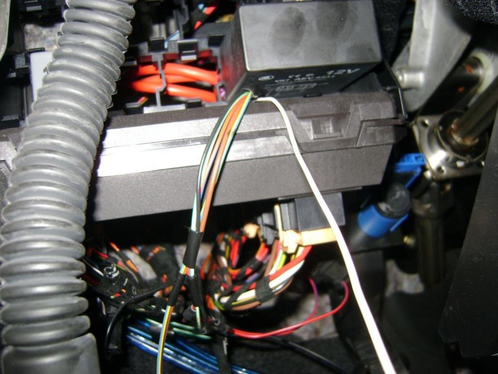

Thanks for the reply Fabia-format. I've tried a new switch unit and that made no difference. Heard this comfort module mentioned before, where is that located?
Mike
It's located above the driver's feet (near the relays and fuse box). Here under you find some pics of my former Fabia I, which was a LHD, so most things are just on the other side in comparison to your car.

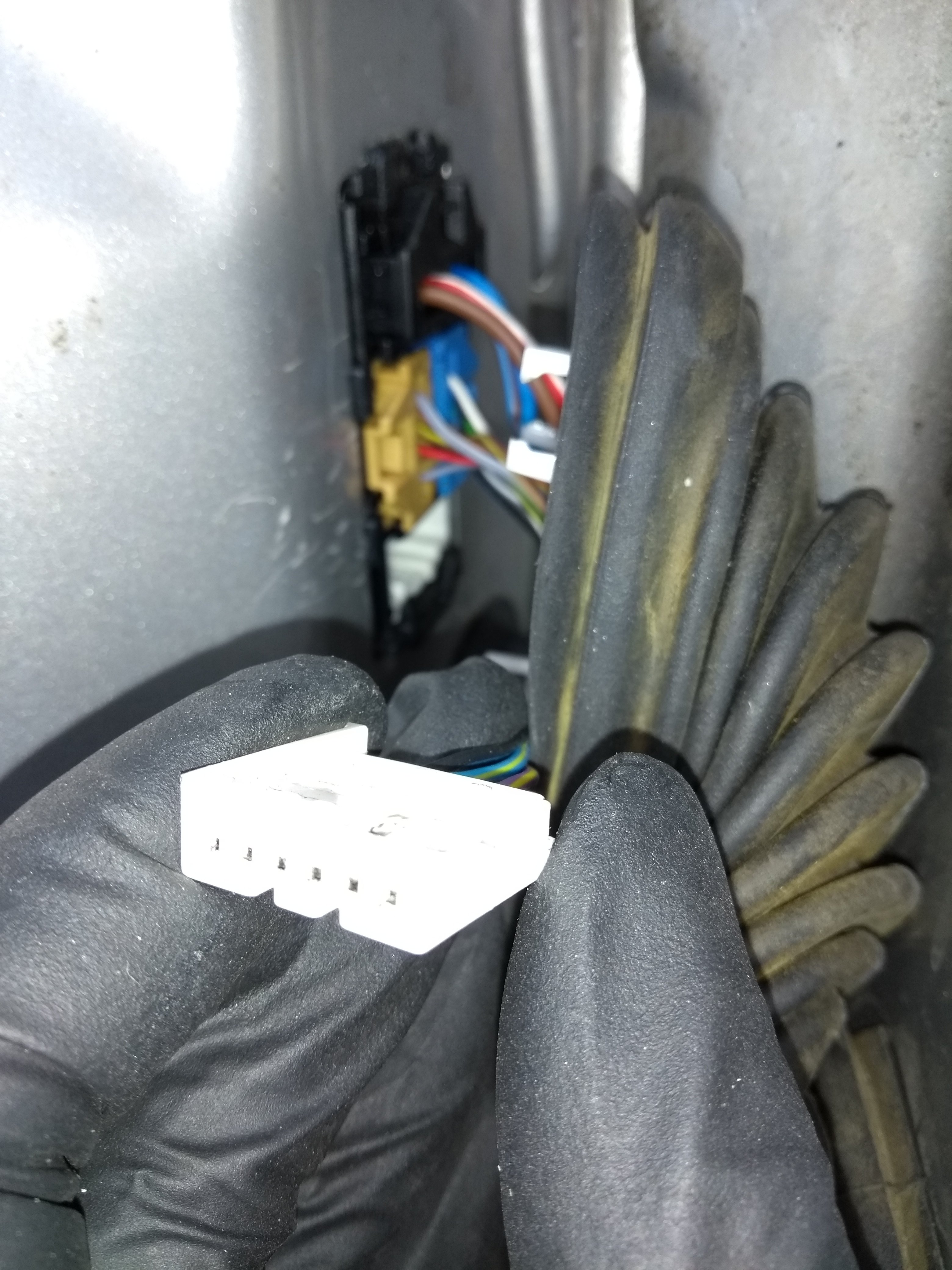

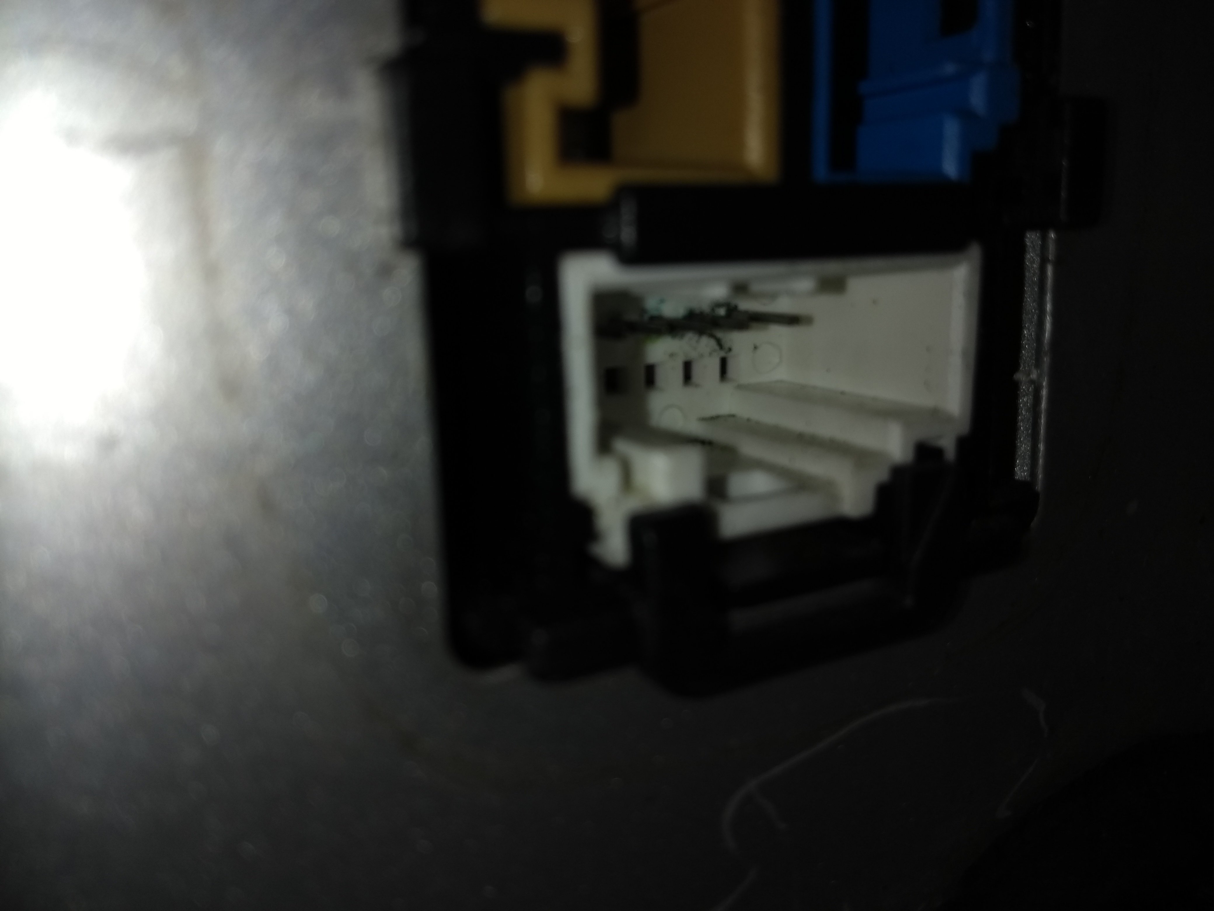

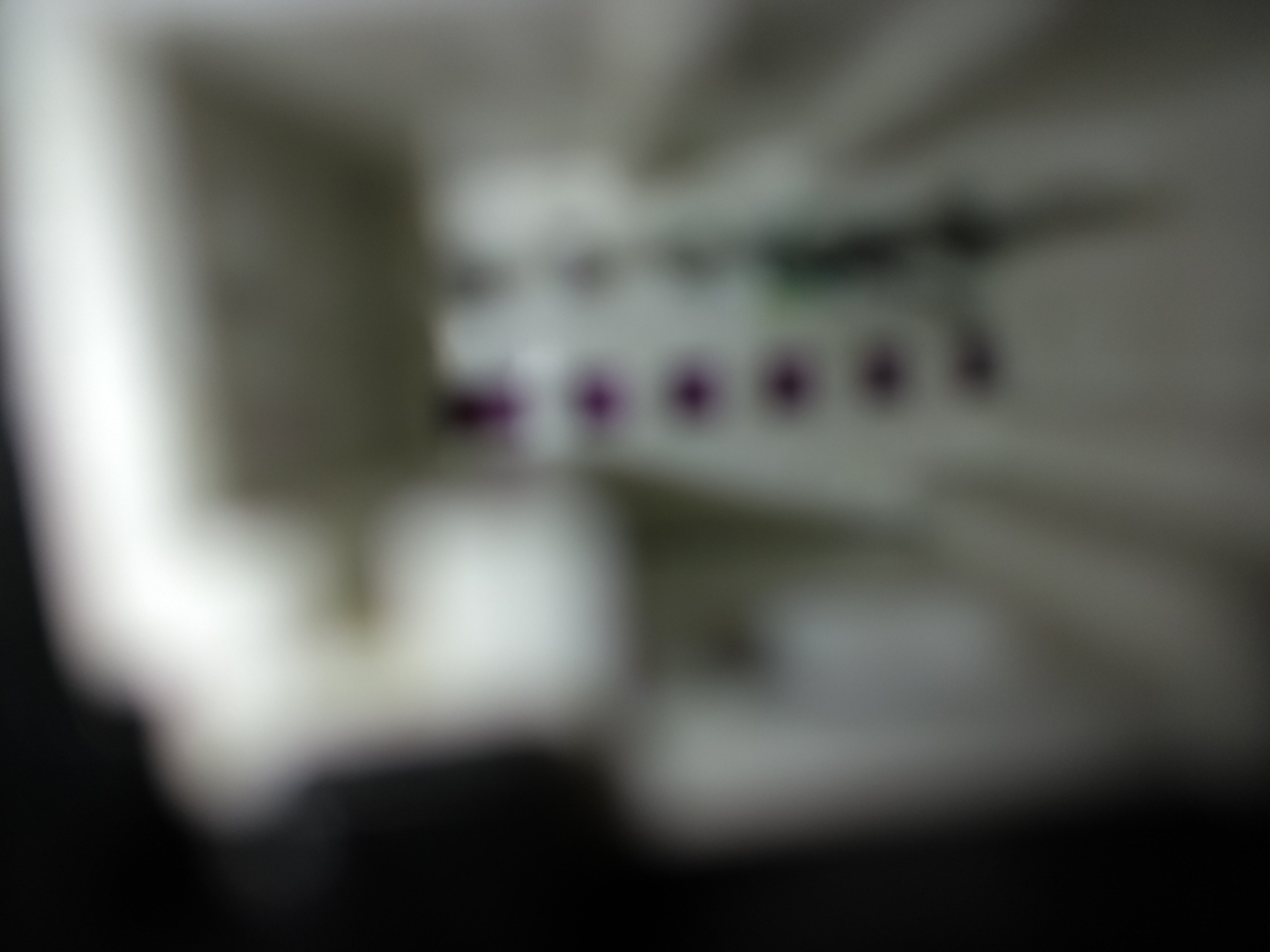

I've checked the plugs and there's definitely something wrong with the white one. Tried to take photos but almost impossible without taking the door off! You can see in the blurred photo green discolouration on some of the pins on the main body side. The plug from the door seems okay after removing the pins and checking them, although there is a little bit of green on the plastic molding. I can't get the black insert out to have a proper look. Any idea how I can get this cleaned up, or even if this plug has anything to do with the window not working? Will spraying contact spray on this be enough? When I plugged it back in it seemed to be the central locking kicking into life!

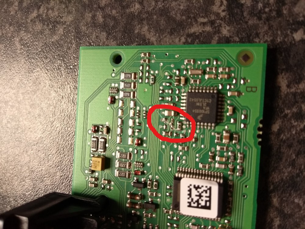

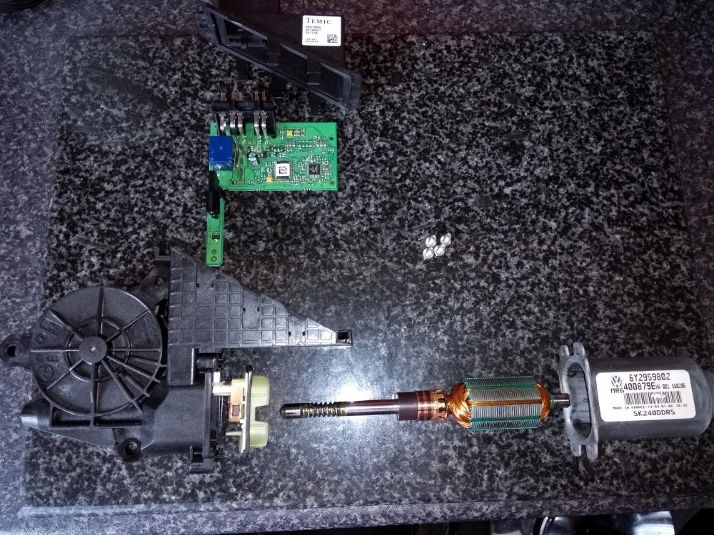

Because I'm nosey/curious I took apart the old motor to have a look.  I think there is a spot on the PCB that looks a bit melted so that's probably the culprit (see photo).  I tell you what, it's a bit of a beast, seems very well built for something doing the single job of putting a car window up and down.  God knows how many metres of copper wiring and some really good magnets which I might try and salvage.  Perhaps this is quite common in car window motors but it impressed me!  Can see why a new one would set you back £140 or whatever!

Sorry late reply glad your sorted. That’s corrosion on the plug removing the plug will removed some of it which would have been part your problem.
Yo remove the plug you remove the trim inside the car and pull the plug from the inside. Just use a small flat blade screw driver and scrape it off carefully then clean up. Cheers
