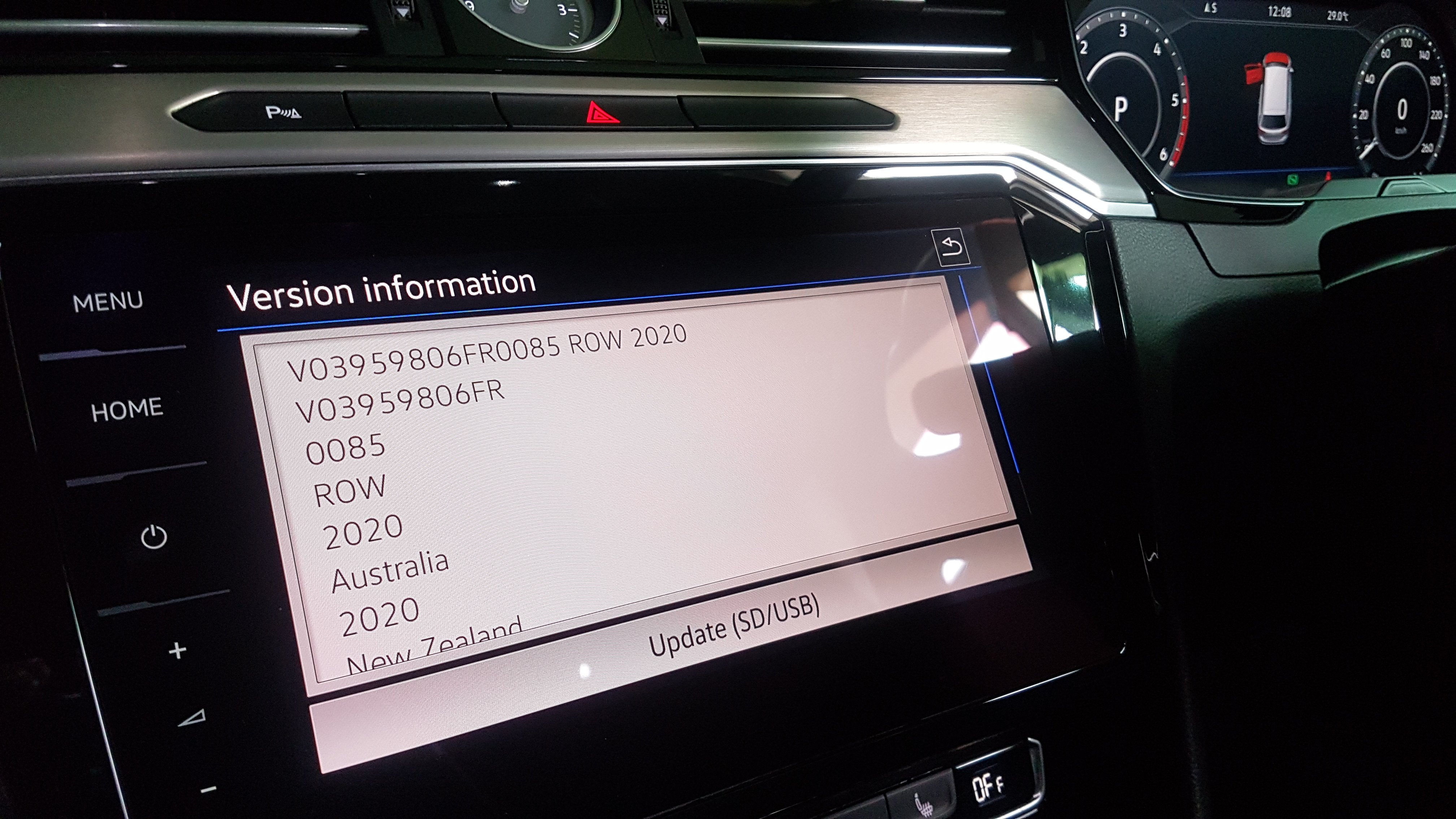

As everyone might now be aware, the ŠKODA update portal now has the P85 ROW 2020 maps available; https://updateportal.skoda-auto.com/
Installed on both my Superb and Passat (pictured)...

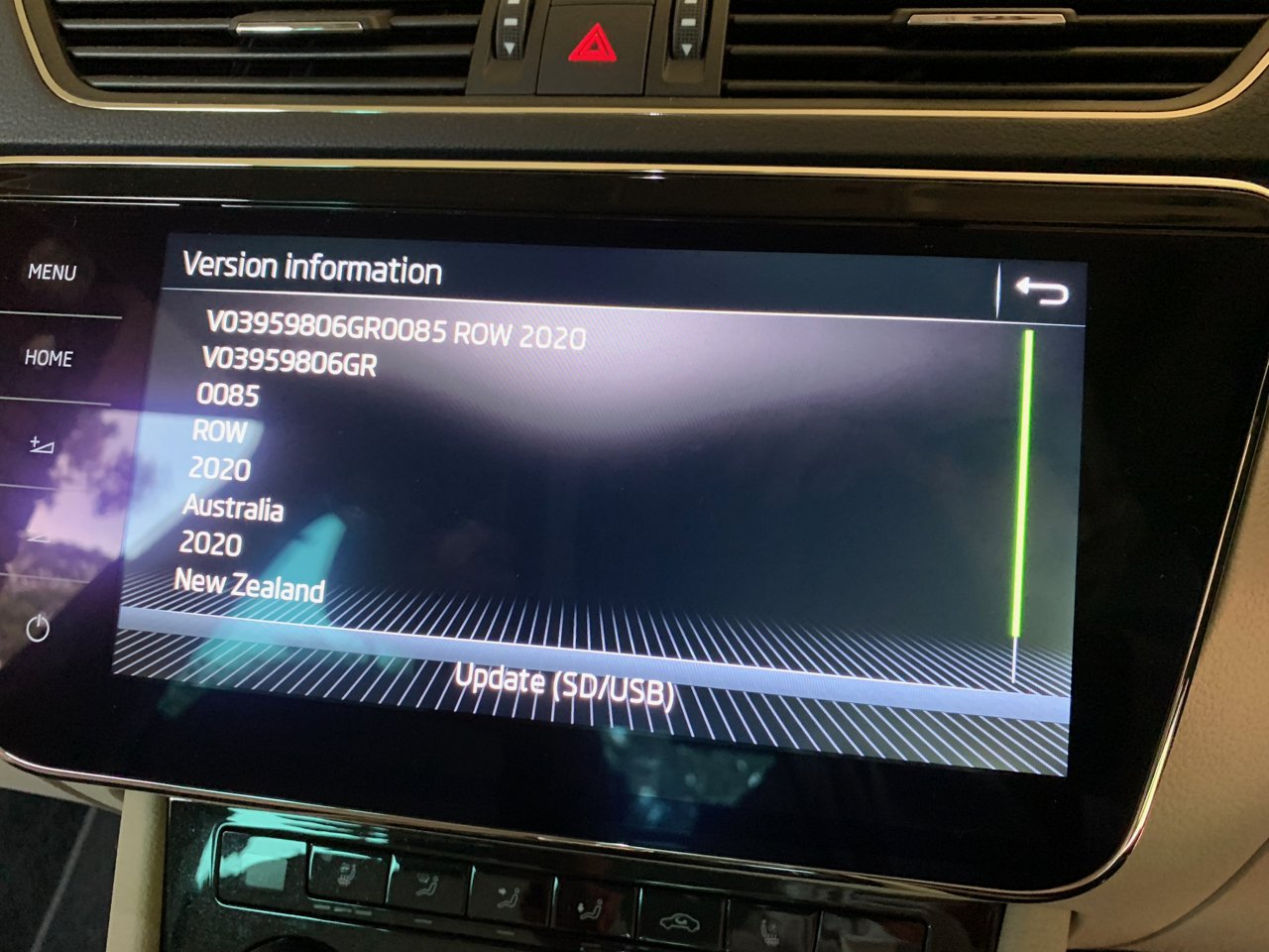

Yes, I installed on mine from the link provided by @MartiniB. However the code on mine says V03959806GR0085, whereas the code in the image from @ope126 is V03959806FR0085 @MartiniB may be able to explain the difference?
IMG_2827.HEIC
Just realised I uploaded HEIC (Apple format). Here is a jpeg.
can't explain, but have seen different letters also previously
maybe depends on device too
ECE 2017-2018 24Gb
Files inside:    2016.12
Version:    V03.959.800.QQ 0161 ECE 2017
Version:    V03.959.801.JN 0161 ECE 2017
publicized:    2017.06
ECE 2018 24Gb
Files inside:    2017.07
Version:    V03.959.800.QS 0166 ECE 2018
Version:    V03.959.801.JP 0166 ECE 2018
publicized:    2017.11
