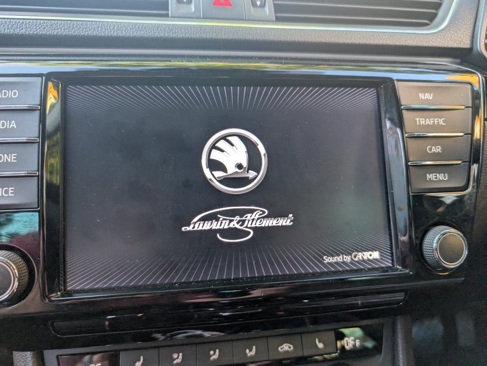

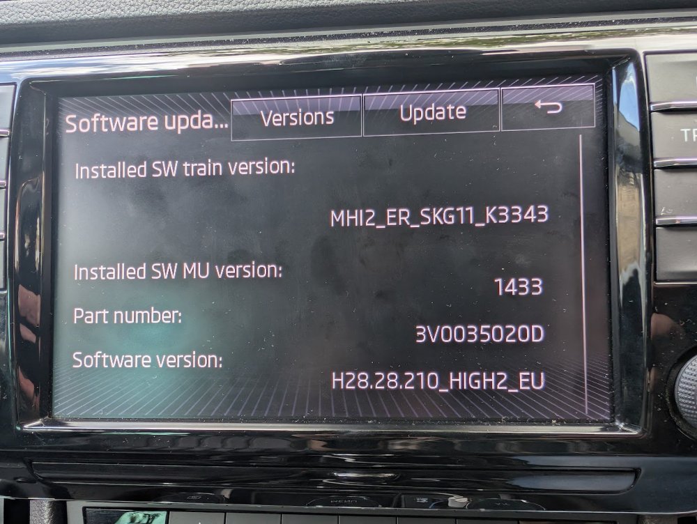

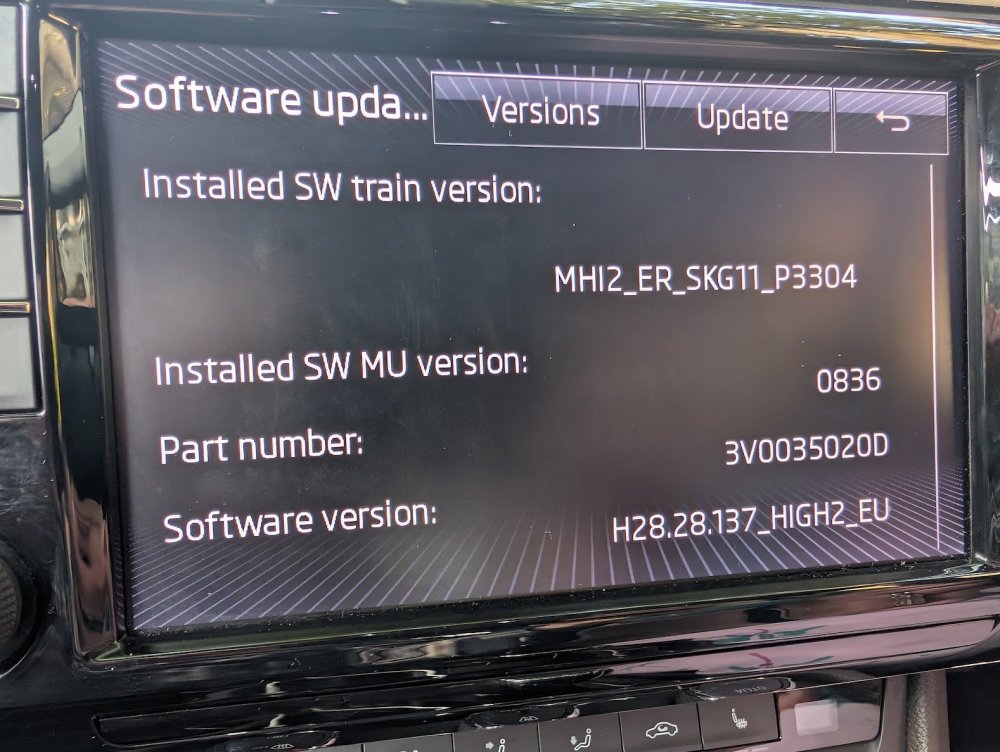

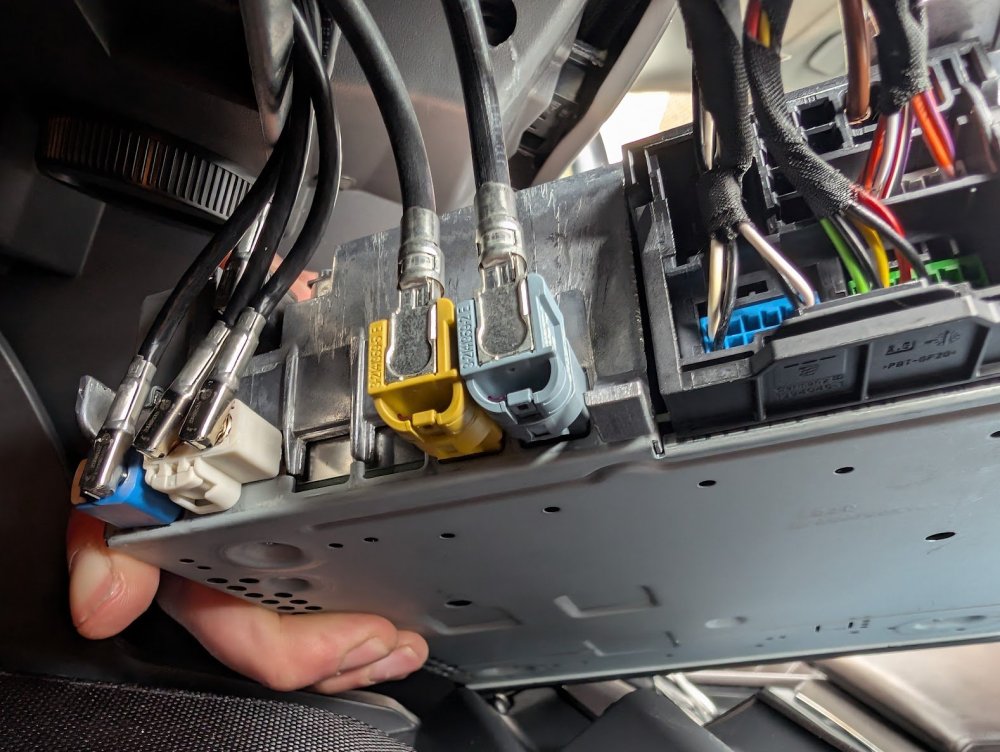

I think I've updated my MIB2 to the newest version in prep for the mib2.5 upgrade.
Investigate my no DAB stations issue. Cables all plugged in. I guess in the right places?

look ok to me. DAB is the black one top left in the photo and easily snagged when putting the unit back in. Do you have any cheap USB chargers plugged in? They were knocking out my DAB signal. Bought some slightly more expensive ones from amazon and it solved the issue.

oh, this one? It was a bit snagged. I didn't know which cable was which - I'll give that a good wiggle.
