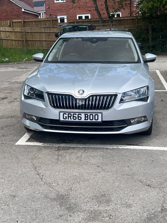

Well I’ve finally been able to start on the Superb, finally got the old number plates off and the 2 ton of double sided tape before fitting the number plate surrounds and Personal Plates 😜 then updated the Gracenote, the maps and the radio station logos, tried to work out how to use XOR calculator, and couldn’t make head or tail of it so gave up and went to look for some migraine tablets 😖🤪 IMG_4492.jpeg

If you have carscanner app for coding then you don’t need xor calculator as it seems to be built in. Seemed to just clear the fault for me.
If not @JR RS has some info in his software update guide on how to use it.
Reading the installation change
Open this page:
https://xor.pw/#
Take the first value from the readout
Take the second value, C9D2
Enter the new value for the installation change, apply the adjustment, the value reverts, clear the fault memory
Auslesen der verbau Änderung
Diese Seite öffnen:
https://xor.pw/#
Erste Wert vom auslesen nehmen
Zweite Wert C9D2 nehmen
Neuen Wert bei der Verbauänderung eintragen, Anpassung übernehmen, Wert springt zurück, Fehlerspeicher löschen

@Binx1310 ive got Hex-net but when reading @JR RS guide it showed “confirmation of installation change” 6c35 in the picture and then 30c5 and c9d2 in the text and I couldn’t work out where the 3 came from 🤪😖 I blame all the fumes trying to get the tape off the front bumper
1 hour ago, GREEBO_22 said:
Thank you @Cairus
The input values in the how-to-guide r just examples.
Every car has a different first input value.
The second input value is always "c9d2".
Glad u got it in the end.
Yep thanks @JR RS your guide helped a lot it was just I thought the image with 6c35 in the picture was from your car and I couldn’t work out where 30c5 came from and didn’t understand that c9d2 was a default value
