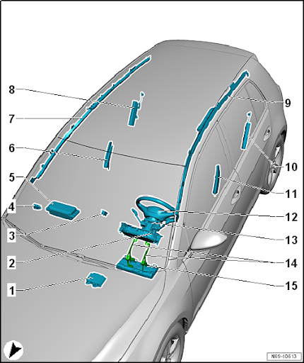

I think the ignitor for a curtain airbag is around the B-pillar but it extends over both windows and down the A-pillar :)
Much like this example image for a Golf:

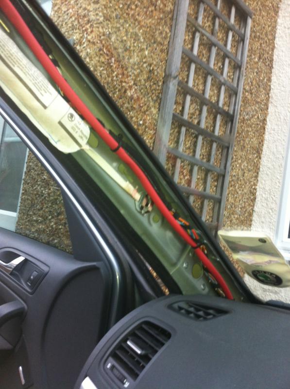

My A pillars definitely had individual airbags.
The previous MK2 Octavia had airbags in the upper outer side of the seat bolsters, I think the Yeti has one in the B pillar but it could be over the roof, there are no signs of the headlining having rupture points to allow the deployment, on the moulded dashboard its invisible, it would also be in the fibreboard roof moulding but for the fabric covering.

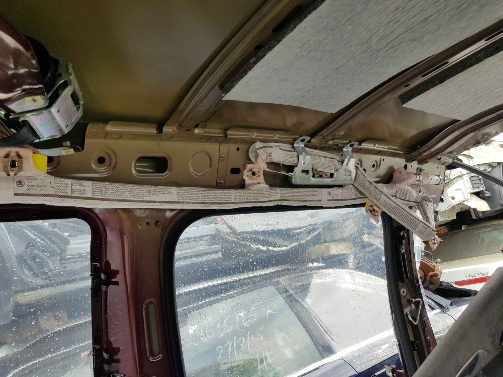

There's a photo here of the airbag in the A pillar in a Yeti..
And in the YouTube video you can see where they are in the facelifted Octavia at 25 seconds.

In the graphic langers2k posted, are airbags at the rear seat side, labelled number 10 standard? I don't recall seeing anything indicating they may be there in mine, I guess they're optional.
Edited by Jip
They're optional.
I think there are a few spec levels when it comes to airbags, crew protection possibly?
The details aren't super important as each car model/spec could be slightly different. My general point was that some cars will have curtain airbags along the top edge so if you're running wires along the top, please check and route them appropriately which may not be easy without dropping the roof lining :)
For Yeti specific stuff, here's a random picture of a (sad looking) Yeti with the curtain airbag in place. I'm pretty sure the left of the image is the rear based on the seat belt point so if the airbag was unfolded, it feels long enough to get to the A-pillar:
And a picture showing where they deploy which again suggests the curtain extends down the A-pillar:

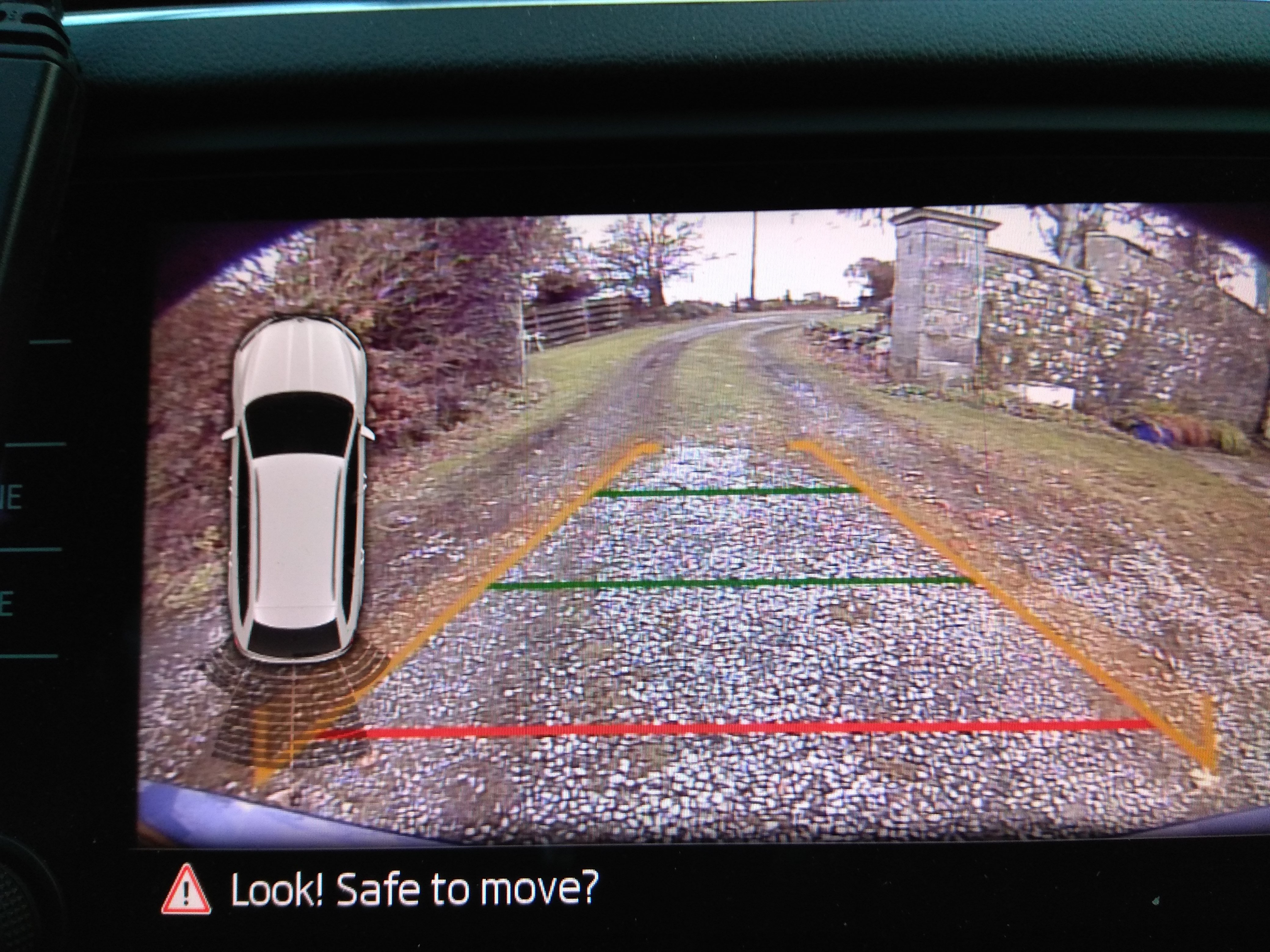

Just to slightly update my retrofit. For those, whose cars are of earlier MYs (MY15 in my case, manufactured 11/14).
I couldn't get the camera working in case the parking sensors activated automatically when getting closer to the objects in front of the car. When selected reverse, I got just the OPS view, not the picture from camera. It turned out that my gateway needed newer software to communicate with the camera as well as with the parking sensors module. So, the gateway has been flashed from index AC to AM, camera has been calibrated using special "domino" board.
Now it works as it should. Picture from the camera is available immediately after switching the sensors on with the button, even if standing still and it doesn't matter which gear is selected and after automatic activation and selection of reverse, too. Completed.
