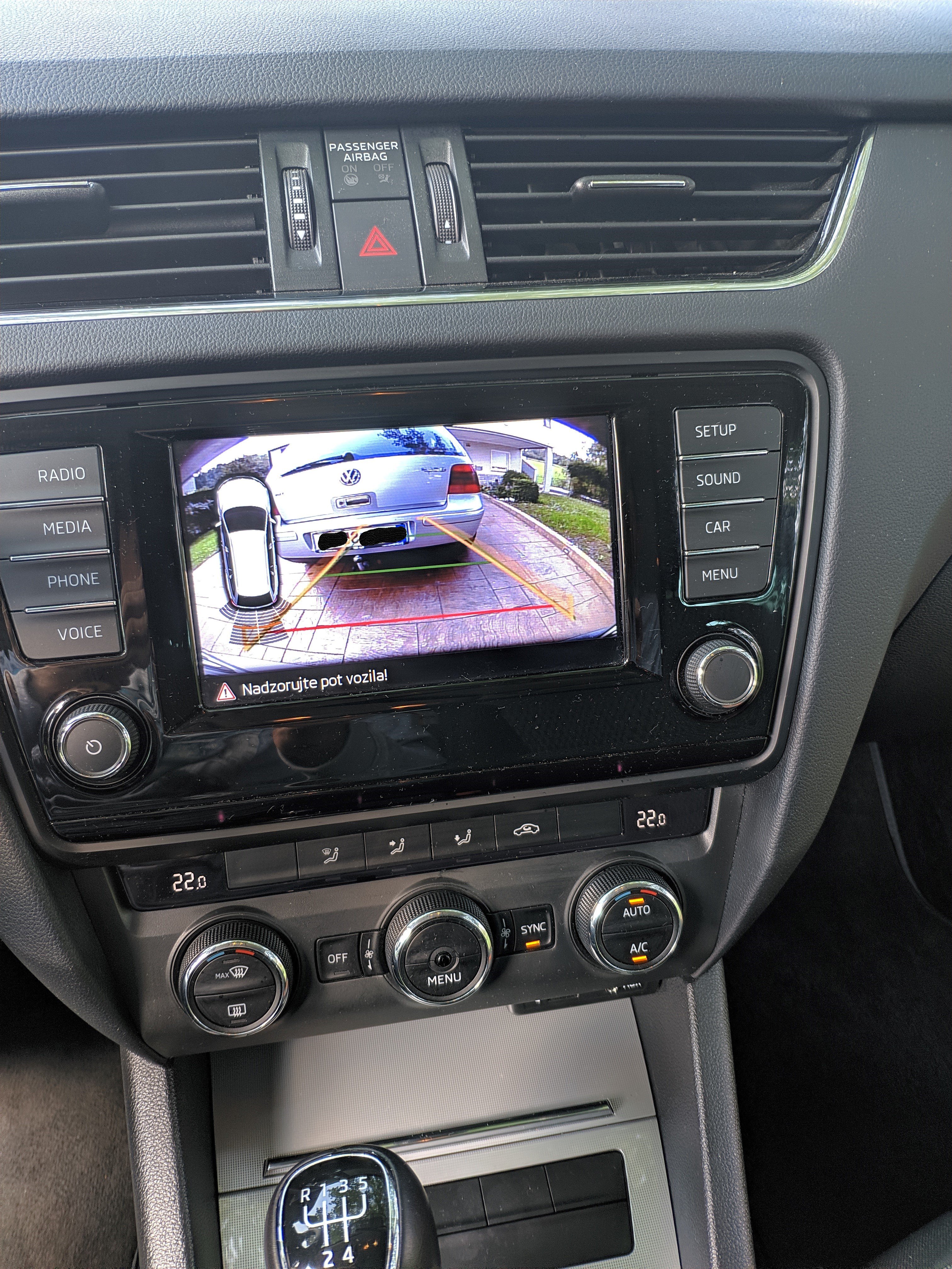

    My first post here, and english is not my native. I have finally managed to install the Sinosmart reversing camera on my Octavia mk3 MY2015 (nickname: brownie). The hardest part was the cabl

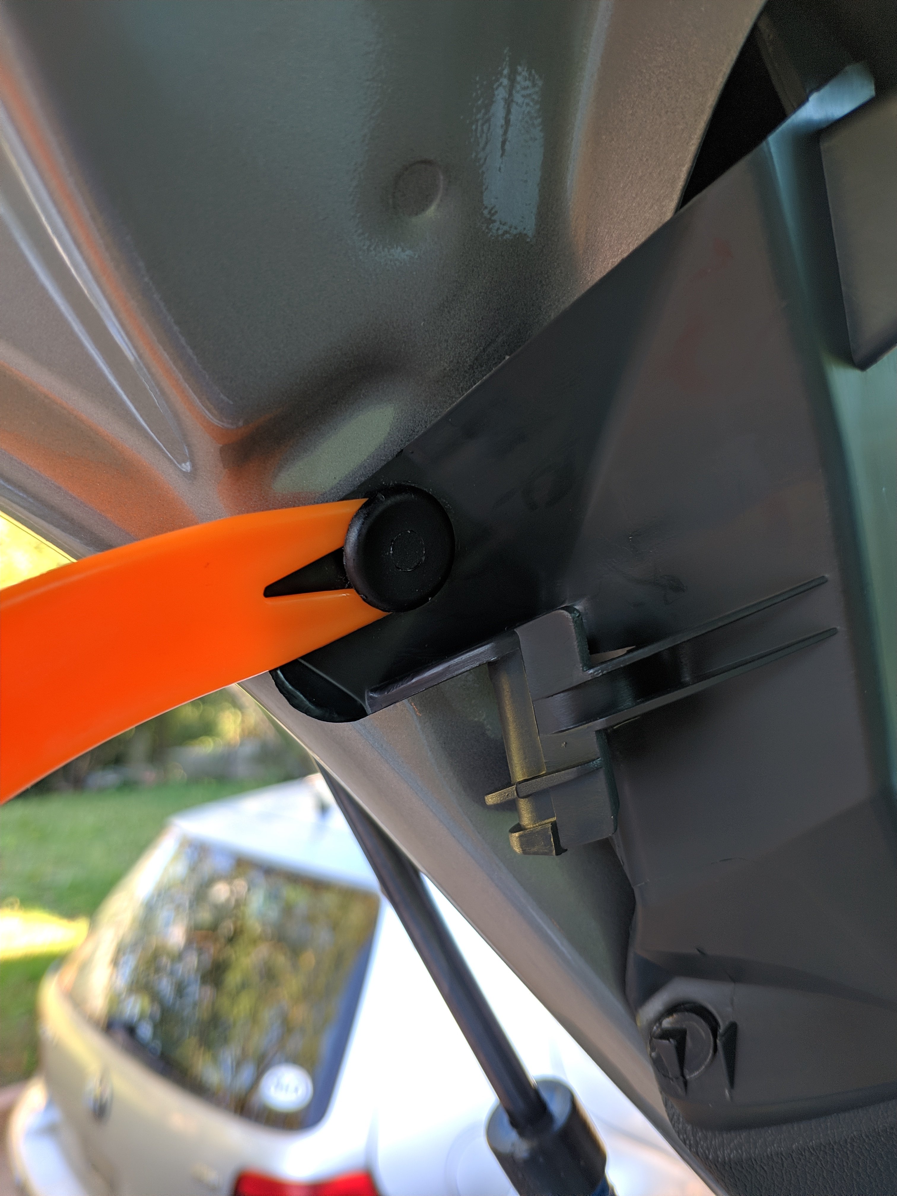

How do i remove this sucker. Im breaking the pry tools on him.
Got it 👍
Finally managed to fit it.
Works great. Although a higher res screen would make it really shine. B)

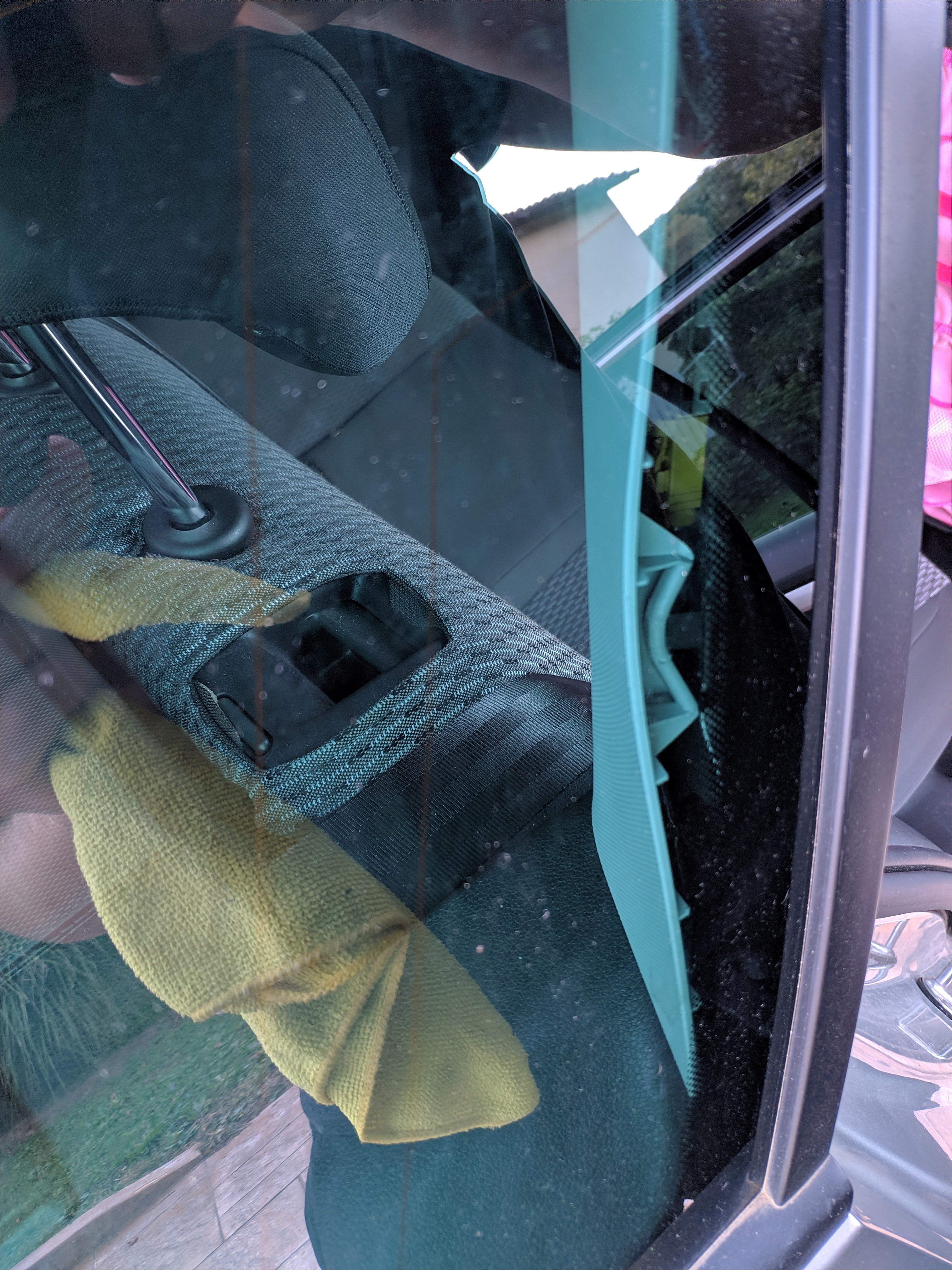

In the process I managed to dislodge the trim behind the rear door.
Any idea how to put it back in place. The clips that holds it really look that the trim need to be fully removed before it can be reused again.

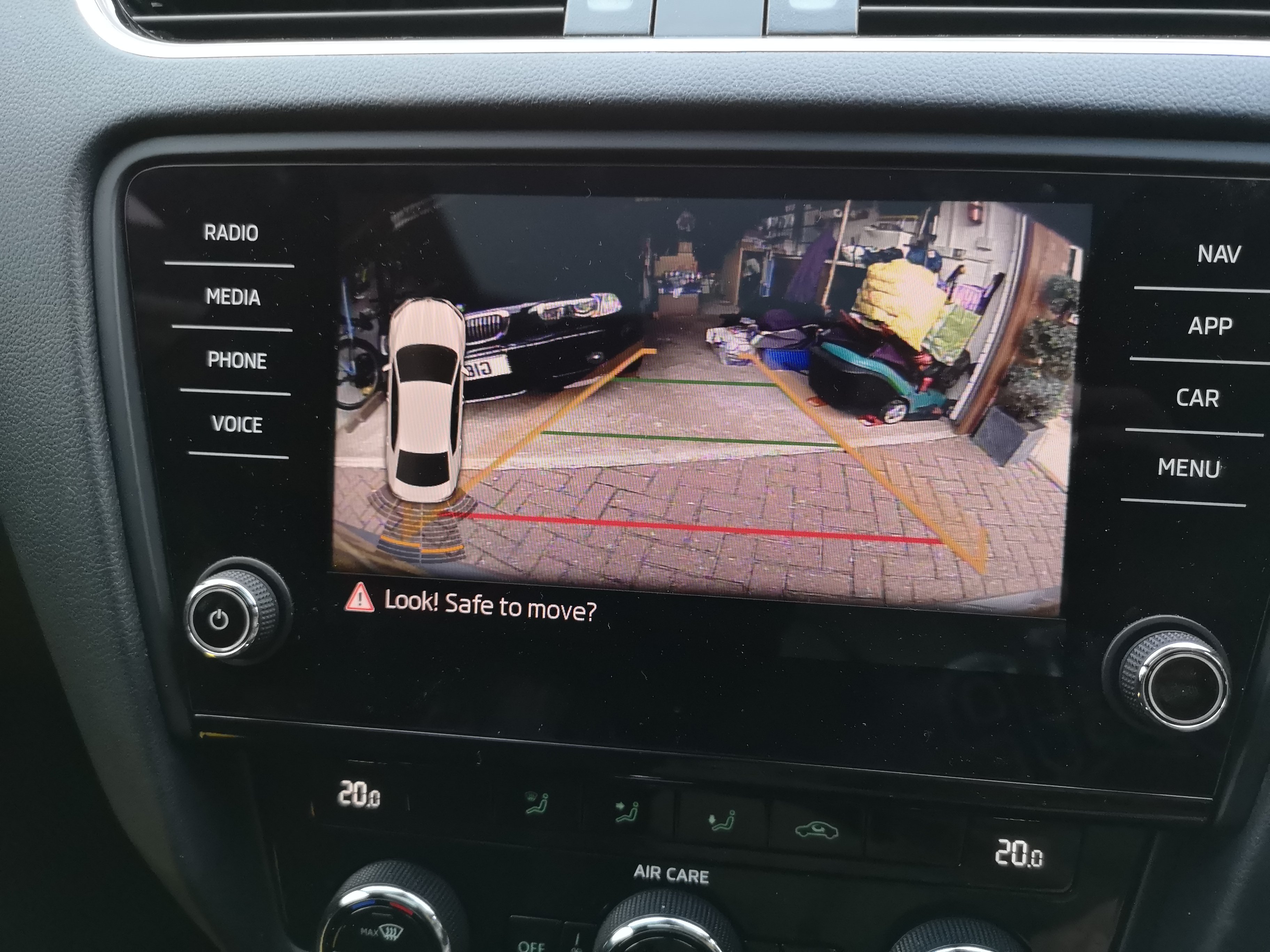

Anyone know how to activate dynamic steering lines? I have it on my mk II but the dynamic lines are moving a little bit strange...

As you might guess, I'm (trying) doing mine now.
The pin is made from two parts. You need to push the circle  part in the center throug the pin.
Ok, I know how now.
The central "pin" pulls out, honest.
Once that's out the clip is cable to collapse and comes out easily.
At which point, you realise that it does not really improve access that much.
:blush:
Thank you. I pulled it out with pliers, but the same effect.:thumbup:
