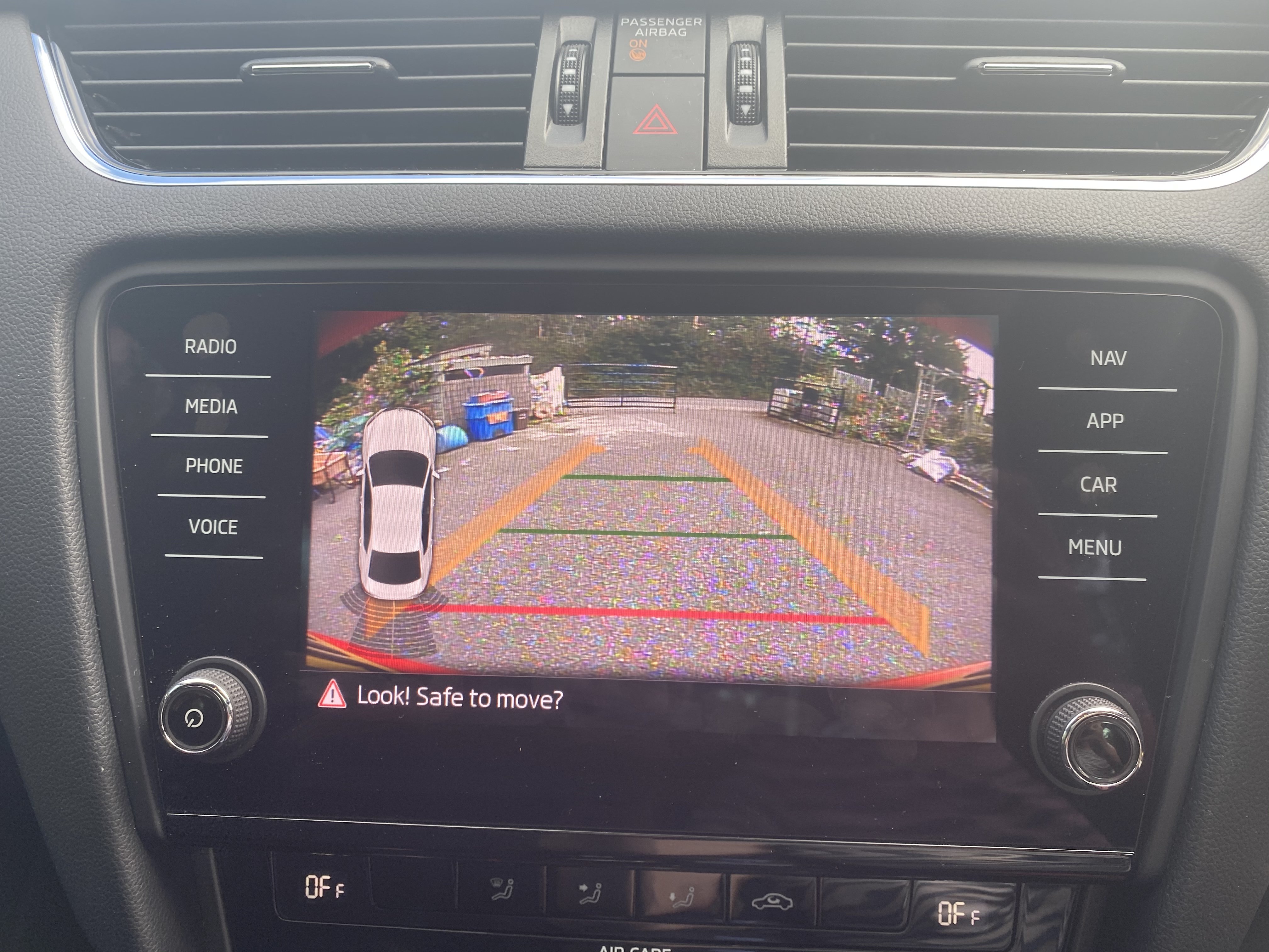

    My first post here, and english is not my native. I have finally managed to install the Sinosmart reversing camera on my Octavia mk3 MY2015 (nickname: brownie). The hardest part was the cabl

I can add that ,ordering from aliexpress ,best option is to seek a camera with Sony lens(fisheye and clear HD picture +turning markers).It's a good quality and long lasting product!There is also one more benefit: It might be connected to all OEM Skoda medias(many people think it's iimpossible ,but it is).I'm using similar(without Sony lens already two years trouble free)
