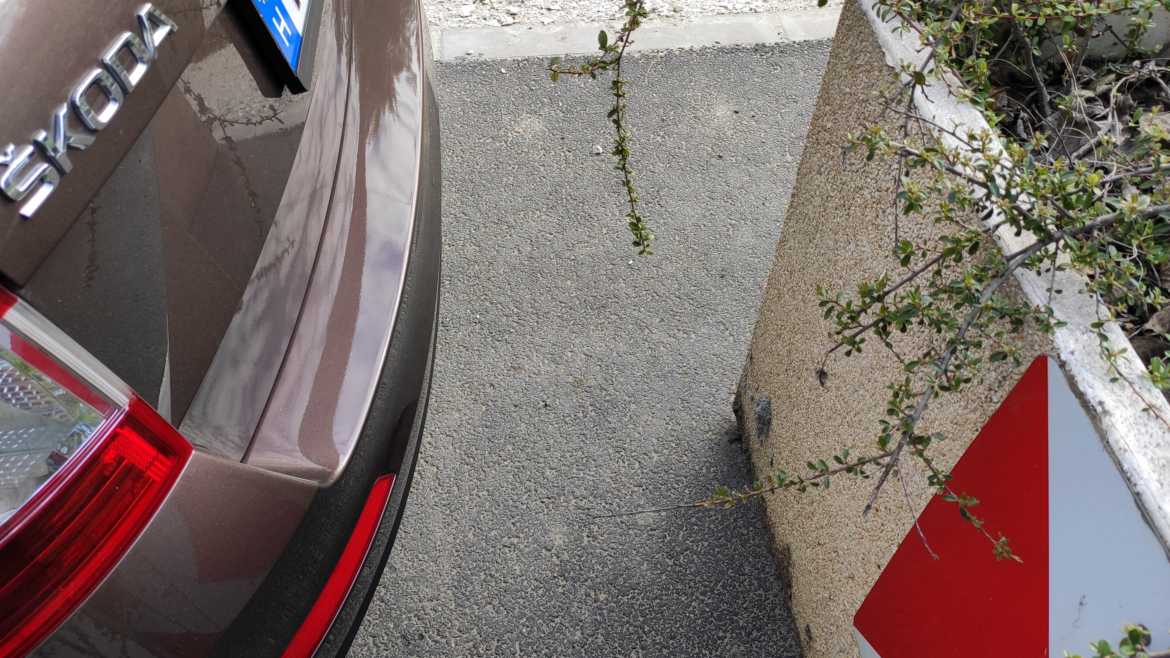

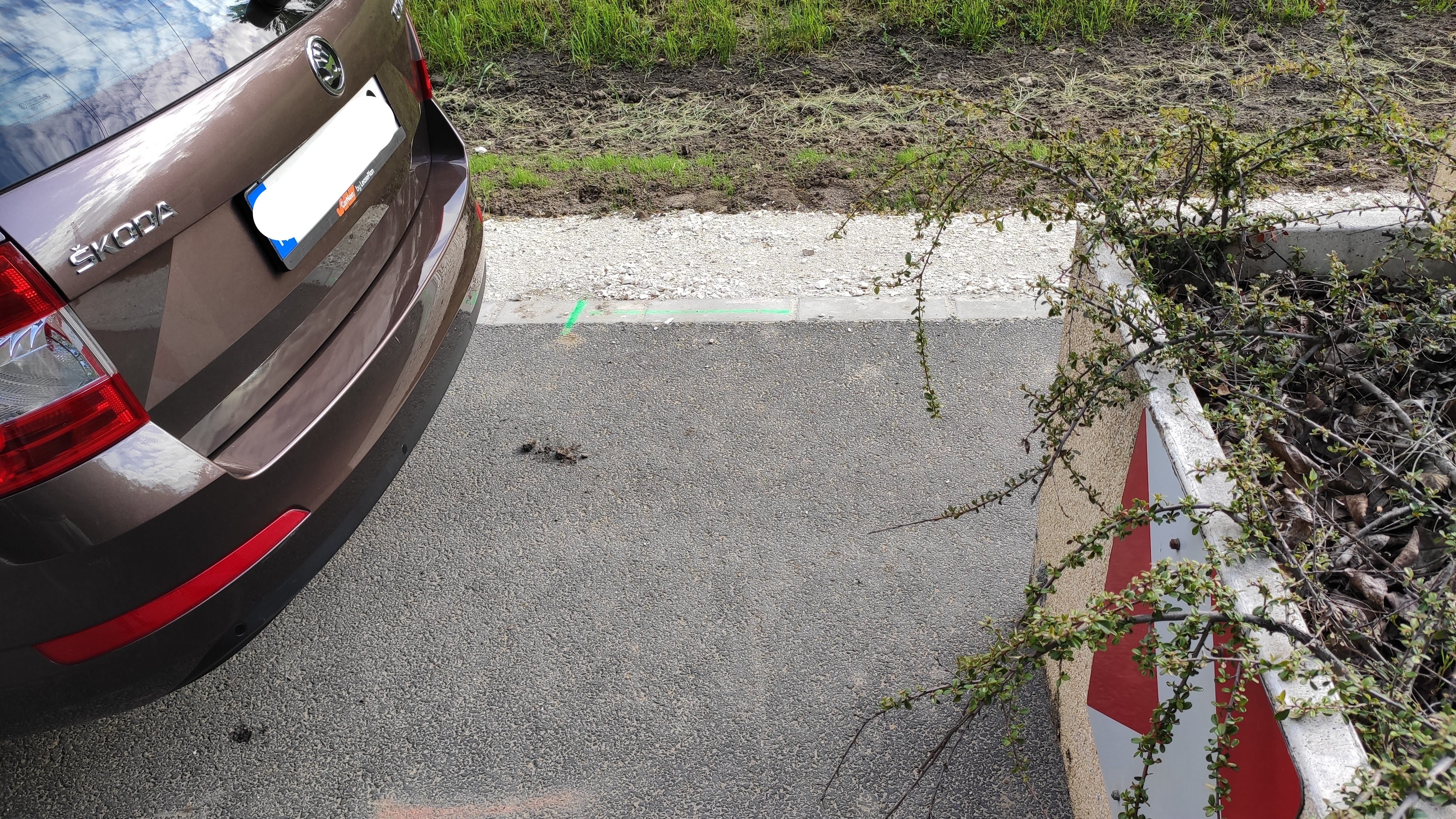

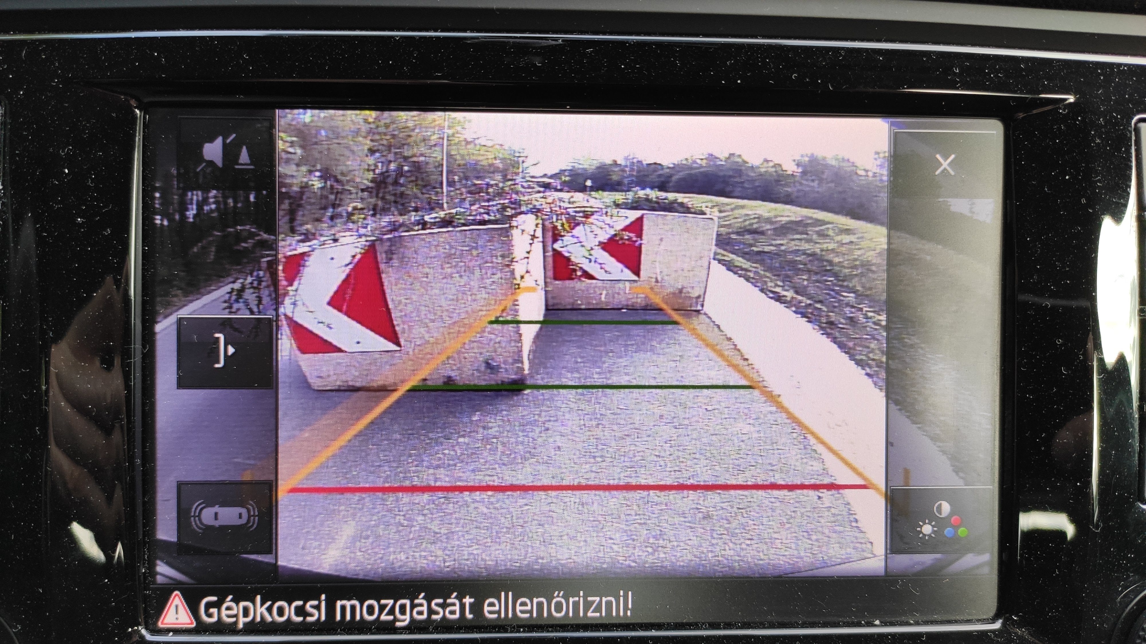

My first post here, and english is not my native.
I have finally managed to install the Sinosmart reversing camera on my Octavia mk3 MY2015 (nickname: brownie).
The hardest part was the cabling to the head unit, but figured out somehow. The other one was the factory release switch, where I could use a third arm for the removal.
The image quality is not the greatest, as others already noted, but it works fine (not sure now for how long) as well as the dynamic trajectory.

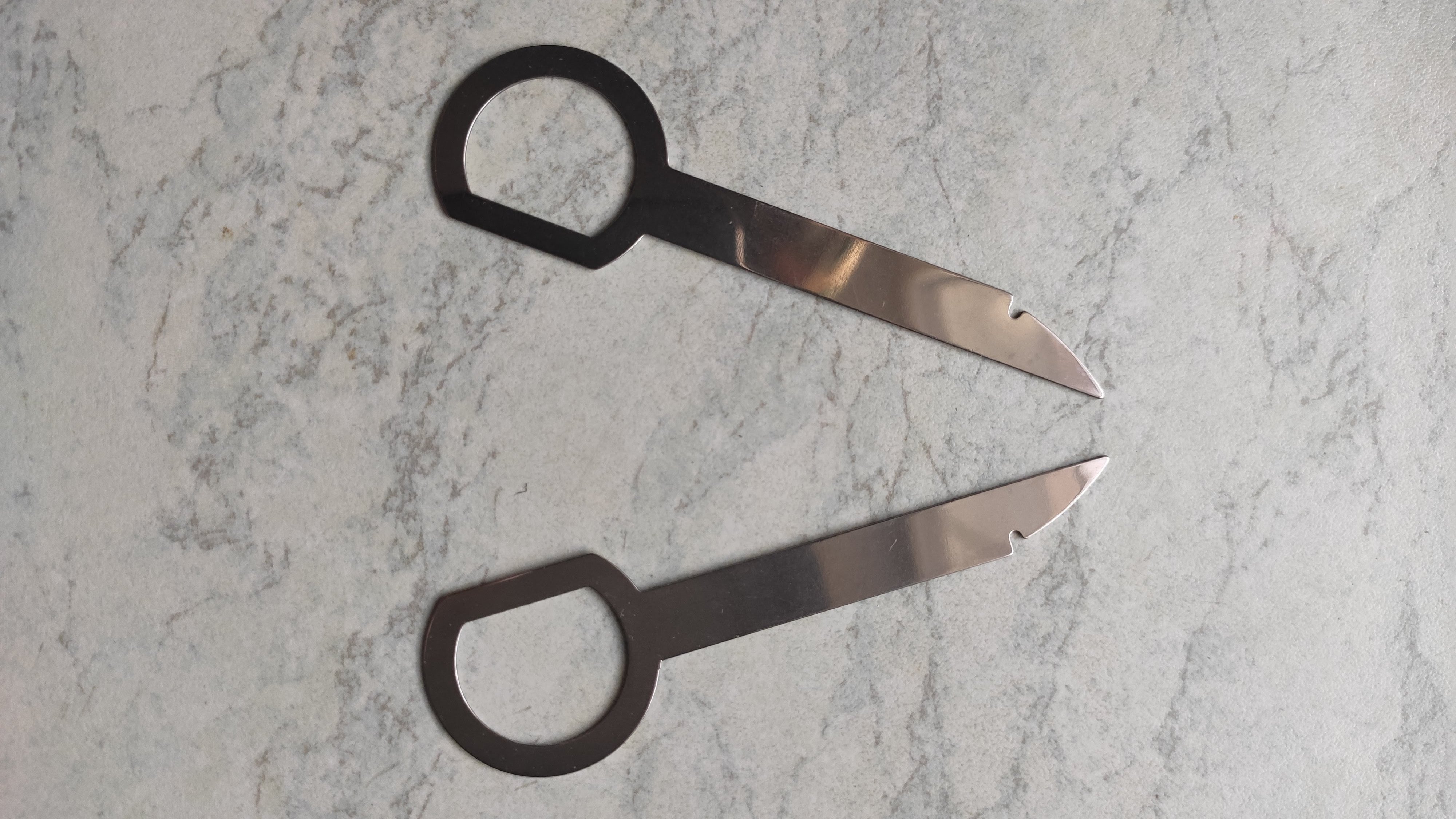

The supplied tool for the radio removal is a crap, so be careful ! Mine has stucked into the head unit and it took me at least two hours to remove it...
Anyway enough of the complaints, here are some distance check at the green and the red line. The green distance is about ~1m (~3ft), the red is about .5-.6m (<2ft), which I think good enough.
The tool is not crap. You just have to push the steel plates - springs at both sides of head unit to release the tool. All these tools will work the same way.
I have pushed the plates as hard as I could, but it didn't come off. Finally found a video on YT which explains how to remove the stucked tool :

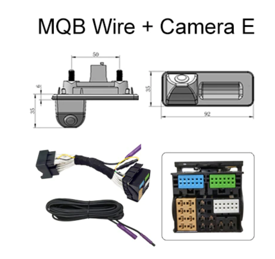

I am retrofitting a MIB2 unit (5Q0035874A) in my 2013 Octy. I would like to fit a reverse camera as well, however, the SINOSMART CanBus version (https://www.aliexpress.com/item/4000230897829.html?spm=a2g0s.9042311.0.0.40694c4dTEPT93) which I think is the most reliable one does not fit my car boot handle (My car handle is 92x35mm).
A potential solution is getting only the camera (type D) and make a hole close to the handle for the attachment. For this type D camera, there are two options, one is MQB wire, and another is PQ wire. I wonder which type should I go for? My guess would be MQB, true?
Or, I can find another camera. Does anyone know a reliable camera which can fit on a 2013 Oct with 5Q0035874A head unit?
Any help is highly appreciated!
On 11/10/2020 at 22:58, SashaGrace said:
One like this will do it, £15.36  16% Off | Auto Trunk Handle Car Rear View Reverse Backup Parking Camera For Skoda Octavia Fabia Superb Rapid Spaceback/Audi A1 A4L A6L Q3
https://a.aliexpress.com/_BS9P3P any handle that’s 92x35 and NTSC will do it :) These handles have threads but there are two clips, think I got one with clips when I did my car. You can make a bracket though. Tbh since upgrading mine, I would cut the boot as the handle is so much nicer and it looks much tidier.
Cut that trunk @Vahids and get a good looking handle and well known reverse camera :)
A question for experts; if the camera power is connected to the always powered supply, like rear wiper, doesn't that mean the camera is constantly working (just not displayed on infotainment) when the car is in used? Rather than if it is connected to reverse light or rear approximate sensors it is turned on when the reverse gear is selected?
The OEM highline and lowline cameras both have a permanent live connection from fuse 18 (IIRC). They only turn on when needed, the highline gets a CAN-bus signal and the lowline uses a feed from the reverse lights. The lowline uses the separate power feed to avoid interference from the bulb monitoring system.
As for Chinese versions, I'd hope the CAN-bus versions used the same logic. The 'dumb' versions with only power/ground connections will depend how you've installed them. Then again, there are so many different but similar looking versions for the Chinese cameras, it's impossible to know exactly what they do until it arrives. Even more so given the number of caveats/incompatibilities mentioned by the Sinosmart seller linked by @Vahids.
As for MQB vs PQ, the MK3 Octavia is a MQB platform car so I'd suggest that version...
