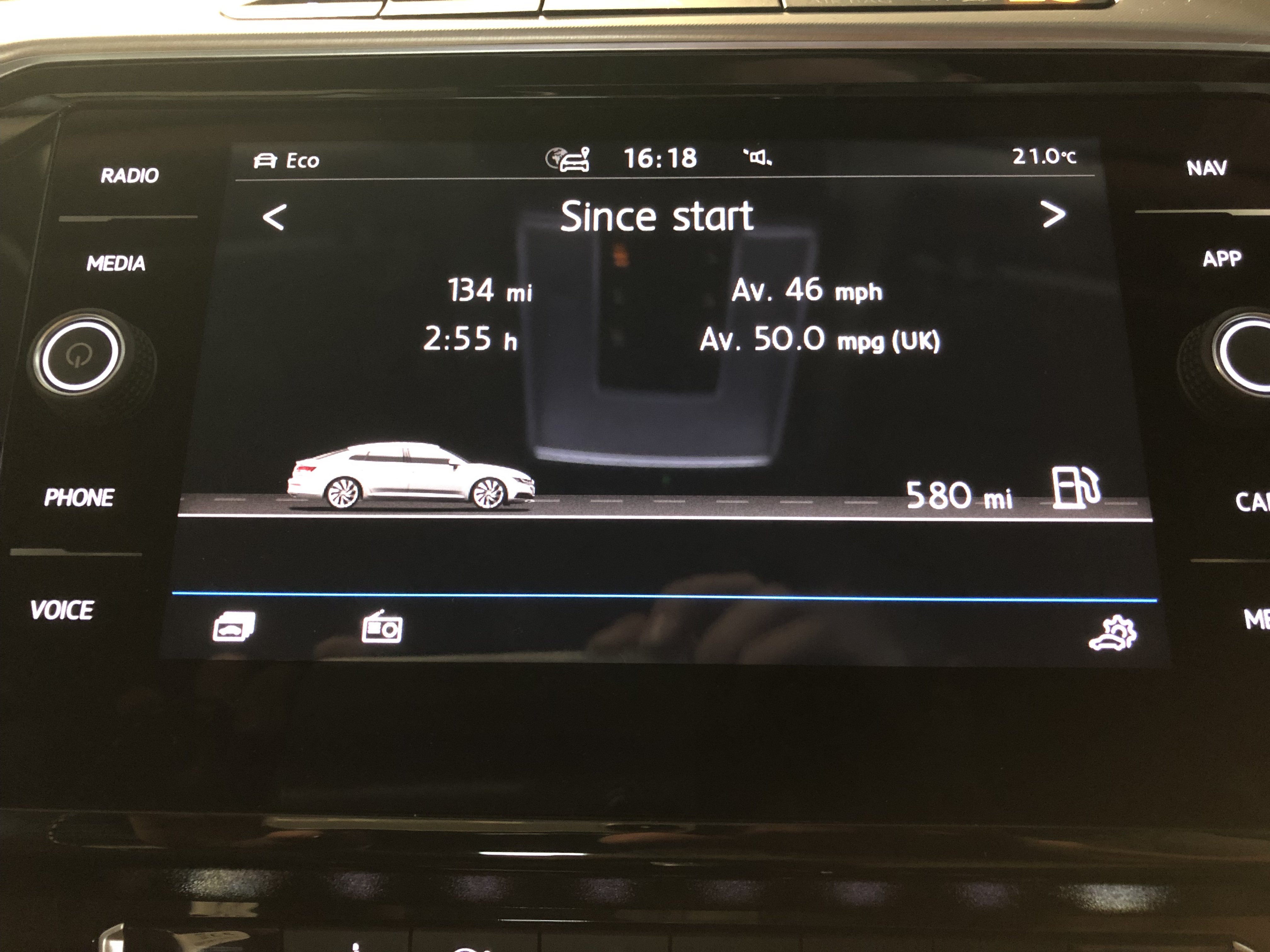

Well, having just taken delivery of a VAG (not Skoda) car with the 1.5 TSI engine and DSG, I think it’s a bloody brilliant combo and can’t recommend it enough!
The DSG seems really smooth in all situations, from manoeuvres on the driveway all the way up to motorway cruising, and everything in between. The switch from 2 to 4 cylinders is virtually imperceptible - if the display didn’t show me I’d not have realised. I haven’t noticed any hesitation when trying to pull away at junctions or roundabouts, either, which is another apparently common gripe.
The car has done under 300 miles so far, so it’s still bedding in, but I did manage the figures in the picture without any effort at trying to be economical and using ACC for 95% of the journey. And that’s on a car which weighs something like 300kg+ more than an Octavia.
Maybe because Audi get to choose the good bits out of the parts bin first, then VW, next SEAT. Skoda get the scraps left over.
All good about what I would expect, be even better if it were manual. Average 46 suggests some steady open road cruising though. Be nearer 40 mpg with 35mph averages that most have to put up with.
Sure, this was m40 and m25 (Coventry to Gatwick) so there was a fair amount of stop-start traffic on the second of those. Might be slightly better economy in a manual but it would’ve been a much less comfortable drive too.
