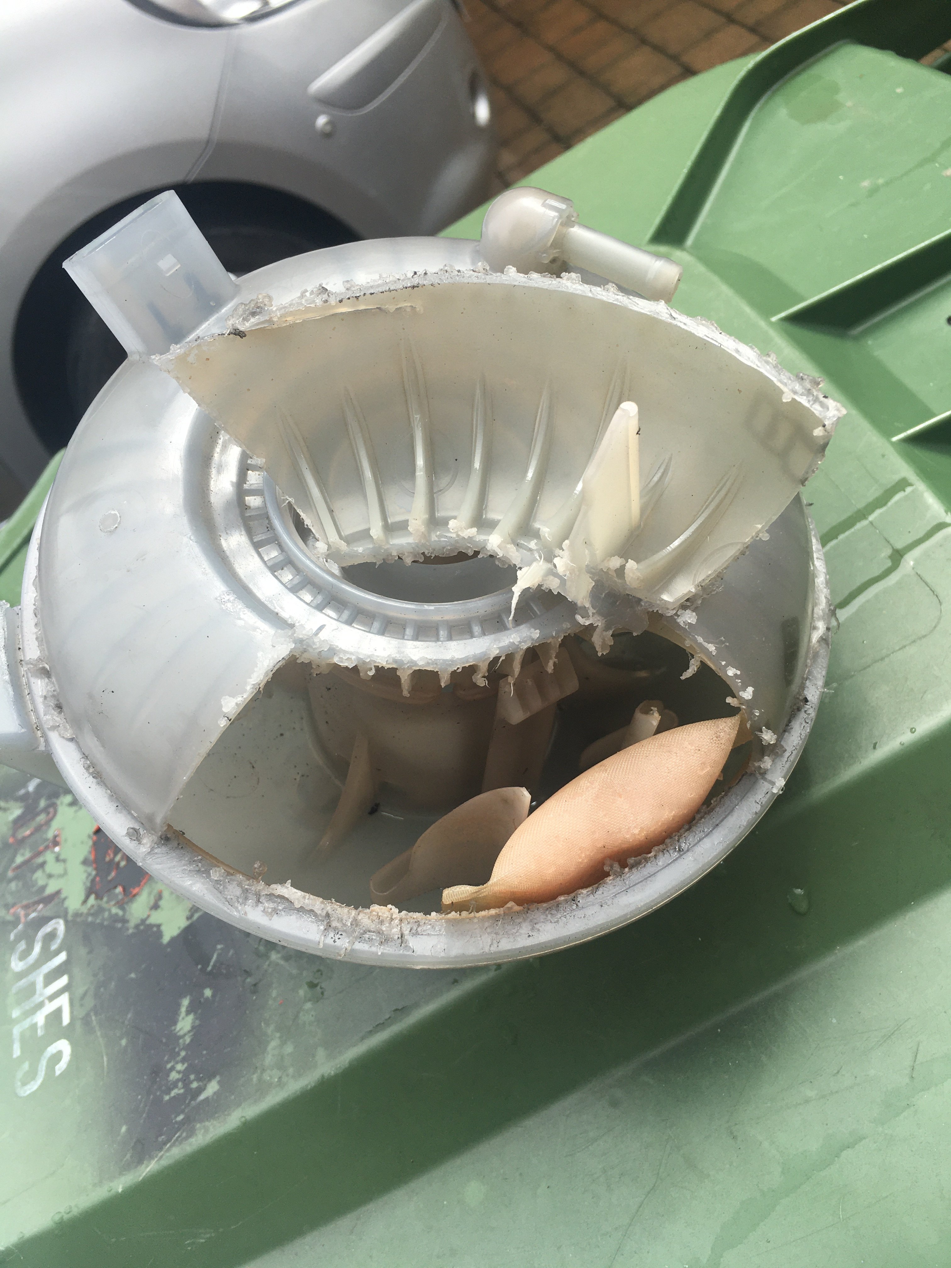

few interesting points...
That A suffix tank has a silicate container and a second mesh outside when I cut the old tank open.
The outer was intact, but the inner mesh was starting to degrade allowing a few crystals between the meshes, but still trapped safely.
The old tank has sensor prongs covered in plastic, the new just metal.
The tea bag style bags, it looks to me as if coolant movement could potentially catch the bag on these relatively fine prongs allowing them to damage the bag. Possibly the start of the problem.
either way, I think the older tanks are probably a safer design, but not infallible. The newer tea bag tanks seem like a bean counter design that’s backfired.
The basic M revision tank and replacing coolant at every water pump change is probably better for cars out of warranty. Changing coolant more frequently, eg every 2-3 years along with brake fluid would probably be good for additional piece of mind.
But even with the second mesh "Barrier" ( "A" type, I presume )  Its not enough to contain the harmful crystals  and prevent them from doing mega damage to the heating matrix + other parts?

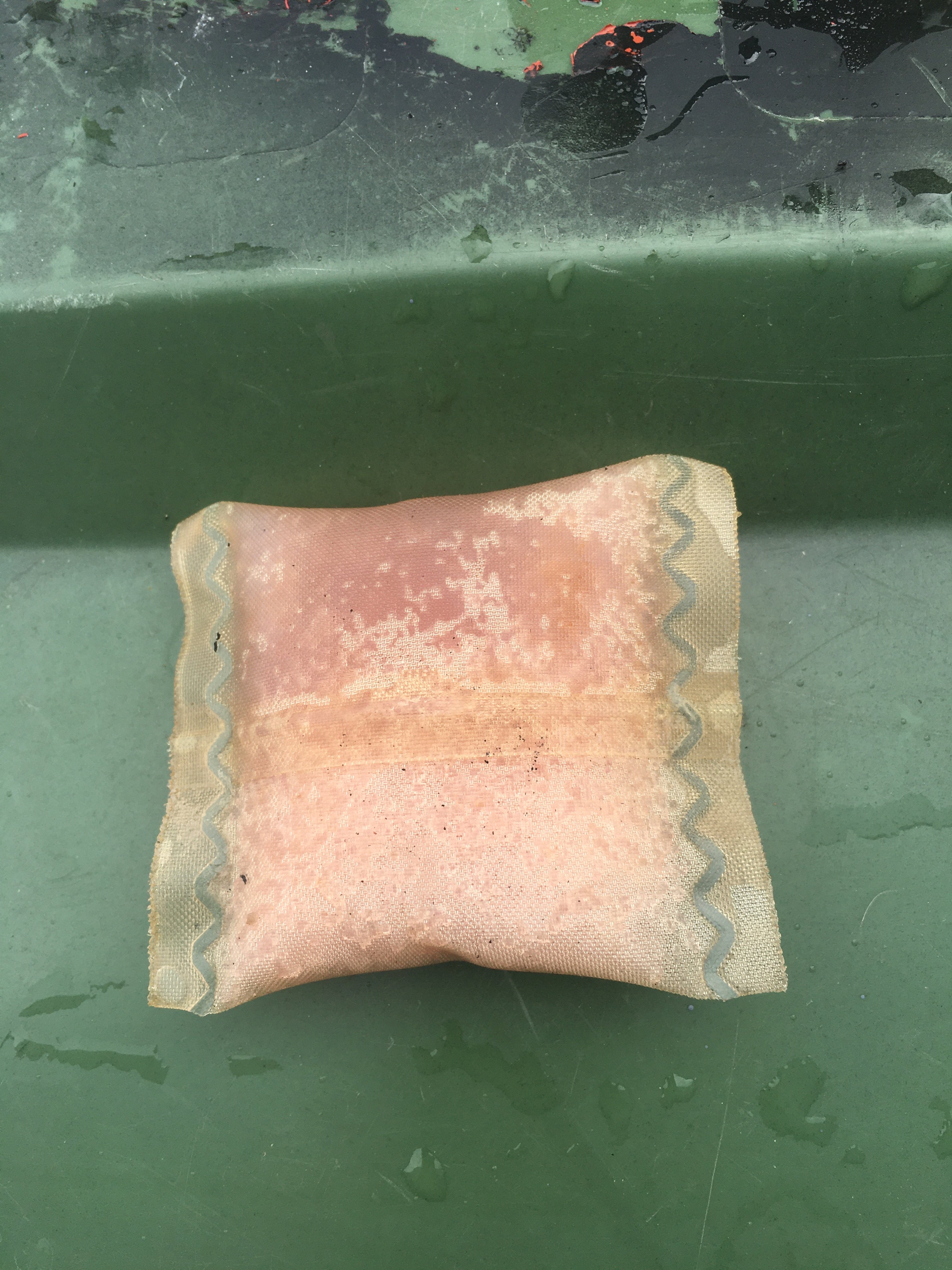

Removed my bag today, it was straight forward, used a pencil and my fingers to get it out. The bag is much tougher than I thought it would be, I can't see how it would split but better out than in.
I've kept the bag for some unknown reason, am I the only one?!

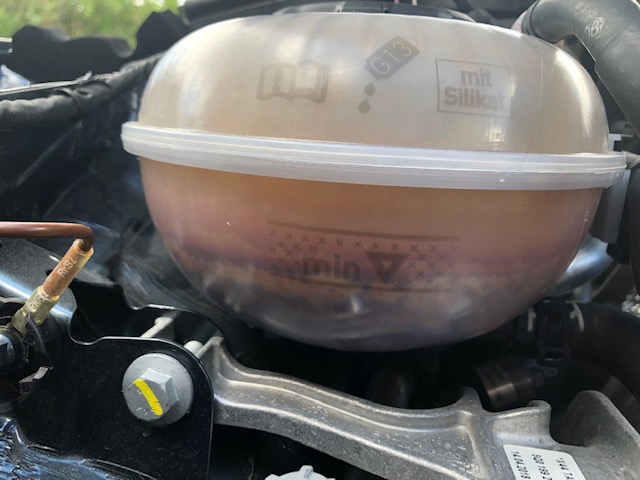

Ok after a good read of this thread and seeming as my 17 plate 2.0L Diesel SEL Octavia has now come out of warranty I've decided to go " teabagless ". My original expansion bottle has the part no. 5Q0121407G and is the version that has an inner and outer chamber with the " teabag " situated in the outer chamber and therefore no way of removing it. Interestingly, my mate's 16 plate 1.6L Diesel Estate has the single chamber expansion bottle which he fished the " teabag " out, yet it had the exact same part no. So the same part no. covers single and double chamber expansion bottles. For peace of mind I've now fitted the 5Q0121407M single chamber bottle as referenced in this thread at a cost of approx. £29 sourced from my local VW dealer. I couldn't be bothered to wait 2 days for TPS to order one in for me. It was roughly a ten minute job to do and I even managed to keep the fluid from flowing out of the old expansion bottle and then transfer it to the new one saving me the need of topping it up. I've cut out a section of my old two chamber bottle and posted a picture of it for those who are curious to see what it looks like. I'm a bit unsure though whether the teabag was behind or in front of the two plastic ridges. Also, but not really sure, it looks as if the corner of my " teabag " might be starting to become loose so thankfully I might have done this mod just in time.
IMG_1359.thumb.JPG.0fbc561317f8f9161f9785c75e7d573d.JPGIMG_1362.thumb.JPG.b10a0d110e14276de871f03d76ce0715.JPG

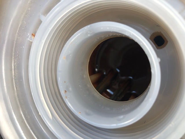

I've read the 8 pages of this thread. The P/N of the tank is 5Q0 121 407G. I haven't plunged my finger in the tank to check if there's any residue of the silikat bag. After a quick glance, there don't seem to be any bag at all. The tank seem to be like this:
But the level sensor has plastic covered electrodes.

Question 2) the image you've supplied, the silicate and silicate container arrows will be the location of the silicate bag. My header tank was like this, I've replaced with the M version now and hacked apart the old container and it was a bag wedged in that position.

I’m no expert but that bag looks ok to me. Either way I think the double walled design appears from pictures on here to have had fewer issues.
