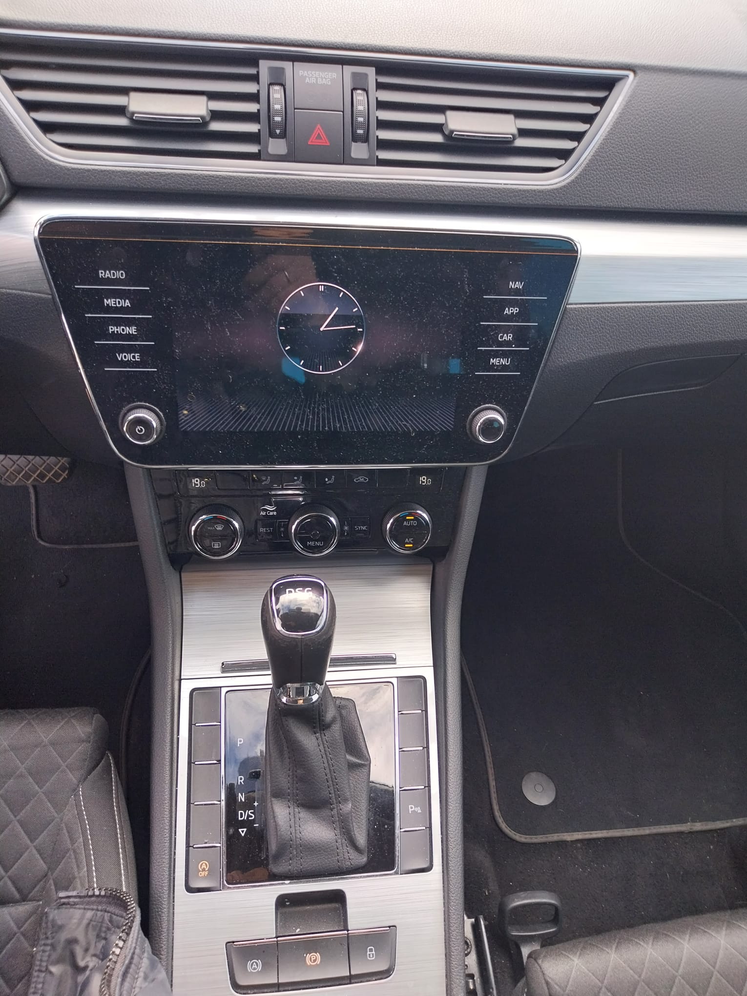

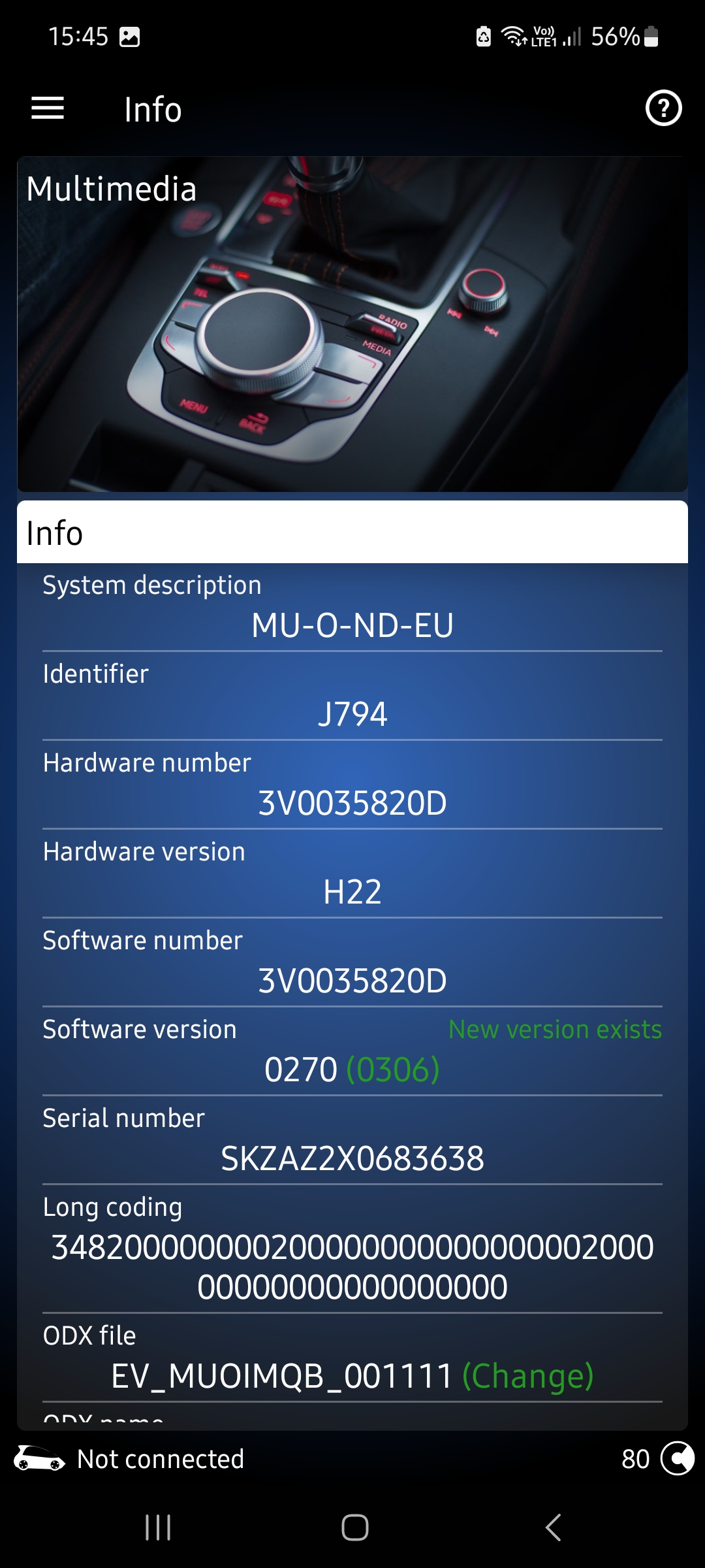

Hi, i have Skoda superb 2021, can anyone help me identify what i have, there are so many topics and names of infotainment systems that my head is spinnig already :D
My questions are:
1. what system i have ? Amundsen ?
2. Is there software updates for this model ?

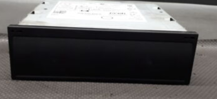

3. Last picture, black box :D what mib is it ? is it any good? it doesn't have sd or dvd, the only option to update my system is via USB or usb-c port.
4. what better mib system would be if i wanted to upgrade ?
My questions are:
1. Not sure, other than it's MIB3
2. Yes your diagnostic SW is correct, version 0306 is available
3. Not enough detail
4. Could be expensive to swap for little benefit (and the infotainment system is tied into other car systems)
So you could update SW, but do so at own risk.

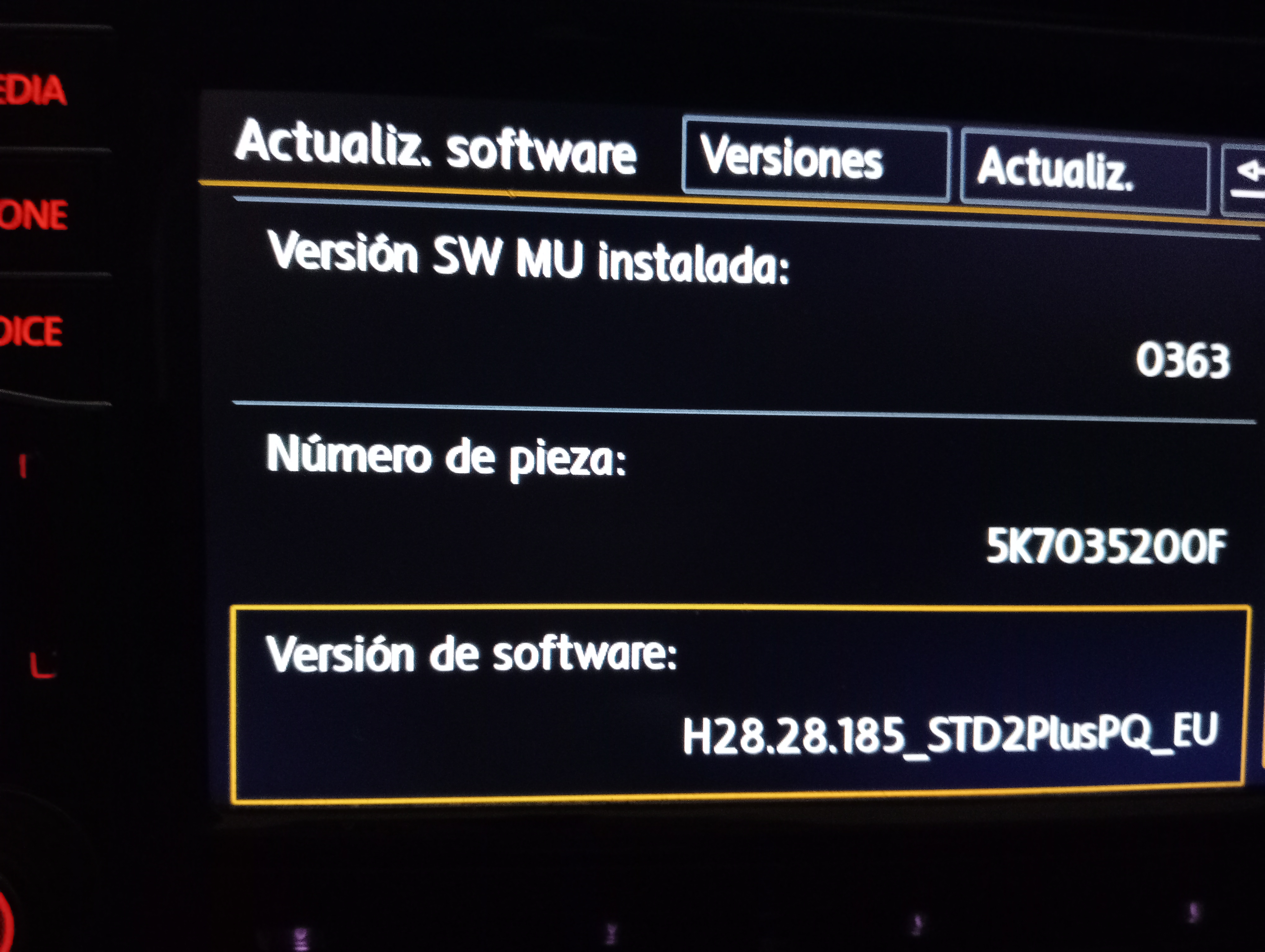

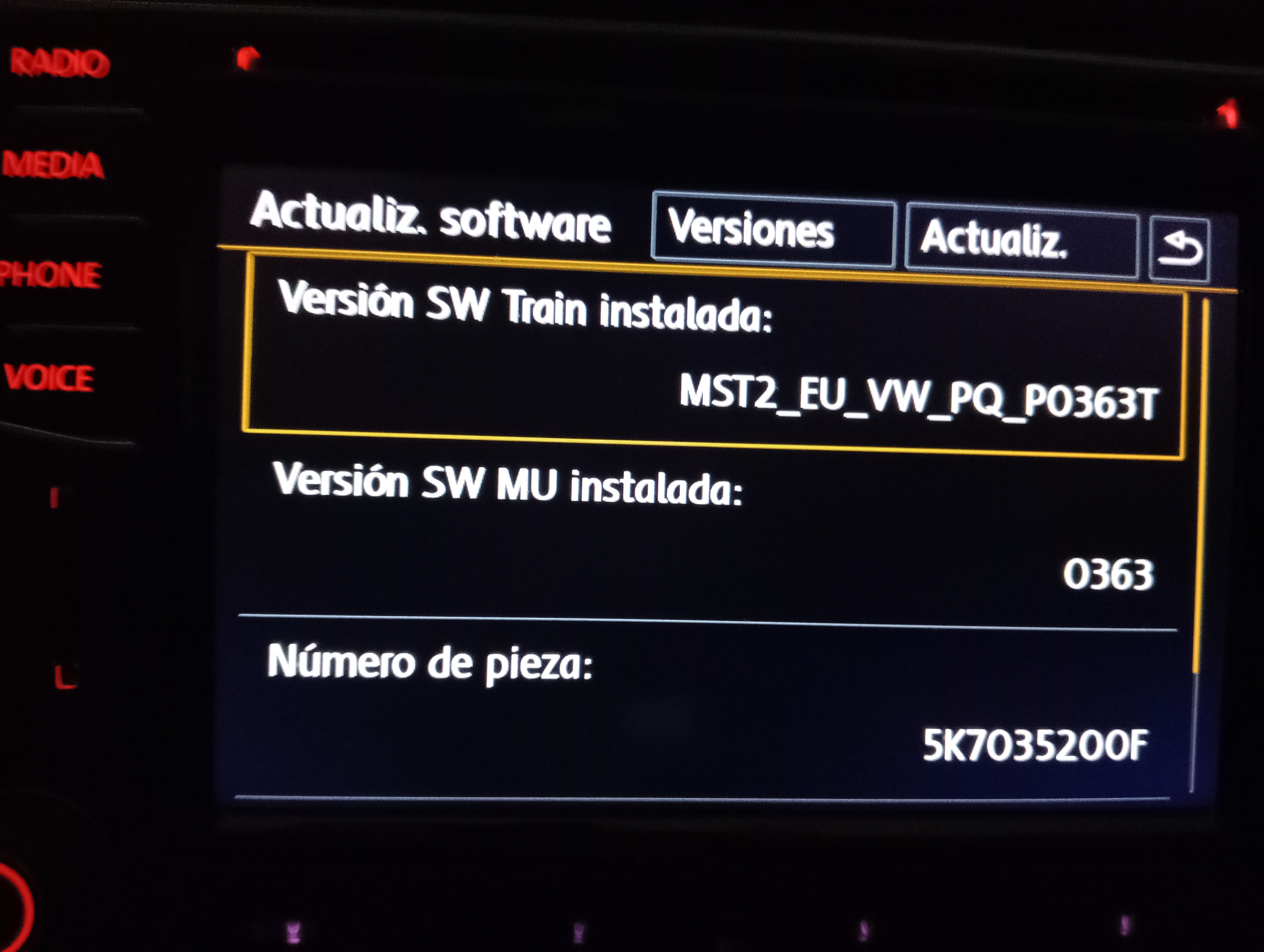

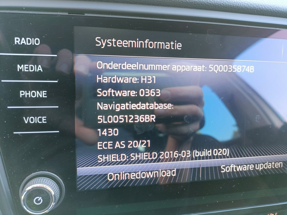

There would be an update for:
MST2_EU_VW_PQ_P0363T
Part 5K7035200F
Software H28.28.185_STD2PlusPQ_EU
The screen does not respond and I have to restart it..
Thank you

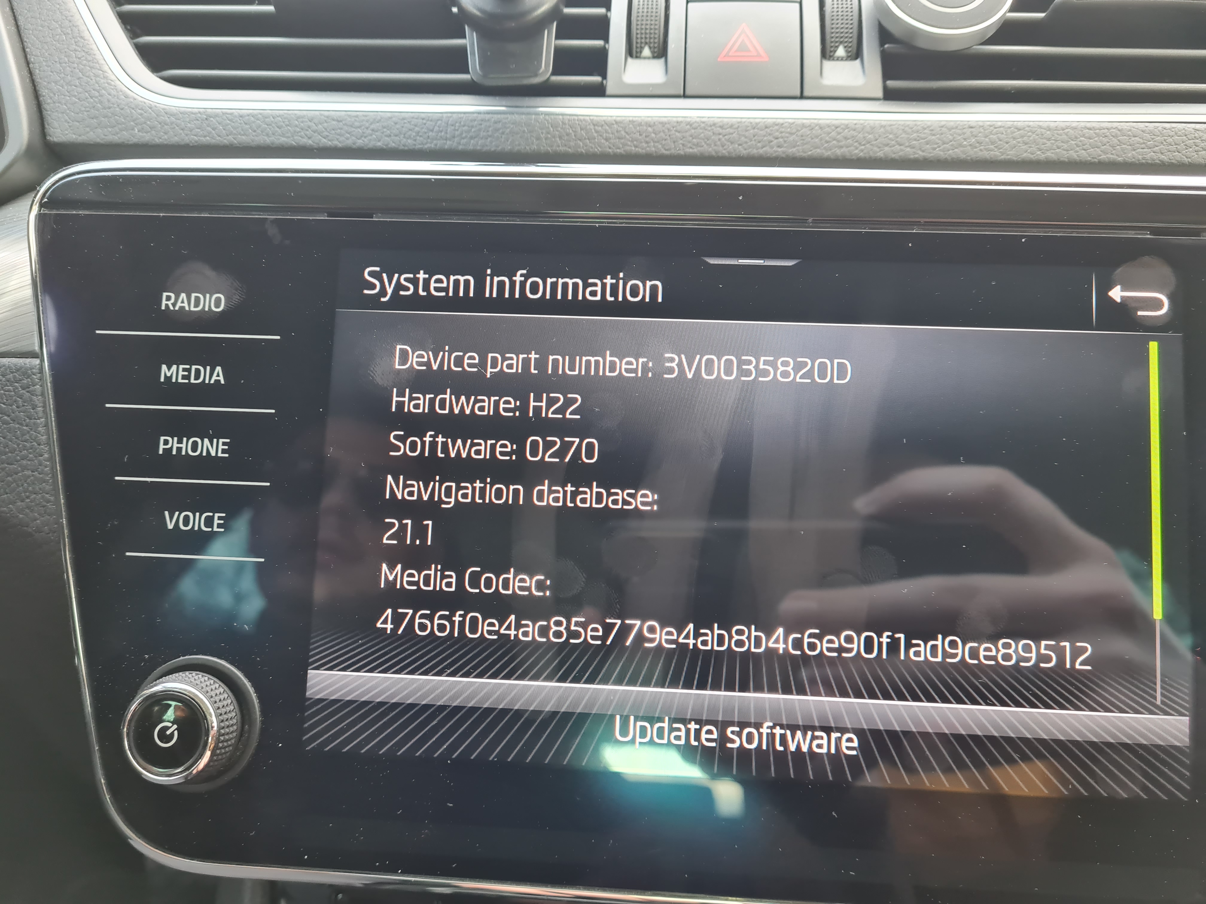

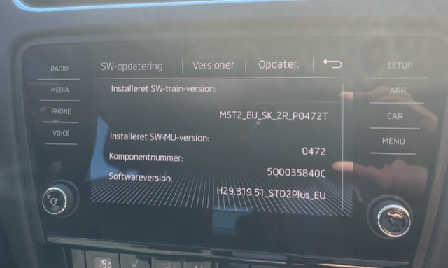

Found info screen of my system, could i update it? If yes, help would be appreciated :)
On 17/04/2023 at 08:43, Tautwydas said:
This screen you posted the other day is the one you need to provide, and it is also the page where you make the update.

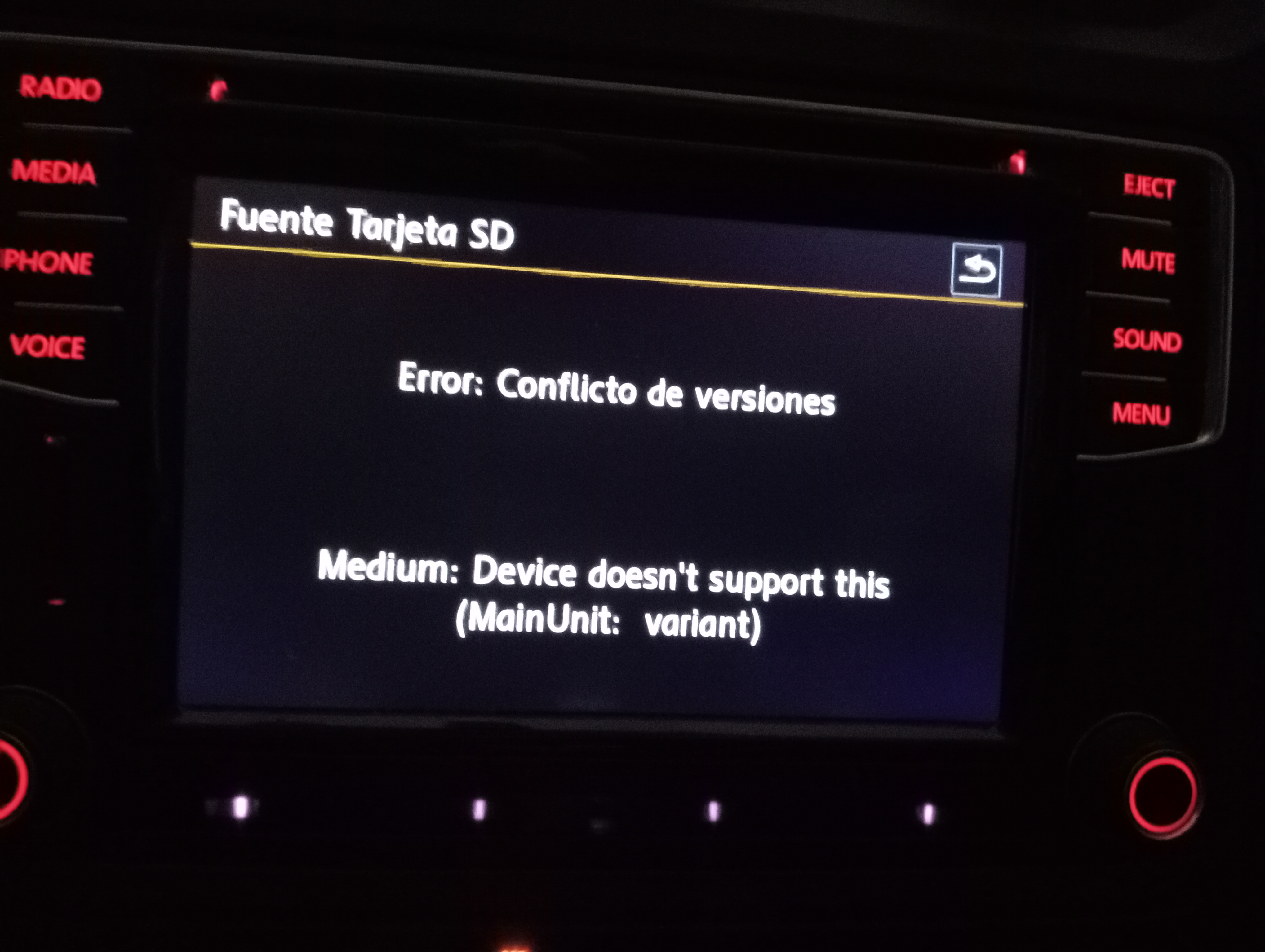

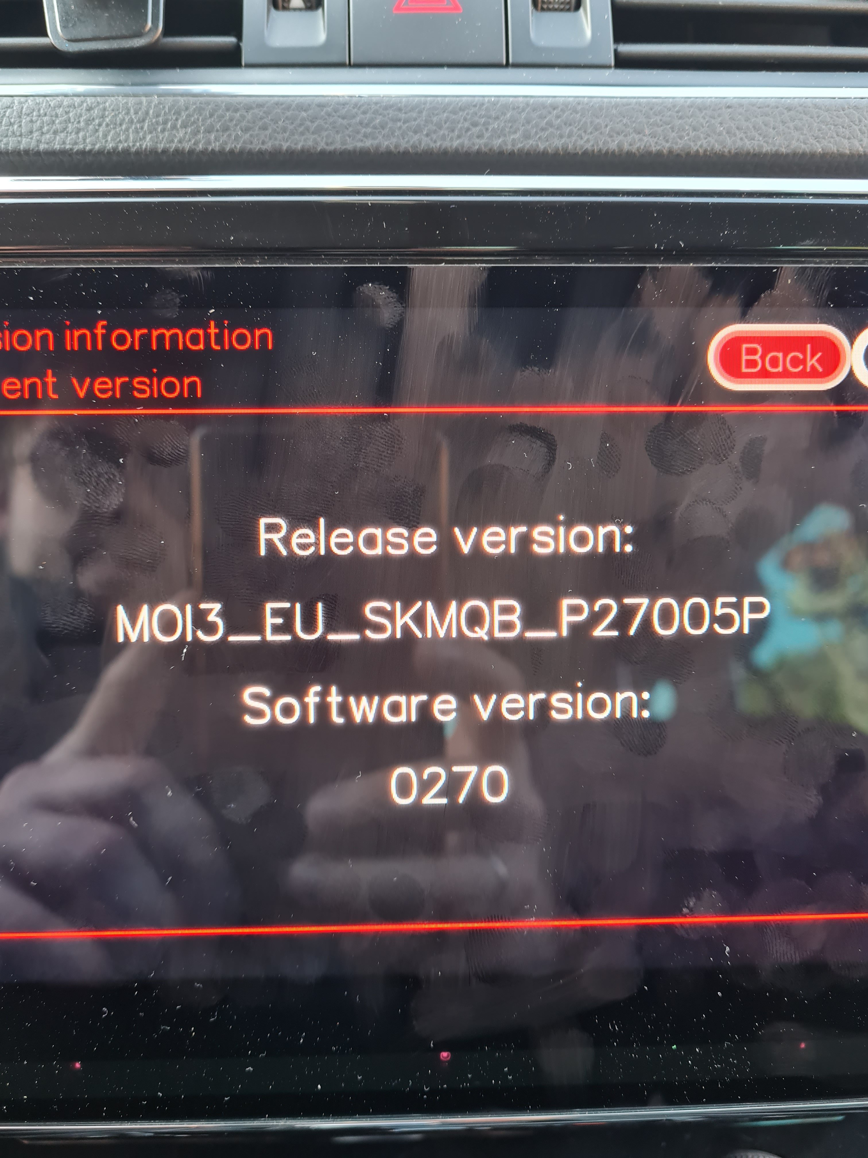

Thanks for sending the file, but it doesn't work on my Caddy.
I'll give you some screenshots:
All the best
All the best
Let me check collection, you have a PQ SW Train.

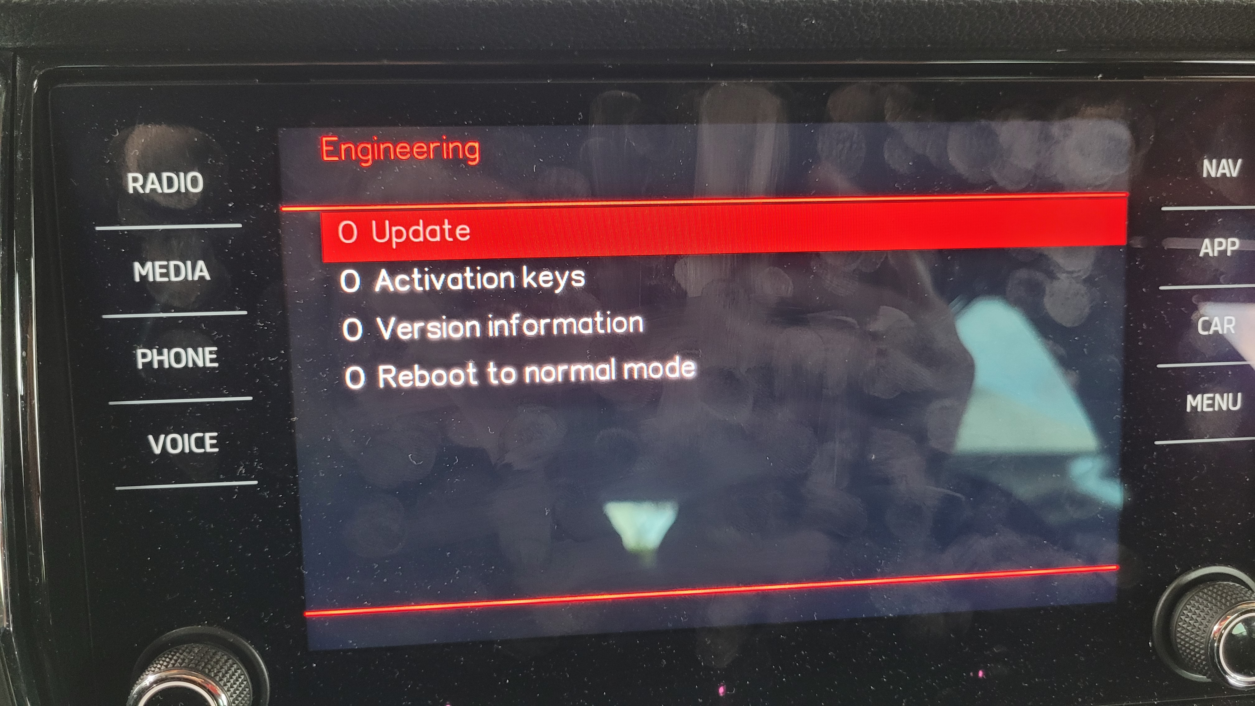

okay, been away for a while. since i don't want to fuss around with firmware i tried to update navigation maps. since there is no option to update within settings i tried with pressing menu for 10 seconds and then selecting update...i was on internet normally (hotspot). and then it just went to this  menu...is this normal (i can only choose reboot since all other commands are not responding...).
and...sorry, i think i am using mib3 amudsen (you can transfer my question to other topic)
Engineering mode is for firmware updates mostly.
So you need to either place map files extracted to USB and wait.... or get online connection subscription.
oh, so this is normal procedure then? ok, i'll put the usb drive in and try.
Good luck, if it updates the map, return to thread to let us know.  It might take a few hours of driving for it to load new map data if it does at all.

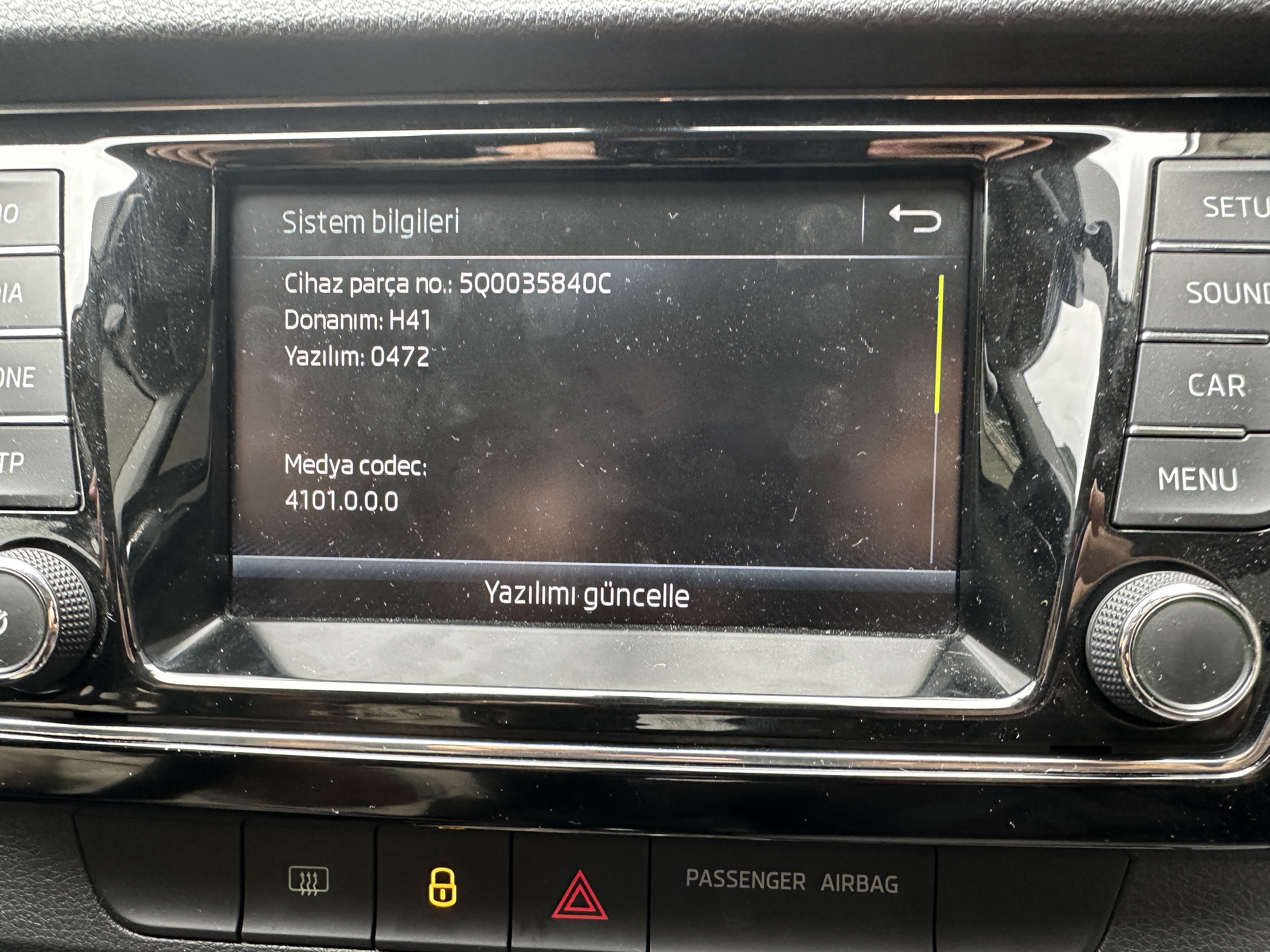

 Dear @varooomcould you please also share the latest SW-train to me. Currently I am on MST2_EU_SK_ZR_P0472T
Thx in advance!
Thx in advance!
You have mail, good luck with update

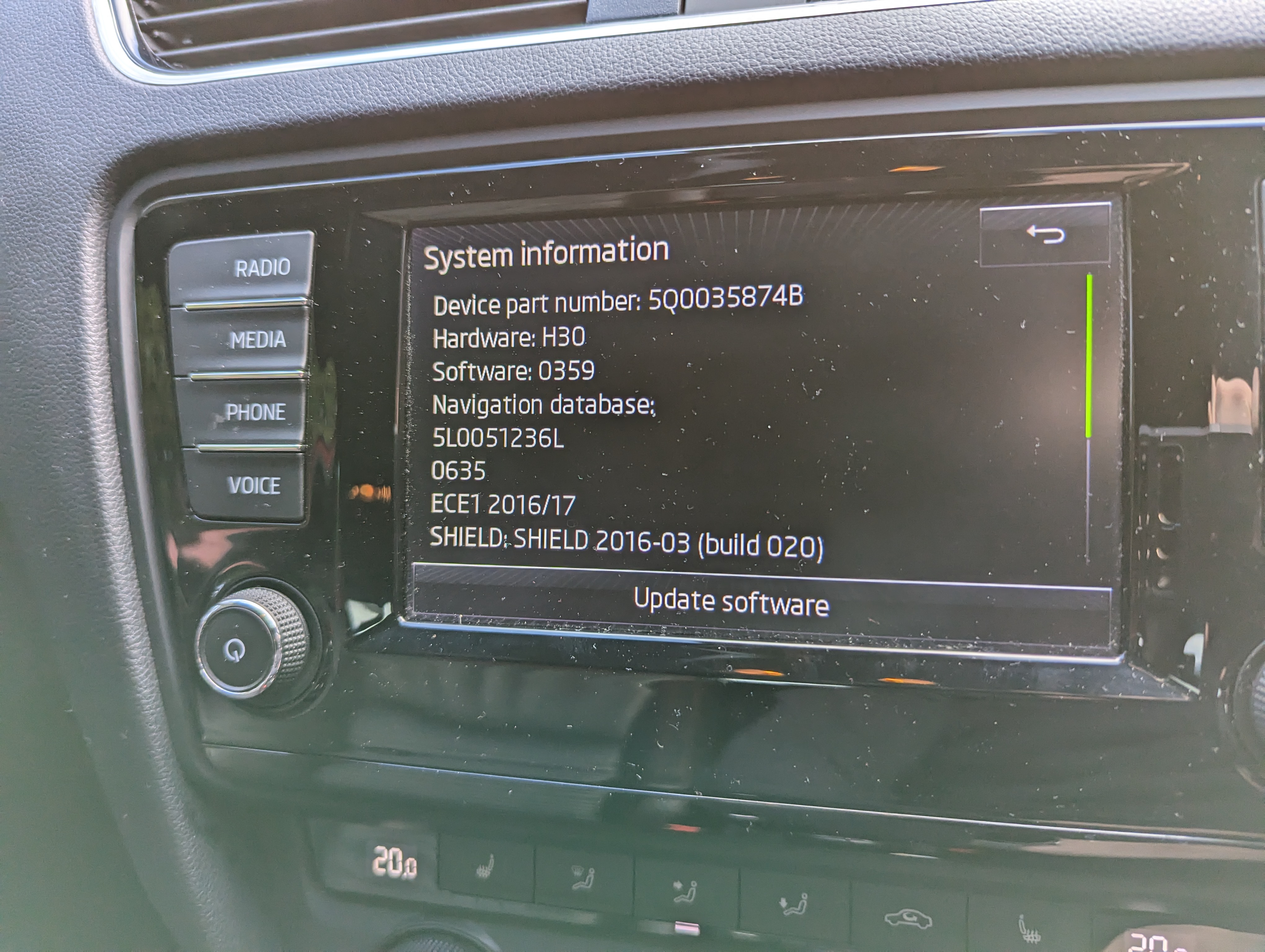

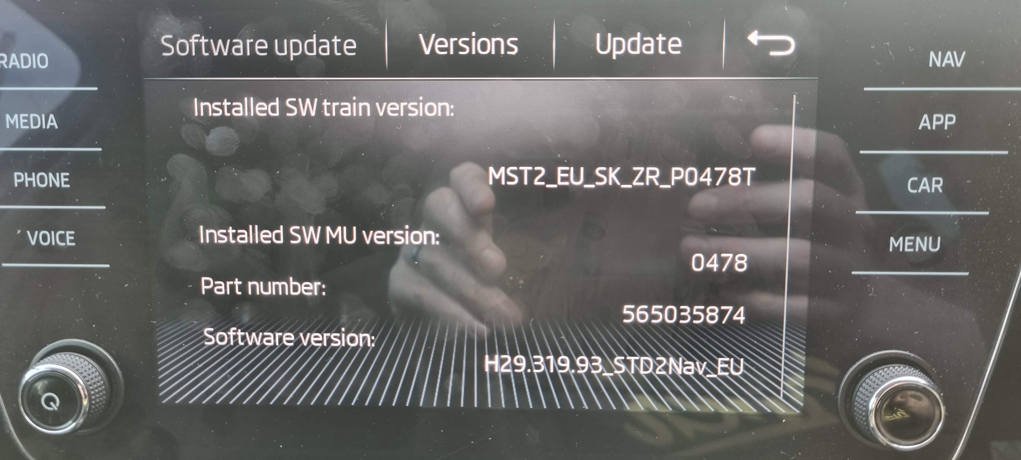

Can I just check if there's an update I can apply here?  Version seems old to me. Ignore the dust. :D
Thanks!
