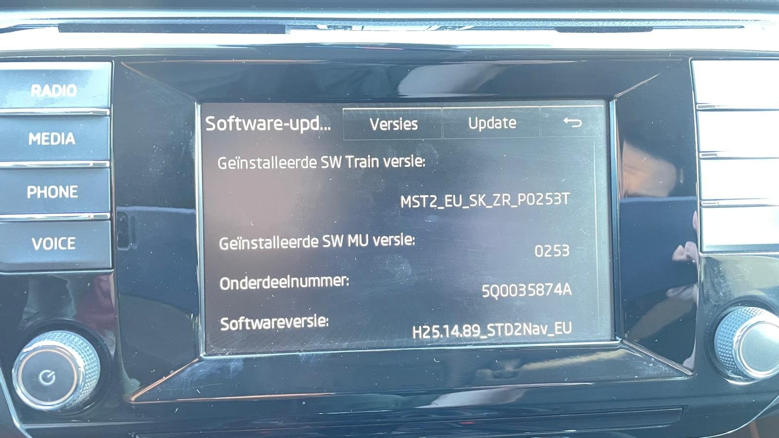

Hello, I want to give my Superb with MIB2 5Q0035874A a small upgrade. I bought a screen 8 inch screen 3V0919606 (i am still waiting for delivery).
I would also like to give my software MST2_EU_SK_ZR_PO253T an update. I read that I could update to MST2_EU_SK_ZR_PO480T. Now I would also like to know if it is possible to downgrade if the new layout is not my thing or can someone provide me with photos or a video of the new layout?
Thanks in advance for the tips and advice.
That would be going between SOP2.x and SOP4.x and this is not approved as an upgrade path (although others here will say you can, its not an approved path of upgrade)

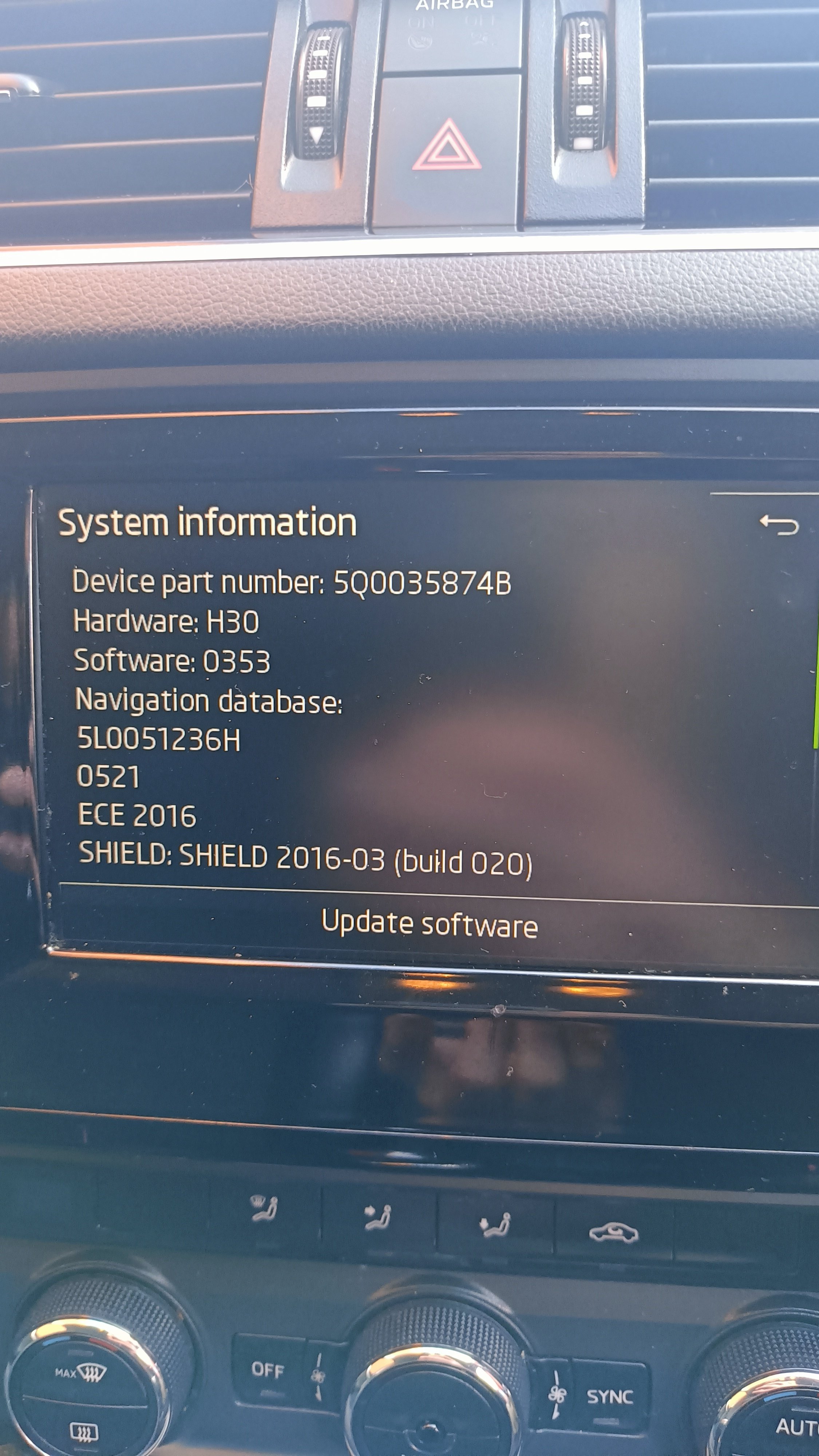

  1. Activating smart link and using android auto?
  2. Upgrading the whole infotainment?
  3. Advantages of just upgrading the sw?
  4. What do you think about those android replacements? I guess I lose many of the car integrated functionalities?
In the end what I'd really want is to be able to use android auto.
Thank you so much, sorry for the many questions
