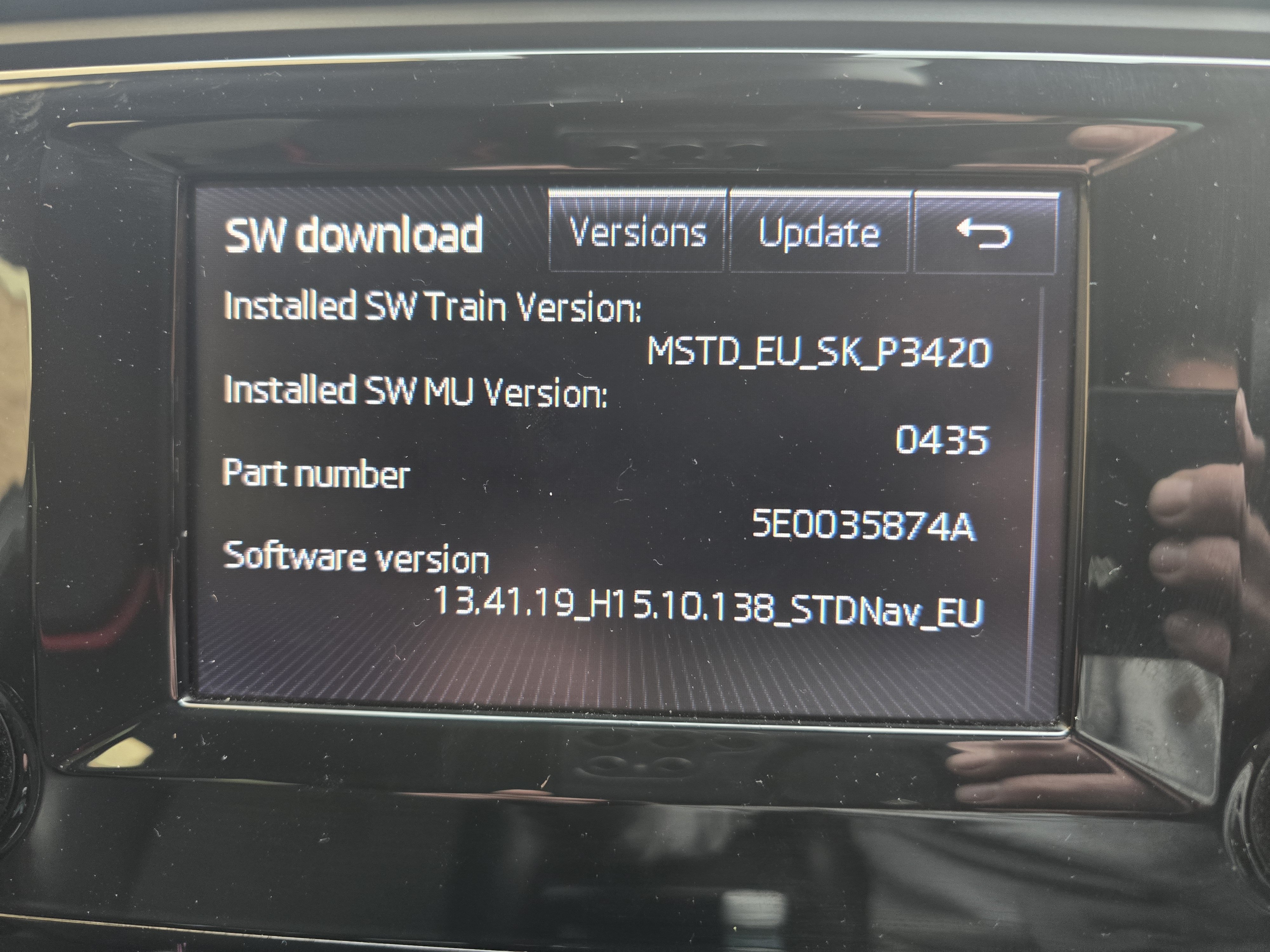

Hi all,
I had a 2008 Vrs estate about 10 years ago and always missed it. Today I picked up a 2016 Vrs Estate and loving it.
I have to reaquaint myself with the infotainment system but I've got an Amundsen unit.
Maps need updating as I think they're the original maps but the unit needs an update.
This is the current install and I understand I'd need the 6230 update?
Also I'm not sure whether this unit is capable of having MirrorLink/Android Auto switched on on it?
Thanks in advance.... And yay... Happy New (to me) car day

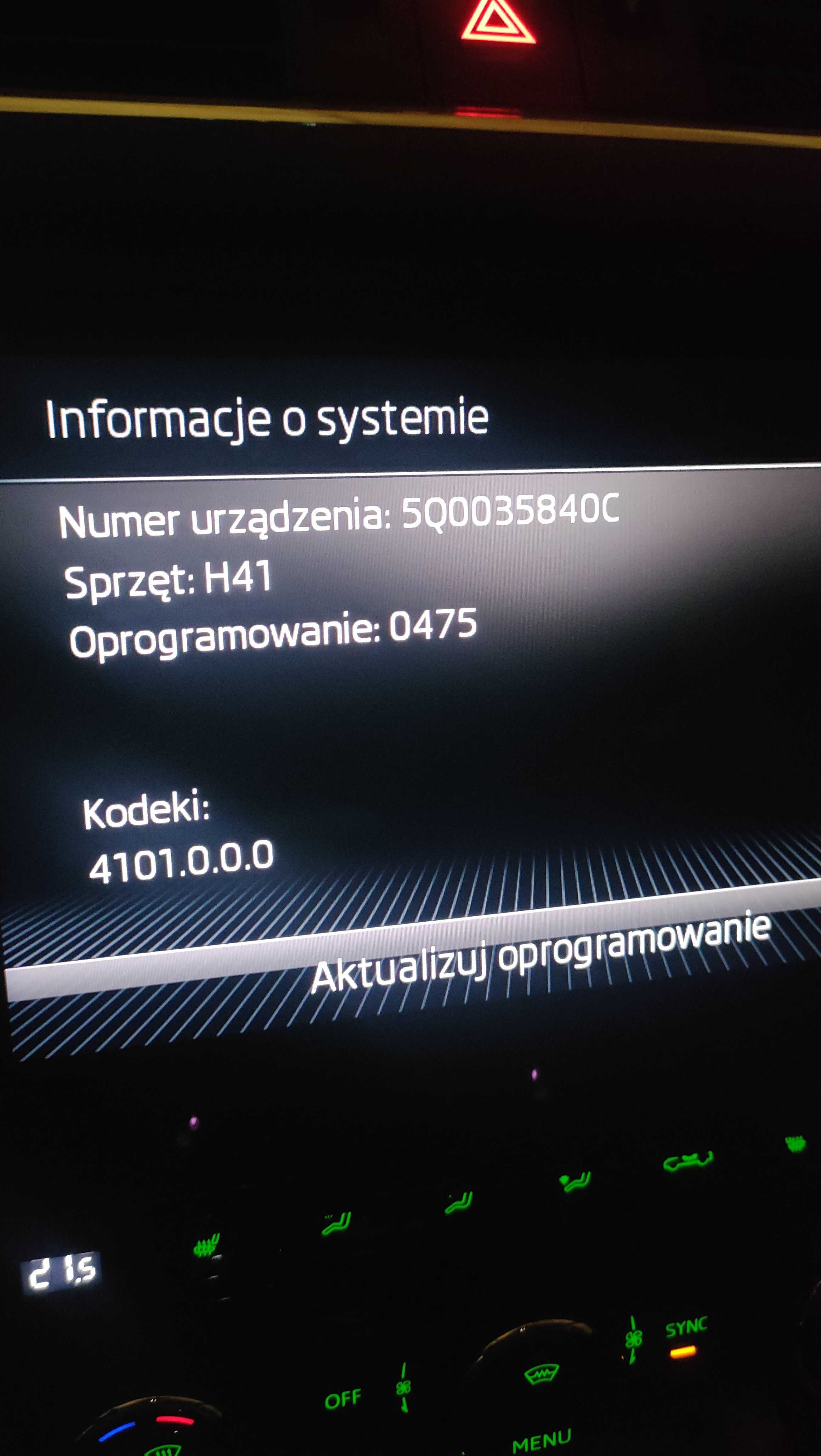

Hi, are there any updates for my brand "new" Octavia? (I am new to the forum so I cannot send PMs until I get 20 posts or sth).

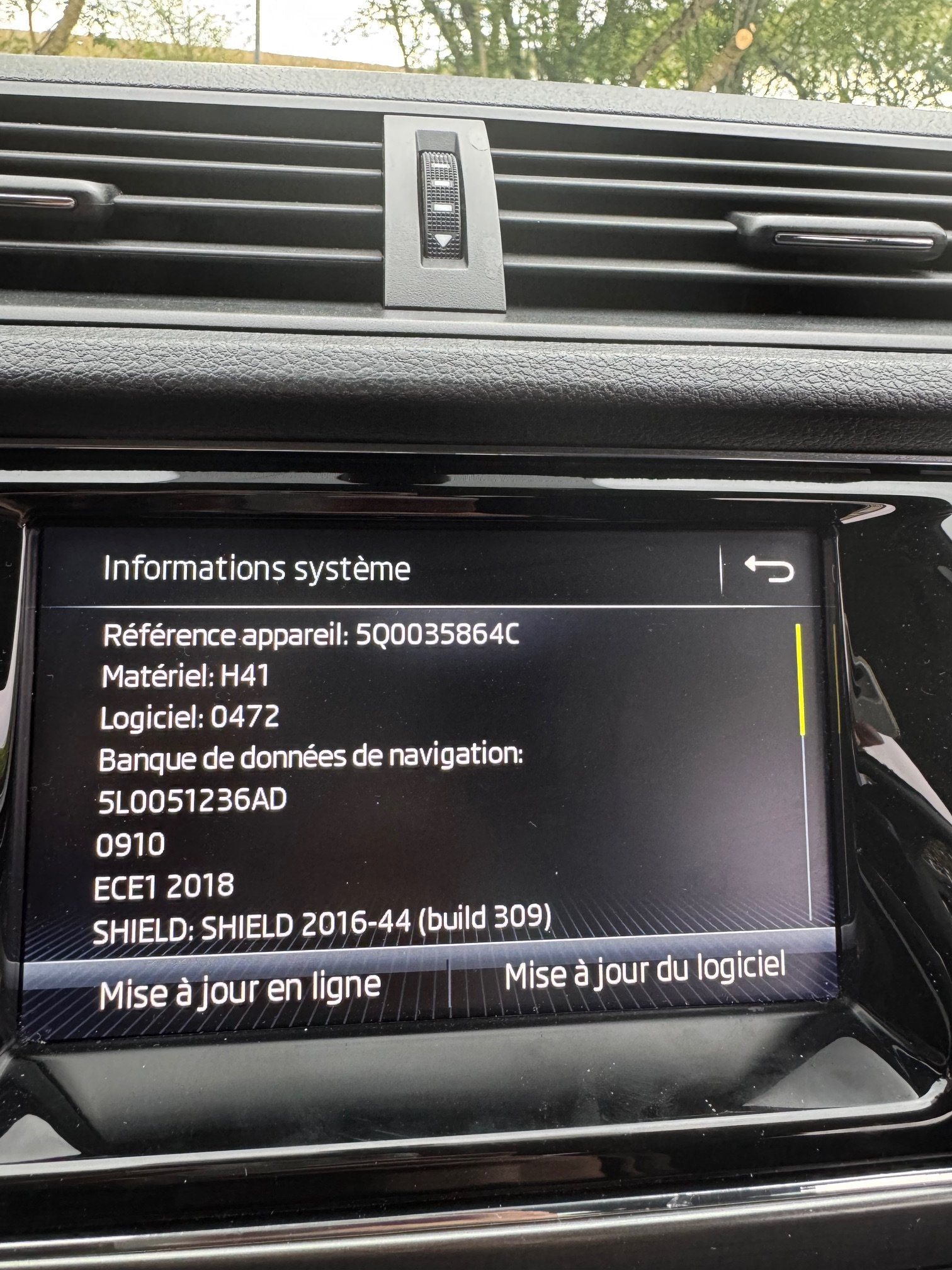

Can anyone send me link for Skoda Fabia 2018 (FR) latest update please ?
Hardware 041 (ref : 5Q0035864C)
And just update me a little bit please, my previous car was an old VW (2011), with just firmware update to proceed sometimes.
It seems, that now, we need more than just update firmware ? Or does this update include everything (except maps) ? Any issues with this update ?
Thanks for all guys ans take care

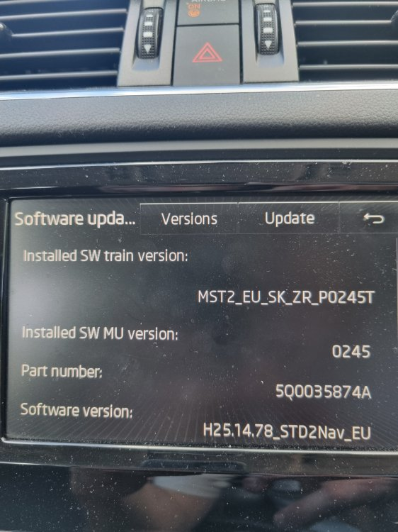

@pab567 , would you be so kind as to find out where i could possibly download the latest firmware update for my MIB2 unit please? please see below pic of current firmware in my Occy mk3
If you could help me that would be greatly appreciated! many thanks! :)

I sent you download link on PM however I hardly believe this could help you.
All check your PMs.
Pls keep in mind that IF your unit has SW patch applied then upgrading firmware will have it killed - your unit will be locked with Component Protection and activations might be lost as well.
Let me remind you upgrade procedure:
1. format SD (best max 32GB) under FAT32
2. unpack to root (metainfo2.txt and all the folders must be placed directly on SD, not in any folder)
3. insert SD card into the slot
4. enter Service Menu (long press MENU button)
