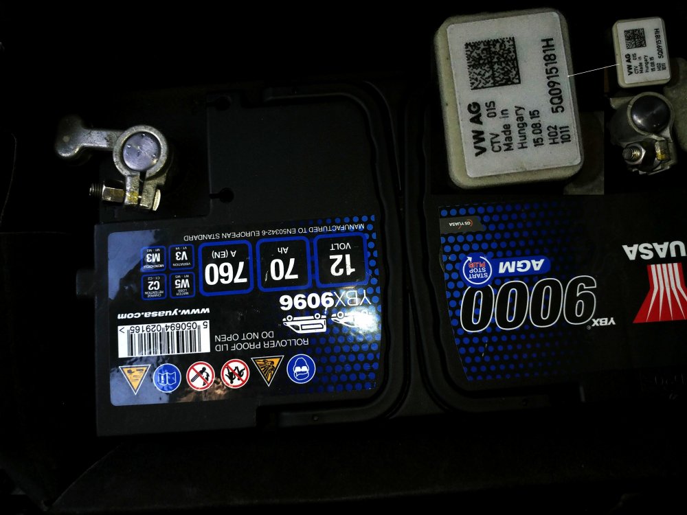

Kenny: Battery does not appear to have a BEM number
Supposed to be a fit for VW battert
Have you tried scanning the QR code on the new battery for BEM information.
Thanks AG Falco
Good thought. Bit of a challenge as well as it is barely the size of a stamp.
Anyway the answer is not. It interprets as a string of meaningless (to me) characters as follows
3#5Q0915181H #HH02S1011#401142351#150815*DTH74185704001508155161*=
