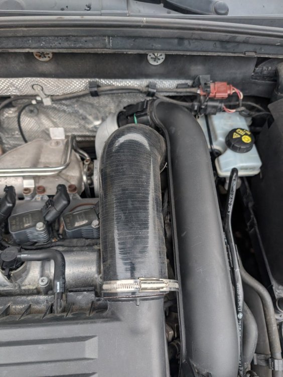

    Little update with my build, I folded and ordered an rtmg turbo and carbon intake. I fitted the turbo last week and tomorrow I'm taking a trip back to my tuner to get a cuatom map for it. Was at 183bh
  • Everything working perfect, your post on how to do it helped massive amounts. Had a little coolant leak after I fitted it but soon fixed that. Topped it up with water going to get some coolant in the

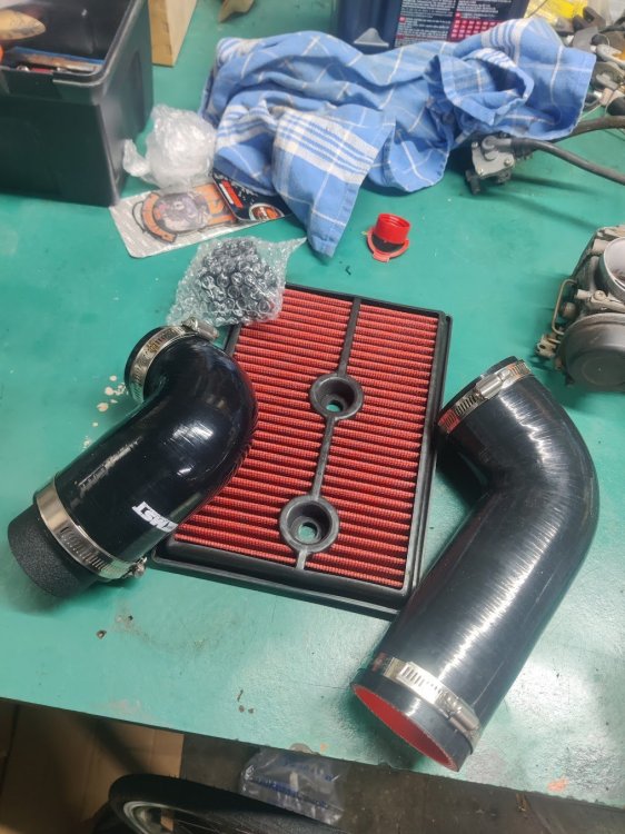

An intake upgrade does make the factory blow off sound much nicer. Don't bother with the forge blow off thing i think it sounds cheap and awful. Get the MST turbo elbow (MST-VW-MK708) and the MST intake kit (MST-VW-MK706L)
Together they replace all the pipework from the filter to the turbo. There's no gains to be had by doing anything with the forge dump valve rubbish.

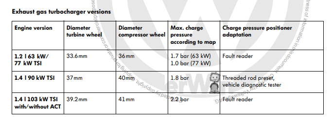

I found this in a pdf about the ea211 engine.
It seems like the 1.4 120hp engines do have a slightly larger turbo than the 1.2. I thought they were the same
RTMG use the smaller 1.4 turbo for their hybrid. I've still got my original 1.2 turbo. I'd be interested in having it upgraded if the cost is reasonable. JBS don't do a stand alone turbo exchange (their package includes fitting and a map) and I don't have the turbo RTMG use for theirs. So I'm a bit in no man's land.

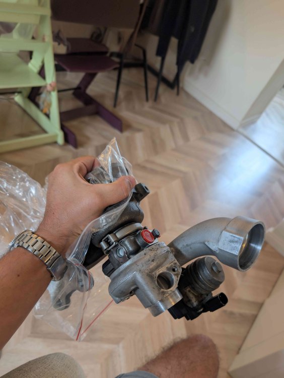

It's arrived. It doesn't look to bad. Getting the old one out is a pain. The repair manual says to drop the subframe. I'm going to cut it in half tomorrow. I should be able to get it out in two pieces

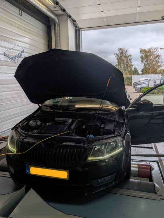

Got a dyno run booked at the end of the month, will post the results

My dyno run is booked for 11th

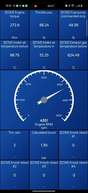

181bhp on 99 octane.
I recently ran short and had to put a little bit of BP 95 to get by, out of curiosity i watched timing pull from knock and it was pulling 10-11 degrees of timing on 95 octane, on 99 only 3-4 degrees which is normal. It definitely felt sluggish and boost came on slower.
BP 97 octane had pulls of between 6-7 degrees, and didn't have the same slow boost buildup, but it lacked power in the top end, struggling to get to redline in 4th, with 99 it can reach the rev limiter (136mph @6500 rpm ish) in 4th.
