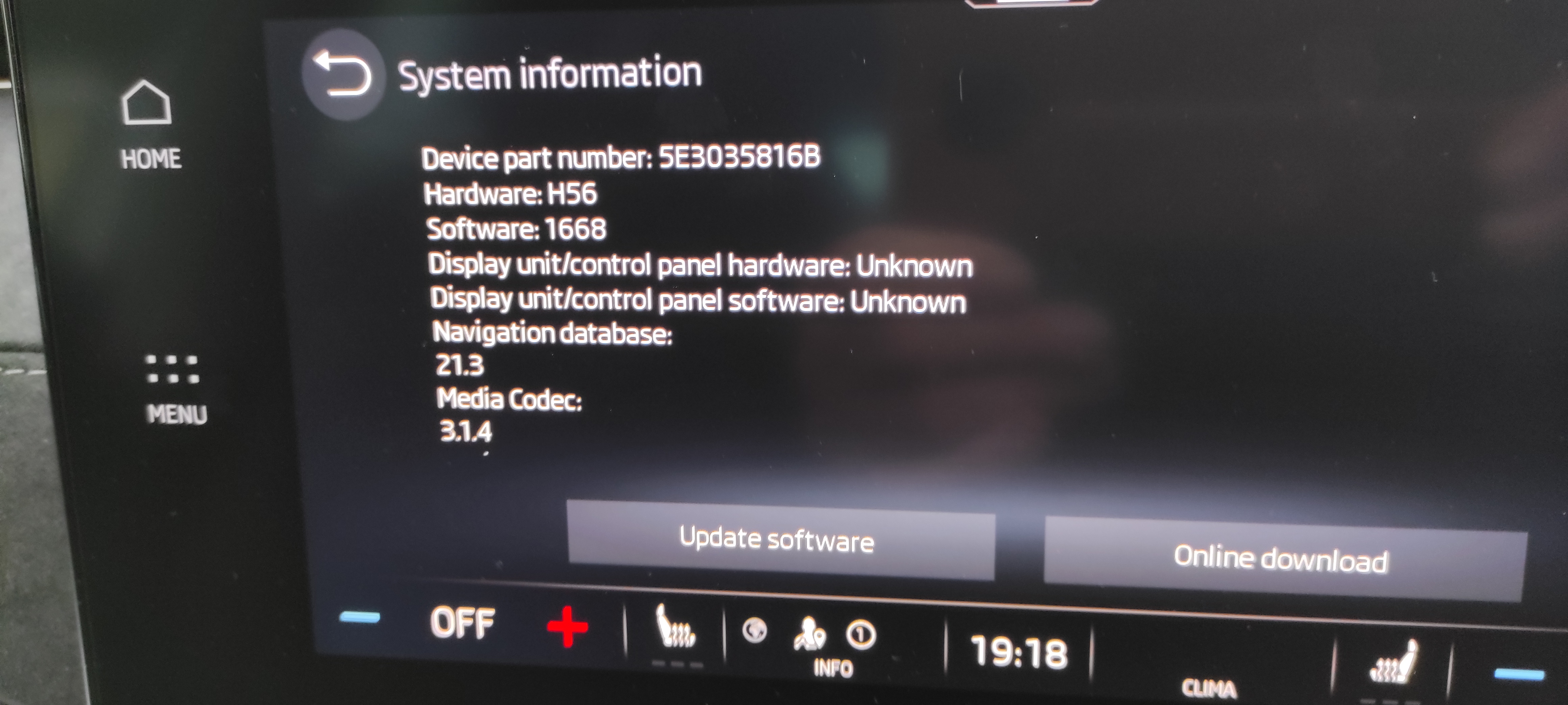

Thanks. I'm uncertain whether it's a 1st edition or not. I only purchased it at the end of last month but I think it was part of a batch the dealer had. I'm also uncertain how to identify the build date. All advice appreciated.
  Key things to look for are the higher spec (electric drivers seat and the blind spot) over the standard SEL.
also check your system information and your device part number.  If there is no letter at the end of the number on the first line, then you’ve got one of the early builds that seem to have the major issues.  Other giveaways are the inability to change the Speedo units from mph to kmh.  And the satnav units as km.
hope that helps.
Thanks. I have the electric driver's seat & the blind spot, but, interestingly, the later(?) device part number listed below. Frustratingly, the software & hardware associated with the control panel is simply listed as "unknown".

It does look like you have a first edition model with a later build.  Does it have the ability to change the Speedo units?  That seems to have been the trigger for Skoda UK to do something about or at least take it seriously.
My SEL first edition showed the same unknown for the same line items and recently the Replacement VRS I was offered by the dealer has identical to your picture. That was built week 45.

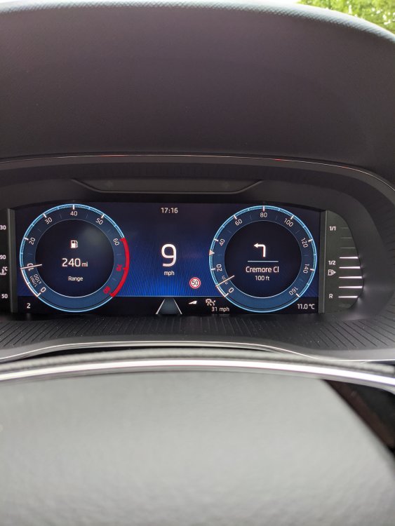

I know my car is not a UK spec, it's Irish with the Columbus D head unit and is set to imperial units.
ACC sees the KPH speed signs and converts and slows to the correct speed in mph on the virtual cockpit. The in built sat nav shows the distance in miles but I prefer using Google Maps/Android Auto which thankfully show directions in the virtual cockpit which can be seen in the attached picture.

Thanks. Fortunately, I don't appear to have the kph/mph problem so my issues include: "unknown" hardware & software as per previous post; SOS warning accompanied by satnav going haywire (rebooting the system by temporarily removing fuses 19 & 30 worked); the esim is far from reliable, but difficult to establish a clear pattern; Skoda connect system rarely operational; "Laura" popping up frequently, unbidden; the car stalling twice (both on roundabouts) when in gear & under load (manual box); intermittent operation of stop/start system; motion gestures work only occasionally; LED ambient lighting pack: uncertain whether it's present or working.

My system information shows:
Device part number: 5E3035816
Hardware: H56
Software: 1668
DU/CPH: H44
DU/CPS: 2088
ND: 21.1
MC: 3.1.4

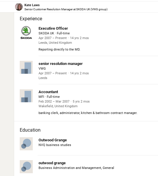

@fossman  Kate Laws NVQ in Business Studies and time with the VW Group might be very good for panning people off for long enough but hardly means her technical knowledge is any more than a Dealership Sales Executive, maybe even less.

Seems a bit harsh.
For all we know her time in VWG included a shed load of training and product familiarisation - just because it's not listed there doesn't mean it hasn't happened. I have had some very helpful and constructive conversations and I have found her experience in the business to be useful. And yes, I am a disappointed owner of a Mk4 SEL FE which has been off the road for six weeks.
