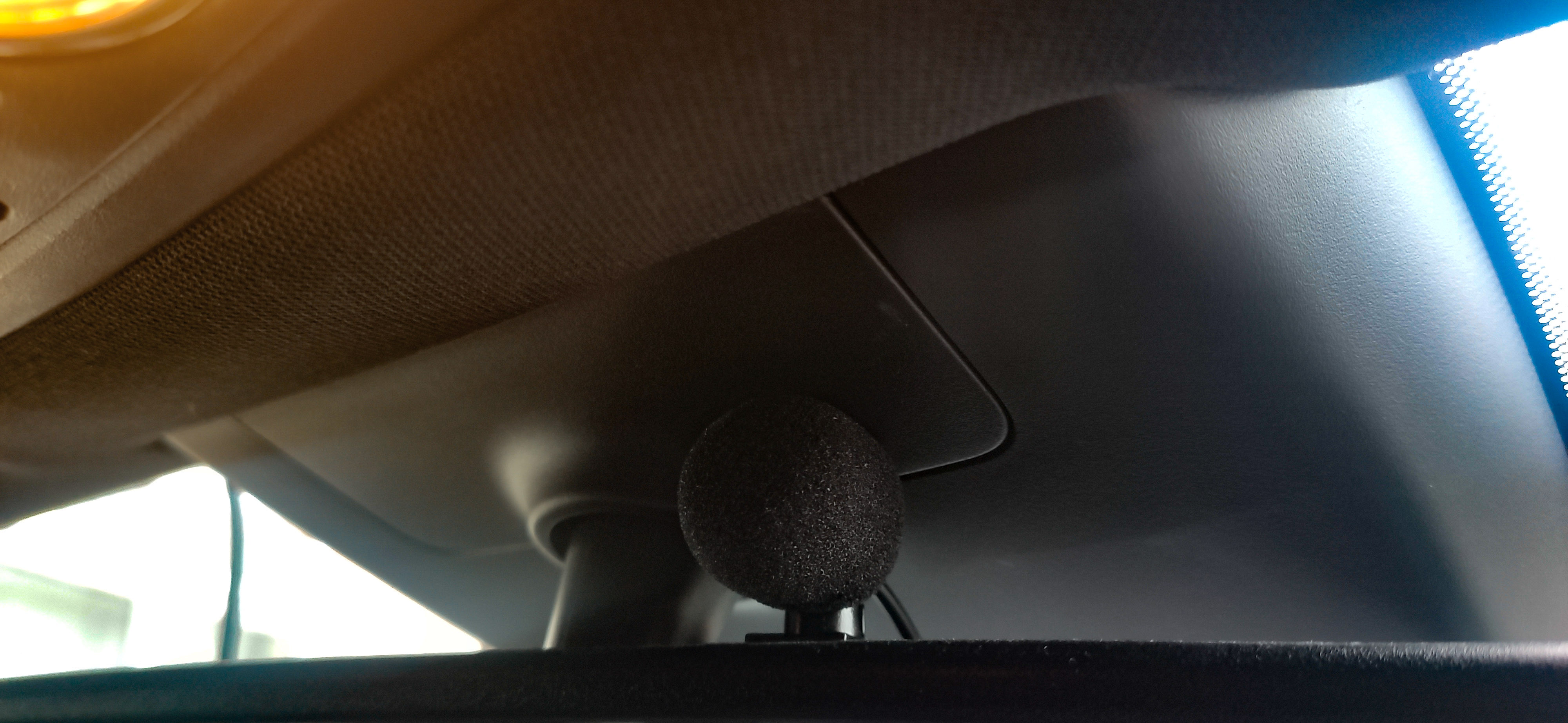

On 17/03/2021 at 14:49, FUBAR said:

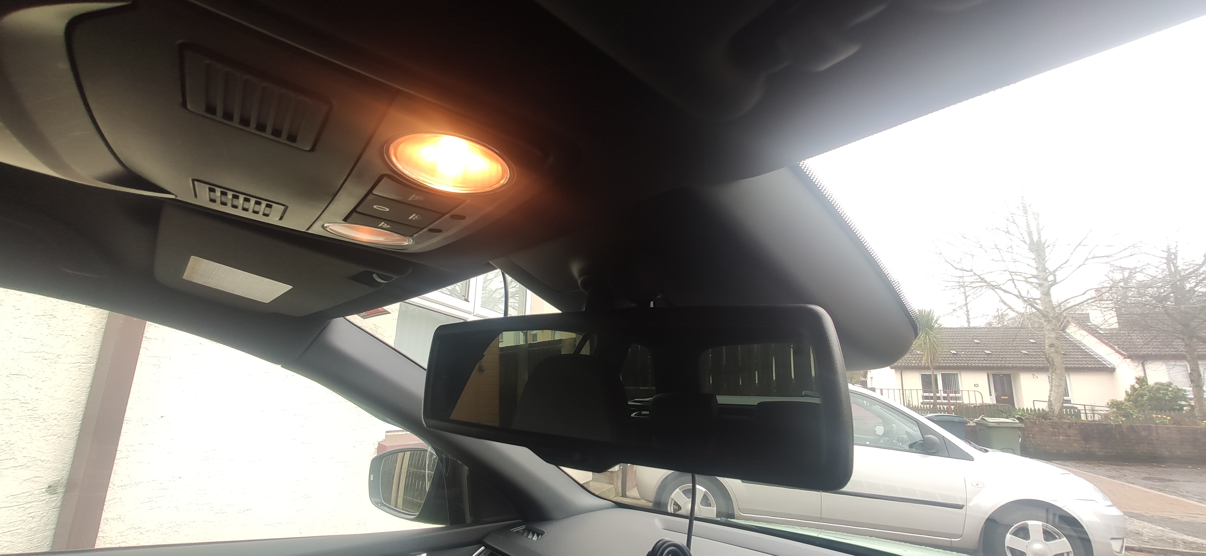

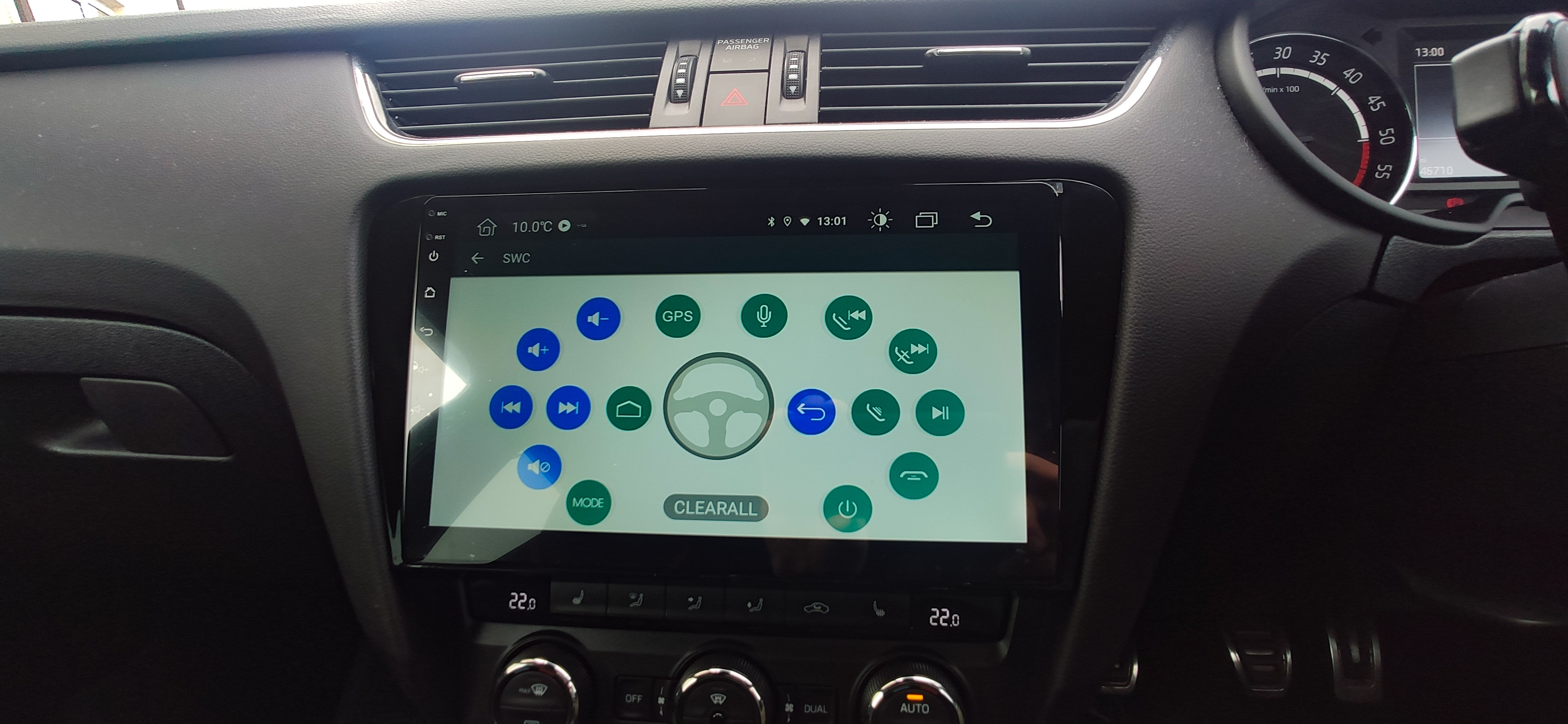

Small update as have now gone back in and put a generic external microphone in place. I opted not to put it behind the trim where factory one is as it's blanked off on driver side and didn't think it would work too well being essentially in a lunchbox (cable routed up directly into head lining behind mics boom so out of sight, across and down behind passenger pillar trim in and across etc. 3 meter cable on mic was perfect with about 20cm to spare (was slightly worried). As everything is black up top I just stuck it on its swivel mount on top of rear view mirror and it's working perfectly on test call after.
Also had a play in menus and found a big list of boot screen logos to choose from inc a Skoda one, but can also upload anything I want, so will get a newer Skoda logo I think or a vRS one or something. Then I noticed the menu for steering wheel controls and I can remap any key function to do whatever I want it to, that's pretty nifty.

13 minutes ago, Lamont1980 said:
Evening guys,
So I have come to the already discovered conclusion that the mic on the head unit is ****e.
What are the recommendations for a half decent one. All the ones I've seen are Aux, and I don't think my unit has an Aux port.
The above is what mine looked like and what I used.

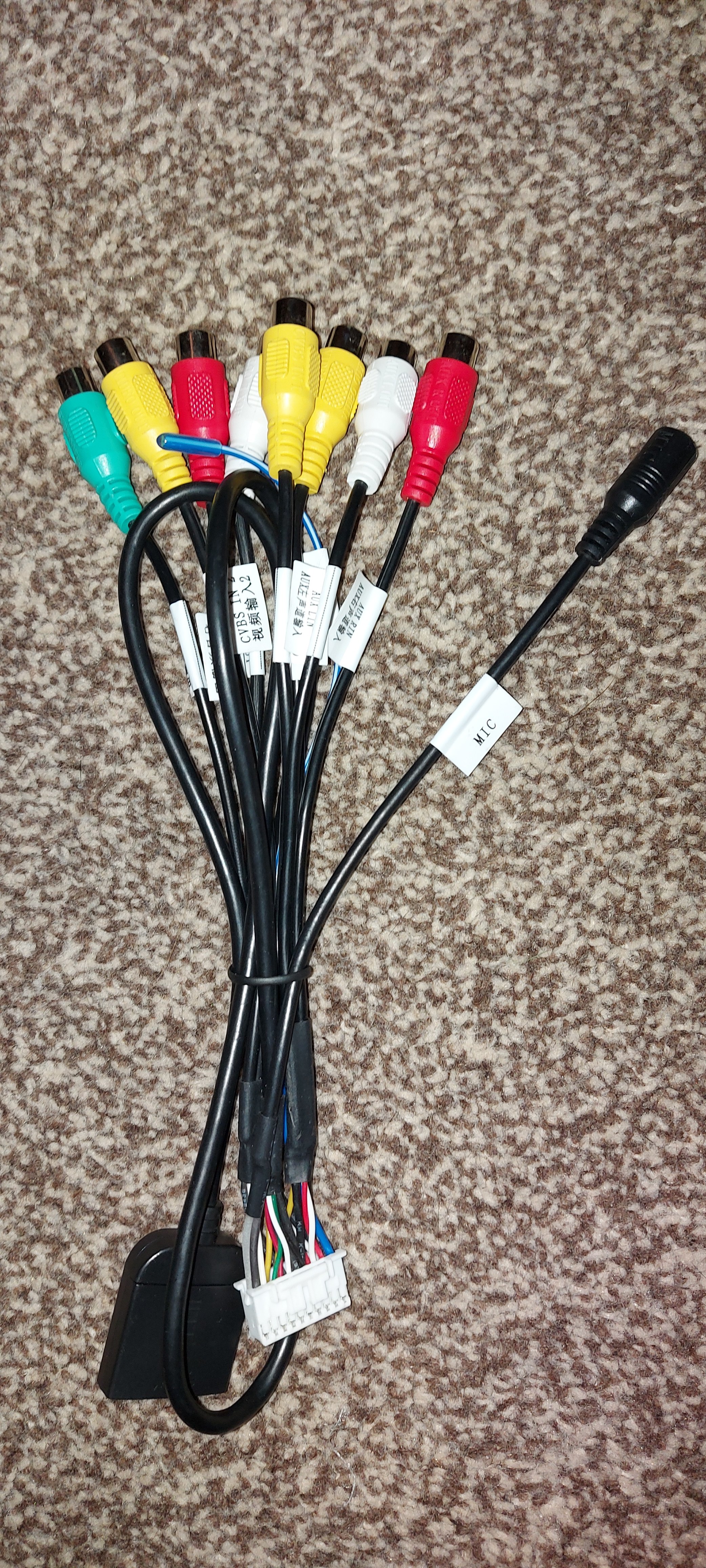

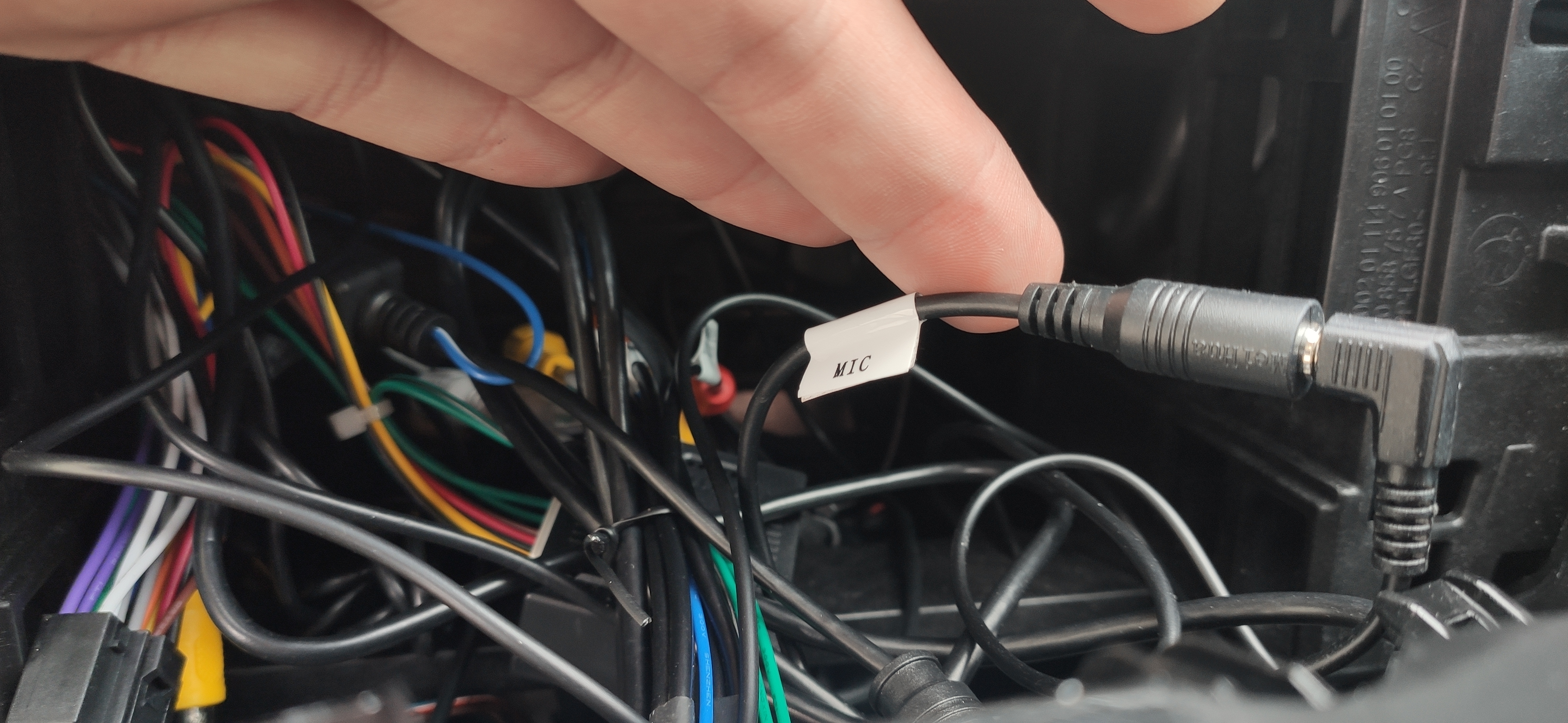

Cheers for that, I just don't get where the 3.5 jack would go into?
Did you get this lead as it has the mic jack on it that that you plug an external mic into and connects to the head unit.
I don't think I did tbh, but I'll check my glove box in the morning incase I've put them in there out of the way. They aren't in the box the stereo came in.
Would they plug into the top line of ports in the back of the head unit?

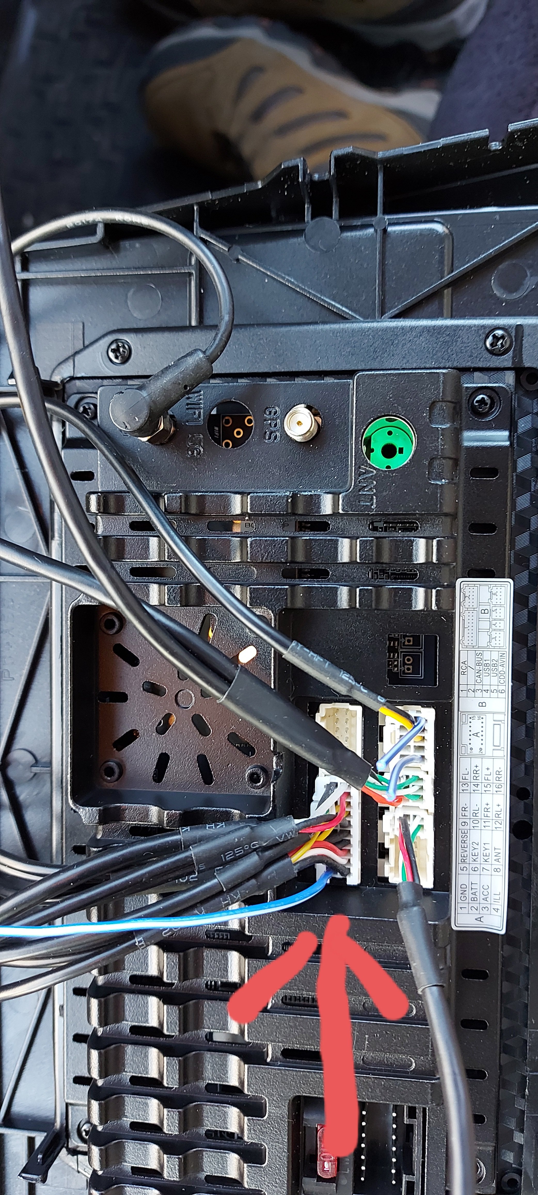

If it is the same as mine then it goes in the bottom ports
Thanks, I'll double check. I'm sure my others are in the bottom, but I might be mistaken.

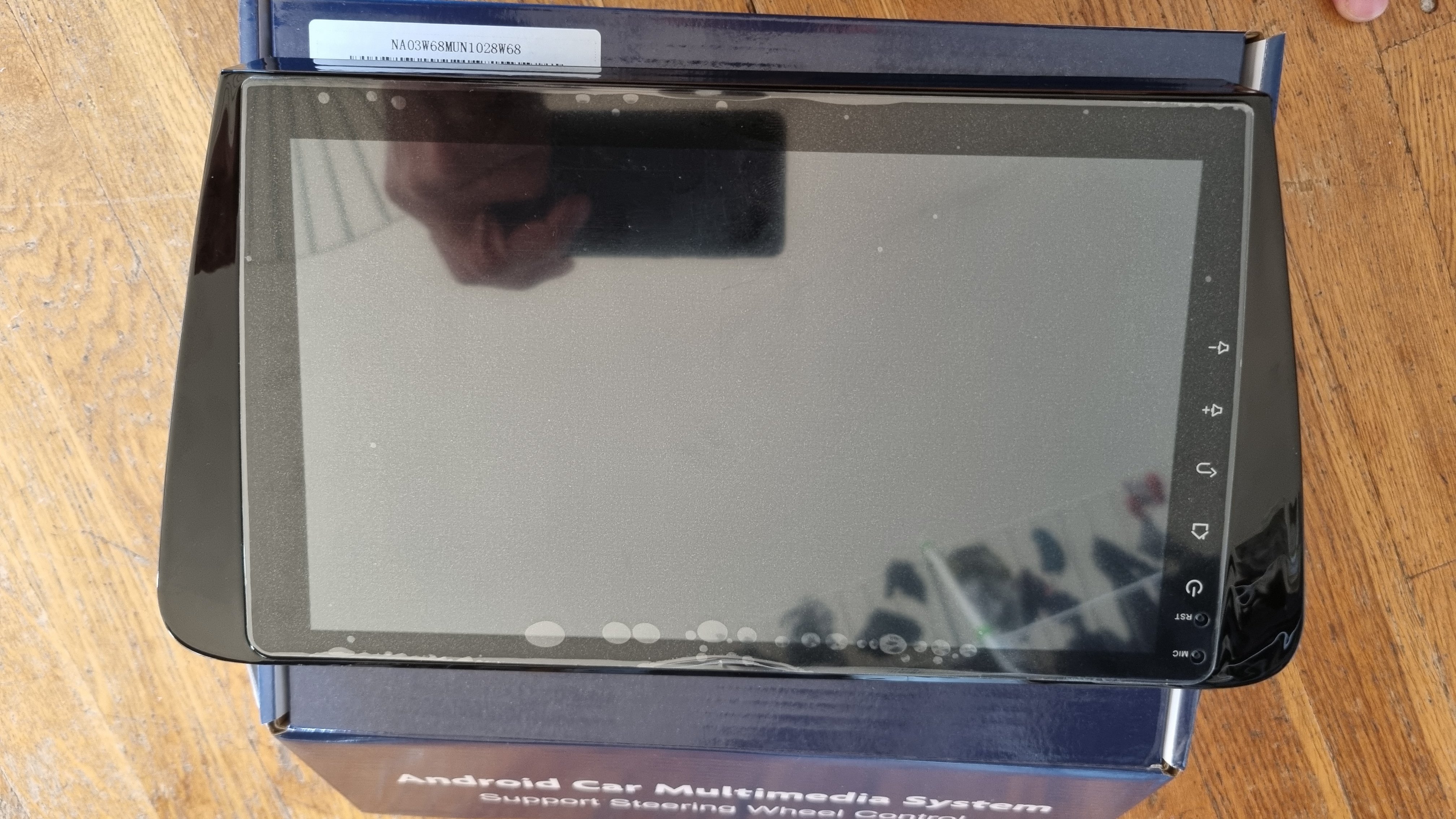

Got my unit at last.
1 it has the mic input
2 it is lacking the usb power on the harness.
I will try to install it on the we
A question though.
Once the unit is in place, how do you get it out? There is no space to insert the extraction tools and the clips are plastic

This is strange, your frame is bigger than mine. Mine is flush juste over the top if the unit.
Either my frame is too small for my car, either your unit is smaller than mine...
I must check this

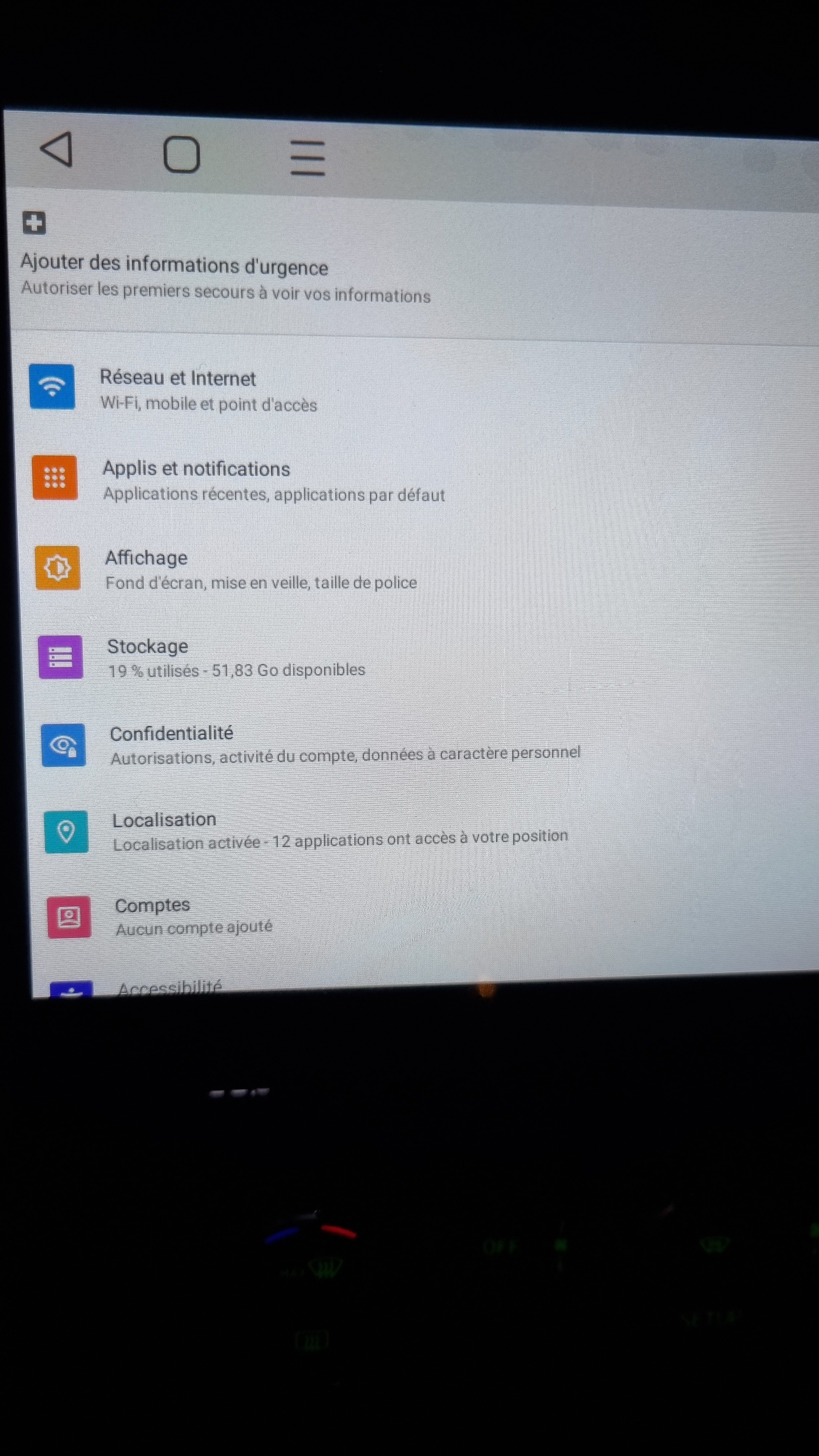

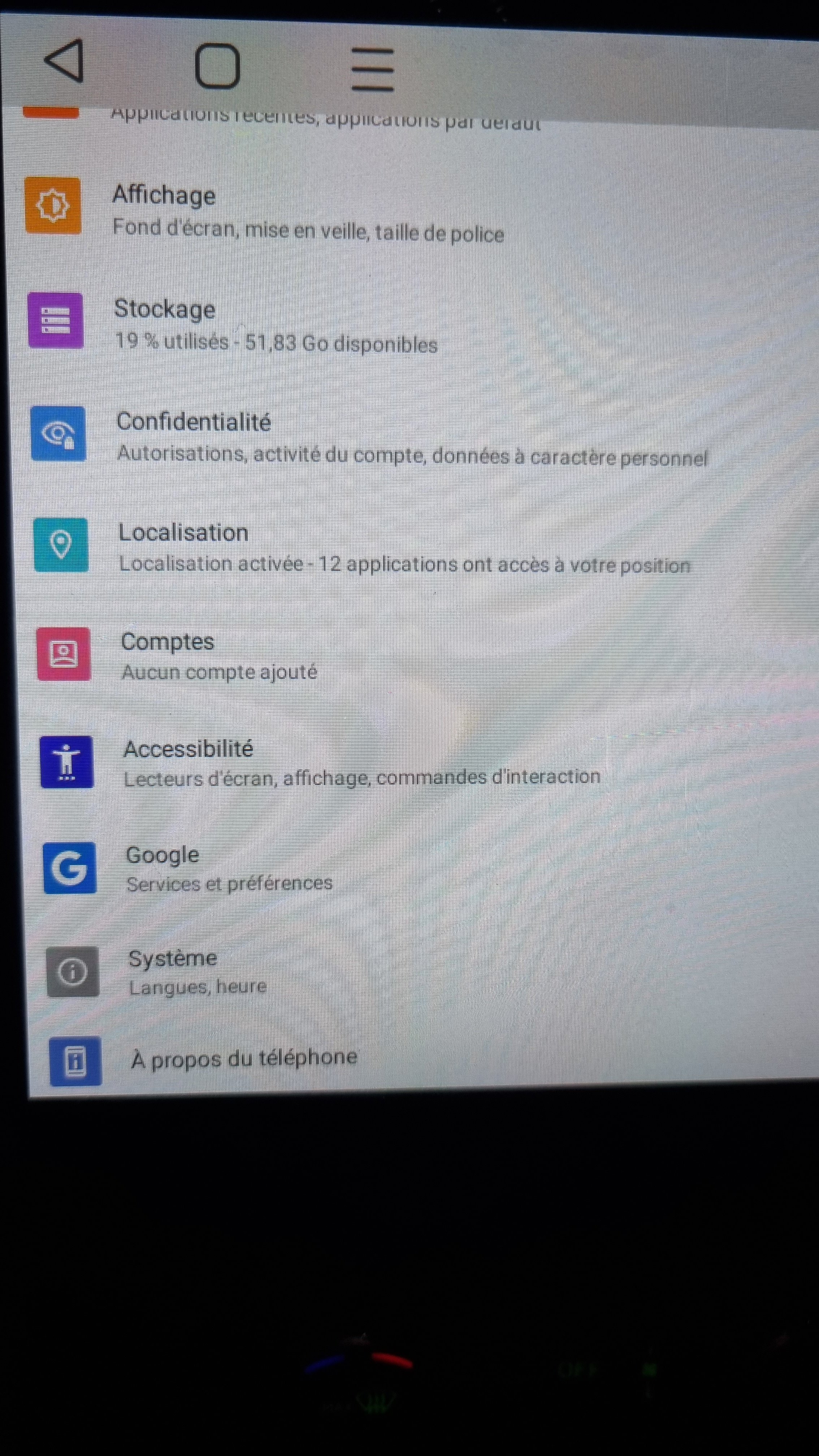

I don't have the infotainment menu...
Got pictures of the main android menu?
Go into Apps then settings.
look for Factory Settings which should bring up a password box. Enter 123456 as the password then hopefully you should see the Canbus settings.
