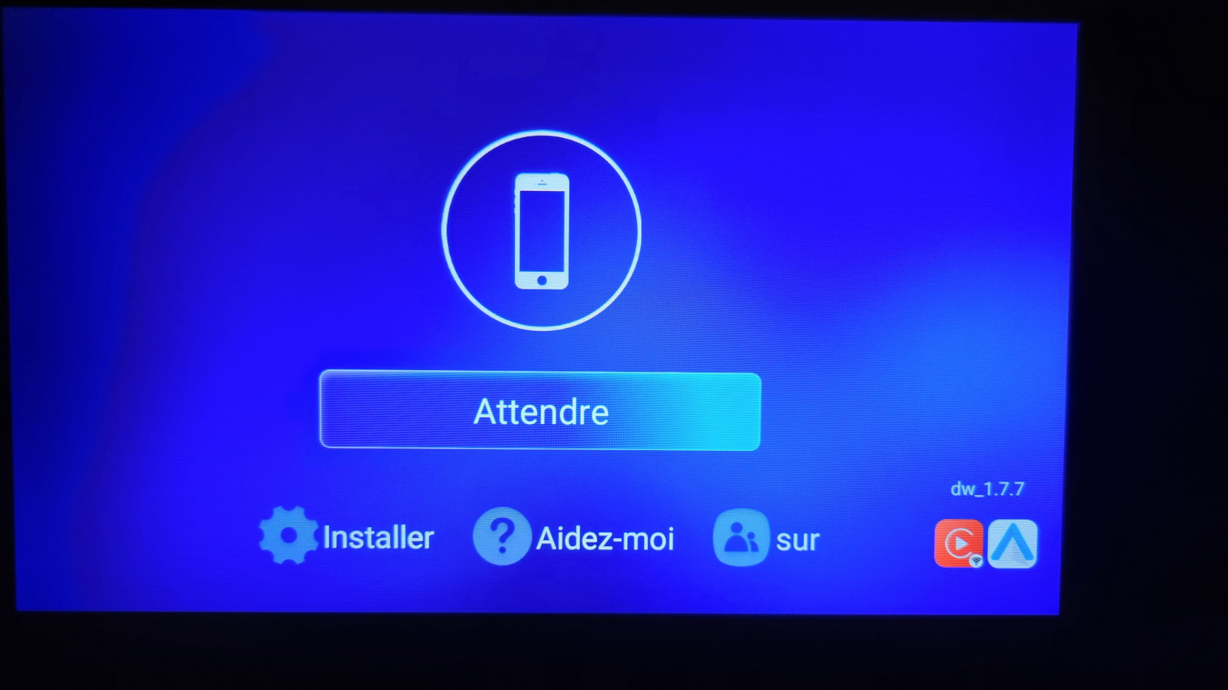

I installed the 1.77. it only works wired for Android auto.
To activate it, you only need to have an internet connection and it activates automatically.
The wireless is for Apple carplay. For Android wireless auto it seems it only works with zlink and headunit reloaded.

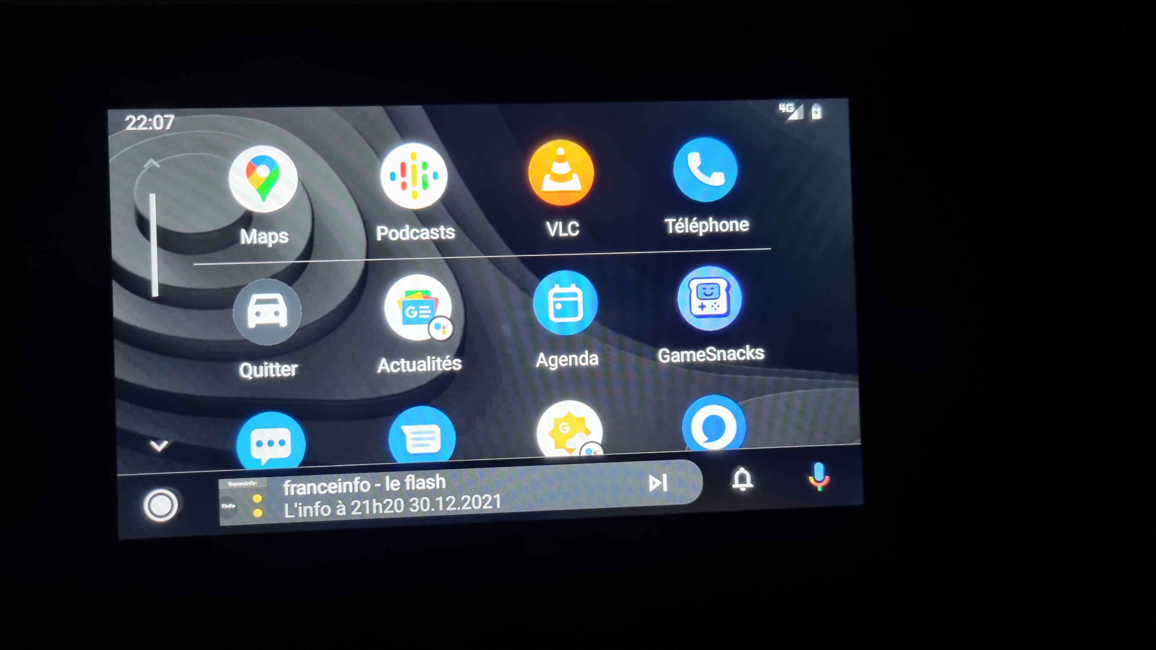

Well my Android Auto works through the factory USB and also after initially setting it all up mine also works wirelessly.
Indeed, I just tried and it connected wirelessly, activated WiFi automatically.

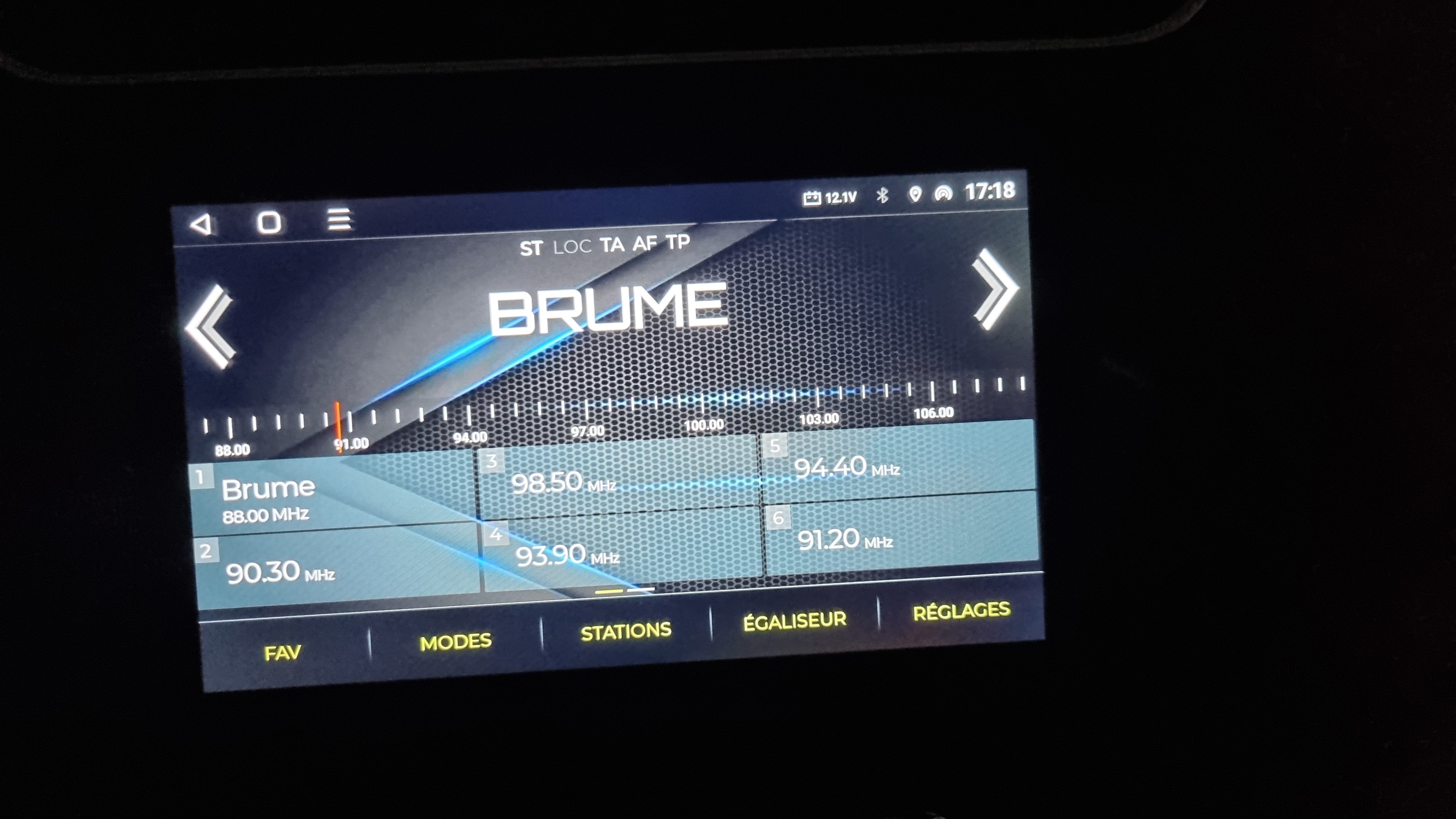

For the radio tuner, I went with the free version of navradio, it is so much better the the Factory one.
