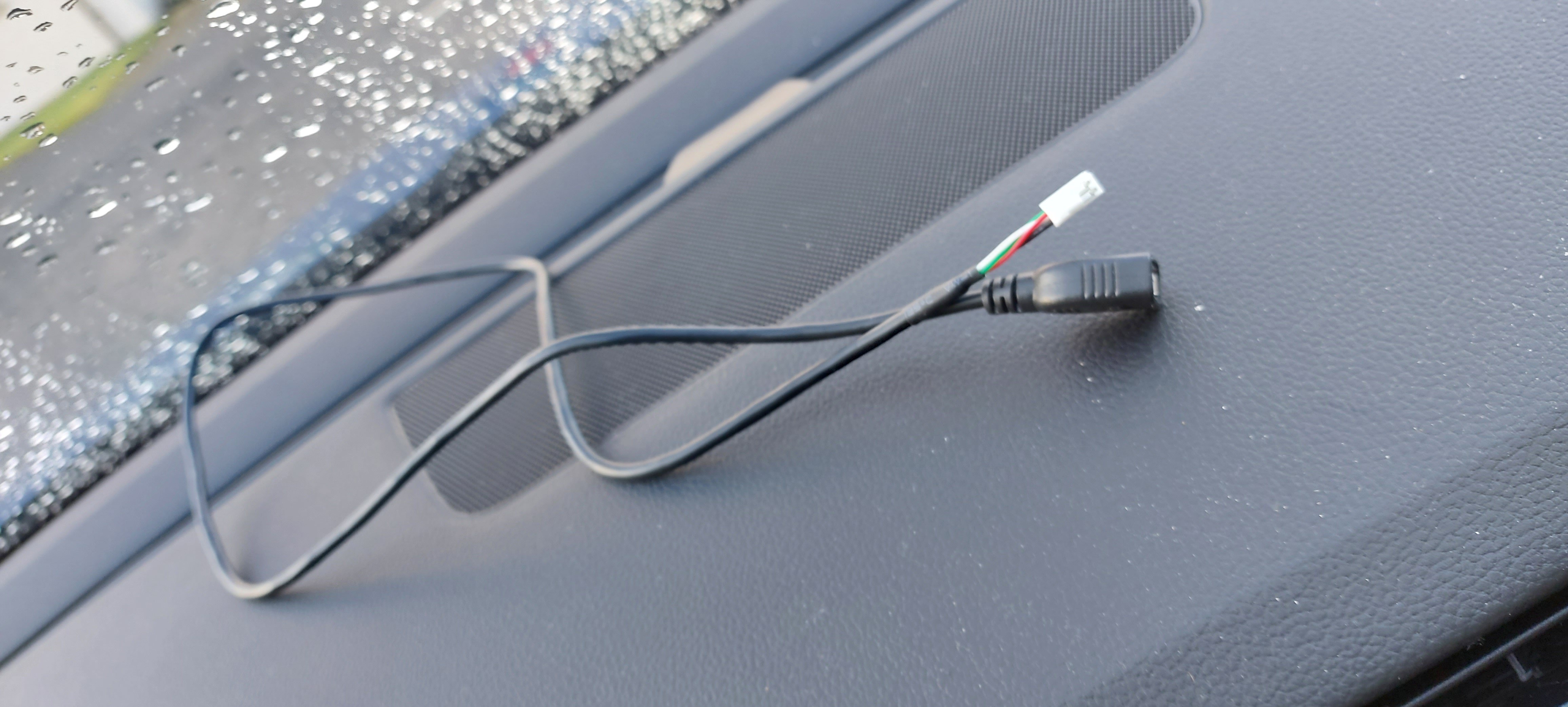

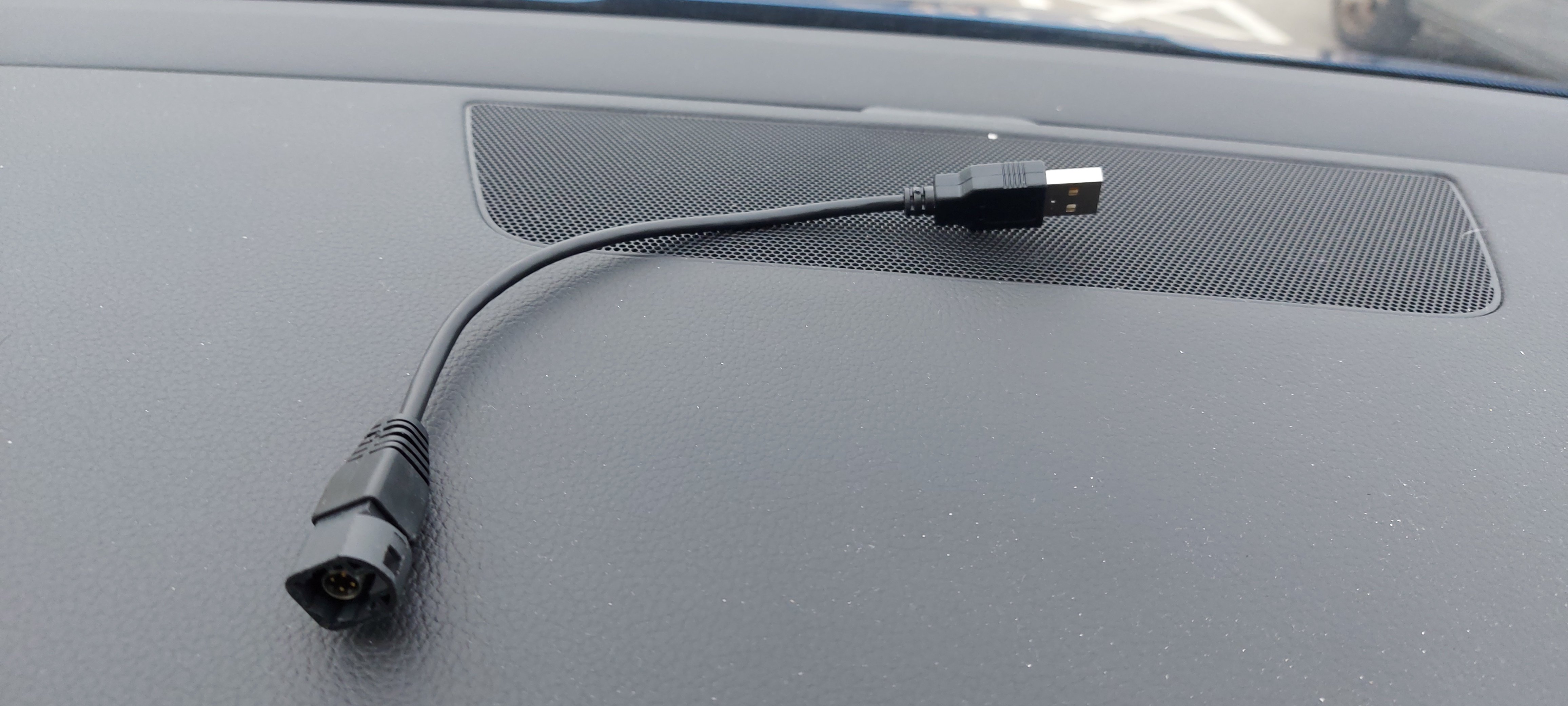

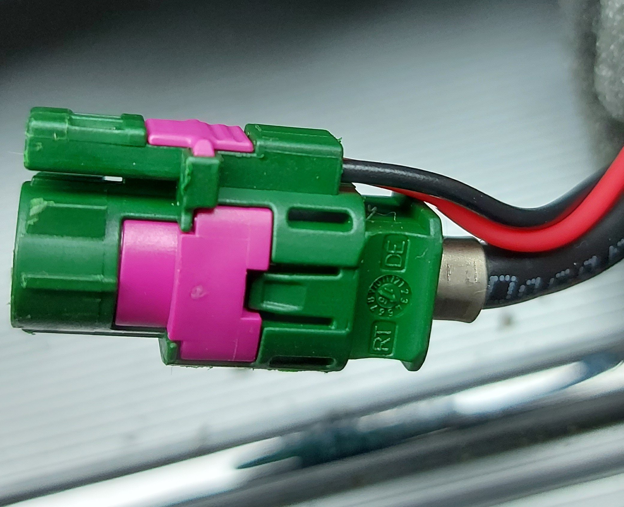

It is USB male to fakra male so that is the one I assumed was used to connect to the yellow fakra and then to the head unit but obviously it does work lol so I have no idea what it is meant to be connected to.
You should have 2X cables that go into back of head unit that have a female USB plug on end. That one goes into one of those then other is your extra one you can route to glovebox or wherever in car. One of the two female USB cables has a 4 pin block connector on end the other a 6 I think? I assumed the 6pin one was for the factory USB port and AUX together and used it on that one. Never tried it though.

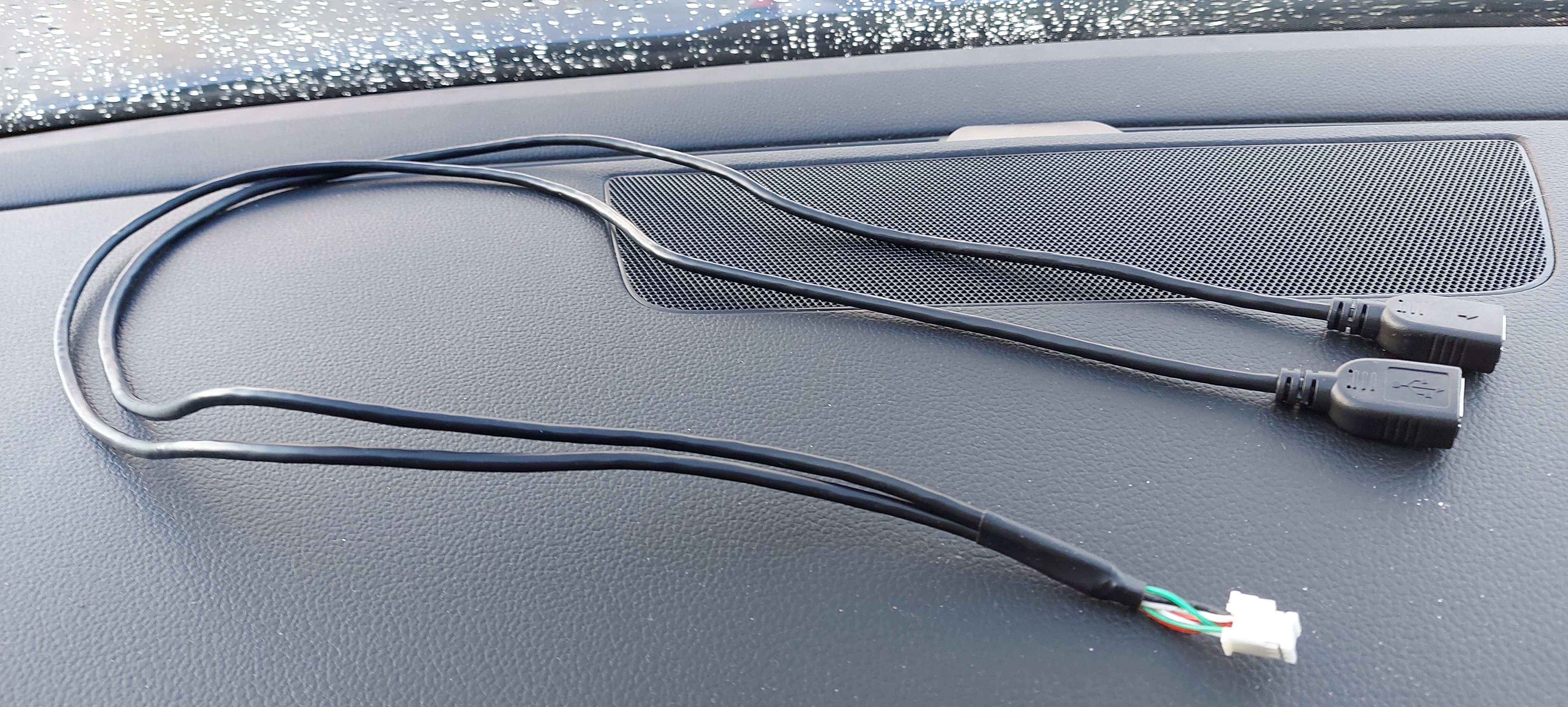

Yes I have the 6pin white connector which has twin USB female and the 4 pin white with 1x USB female connected to the head unit.

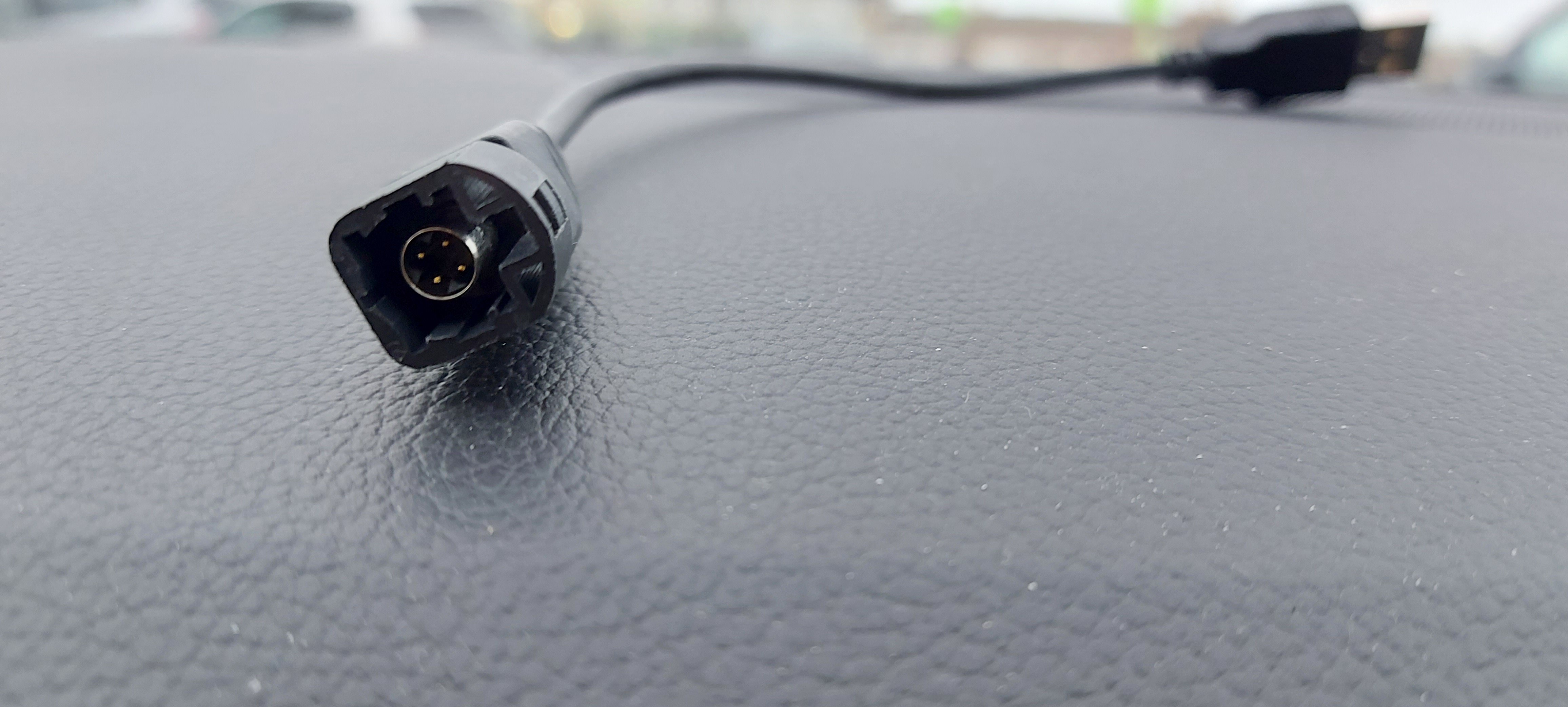

As the same as you I thought the black fakra male to USB male lead was used to connect to the yellow fakra connector that I disconnected from the unit in the glove box and then connected to the single USB lead which would allow use of the original USB and Aux but it doesn't work and now the seller is saying it won't.
At the moment one of the twin USB outputs doesn't work so waiting on the seller to give me a response on that.
My 6 pin and 4 pin were both to single female USB plugs, no double in my lot.

These are what they sent me. The last photos are the lead I thought was for connecting to the yellow USB connector.
It seems to be the right cable if I believe what is described here

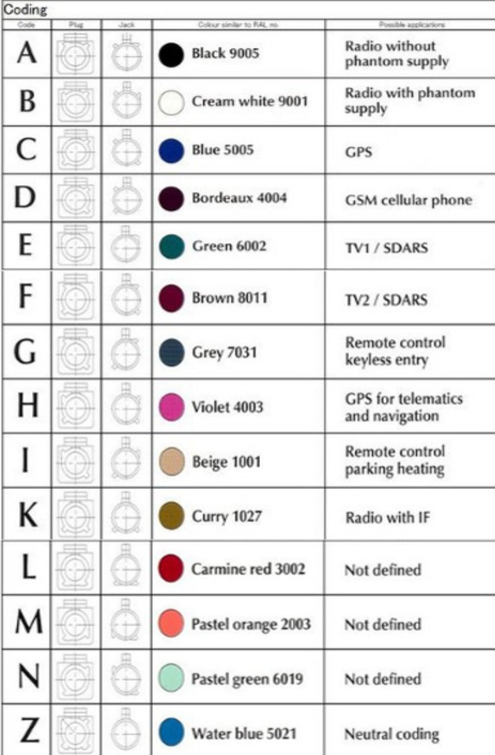

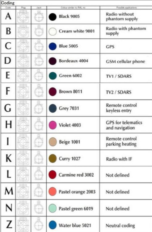

That was meant to be Fakra male to SMA Male not female to male.
With the farka plugs, it's male to male for DAB, but is it farka 'Z' male or farka 'C' male, I see both online and link above is for 'C' but you mentioned 'Z'?
Fakra C is basically for GPS and DAB, the lettering denotes the keyway of the connector so to stop incorrect male and female connections. The type Z version is basically a universal fit as it has no keyway on it.

It might be a faulty cable that they sent but I have no way of testing it so until someone can confirm that by connecting to the yellow connector and then to the usb to the head unit and they plug something into the factory USB and aux socket that theirs works or not.

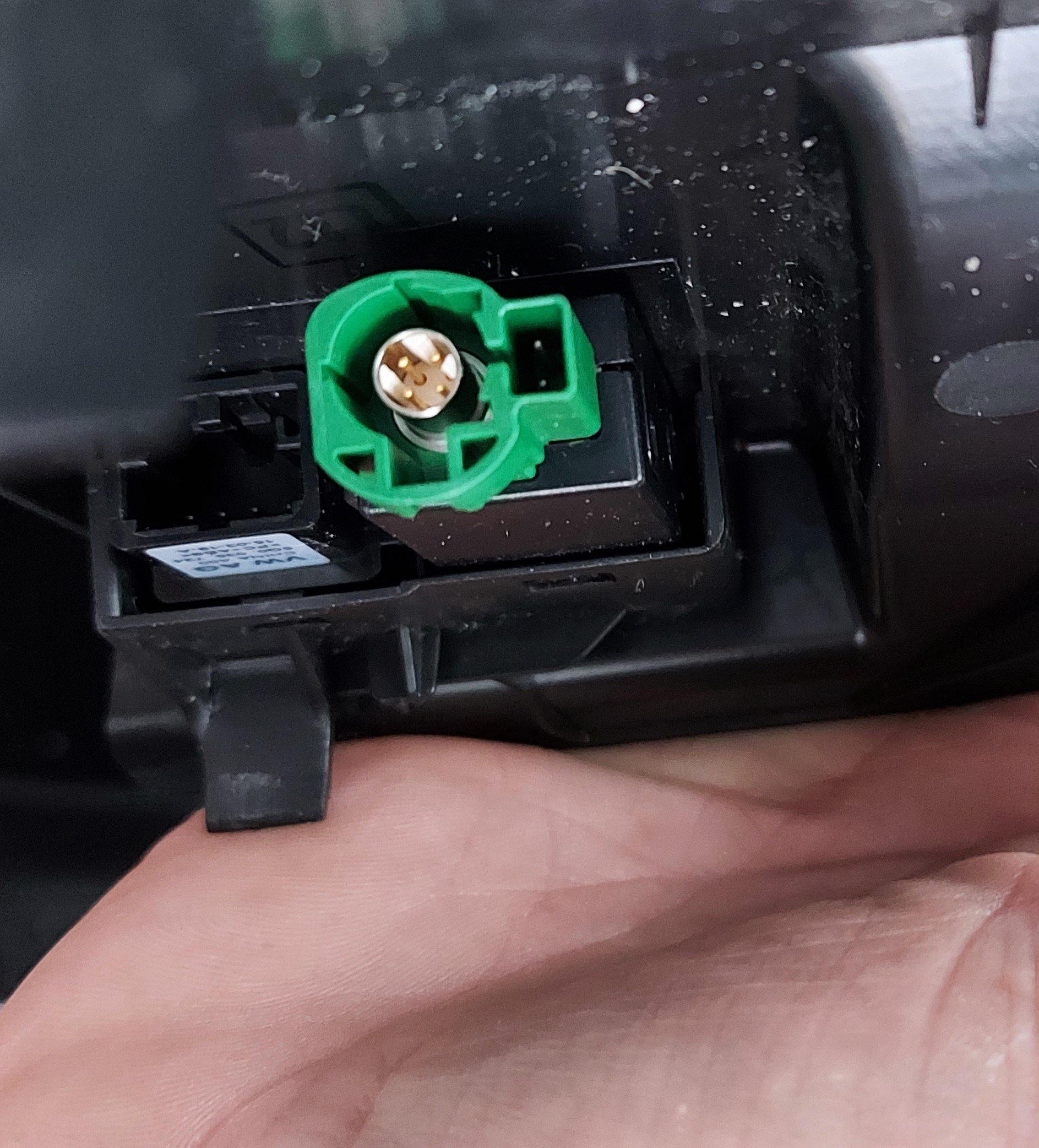

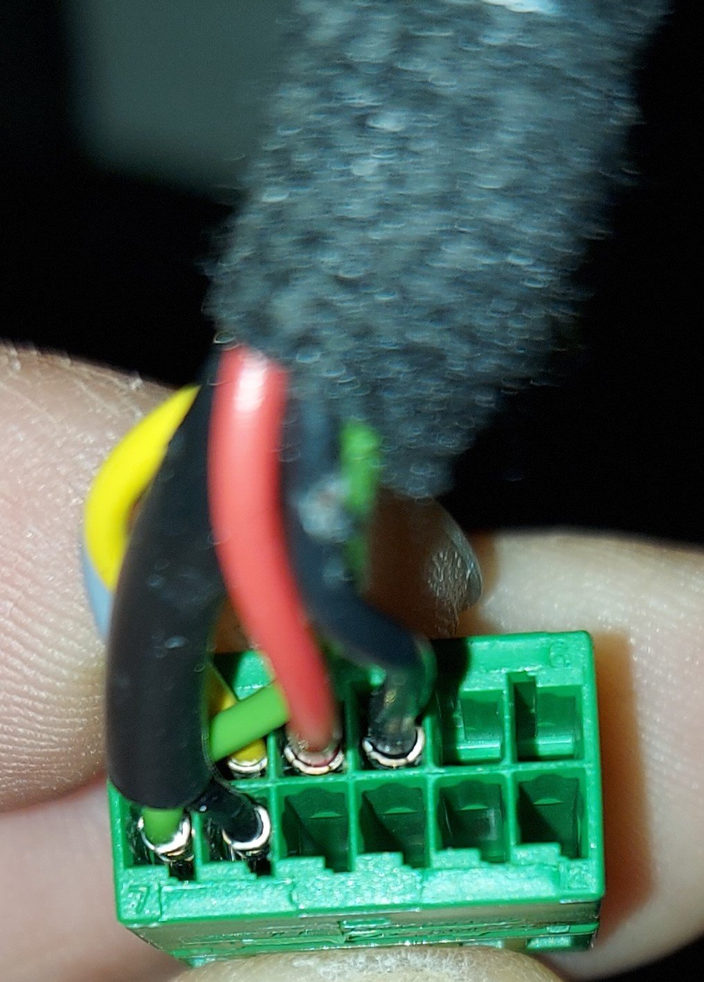

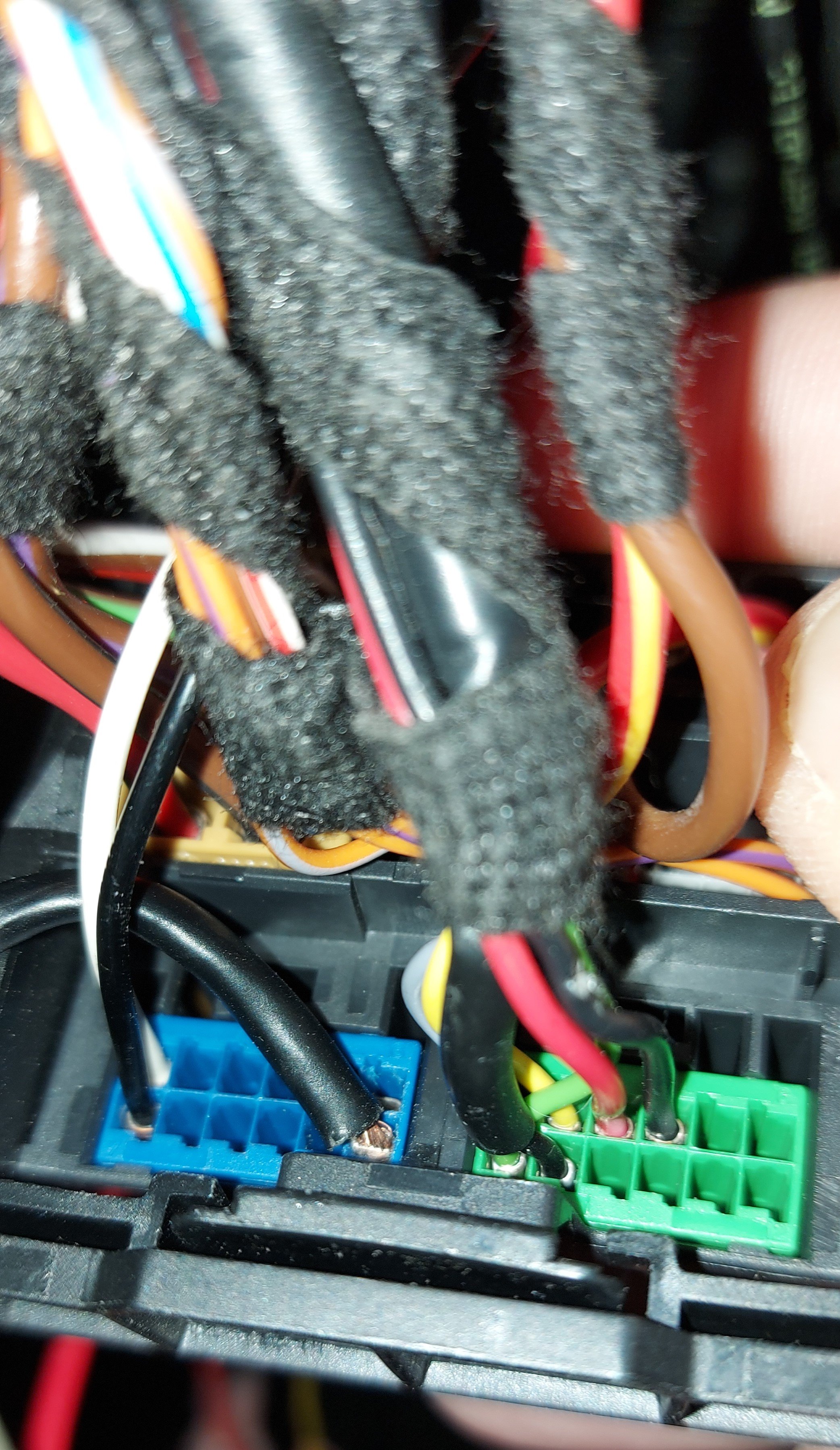

I think it will depend on which version of USB & AUX connection you already have fitted. I have just took mine out and i have the type that has the 5volts on the outside and the 4 data signals on the inside, the lead that carries the data signals goes to the yellow Fakra that originally connects to the unit in the glove box, the 5volts is taken from the green iso connector from the unit in the glove box. If you have USB & AUX connection that doesn't have the 5volts on the outside then hopefully the sellers supplied cable should work.
Just to add, it looks like the only way i am going to get mine to work is either use the correct cable as shown in the picture which i found in an Alpine radio installation manual but i cannot seem to be able to find anywhere where i can buy that that type of USB to Fakra or i will have to add in a 5volts and ground to the ISO harness that came with the android unit to match up with the correct pins on the green ISO in the quadlock.
