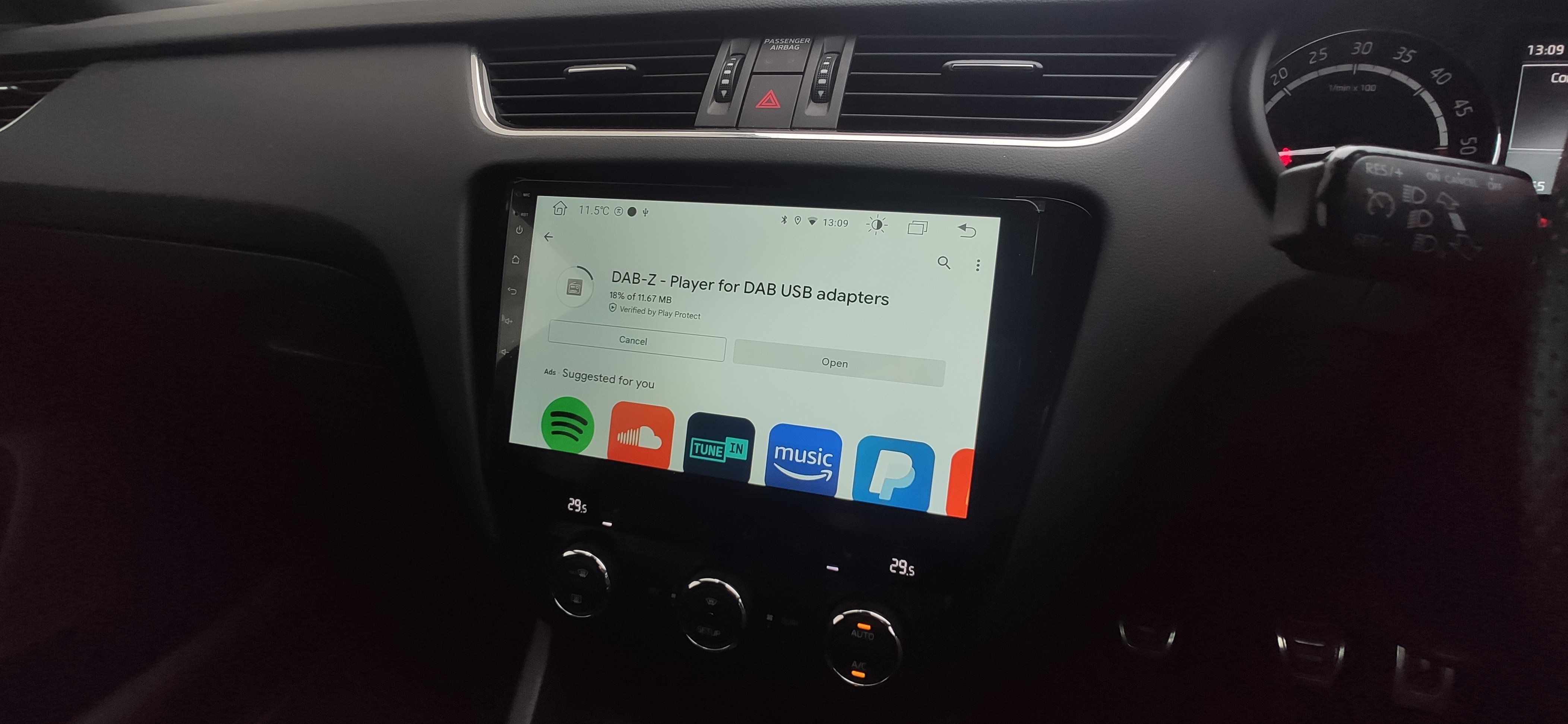

Fired in the DAB USB thing today, a very VERY quick and simple addition due to where I had put my other 'single' usb plug meant to the factory port. Was looking for it with a torch for a few min then remembered what I did lol. Used that DAB-Z app, is that what all are using?? Only pick up 45 stations this far from civilisation still bahhhhh
I am just using the app that was already pre installed in the head unit labelled as DAB+
When I tried it it said something about being designed for an older version of android and may not work as expected etc, so I just went for DAB-Z
I can't remember if it gave me a message about designed for an older version when I 1st used it but it works no problem on mine at the moment.

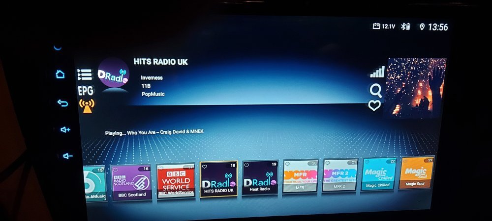

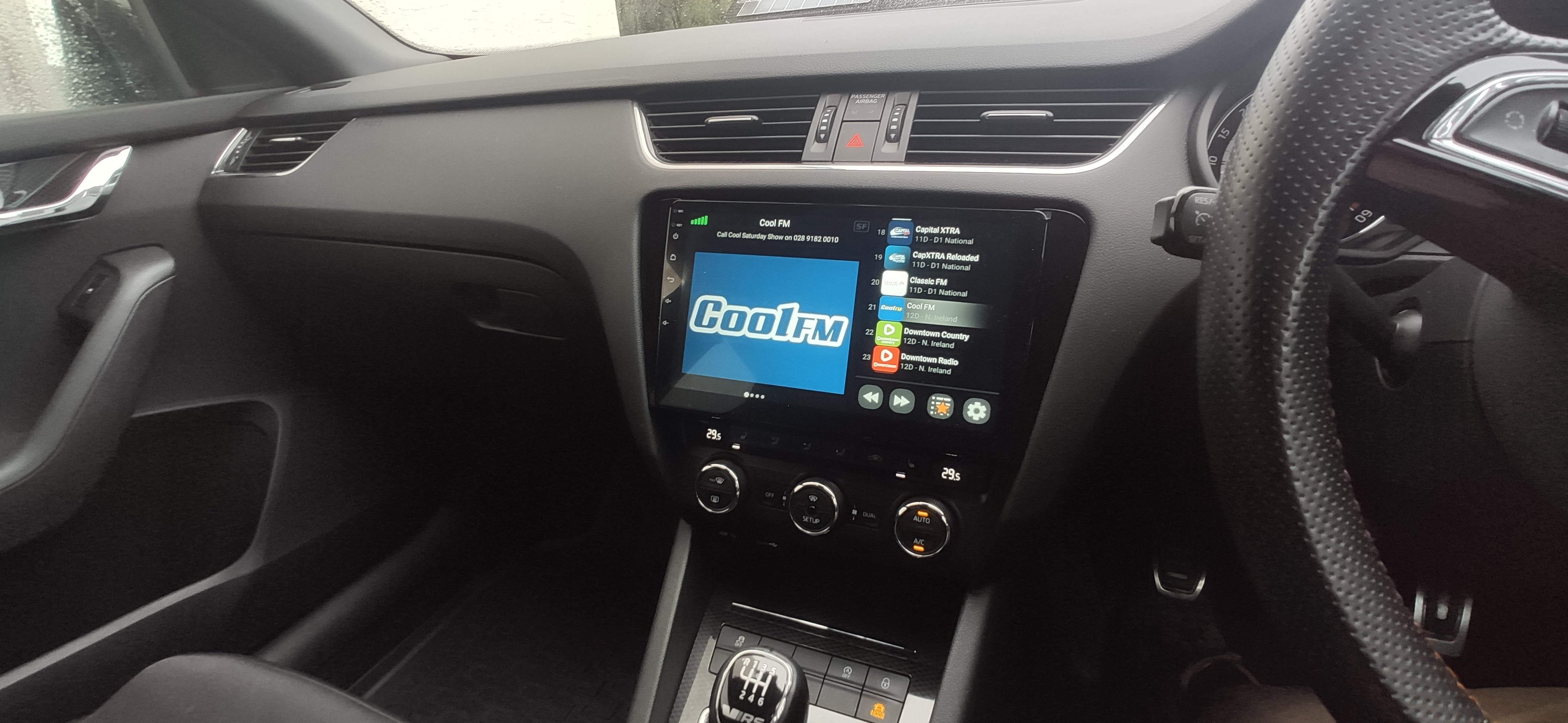

Tried the other one again today works fine, although didn't get the logos for all stations it found. Like the DAB-Z one more though, lots of options etc. Can set it to auto launch and play as soon as device boots and it detects the USB receiver etc. Be worth a try to see which you prefer :thumbup:

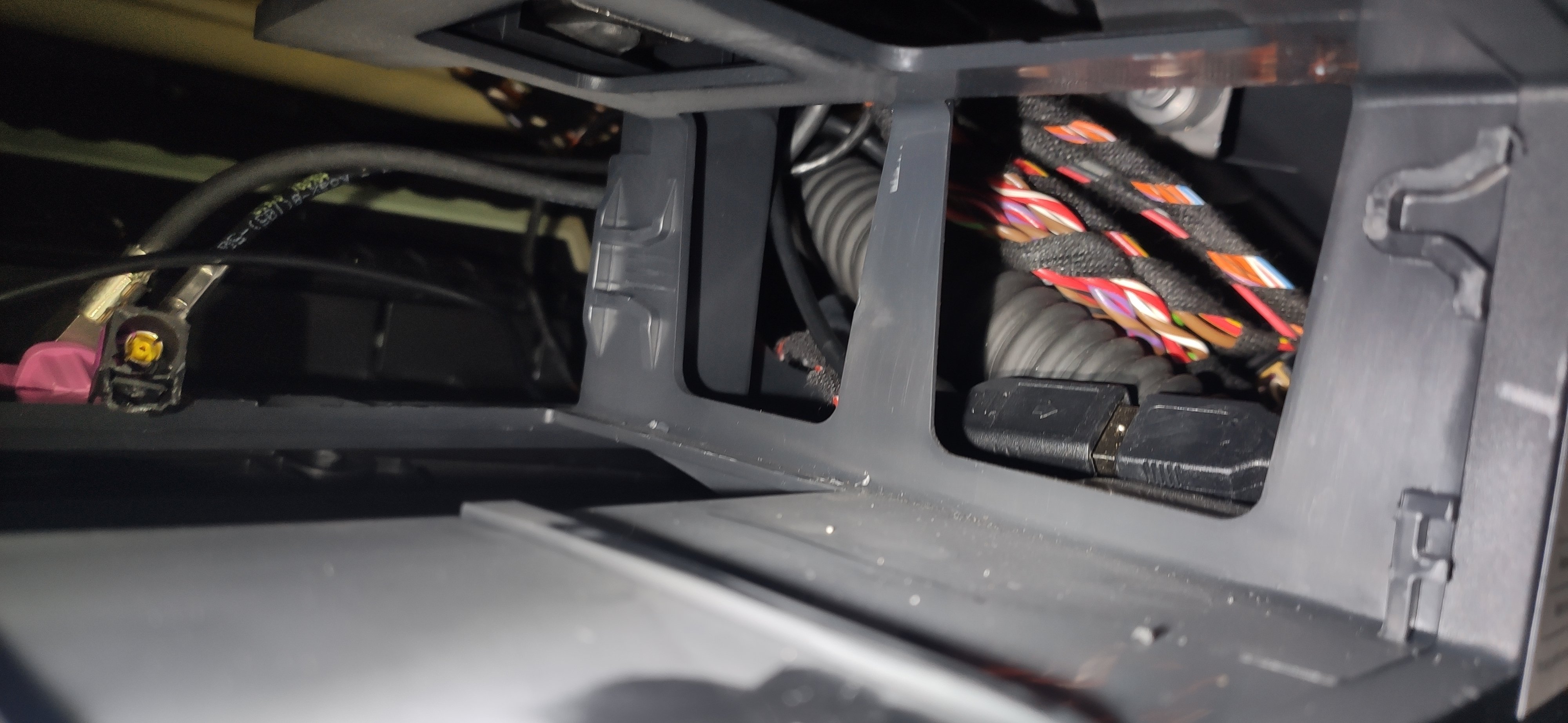

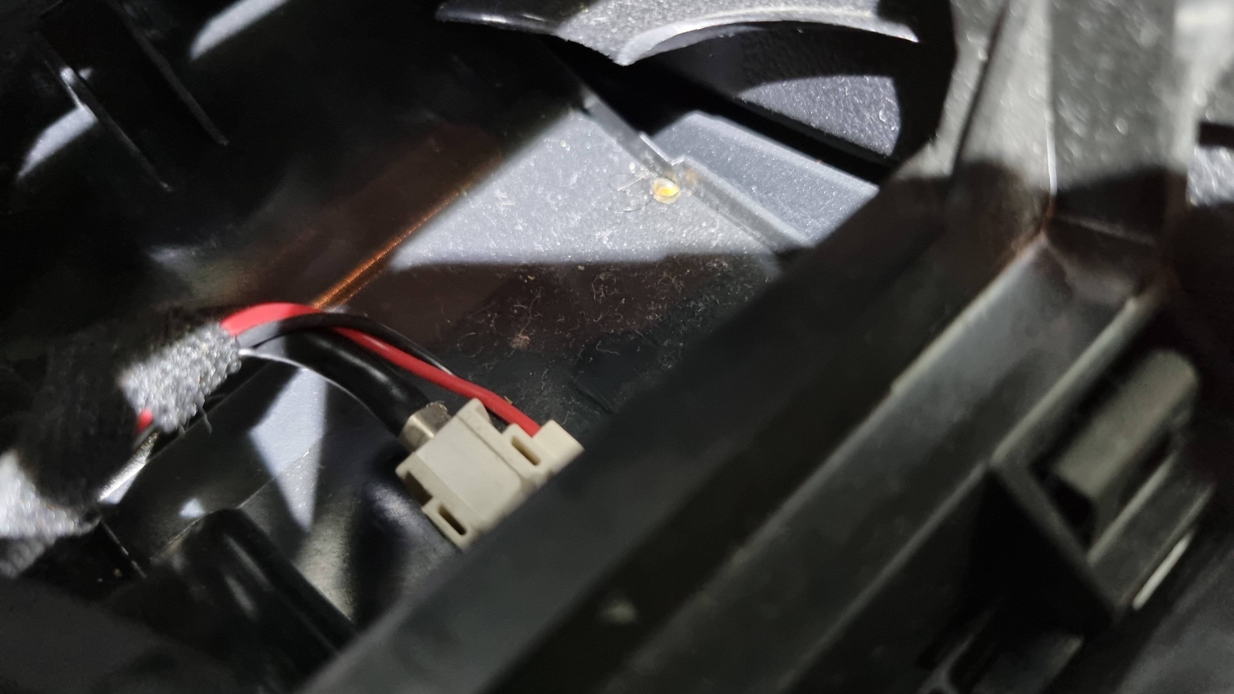

I got my extraction keys today so I checked my MIB1 usb plug.
Same punishment except that it is white. The 5v is also on another sockets.
But how the hell did you get your fingers in there to unplug the usb port?
Where is your usb located? Mine is under the heating controls, once I managed to get the bottom fascia cover released and pulled out slightly it gave me just enough room to get in and and unclipped the connection.
Same place as you.
I removed the unit, the climate control but couldn't get my fingers deep enough to reach the plug

WAGSTER, could you check if you have power on the factory usb port?
The provides cable has 4 pins with Data / ground / 5v.
If you have power on the pi,s of the factory usb (as it seems to be provided from the harness) , the solution may be just stripping the wires from the provided cable and connecting the ground and 5V to the data.
The cable would then provide only data on the 4 pins leaving the power to be provided by the factory harness.
