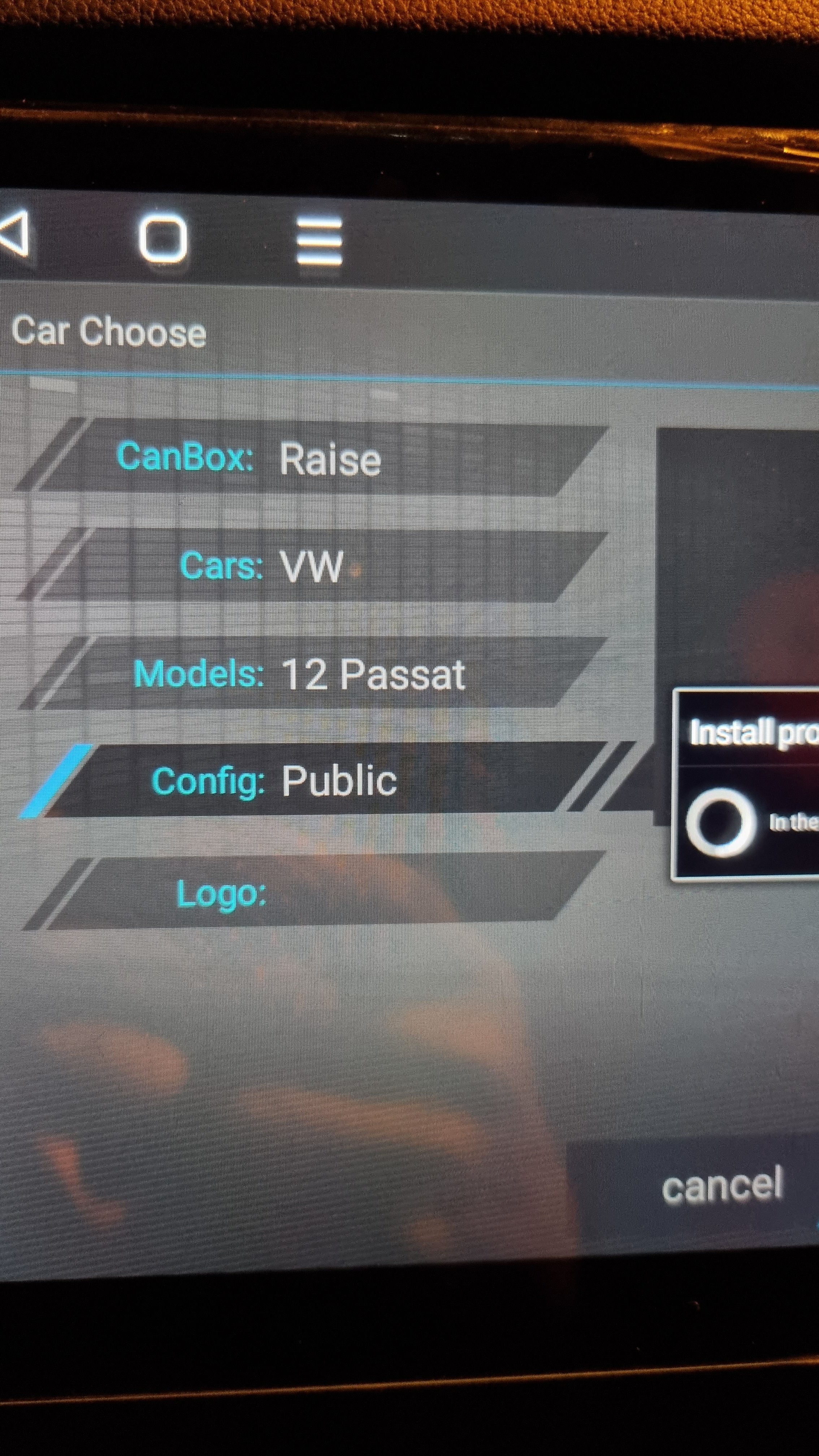

1 hour ago, wagster said:
Go into Apps then settings.
look for Factory Settings which should bring up a password box. Enter 123456 as the password then hopefully you should see the Canbus settings.
Is this the setting you put? I don't have Skoda

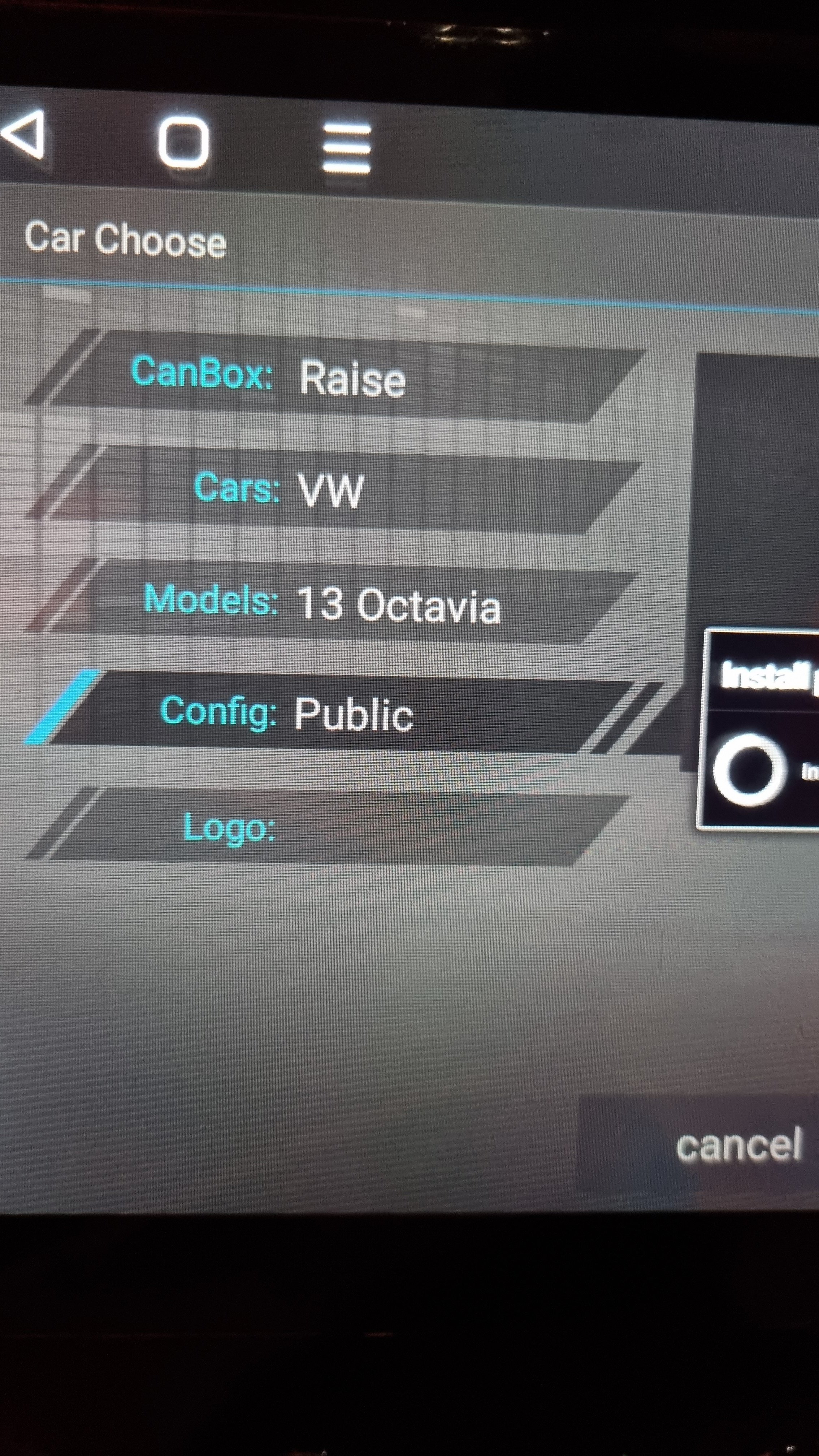

Found this
8 minutes ago, nickytheshaft said:
Found this
Guess you found the Octavia. You can try different VW cars like going to the Golf etc. You just need to figure out which works the best for your car.

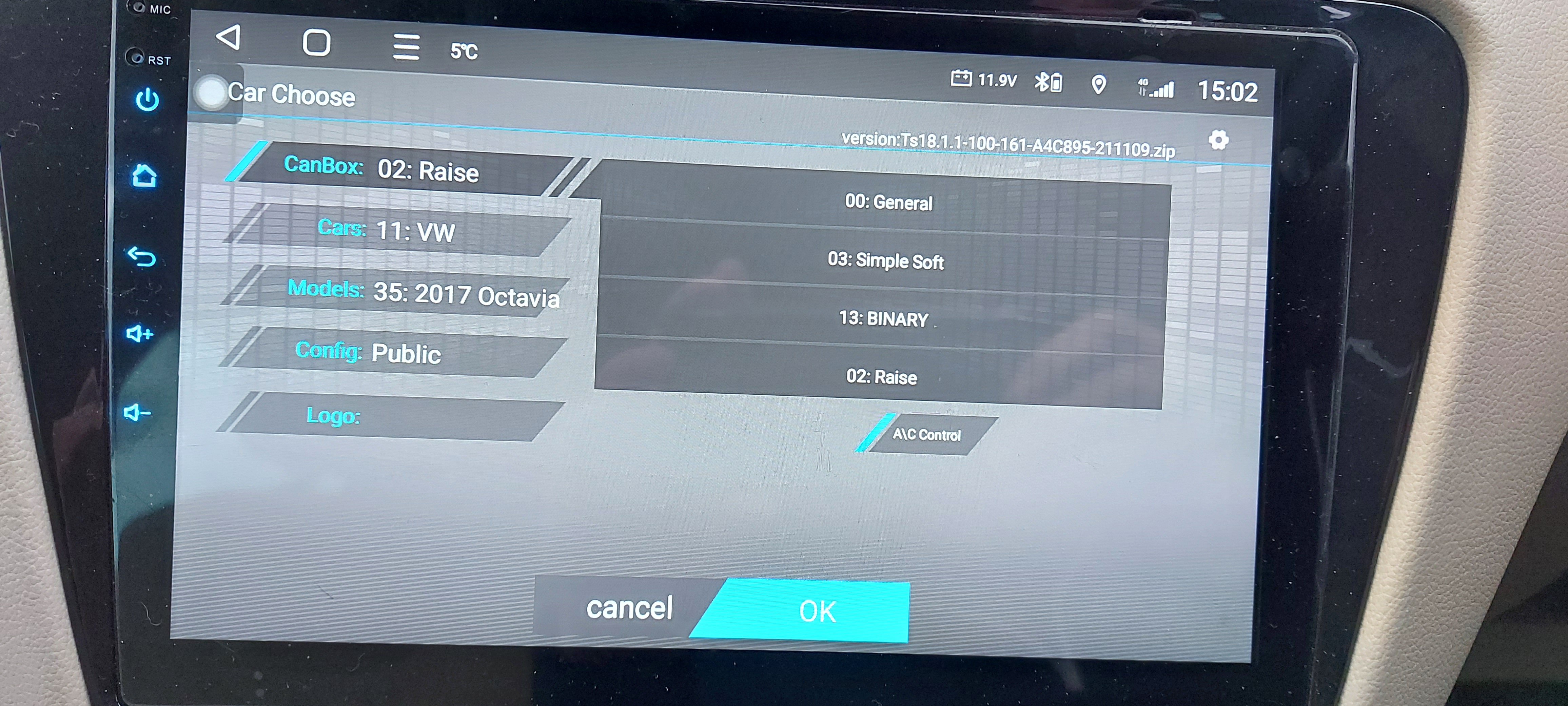

I finally sorted out the canbus issue. I didn't connect the second plug... My bad. Went for Octavia 2017. Now it works.

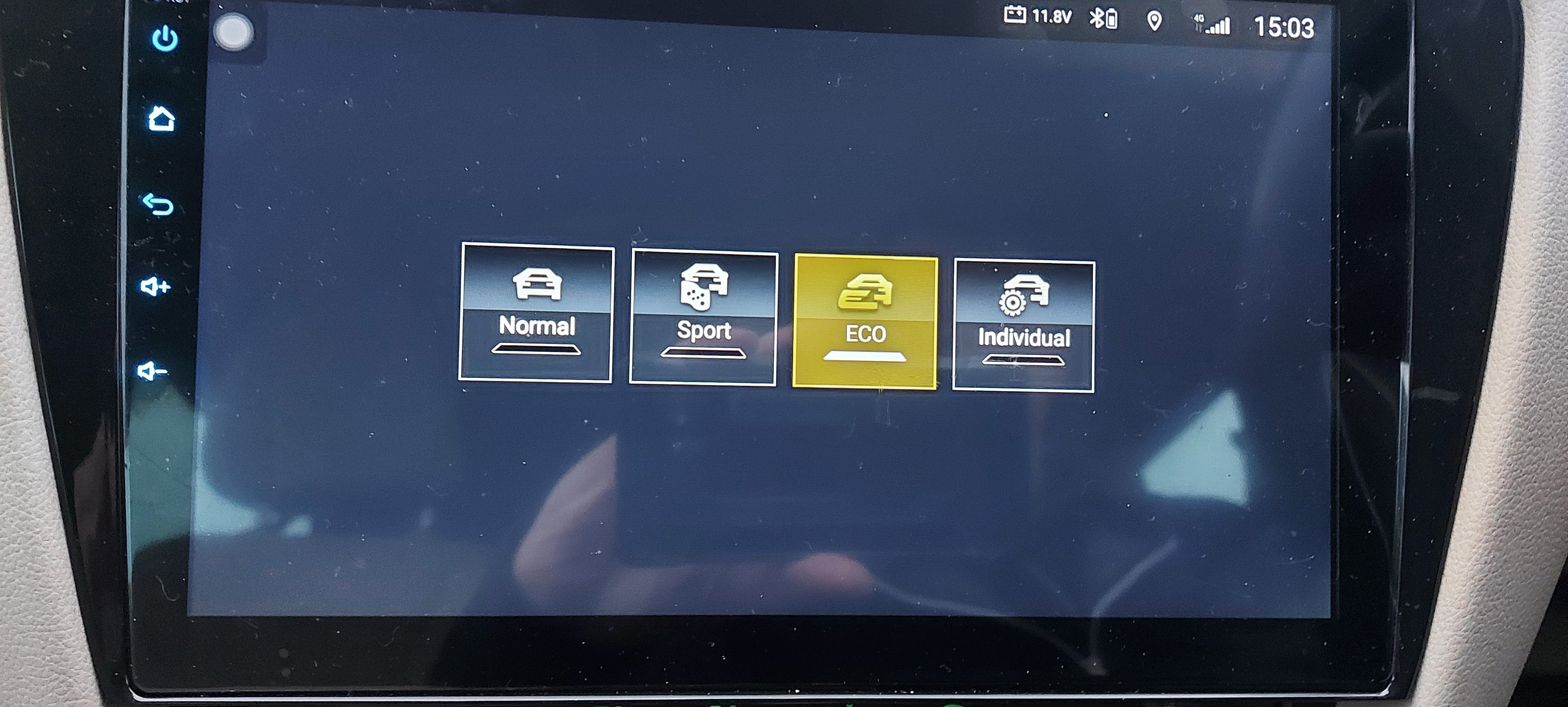

So now the unit is operational, the one thing missing is how to get the drive function to pop up when I press the buttons .
I know that it cycles around the modes as the light turns off when it reaches the normal mode.
Also when I go in the settings, the correct mode is selected and I can manually change theme.

Can you tell me which vehicle you set in the canbus?
Octavia 2017 isn't working right.
Simple Octavia the radar doesn't give me distances juste green lignes and the driving mode button doesn't pop up on the screen and the open doors are all wrong.

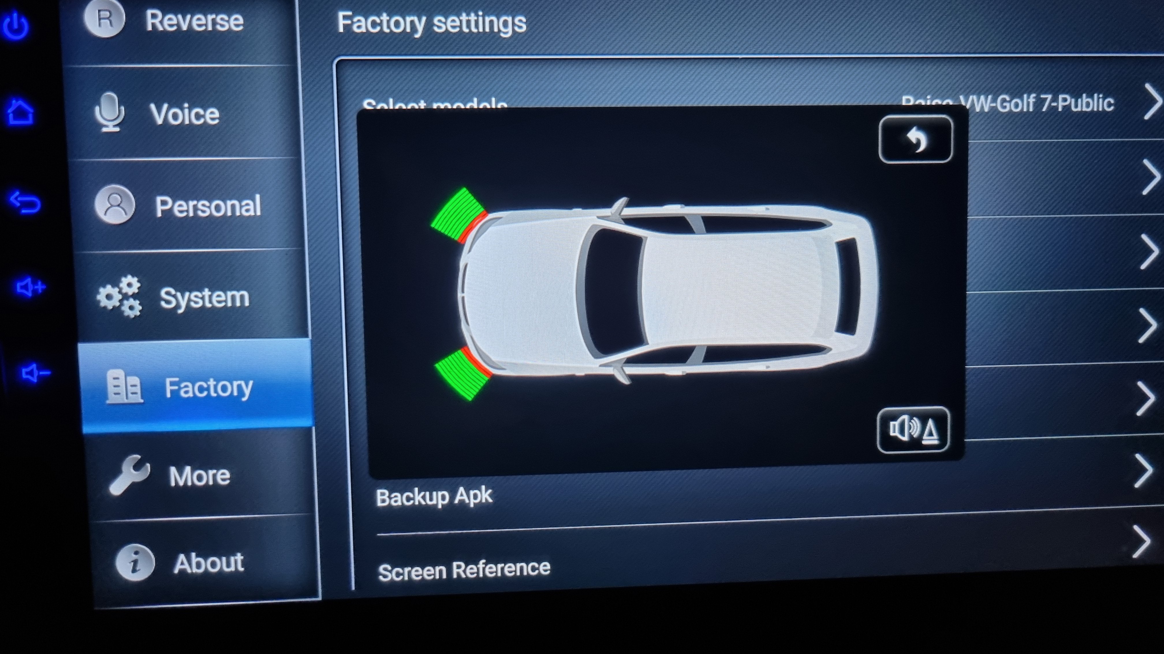

So I set it to Skoda, golf7, Skoda 2017, my radar is just going crazy
On the picture my car is backed against a wall (the wall is behind the car) and it just shows the 2 front side sensors.
Most of the time it shows the sensors with all the green lines out without talking the distance of the obstacle in consideration.
Then it stays on forever
Wagster, you seem to have the same Unit as me. What settings did you put and how do your radars react? Also do you have the driving mode that pops on the screen when you press the button? It works for FUBAR with the golf 7 setting but nothing works for me.
Edited by nickytheshaft
BTW those are not radar they are ultrasonic sensors.
Mine is currently set to what is in the photo but it works on a few options. Have you tried changing to VW MQB or PQ? Also have you ran the upgrades for the MCU?
All my proximity sensors work as they should.
Yes the driving mode options pop up on the screen when I press the mode butto
