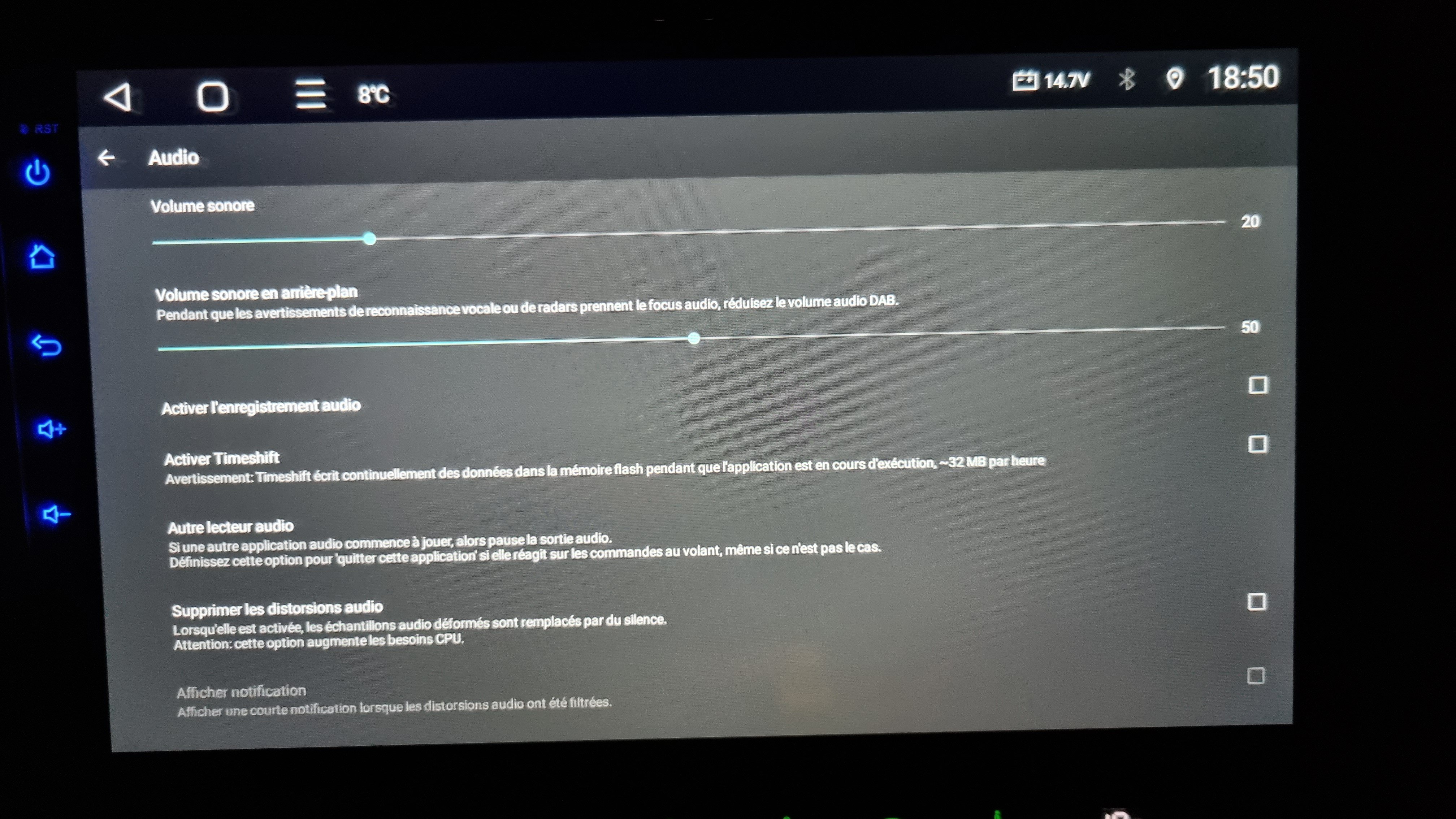

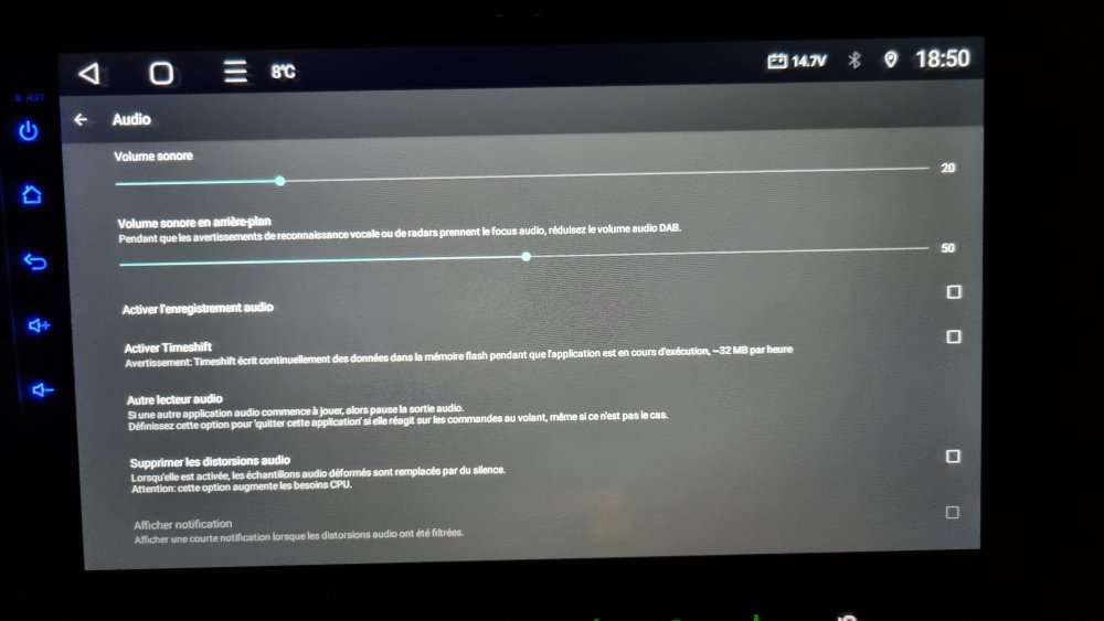

In the audio settings of dab z, you can set the app to reduce the volume when an alert comes up. The Google notification should be considered an alert.
Try it, it may work. It is what I did with Sygic. The music doesn't completely cut of but the instructions are very audible
(Sorry screenshot in French, I didn't think of changing the language but you will understand it)

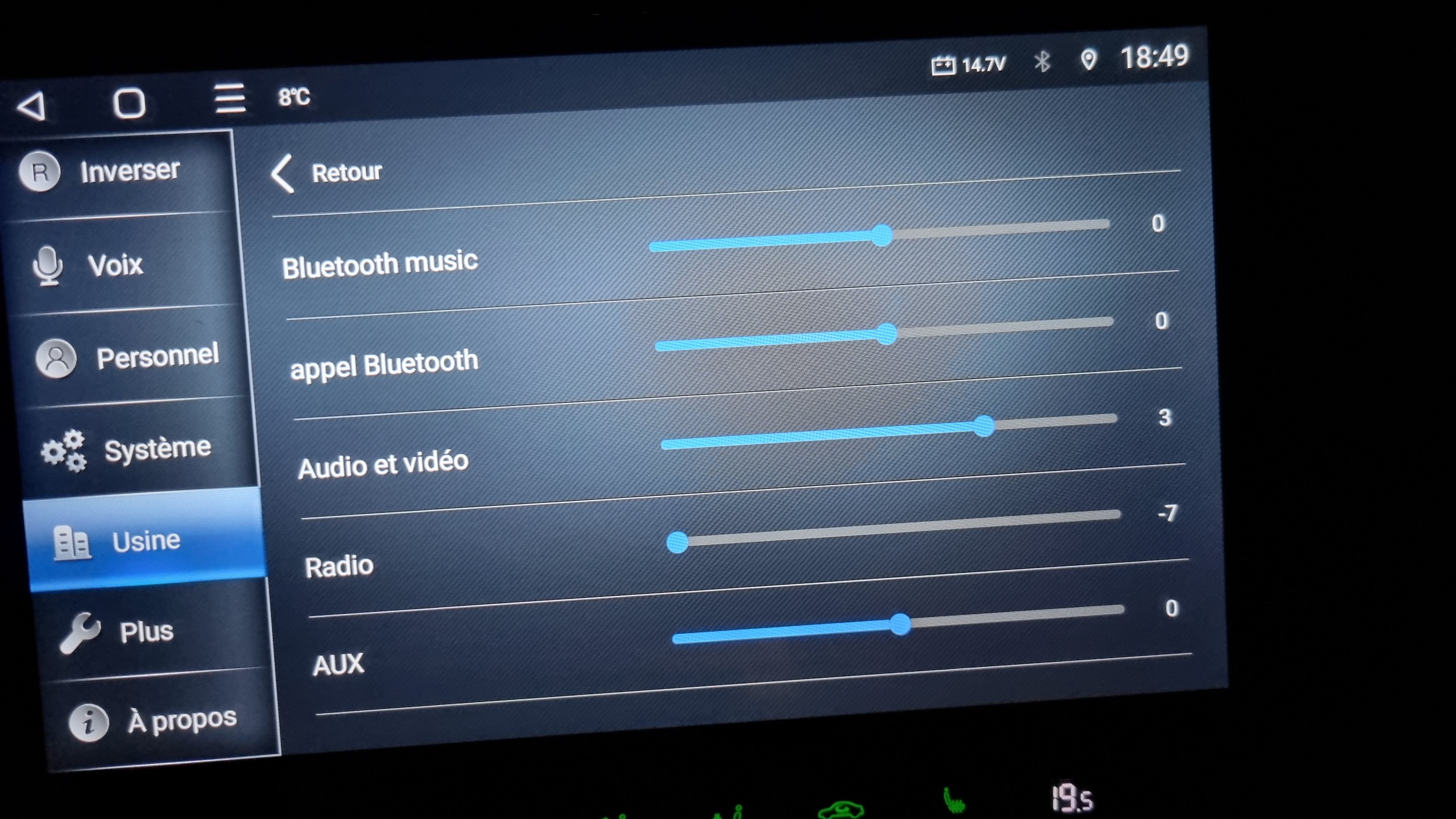

41 minutes ago, nickytheshaft said:
Here, you reduce the radio volume and increase the systeme volume (Audio et video in my case)
the systeme volume is what is used for the different apps.
Lowering the radio volume gives you a more precise settings, low is low and you can crank up the radio volume more precisely.
Leaving the systeme volume higher means that navigation instructions will be louder than the radio.
Then go to dab z audio settings and play around with the 2 volume settings, that will fortunately resolve your maps issue.
