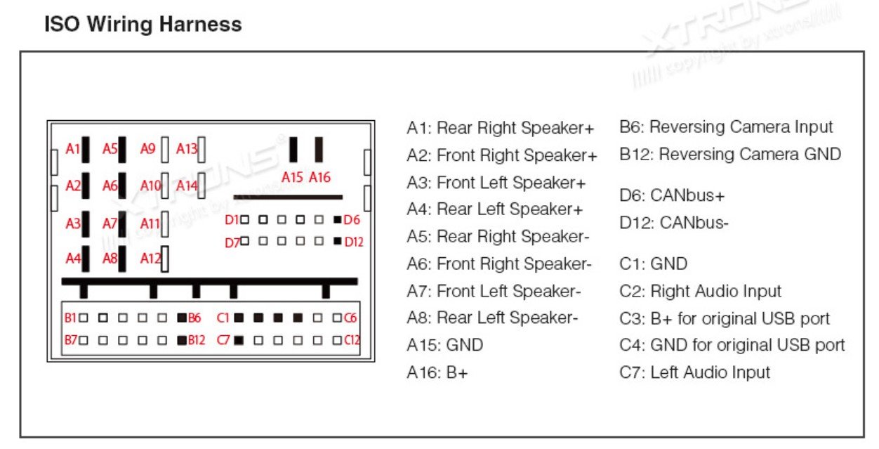

The ISO harness they should have sent me so that my USB would work is this one but they sent one that doesn't have the C3 & C4 pins fitted so I can try and add those pins to provide the power needed to the USB.
It could work and could not...
If the cable that connects to the yellow one is the same as the one it a previous post I posted, the 4 pins have data+5v+ground.
As you said, the yellow cable only carries the data so you should test the leads on the adaptor to see if any of the 4 pins are connected to the power of the usb (I don't know if I am clear)
If they are, you shoud cut the wires providing the 5v as it will be provided by the outside cables.
Edited by nickytheshaft
Yes I understand what you are trying to say and won't be be problem(I am an electrical engineer by trade).

17 hours ago, wagster said:
I think it will depend on how / where your mic is connected to how easy it might be, I only picked up on the possibility of doing mine from this thread
I can already see what I assume are the 2 mic wires connected to the Quadlock on the blue ISO connector in my car, so hopefully I should be able to get it to work.
You are on the right track.
The schematic taken from the post you quoted shows the mic to be + on B1 and - on B7.
Pinbelegung.png.d047a3536044173b603af9a6f714ffd8.jfif
I think I will go for the wired harness, use it as an extension then split the ones that need to be re routed
