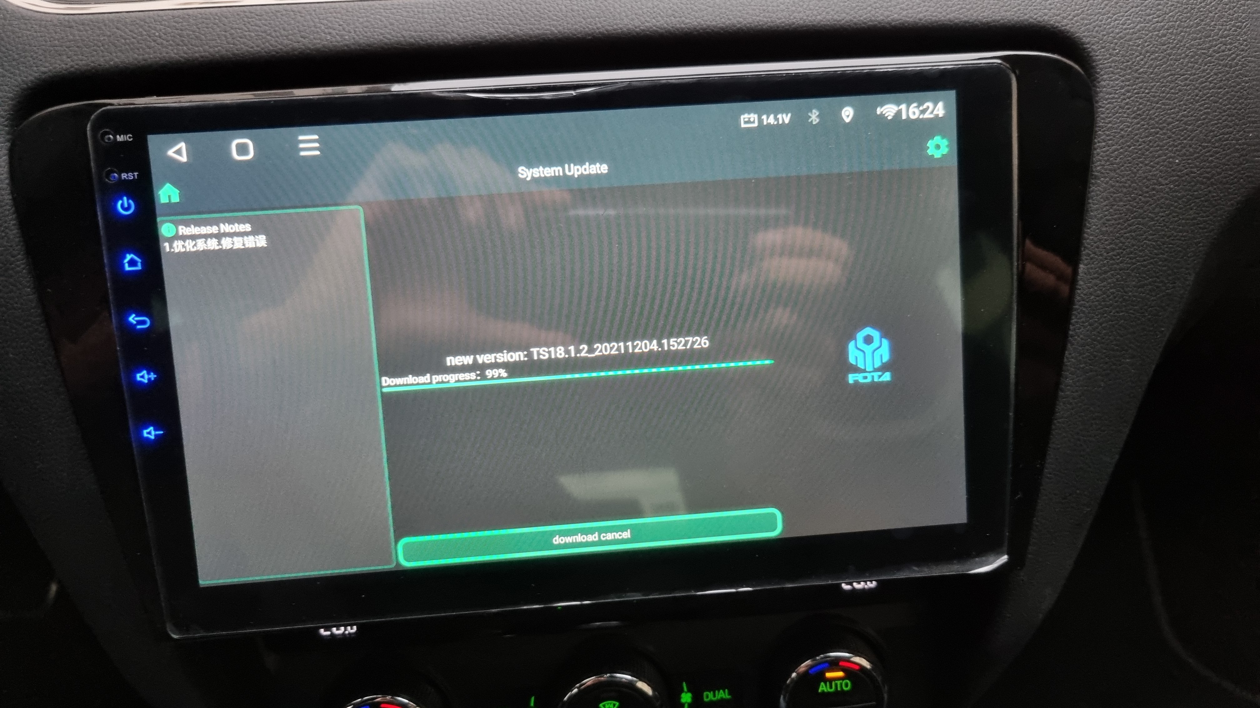

Finally I did a system update then got MQB and now things seem to be in order
It is an update of early December.

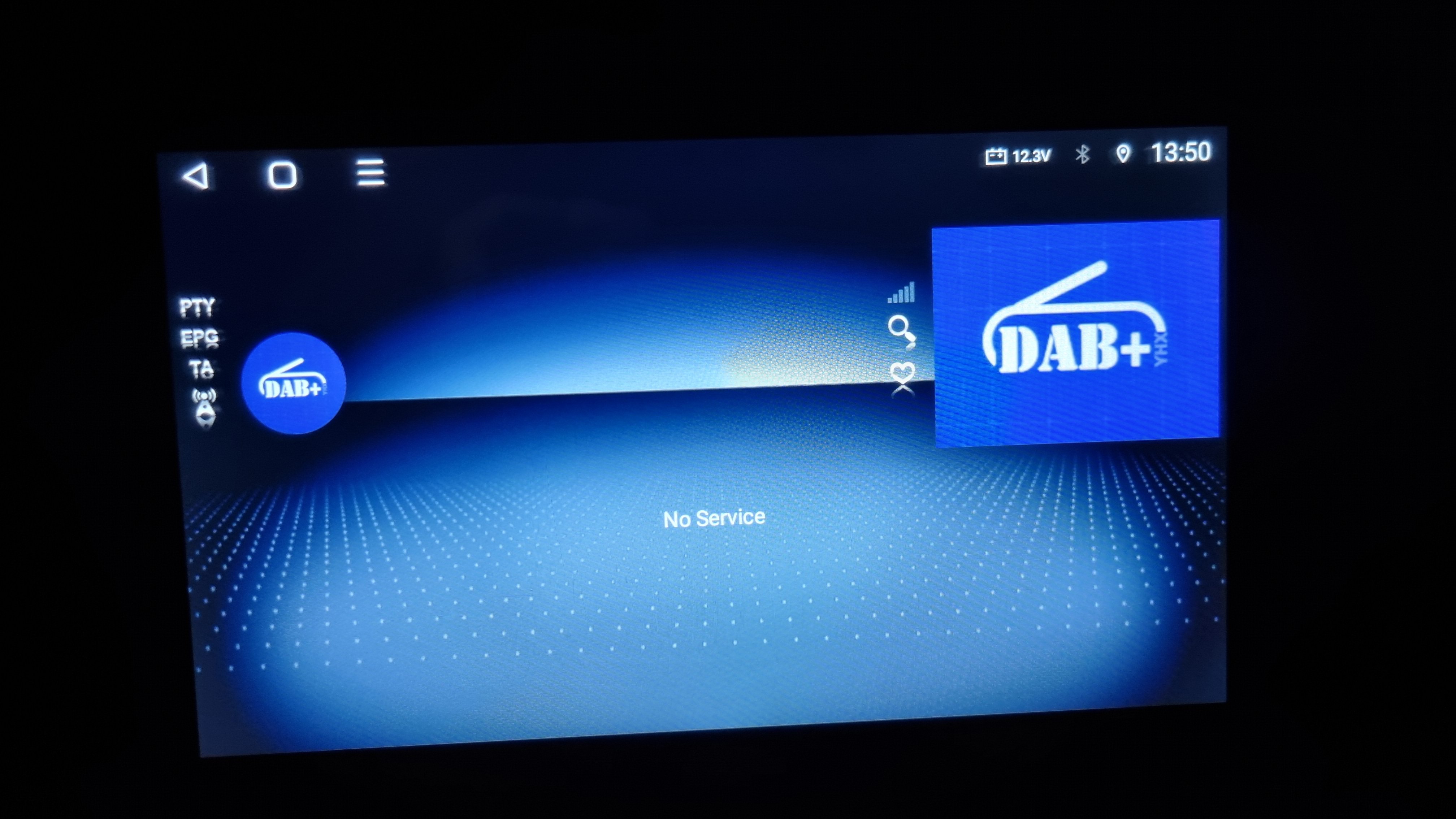

6 hours ago, nickytheshaft said:
Ok dab problem solved, one of the Split usb is not working...
On the other it is ok.
I will have to put my original Unit back as I didn't disconnect the stock Bluetooth....
So now the unit is operational, the one thing missing is how to get the drive function to pop up when I press the buttons .
I know that it cycles around the modes as the light turns off when it reaches the normal mode.
Also when I go in the settings, the correct mode is selected and I can manually change theme.
I guess that is the same problem I have with the split double USB, you should find though that the one that didn't work with the DAB dongle will actually just charge, try plugging a mobile phone into it and the phone should show charging. My phone does show charging but at a low voltage.

Yes, but it is mind bending to get around all this. Although I wonder why there is such difference between the 2 firmwares. The old one was from November so not that old but sooooo bugged.

Also lost the native dab+ app. It seems that it is installed after and not included in the rom.

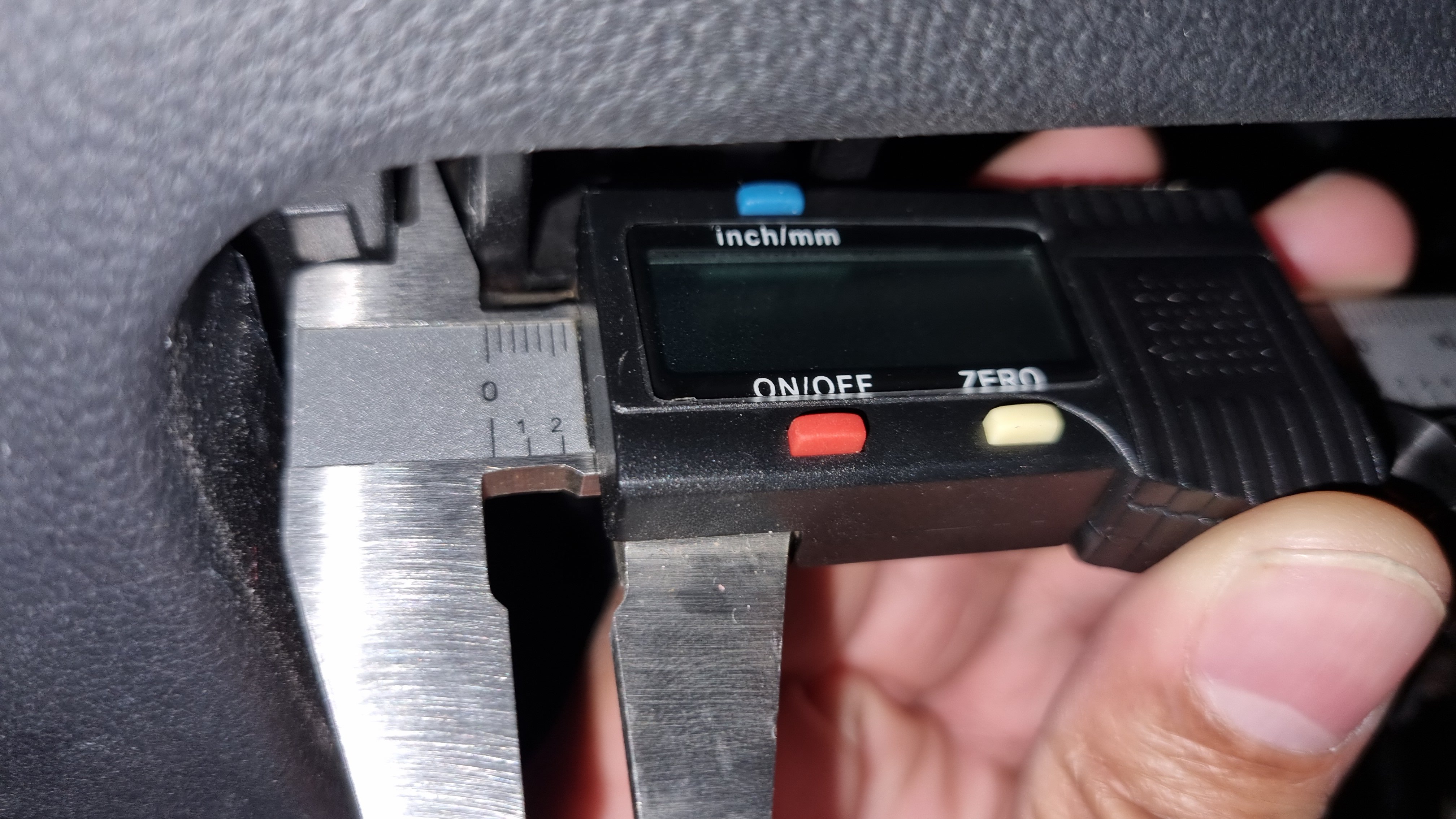

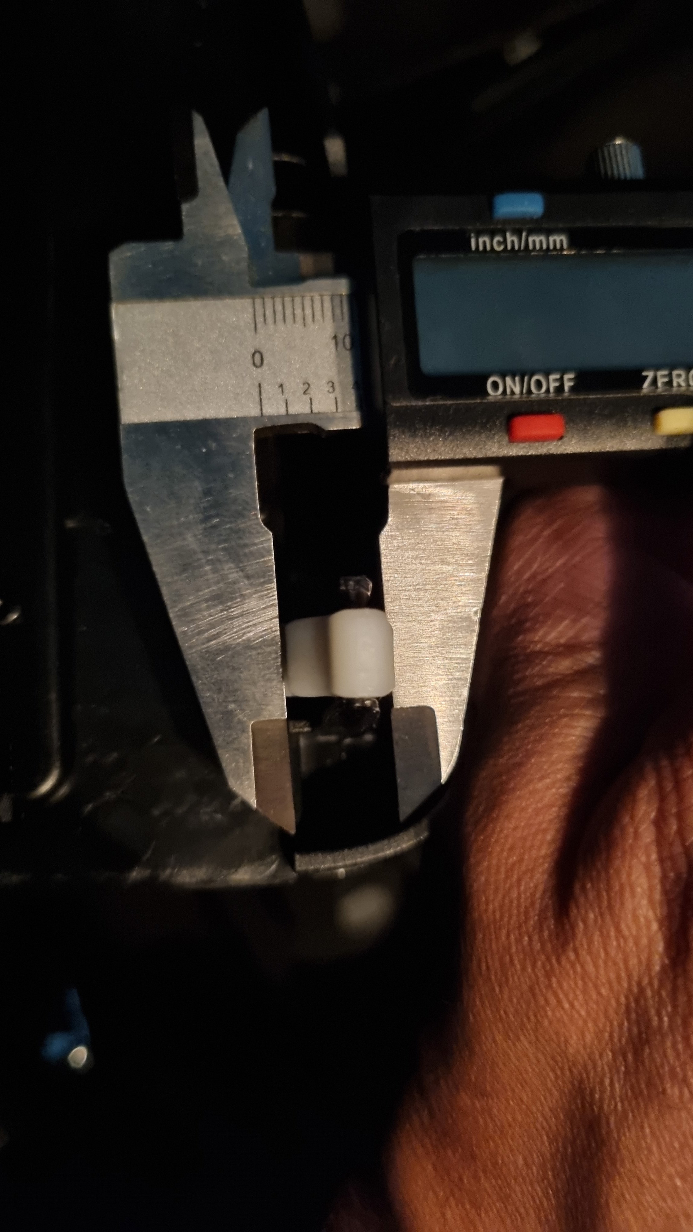

For the frame, I took the whit clips out and it now slides in and holds In place .
Here you can see the difference in size of the stock hole and the size or the clips

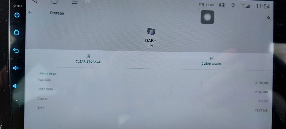

31 minutes ago, wagster said:

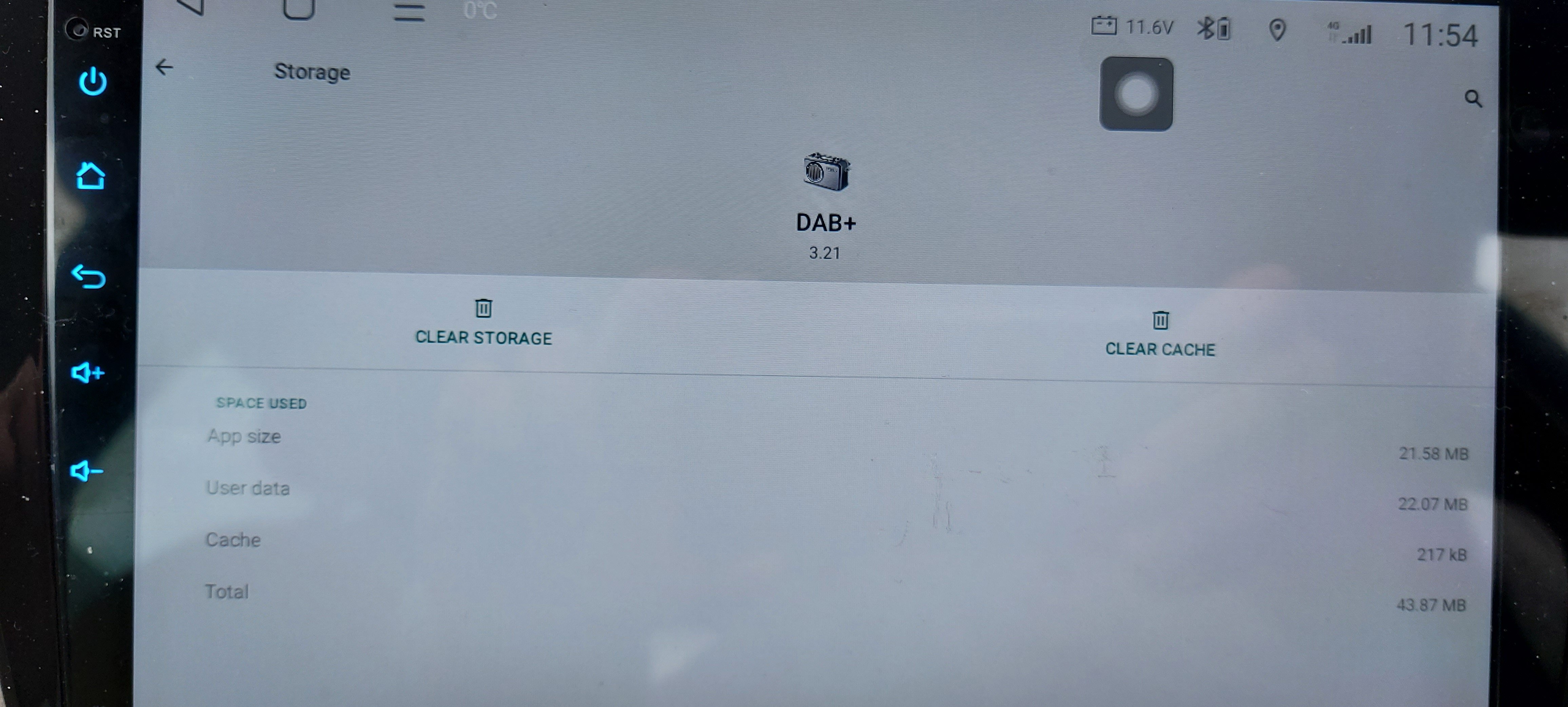

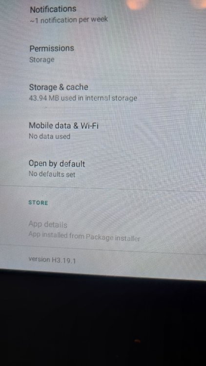

I can probably send you the apk from mine if that helps as it is showing as version 3.21.
Thanks for the offer, I will install the one I Found, if it is really 19.1 then I'll Keep the higher version
Might not be able to now😥 I thought I would click on the factory reset the one that asks for a password expecting it take me to another menu. 7890 is the password but it did not give me no do you really want to factory reset but it just went off and did it.

For the DAB+ you have the one from the link but it seems older than yours... I'll try and find a newer version

If you can extract the dab APK it would be cool
