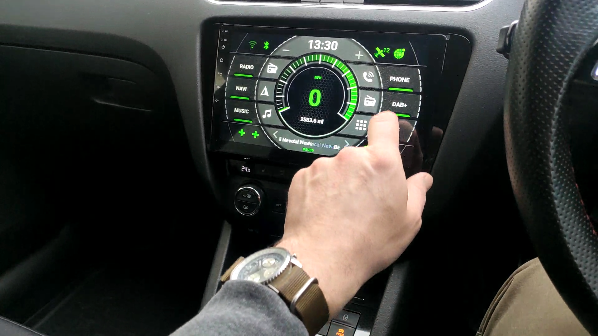

AGAMA. Tried changing the app defaults in AGAMA settings but doesn't seem to work. I found default nav app setting that worked in the car settings app.
On any of the options on home screen touch and hold the item like radio etc and it will let you do everything there, rename, which icon, which app its for etc I added one for DAB on mine so I have that and FM

Just now, FUBAR said:
On any of the options on home screen touch and hold the item like radio etc and it will let you do everything there, rename, which icon, which app its for etc I added one for DAB on mine so I have that and FM. You can add stuff to the little + symbols at bottom in same way too, I have one there for VAG DPF etc (not in the screenshot below)

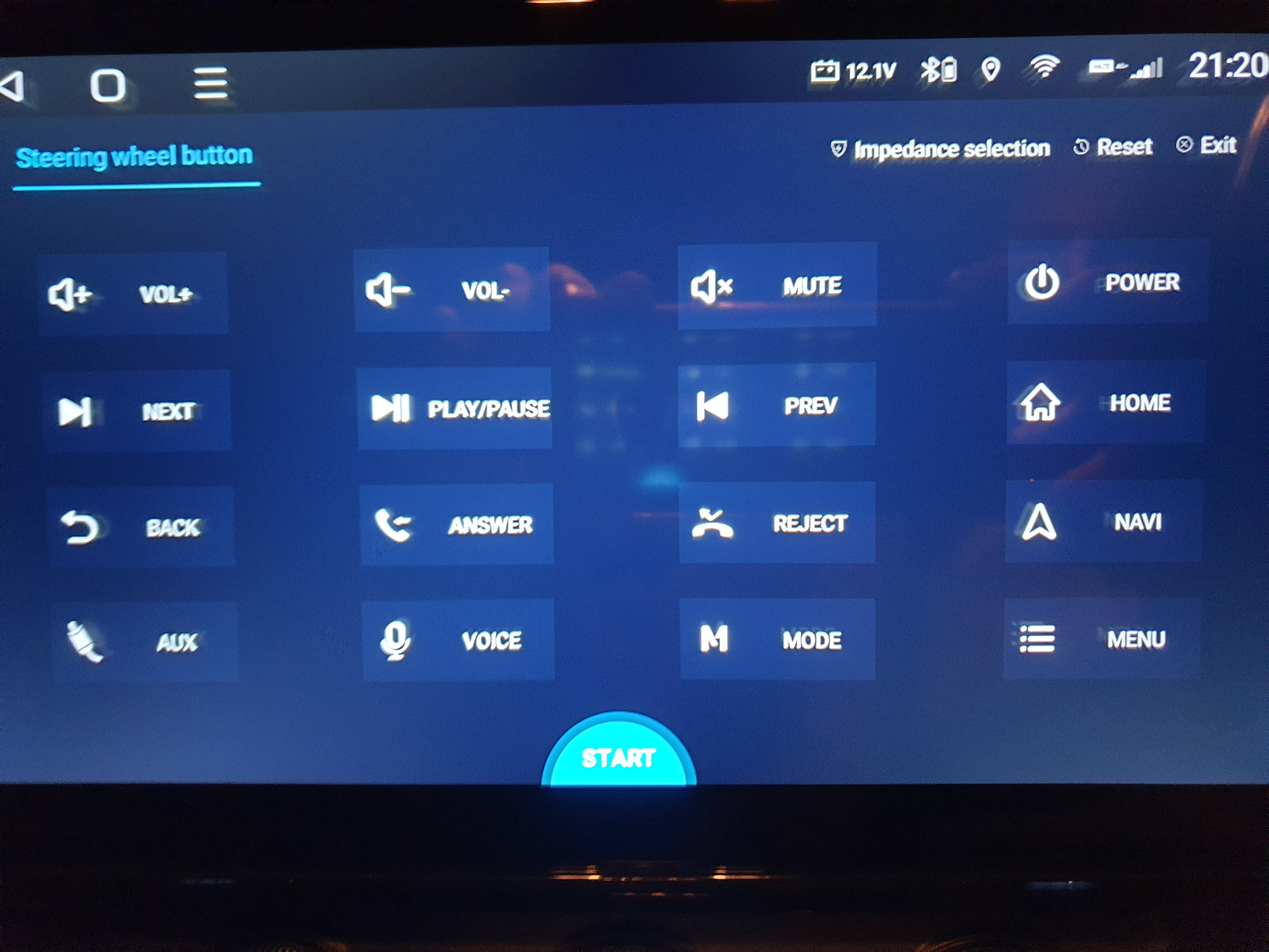

I've linked apps to RADIO/NAV/MUSIC etc in AGAMA as you've shown, but this only seems to relate to the AGAMA app. The default apps on the the mode button (circle with dots on left of photo) on the steering wheel aren't changed. When press the button it cycles through NAV/MUSIC/RADIO/AUX etc but with the exception of NAV they are all the default apps. Had a quick look on XDA developers forum and it seems other people have asked the same question for other android head units but there doesn't seem to be a solution.
The button mapping I was trying to use is the built in steering wheel button app in the photo attached not in AGAMA. When I press start at the bottom of this app, select the function I want and then press the button on the steering wheel it just activates the default button action rather than re-mapping it. I wondered if anyone else has sucessfully managed to use this app to re-map the steering wheel buttons? I see there is an impedance selection option which I haven't tried yet so will give that a go.

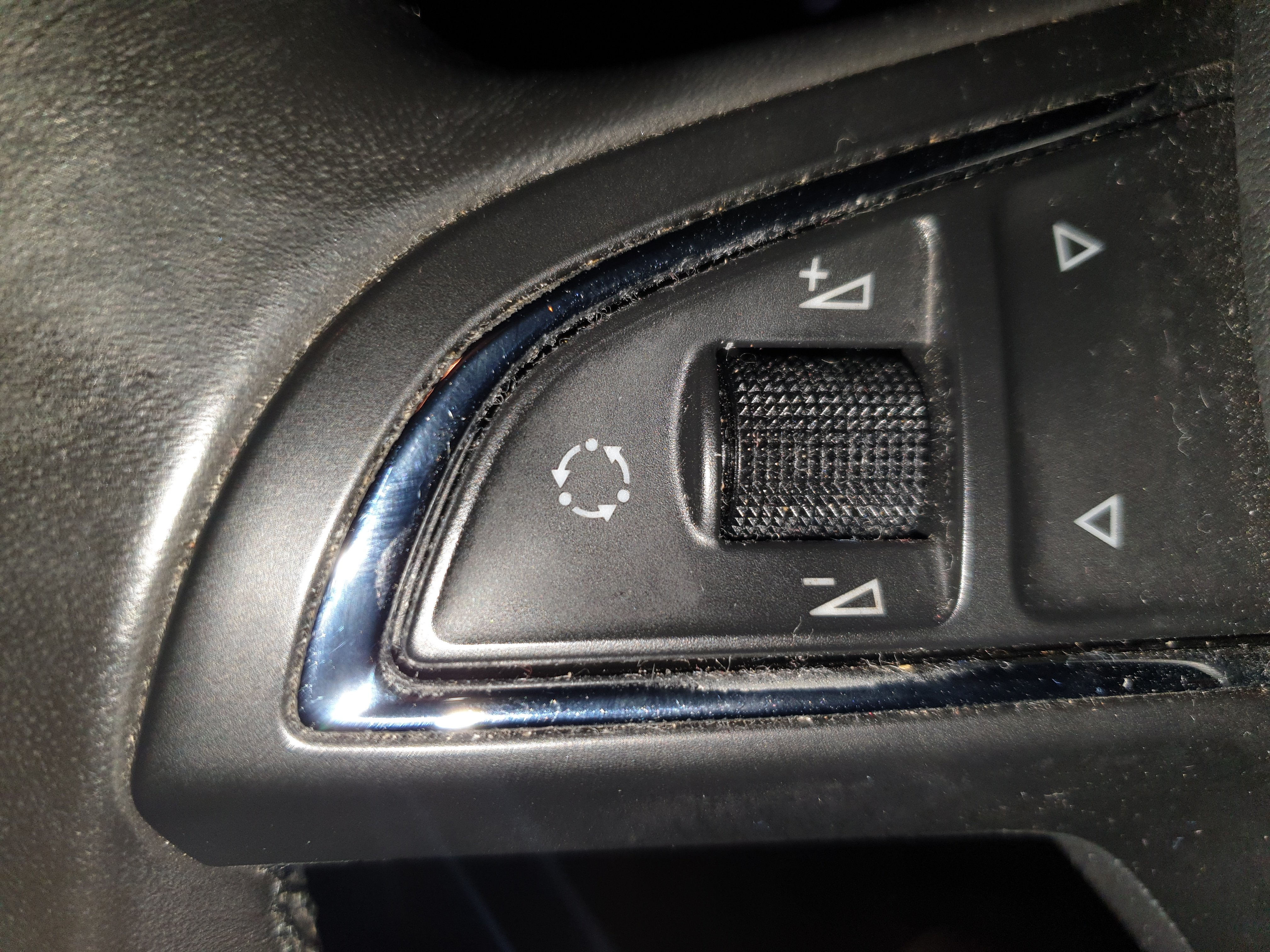

Has anyone figured out how to change the default apps you get when you press the mode button on your steering wheel (circle with three dots). It cycles through NAV/MUSIC/RADIO/AUX for me but I can't figure out to how to change most of the default apps.
I found an option for the navigation so I could change the default to Sygic, but can't find a way to change it so that the radio uses my DAB app, and PlexAmp for my music.
I had a look the steering wheel button mapping app, but couldn't get it to work either. Anyone worked it out?
I don't have the Mode button on my steering wheel, mine was I on the factory display unit, where your mode button is I have the search button so can't really help you sorry.

Well I think that the canbus calls the default apps of the Unit that are hard coded in the firmware. All other apps are added APK. I don't think what you are trying to achieve is possible.
I have the same button but never used it as I find it wothless to cycles trought the sources When you can just go straight to what you want with the screen.
I had an Amundsen mib1 and it has physical buttons for all the sources.

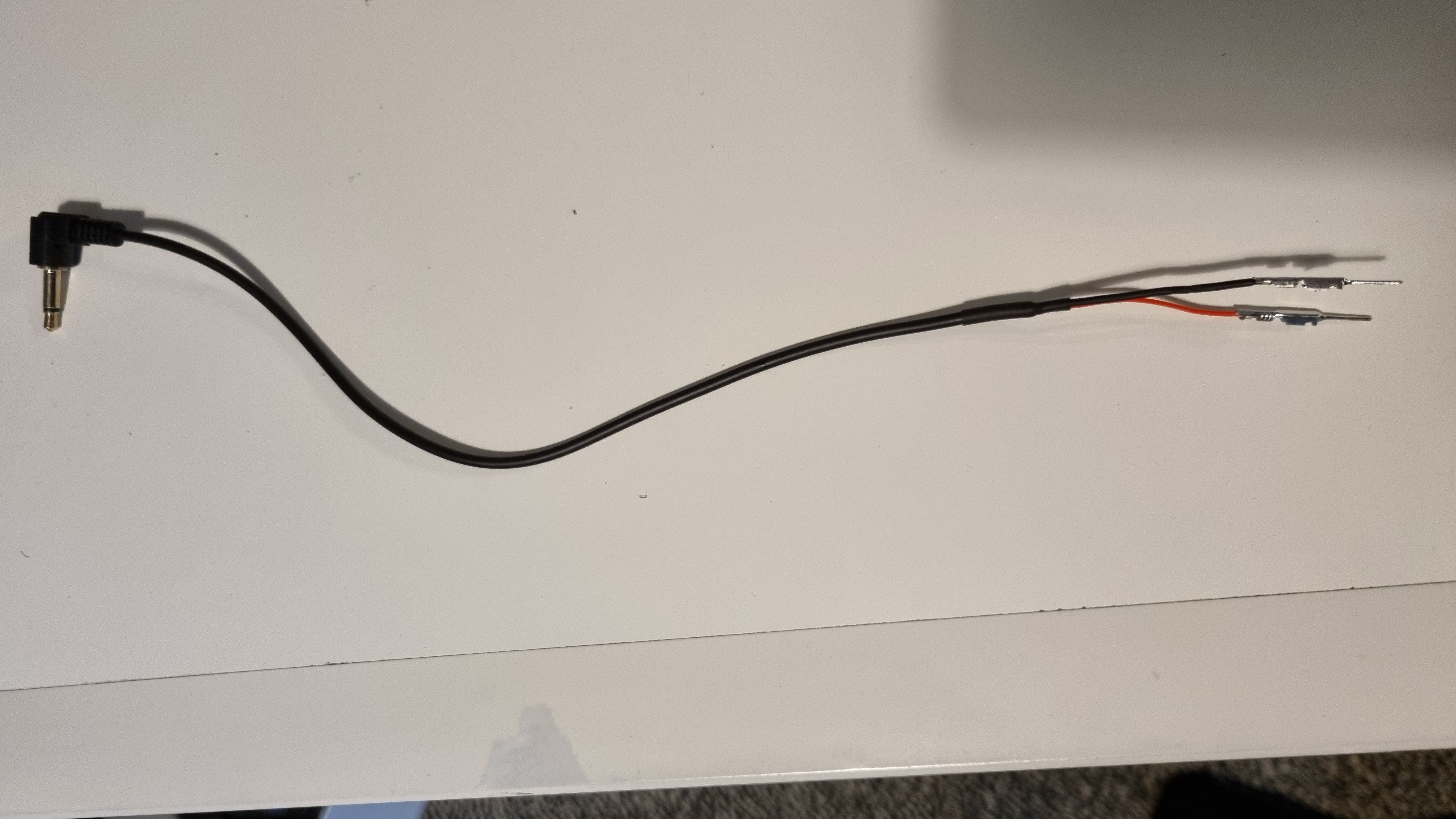

So I am scratching my head this evening. I built myself a neat cable to try the factory microphone.
The thing is when I use it, my voice is loud nice but there is a background noise like a bee hive buzzing. It as as if there is no ground. I tried all the combinations, inverting plus and ground, plugging only ground, only plus... The buzzing just won't go away. As I said, it is as if there is no ground on the cable. I don't understand... I tested the continuity on my cable and it has so Issues
Edited by nickytheshaft
I got the same sort of buzzing when I tried the factory mic and haven't got round to investigating any further on why it does it, I might look at it sometime in the future but no high on list of things to do.
I am trying to investigate, if I find something I will let you know
It seems the factory mic is an active mic, it needs power sent to it. Maybe the glove bow unit was taking care 9f that and that's why we can't get it to work with the Android head unit that uses a passiv mic
From everything I looked up nothing pointed to the factory mic needing a power supply and normal Active mics would have at least three cables going to it where the factory mic only have two. I think it might be an impedance problem.
Ok, you have more electric knowledge than me, I will wait for your conclusion. In the meantime, you should really try the mic FUBAR and I have put. It works really good with no parasites noise

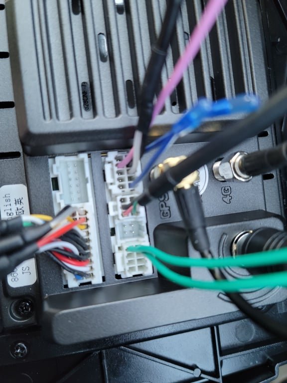

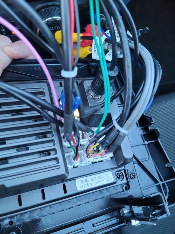

Hello,
can someone tell me what's on the CD on the right, the pink plug, the blue et the black one? Yellow is for the usb i think and white  the radio, is that correct? I just bought a Android head unit, and those cable aren't connected anymore.
Also the parking sensor is not working anymore any tips. i don't have a rear camera for info. The darkness came and  i had to stop couldn't see at all anymore i will have a look tomorrow .
Thank you for helping me,
Bryan

Hi, you can check here
https://www.forum-audi.com/topic-729-audi-mib-et-mib-mmi-plateforme-modulaire-dinfodivertissement.html
Pink is for the factory head unit display, you don't need that anymore
Blue is for the factory GPS antenna => you can use a fakra c male to sma male adaptor to use the factory GPS antenna and not set up the provided one
Black is fot ehe factory DAB+ antenna => same as blue, you can use a fakra c male  to sma male to use the antenna
yellow is for usb but it won't work unless you send the 5V to the quadlock. You can build ana adaptor like WAGSTER did or ask the seller to provide the correct cable (like I did) for 1$
Does your parking sensosr beep or does it just not show up on the screen?
If there are no more beeps then it is not related to the head unit, if it beeps but doesn't show up then either you did not plug it right, either you did non set it right.
Check the the canbus is connecte to 2 sockets, one 16 pins ans a second one, a small one goes from the canbus to the head unit, it has only 2 wires and is easy to miss.
Then you must enter the factoey setting, use password 123456, canbus settings and select raise / vw MQP platform (in my case I use simplesoft).  you need internet cinnection while doing this.
The unit will reboot, then reboot a second time.
also check for any system updates.

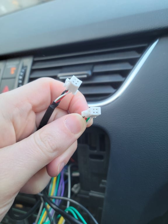

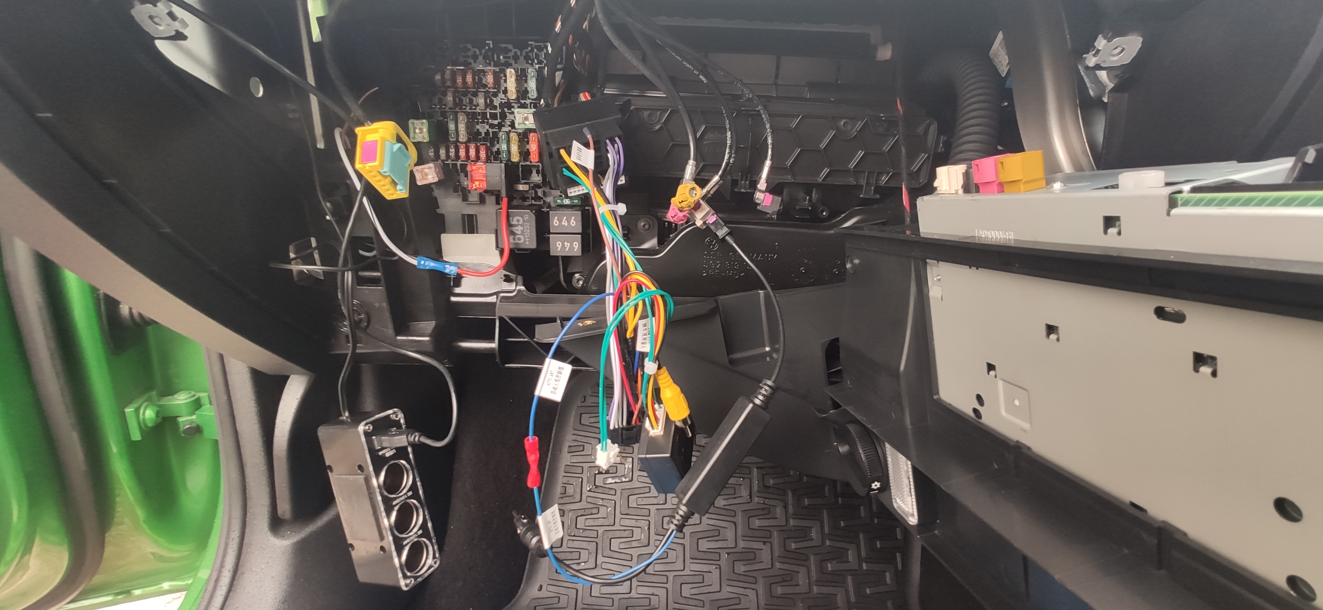

Thank you for you fast answer,
Sensors work well now , i didn't set it right, or maybe not plugged at the correct place,
(first pic), on the left usb pin and on the right i don't know, it's only connected to the big big plug ,  (second pic) at first i plugged the right one to the 4 pin plug next to the green cable, and i try to plugged the 4 pin usb at the only plug free. This usb cable didn't work, today after switching those two the USB is working. and the other i don't know what this is. Is this what you talk about  "a small one goes from the canbus to the head unit, it has only 2 wires and is easy to miss. "
(third pic) i switched place of those 2 cables it seems to work,

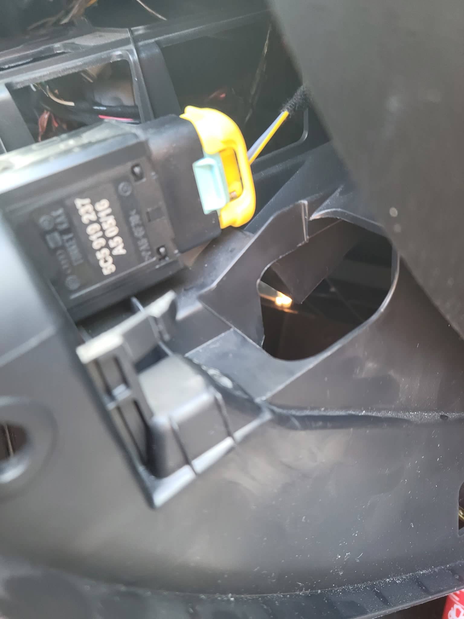

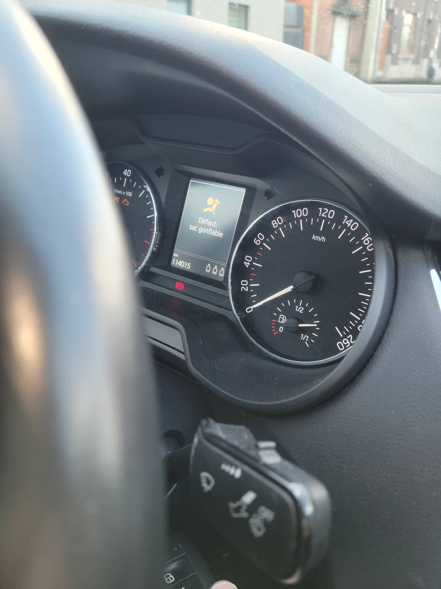

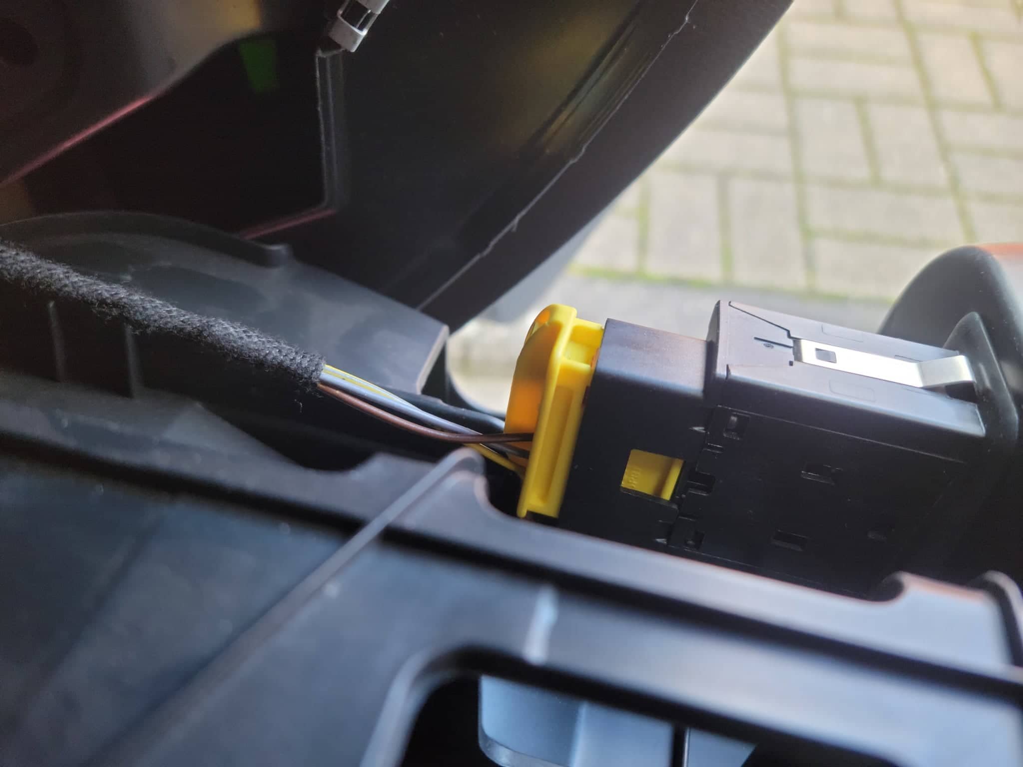

( 3 last pic) Now i have other concerns, this is the airbag passenger , to make all the connection I remove the glovebox and the 3 plugs was connected 1 the tube for ventilation, 2 glovebox light, and the airbag plug.
Could it be this ?
  • Baisse de la tension de batterie :
Le calculateur d’airbag est un élément sensible qui est susceptible de réagir anormalement lorsque la tension de votre batterie tend à baisser. Ce désordre est dû au fait que la batterie a du mal à activer le moteur quand la tension chute. Cela provoque un problème au niveau du voyant airbag
Low battery voltage:
The airbag computer is a sensitive element which is likely to react abnormally because the voltage of your battery tends to drop. This disorder is due to the fact that the battery has trouble activating the motor during the voltage drop. This caused a problem with the passenger airbag.
I used the android system for a while without turning the engine on,  i drove a mile then but the issue is still there..
thanks again for the help

I will try and answer a couple on the usb connectors side but will respond better when I get on a computer.
To start with how many white connectors to usb female connectors did it come with?
Were they 6 pin white with all 6 pins wired to how many female usb's?
Did they give you a 4 pin white to female USB?
The 4 pin white that goes to the big black connector as you put it, can you take a photo of what color connector and what pins it goes to in the big connector.
The 8 pin white connector that only has 2 green cables is what comes from the canbus  box and you have that in the correct place.
Regarding the airbag problem, did you turn the ignition on with the airbag switch disconnected? If you did then you will probably need to get the fault cleared from the ECU and you will need to get hold of diagnostic equipment to do that.
What seller did you buy the unit from and did they give you any wiring instructions for it?
I took this one https://fr.aliexpress.com/item/1005003491079037.html?gatewayAdapt=glo2fra&spm=a2g0s.8937460.0.0.5a3f2e0evR3hMu
few instructions here https://fr.aliexpress.com/item/4000661674334.html?spm=a2g0s.imconversation.0.0.62163e5fzfbHBB
It came with 2 female usb, 4 pin and 6pin,
The other 4 pin is black, green, withe and red, i just checked the link above, and it could  be the radio interface...
But now everything is working, i asked just to know but it doesn't really matter if all is gooing smoothly.
Yes i did turn on the ingnition with airbag disconnect, to see if the Android multimedia works, before rebuild everything and see there is a problem as always when i do something.
Could i do it myself with this ? https://fr.aliexpress.com/item/1005003488723366.html?gatewayAdapt=glo2fra&spm=a2g0o.cart.0.0.54143c009IsXOC&mp=1, after googeling it i saw some tuto to cancel the fault,
I actually have no rear cam, and hesitating to buy one, but if it is a lot of problem like here don't know if i will do it or rather manage it
Thanks again
