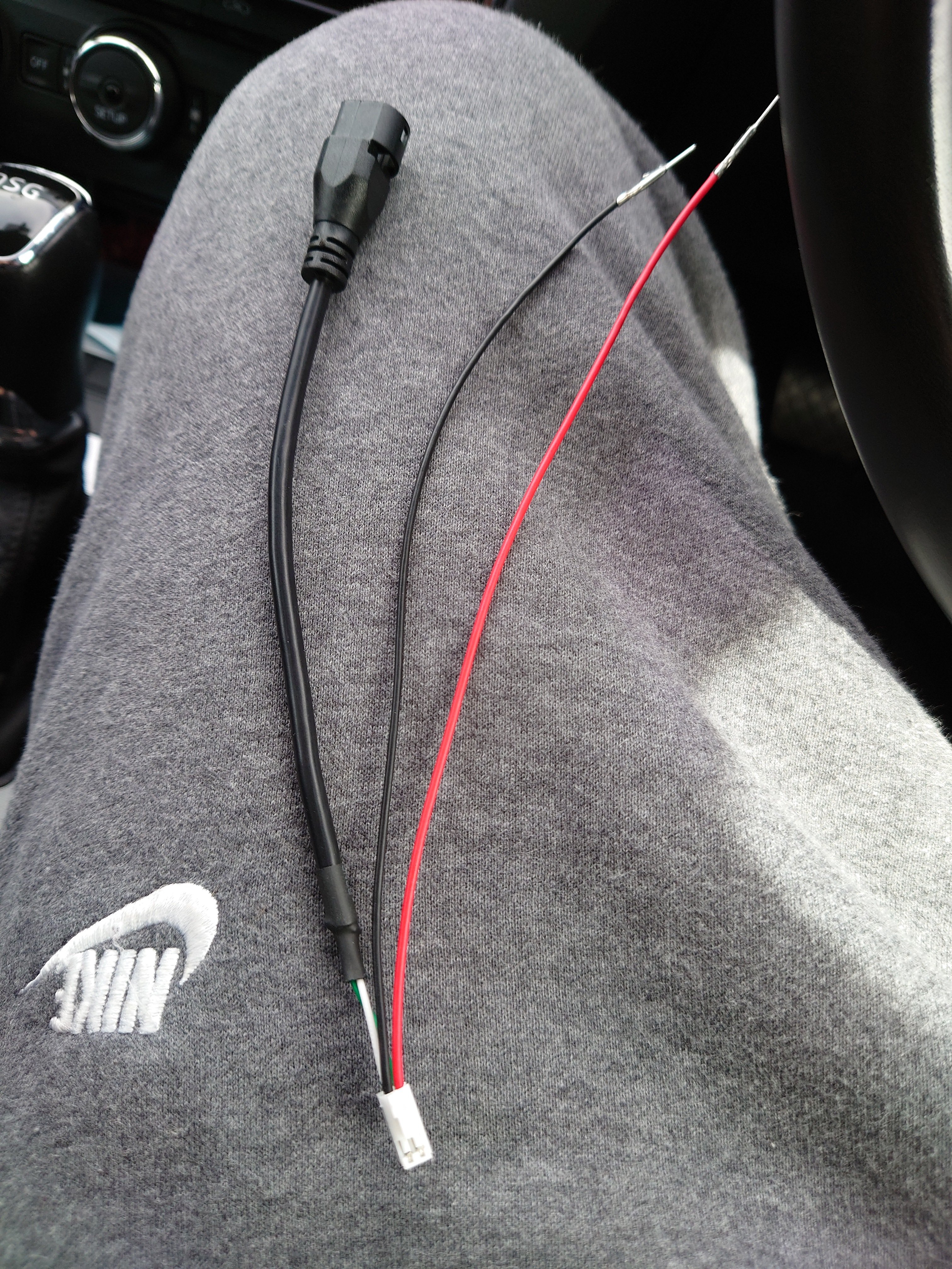

It's probably my being a novice, but I disconnected the original part (the one that connects the female usb adaptor to the male USB A cable that connects to the yellow fakra), then wired in the 5+ in C3 and ground to C4 as instructed, then connected it again to the yellow fakra.
Must admit it was much more of a tight squeeze connecting it all up without that previous USB extension being used. Only when I powered the unit on, still none of the USB sockets get any power.
What am I doing wrong? 🤓
did you connect the white 4 pin connector straight to the head unit il the rigt place?
youshould test the leads on th 5v wires to see if you have power on theme.
Also check if they did not ivert live and ground.
Alsi make sure that you have cables on the other side of the quadlock going into the car.
I sold my unit so I can't show you pictures
@nickytheshaft while your hopefully still on, which one is ground and which one is 5v
Infact, I might be OK, the extended loom that I was given before has those two pins.
Going to fit that and see what happens.
Ground is black and 5v is red
Cheers, got it fitted into the loom, just not enough wire to get it into the back of the stereo. Looks like I'm going to need to do some cable snipping and extending.

See the cable for the main USB, to extend that, what cable type should I look for
Once I went into Legacy, it showed it there, but the tick box was blanked out and I couldn't select it.
Ran a scan and nothing.
To extend the USB data cable i would just find an old usb lead or even a phone charging cable and strip the outer insulation off it and use the in cable inside, it is only data signals that you are extending so doesn't need to be that hefty, you could even use the a twisted pair cable from a LAN cable if you wanted.
