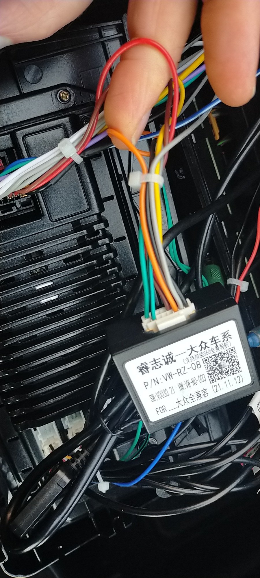

4) I have the same query with the extra 4pin in the main wiring block.  I connected it thinking it would maybe sort out the cars built in usb port and jack but it doesn't.  All is working but I have the 4pin usb sitting spare just now and ongoing discussion with JS to establish what the 4pin I have connected is for.  They think I have 2 x 4pin usbs just now 😞 I have attached a pic of the wiring as it is atm without the the 4pin usb attached.
I disconnected the airbag as well before I had realised what I had done but managed to clear it and 4 other faults at the same time with my OBDeleven, no problems since.

4 - the Factory usb won't work unless you send the 5v to the quadlock.

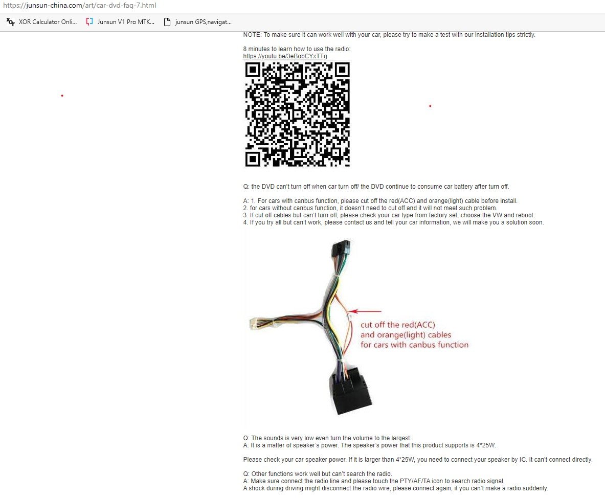

 @bryan008 Junsun have let me know that the 4 pin usb that we have connected to the headunit from the main loom is for carplay and the front camera only so if you don't use those you can take it out.  I have disconnected it and connected the spare 4 pin usb instead for updating the firmware and it updated fine and the basics all work fine still.  I will need to go and add all the other details as I had previously.

well yout unit is different than ours. On the other hand, I think that it is better. One of my friend has one and it runs flawless compred to mine.
for the record, the latst update on the T18 is from late february.
I don't understant this cutting wire stuff. In our units, we have an option to put it to sleep for 2 hours, 1 day, 1 week... or no sleep.
You should check if you have this menu and ser it to hours if you take you car often and don't want a complete reboot at each time or simply to no sleep if you want it to shut down completely.
When I get to my car, I will check my harness to see how it is wired.

Junsun head units are slightly different compared to what we have fitted. That is the reason why you cannot find the themes app as i do not think it runs a theme launcher as such and most people with your type of head unit install 3rd party launchers. As i have no real knowledge of using your type of setup it is hard to provide help. You might be best taking a look at the the forums on xda https://forum.xda-developers.com/t/junsun-v1-pro-megathread.4385315/ where you might get better help.
Anyway yes you will need to cut those 2 wires as you are using a canbus box. With a canbus box connected the power ACC power supply to the head unit is controlled from the canbus and only powers on when the ignition is switched on, by having those 2 cables still connected you are basically providing permanent power supply to the head unit that will cause the battery drain. On our head units we do not have those 2 cables so nothing for us to cut.
By what i have read on the Junsun units they do not have the option to update OTA and can only be done by USB and the files are provided by Junsun directly when you ask them, on the XDA forum they do have all the firmware files available to download when new ones are released.

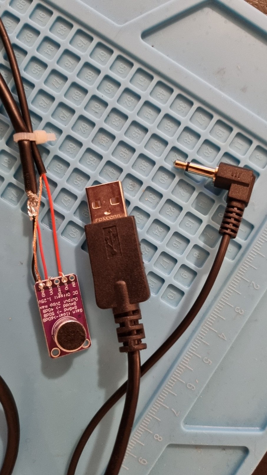

So I got a little impatient waiting for the amplifier board and just got this kit on Amazon
DollaTek MAX9814 Electret MIC Microphone Amplificateur Module Contrôle Gain Auto pour Arduino https://www.amazon.fr/dp/B07DJWQDQF/ref=cm_sw_r_apan_glt_i_7RY2RWA13BZJ3YPDYZ94?_encoding=UTF8&psc=1
I hooked it up to the usb port supplying only power.
I set the board at 40db which is the lowest setting. It still gives a huge amplification. The mic may need to be equipped with a foam screen.
The other board I am waiting for is 20x amplification at the minimum setting, wich I think, is also 40db if I am not mistaking.
Anyway here is a little sound clip I took with mic tester.
I also left a voicemail with the mic gain settings in the Bluetooth app to low.
Tomorrow I will try putting a screen on the mic.
So basically, we are going from too low to too hight...

Just a wee update..
I went for a quick spin round the block earlier and the speed was now reading correctly and changing from kmh to mph on the main screen, the firmware update obviously did the trick! 🤷🏼‍♂️👍🏻
I was also going to cut the 2 wires to prevent the battery draining as well but had a look and they looked to be connected differently to the diagram so thought better of it. The red and orange wires on the diagram look like they go from one black block to the other but mine go black block to white canbus block. Waiting to hear back from Junsun again..🙄🙈
So I just put a foam screen on the mic and left myself a voicemail.
Here is the file, the sound is preety good. A little loud but no parasite noise. A 20db amplification would have been great but this is way better than the stock mic or simple external mic.
In fact, the unit does not provide any amplification what so ever. The factory unit, I think must have an amplifier.
I will check with an electonician friend is adding a resistor to the cable going to the unit can reduce the gain.
20220308_085000_r0325247915.wav

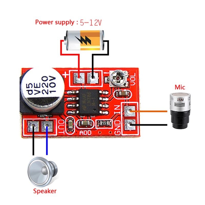

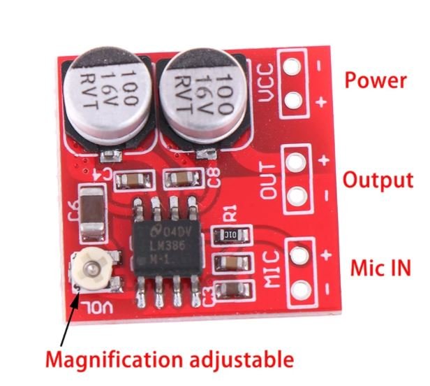

Might be an option to use just an amp board and connect the factory mic or external mic to it.
Yes,
I am waiting for this board from aliexpress. I took the one from amazon in extra because I was impatient to hear the result of an aplifier board on the unit.
It is plugged to the external mic jack.
I opened the unit and it is quite impossible to connect anything to the inbuilt mic. It is soooo smallll and connected to a ribbon.
The goal is connect an external mic to the board, hide the mic somewhere then connect the board to the external jack and usb for power.

If i was going to do it i would ultilise the 2 connections for the factory mic that are connected in the quadlock connector , i have already added in the 2 extra connectors to the chinese connector to connect to the factory mic and it worked but was poor quality so would only need to connect the amp board inline inbetween the chinese connector and quadlock :)
It is an idea but the last time I tried it (without an amplifier board) all I got was buzzing....  I will give it another try When the board arrives

I've bought and installed a 4GB/64GB unit and it was not complicated after watching the videos and following your advice.
The only thing not yet working is the existing USB port and one of the double USB cable ports - has anyone found an easy fix to this issue that doesn't involve splicing cables/creating new ones? Oddly, when I contacted the vendor, he says to try to reset the unit...
In short the answer is no.
As you might have picked up on in previous threads about this, the only way to get the factory USB to work correctly if you have the factory USB type that has the +5volts and ground connected on the external part of the USB socket, is to splice in the required 5volt power into the quadlock connector. The onlt other option you really have is to replace the existing factory USB with a version that has the +5volts and ground wired to the internal pins of the USB socket.
The way they have designed the double USB cable is that one USB will work as normal and the other only supplies 5volts that can only be used for charging something. What i did was use the USB that only allows charging and cut the end of the USB and spliced that into the quadlock connector to get the factory USB to work.
Speaking to the vendor with most of our problems has always resulted in them not having a clue so get used to it :)
