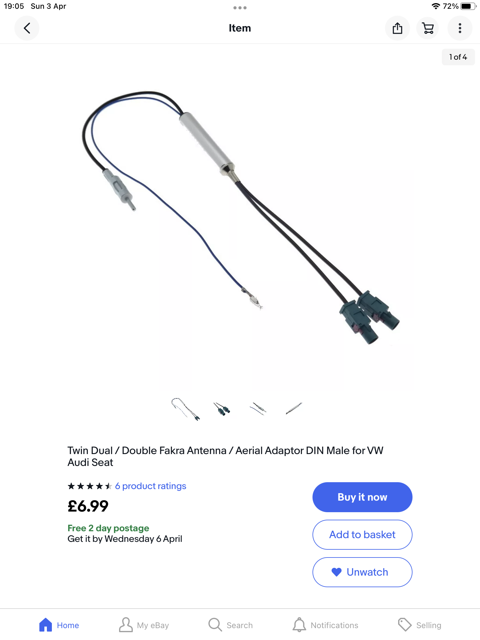

Depends on where you want to buy the adaptor from, how much you are willing to pay and how long you are wanting to wait to get it delivered, cheapest is AliExpress but also the longest delivery time, most expensive is Halfords but probably the the quickest to get it if they have it in stock in store, just google Dual Fakra to FM and take your pick from Amazon, eBay, Connects2 AliExpress etc. Just make sure you get the one with the power feed and yes no matter whether you are using the single or double version make sure you connect the blue power feed.

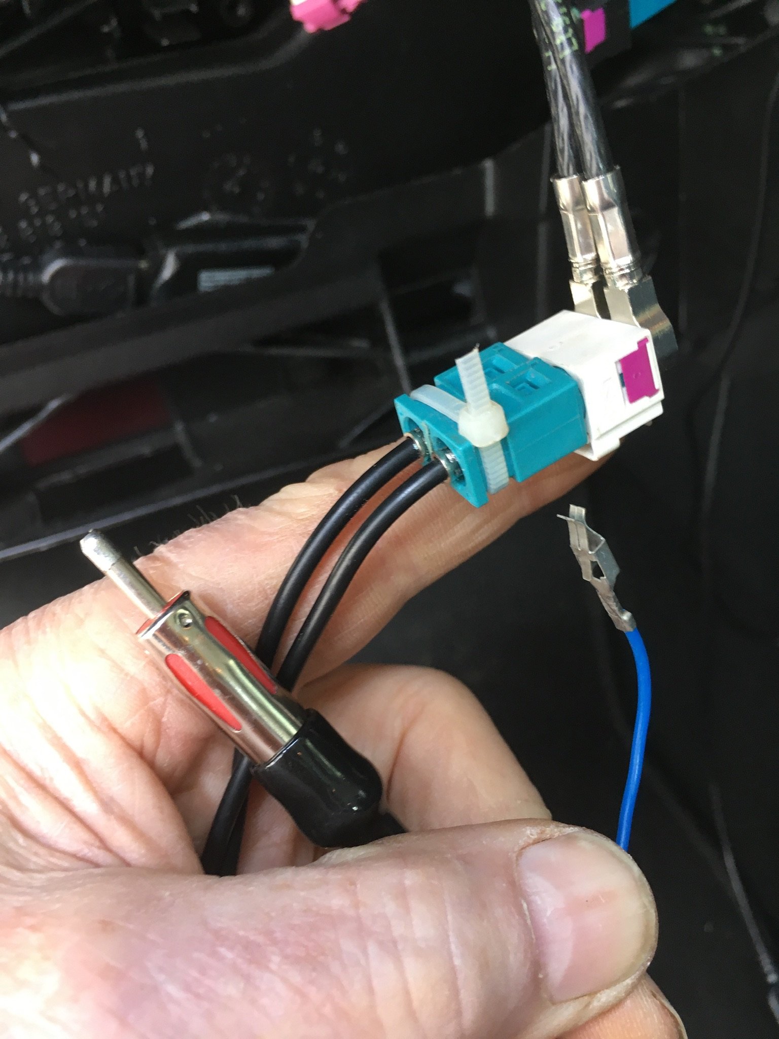

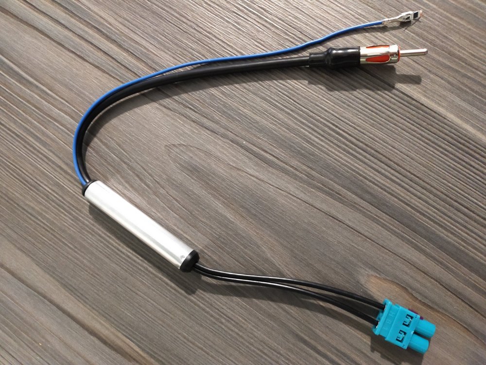

Di-Greenio, bought fm twin Fakra from eBay £7 which had 2 separate Fakra connectors which when held together had a wider pitch than factory white Fakra on car, so filed each plastic body slightly to match and also removed locking spigot on one Fakra, then tywrapped together to ensure both locked by remaining spigot. See photo. I never found a setup with correct twin white one piece connector although twin Fakra connectors are available and didn’t foresee the wider pitch problem. There are cheaper from AliExpress as Wagster described but delivery times means installation goes on forever

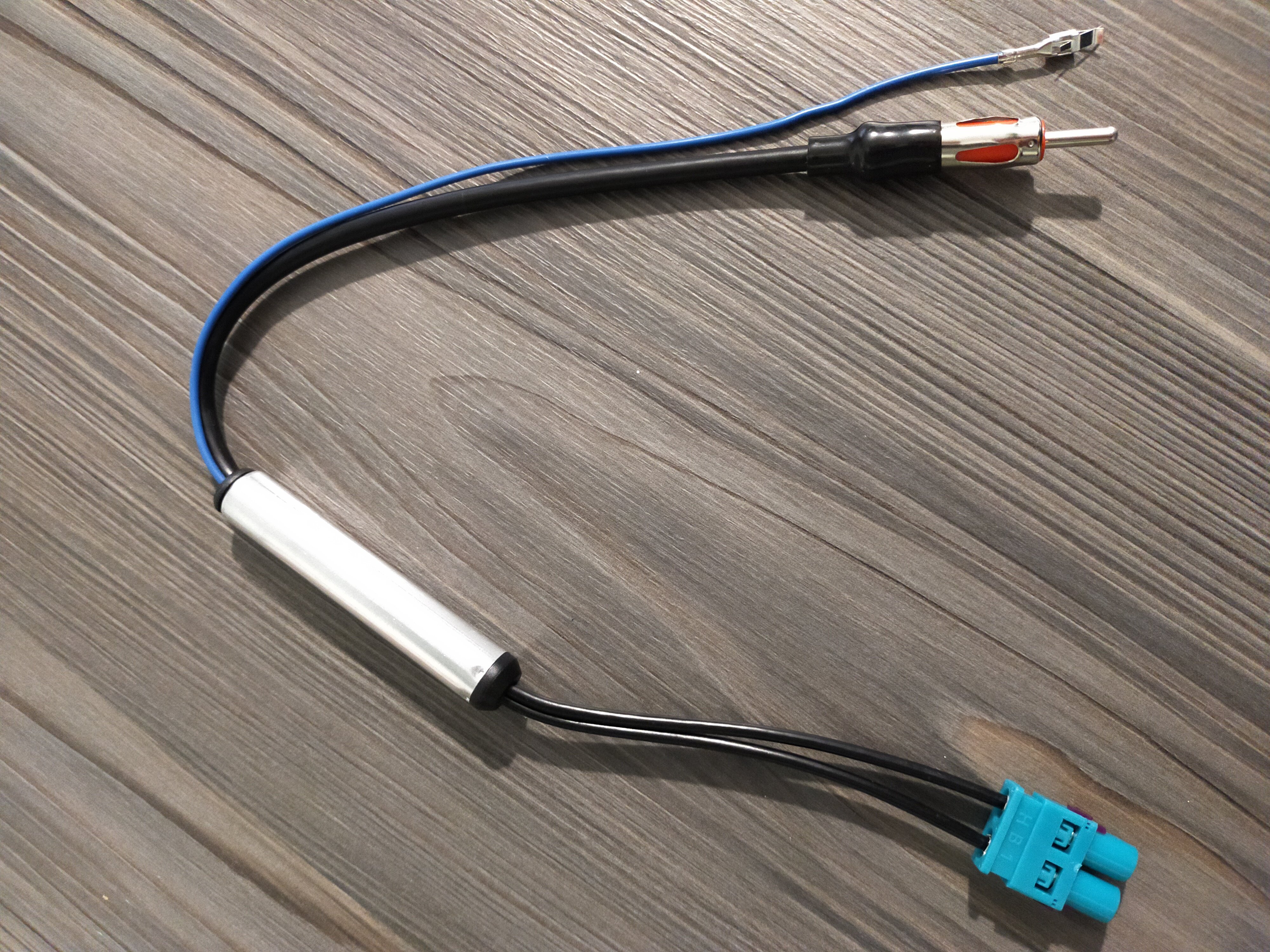

I bought this one
US $5.89  40%OFF | Vtopek For Volkswagen Wire Dual Antenna Adapter TX
https://a.aliexpress.com/_mPqLGOS
The only thing I had to do to it was trim off one of the locator lugs on the side to make it fit, nothing to it just a quick trim with a sharp knife and then it fits perfectly

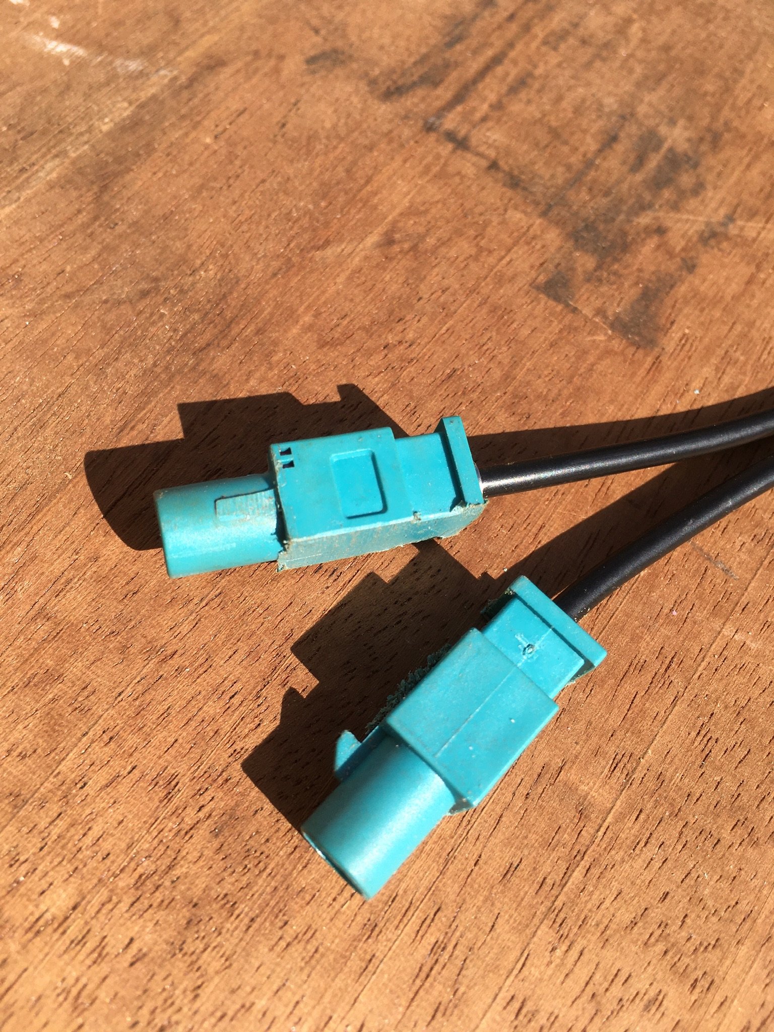

I also ordered the dual fakra to FM yesterday and unbelievably it arrived today too. That's doesn't usually happen in the North of Scotland!! So now all I need to know is how to connect the blue wires.. what a noob!🤦🏼‍♂️😂  I'll need to trim back the blue coating on the wire at the radio side but what do I need to actually connect them?? Every day is a school day...

Where in the North are you?
It friends on what items you have available to join the two cables together.  You just trim the outer insulation off the end of the blue radio cable and put a female bullet crimp on it and connect that way or cut the crump off the dual FAKRA blue cable and connect using a choc block connector.
