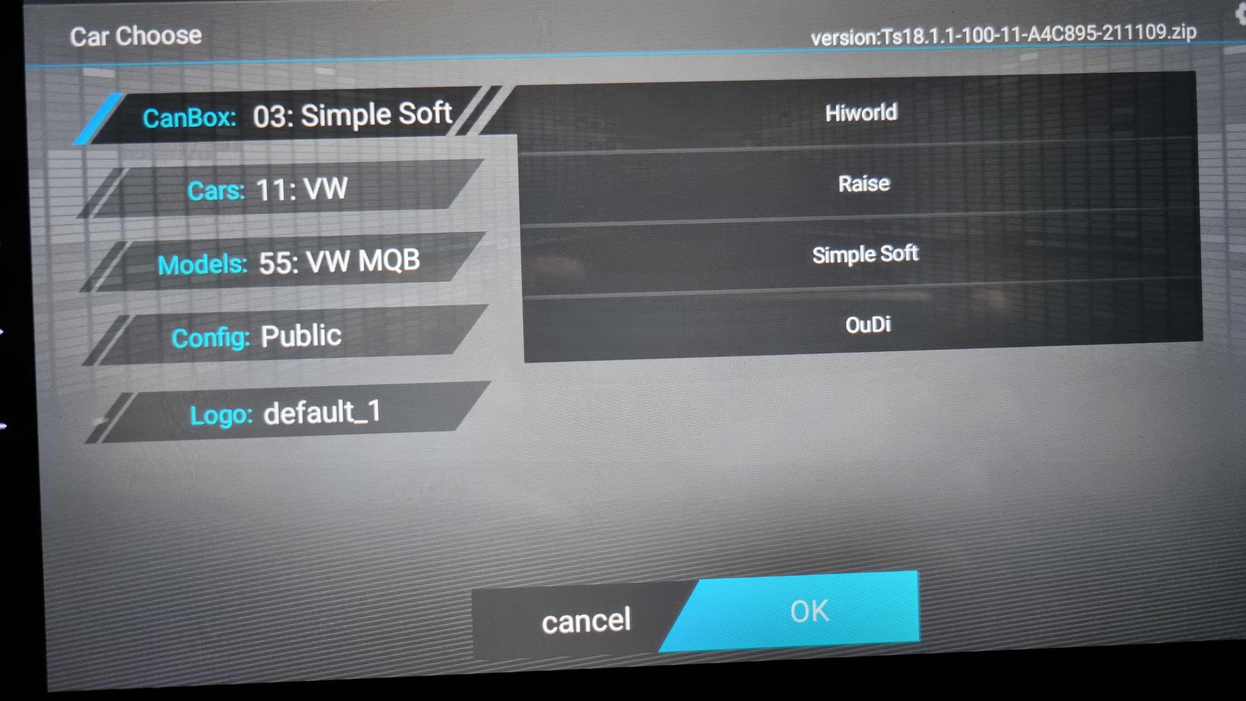

So after playing around with the settings, I noticed that simplesoft works better than Raise. Using it, all my parking sensors issues are gone.

For the canbus settings, I didn't notice any missing settings (at least that I use) between simple soft and raise.

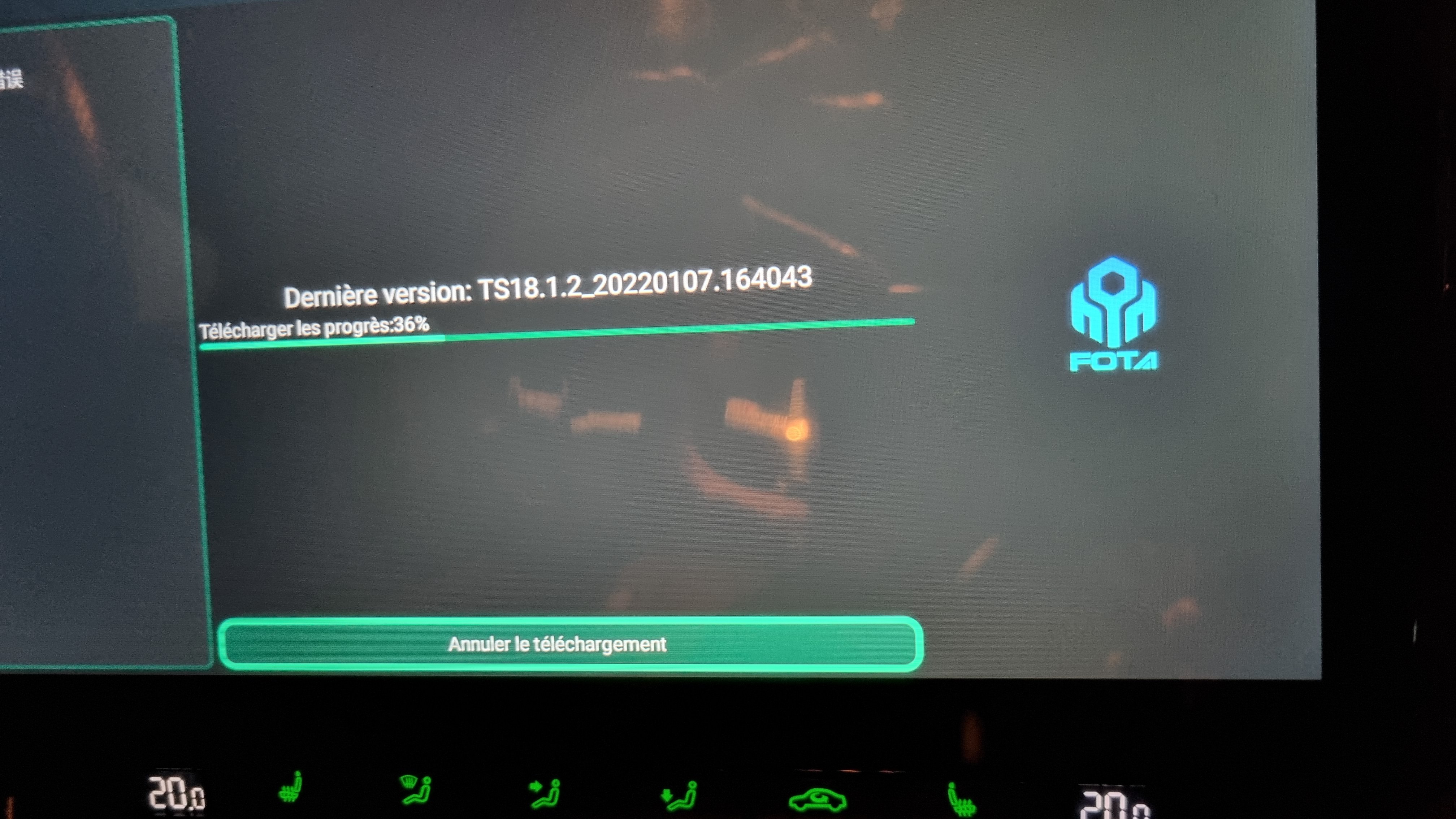

There is a new update
The unit feels more snappy now

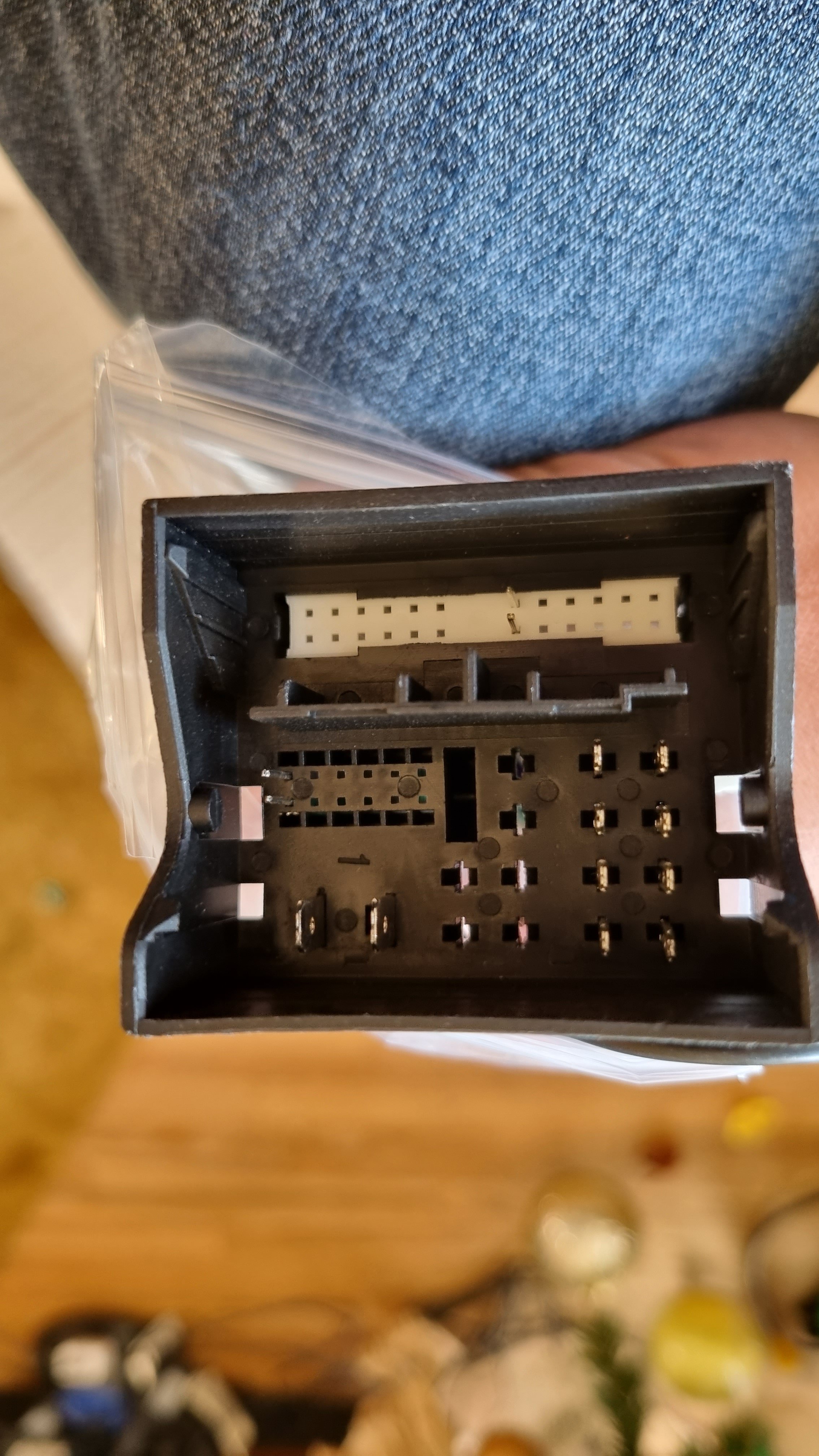

So my cable has arrived pluged it in the harness and now factory usb is working, data and android auto.
I hope the seller now provides it to any new customer.

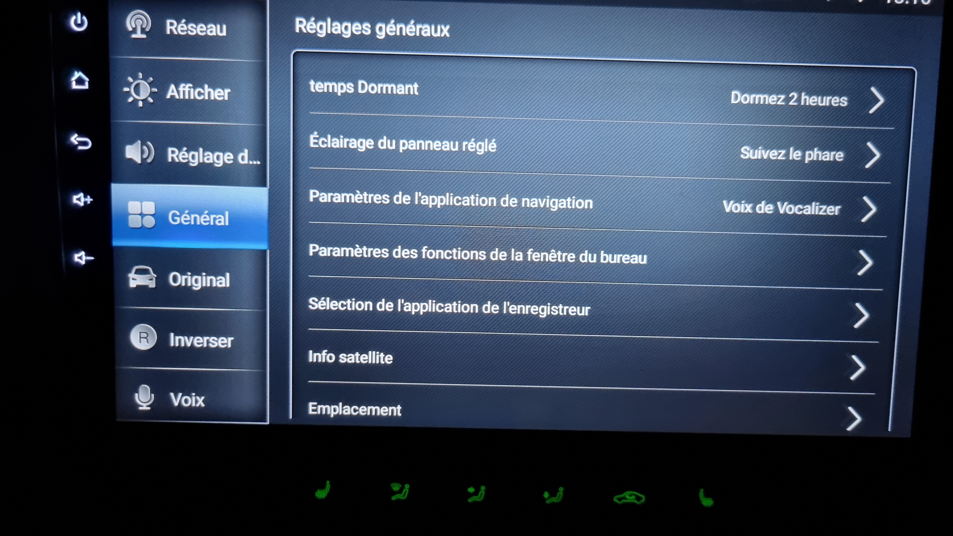

i will add that if you don't set a sleep time, the unit will stop drawing power as soon as you open the driver door. It cuts off all the power.
I set mine to 2hrs sleep so that twhen I go out and in, I don't go trought the whole boot up sequence.
One major difference with the factory unit tough, when you stop the car, the factory unit would stay on until you open the driver door.
This unit will stay on as long as the matrix screen is powered. Once the screen switches off, bam, the unit will go to sleep. So you can't listen to the radio for a long periode of time with the car turned off.
I think it lasts something like 10 minutes.

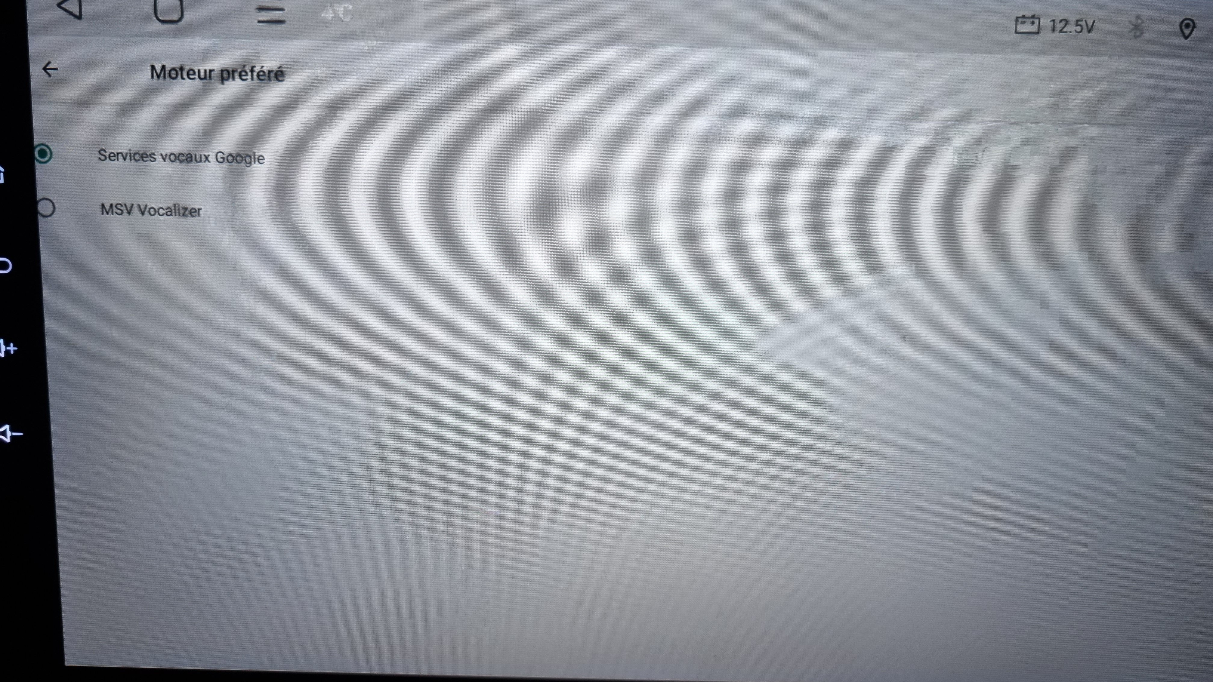

Wagster, for your TTS issues, on my side, I finally baught a voice with vocalizer.
Then strangely, set Google Google engine as preferred engine and vocalizer as navigation app.
Then no issues with Waze. It muted the radio.

I managed to get it working without having to install any tts other than the Google version.
Figured out that I hadn't set anything as the navigation app application so set it as Waze then by going into the sound settings and setting the navigation volume to max and the background volume to a lower volume I would have the tts work correctly by either lowering the music volume or if the background volume set to minimum everything will mute apart from the tts.

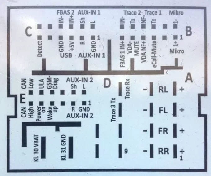

So the seller has agreed to send me the modified factory USB cable (for a charge of $1!🤨). Where and how do I connect the additional power wires from the cable to?
Also is there anywhere that tells me which 4G bands this unit is compatible with? I'm thinking of getting one of the 24 month Three 4G data SIMs from Amazon, but wanted to make sure it will work before I purchase.
1 hour ago, londonmoog said:
Thanks everyone for your help so far.

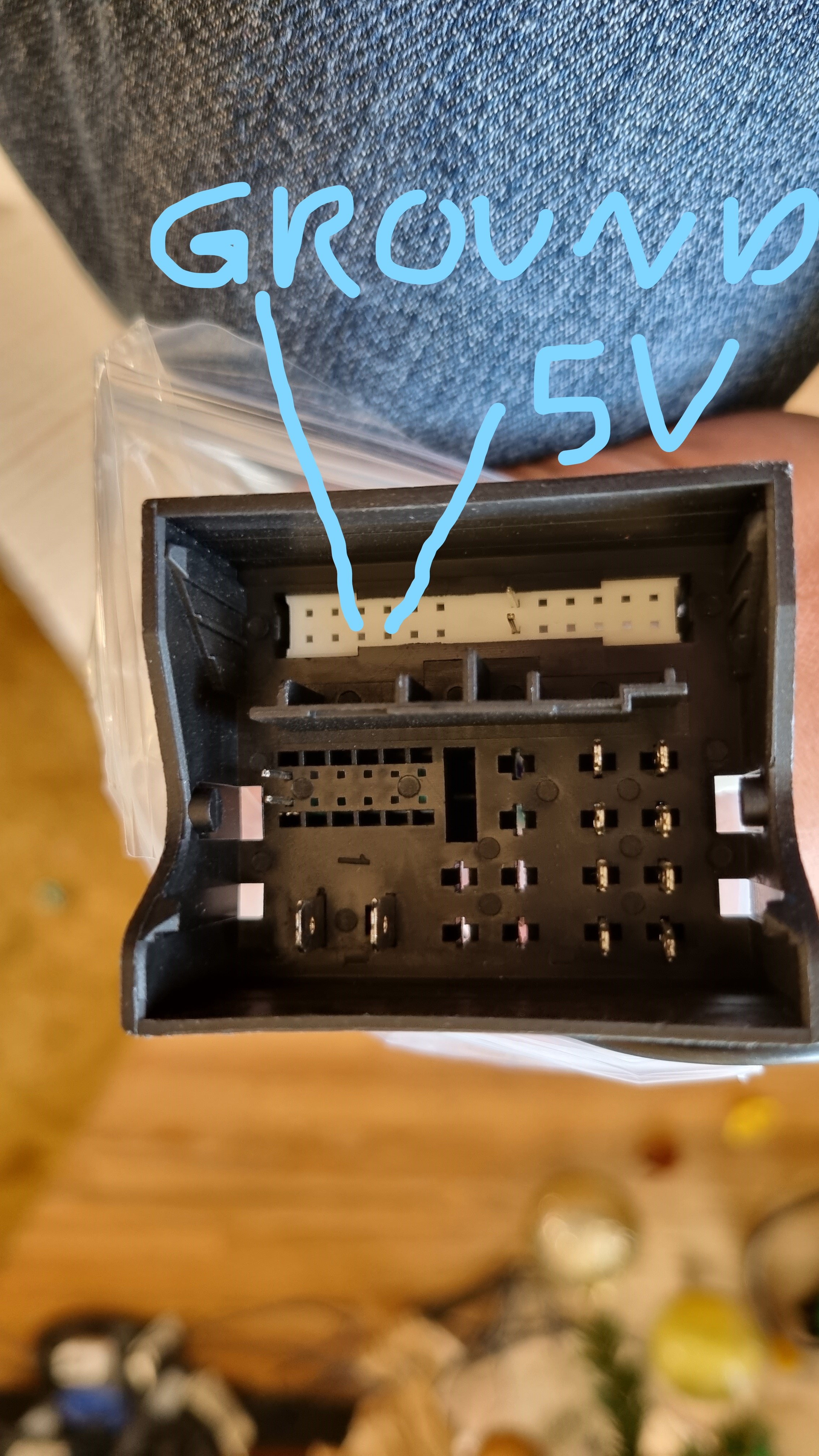

Here is a front view of the provided quad lock and the schematic of it.  You should pout the 5+ in C3 and ground to C4 (the white connector) and you are good to go.
Edited by nickytheshaft
Thanks much appreciated. Fingers crossed it works!

I've bought the DAB USB dongle, and that seems to be working as well using the Fakra to SMA lead from amazon.
FM Radio working with two blue wires connected together for power.
Software updated to latest version.
