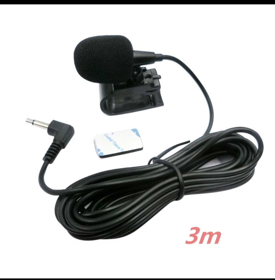

So I recieved the same mic as FUBAR has, I lesft myself 2 voice mails, one with the ibuilt mic and one with the new mic. I must say, on the voice mail, we are way ahead of the inbuilt mic. The sound is crisp and clear. The car was stationnary so I have to call someone while driving and see what they have to say.
Then I will test the factory miconce the harness arrives.

As I have mentioned in previous posts when I tested the internal mic, an external mic and also the factory mic, the factory mic seemed to be the worst out of the three, I always tested with the car stationary and engine not running.
Anyway, today my wife phoned me whilst I was driving and she complained that the call was bad and to her it sounded like a wasp or bee was humming down the phone to her, on my side everything seemed clear.
When I got home, I decided to run some more tests using the microphone sound test app that I had installed but this time with the engine off then engine running. I tried with the internal, external and factory mic and the results were that with the engine turned off the sound quality on all three mics was ok but with the engine running I can clearly hear a humming/droning noise on all three mics as if the head unit it picking the sound of the engine running, if I increased the revs on the engine the humming also got louder.
I might have to dismantle the head unit to investigate a bit further but I need to do some research first.

Just carried out a quick test call on my unit using the built in microphone, by leaving myself a voice message. Quality seemed OK (I think!). Tried with engine idling and reving up a bit and still seemed OK. I suppose it might be different after a while or when actually moving with all the road noise, so will test properly another day.

I don't have the buzzing you have. On my side it was like talking in a jar and all deformed. With the flat mic it was the same thing. With the new mic that has foam around it, I just sent a voice mail while parking in my garage and reved the engine. No buzzing and everything was good quality and very audible. So I can't see where your humming comes from....
Next step is to have a real conversation and see how it goes.

So I made a phone call while driving with this mic. On the other side, I was heared clearly. No buzzing or droning, only a slight metallic voice but perfectly quiet, audible and loud.
