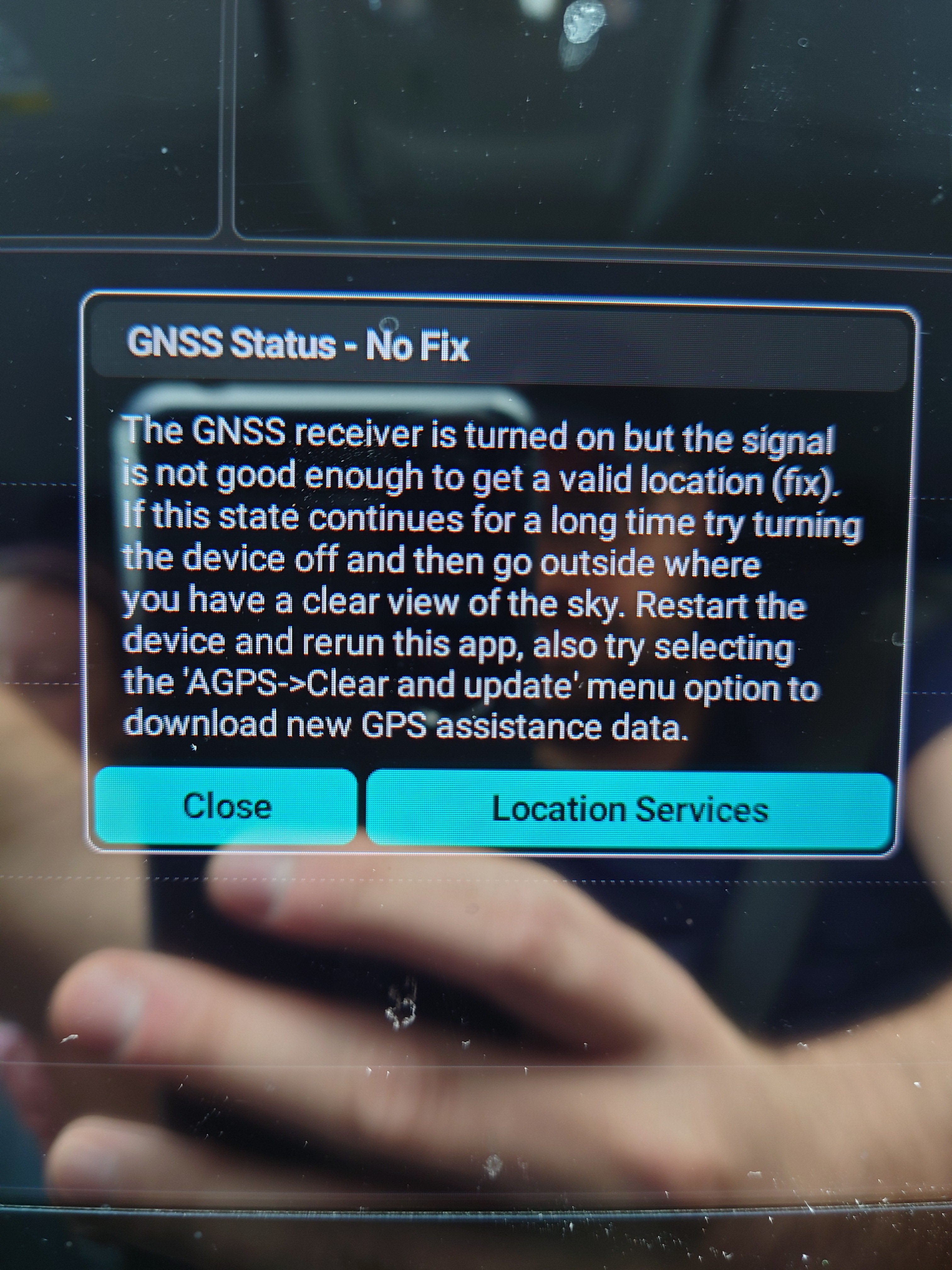

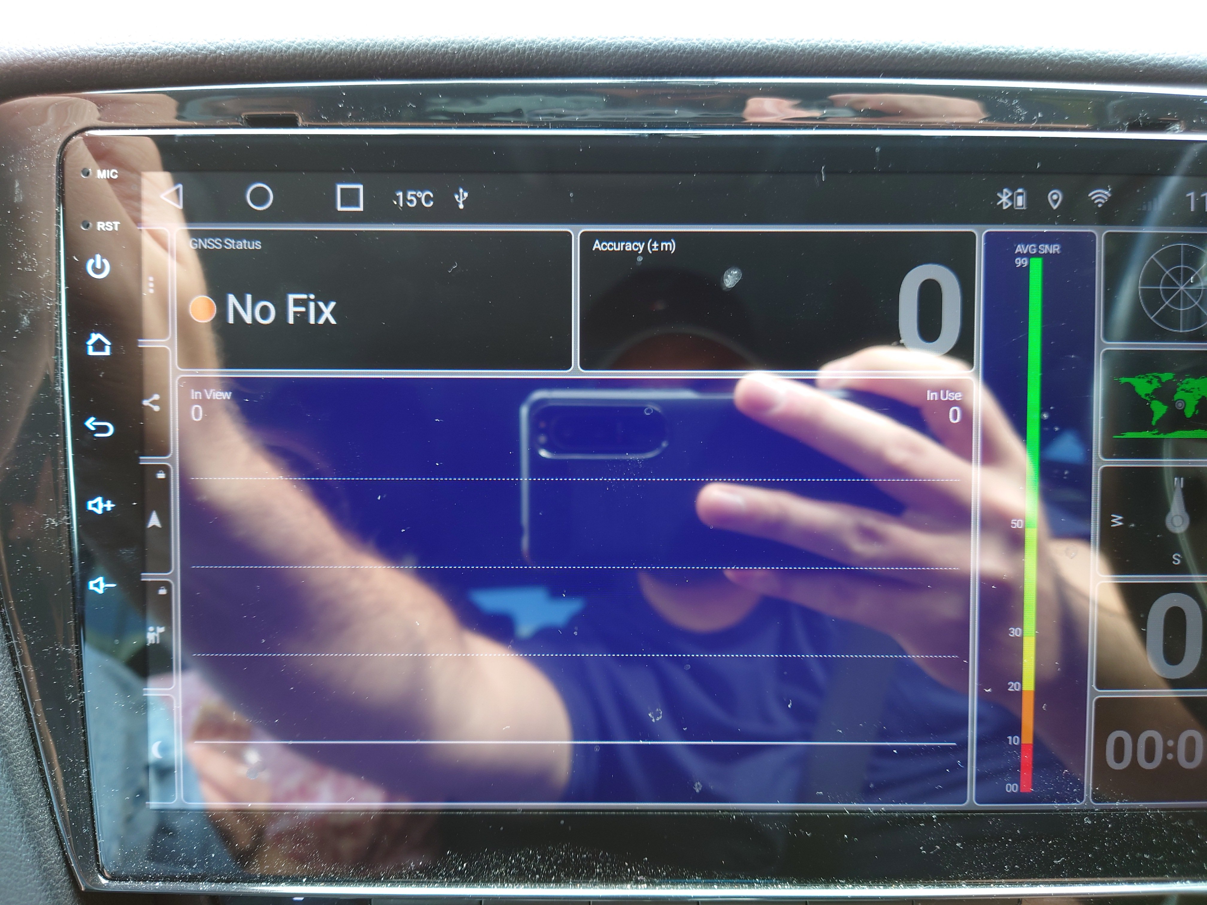

I've had an issue with mine over the last couple of days where Google maps looses GPS signal after a minute of me using satnav. Anyone had this?
I have had lost of gps a couple of times whilst using Waze but it either sorts itself out in its own or I just restart Waze. Usually it is a satellite problem as far as I am concerned.

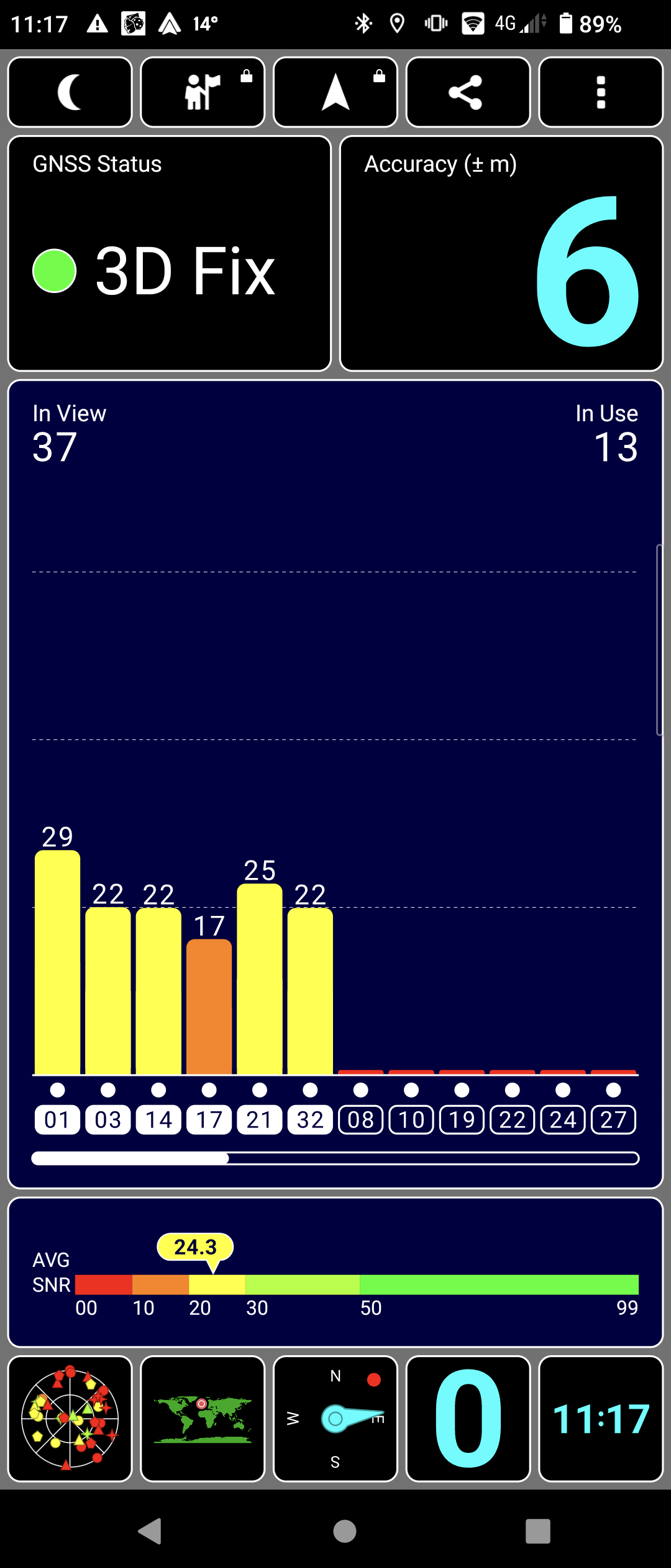

I have this installed just to check GPS if needed
Just downloaded that to check, got the following.
The last pick us the same app on my mobile.
20220821_111832.thumb.JPG.ab1123b14d1847b88cffcf6a0b46b292.JPG20220821_111832.thumb.JPG.ab1123b14d1847b88cffcf6a0b46b292.JPG

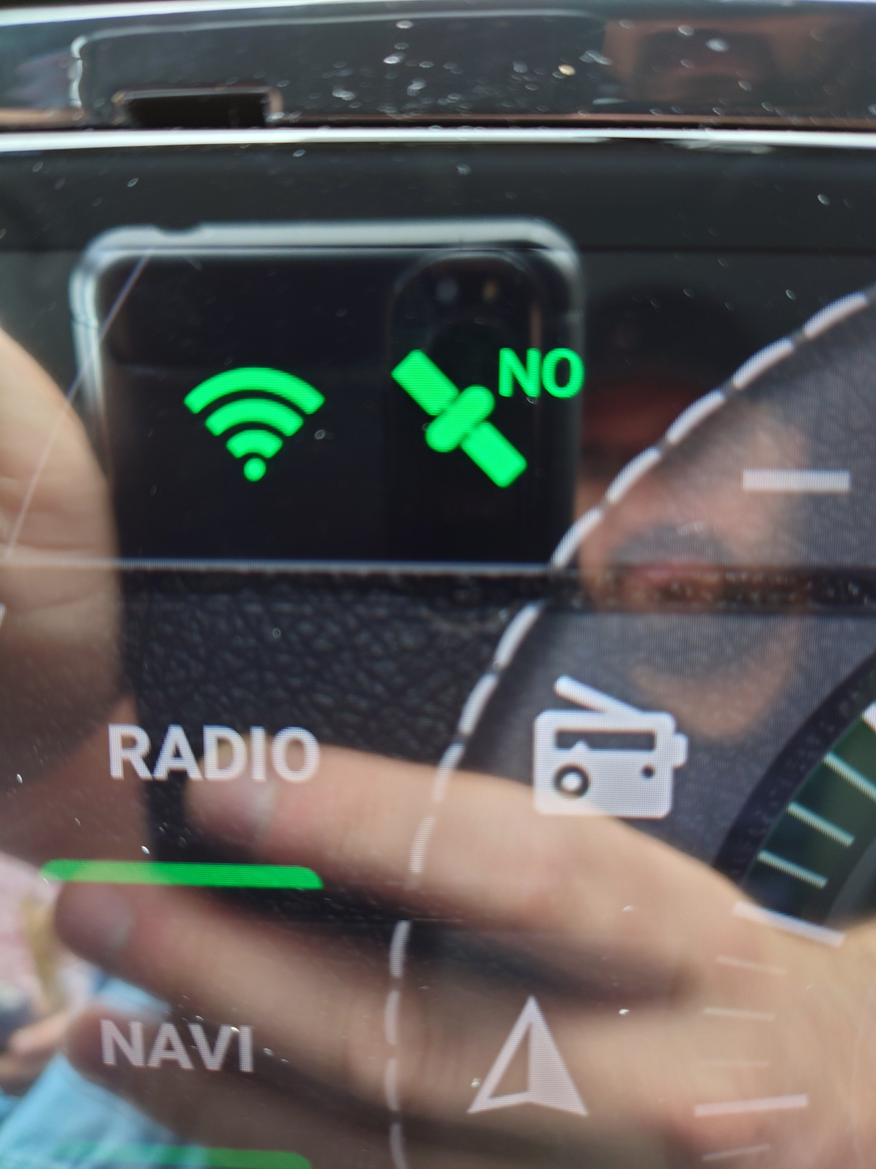

So went to the car this morning, and switched on the ignition. For about 10 minutes there were no satellites. Face panel off again and moved about the wires and satellites went to 4.
I have a spare GPS unit as I'd bought a second stereo from Ebilaien, disconnected the old GPS unit, and and the head unit still showed that there was a connected satellites lol. Do they have built in GPS too?
Anyways, plugged in the spare box and it then showed that there was 15 satellites, so I know part of the issue is the older GPS unit that I had.
Might have a look around to see if I can find any more powerful ones that will go into the unit.
