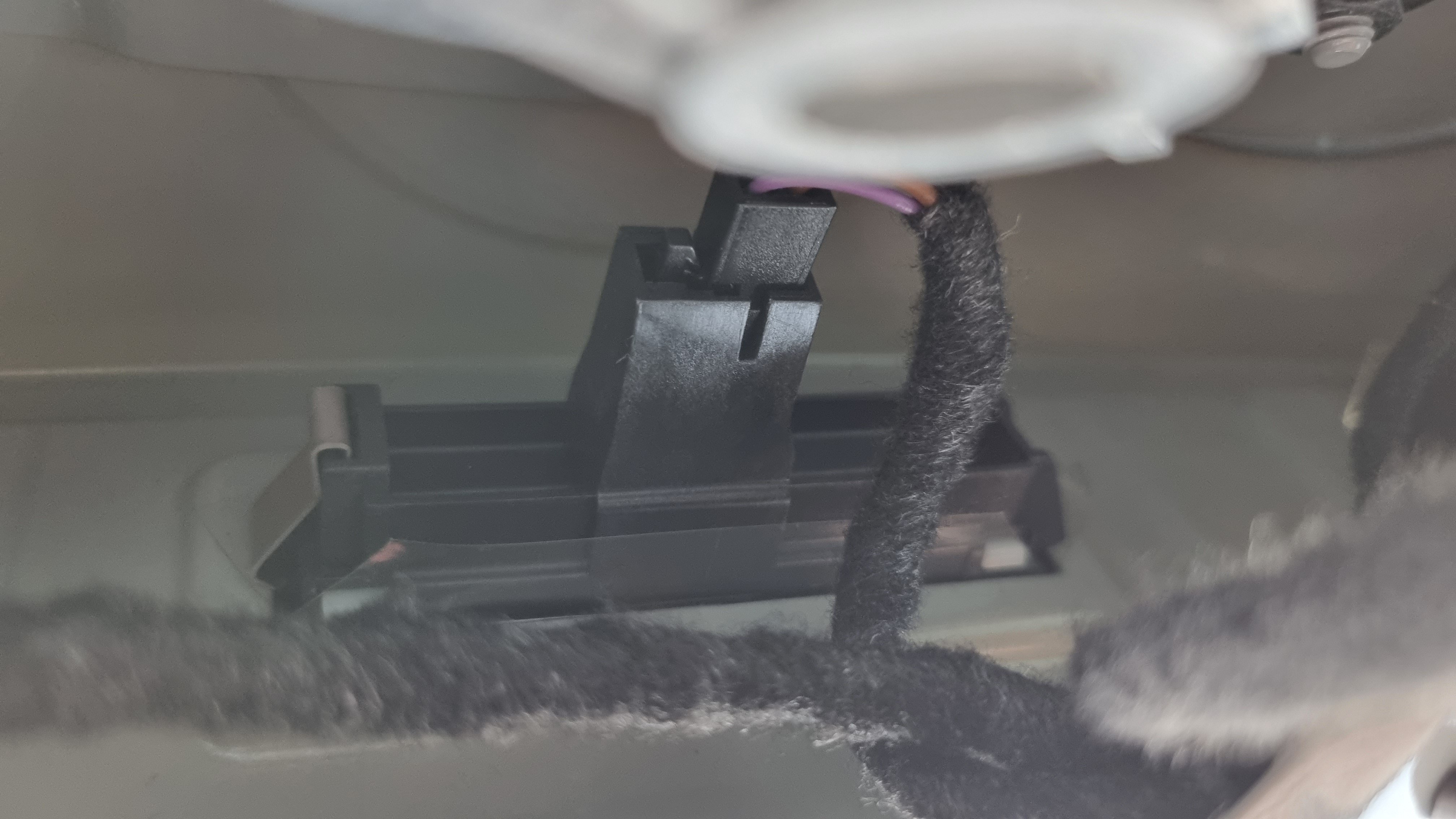

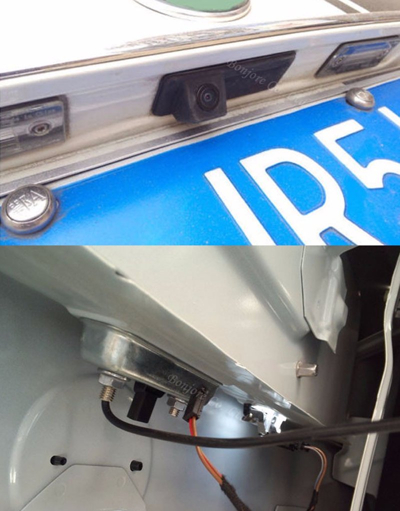

does anyone know the name or have a link for the metal plate that holds the trunk button?
I recieved a reverse cam than came with treads but the seller does not provide the metal plate.
therefore i have sold doubts abou the camera holding with the skinny plastic clips....
I need to secure it with the metal plate and bolts.
I am talking about this plate
My stock handle holds with a solid metal clip.
Edited by nickytheshaft
I may just end up building a clamp.
This is the camera that I bought that came with the metal clamp. Maybe contact the seller as see if they will just sell you the clamp only?
https://www.aliexpress.com/item/33035970515.html?spm=a2g0o.order_list.0.0.73ba1802h330lo

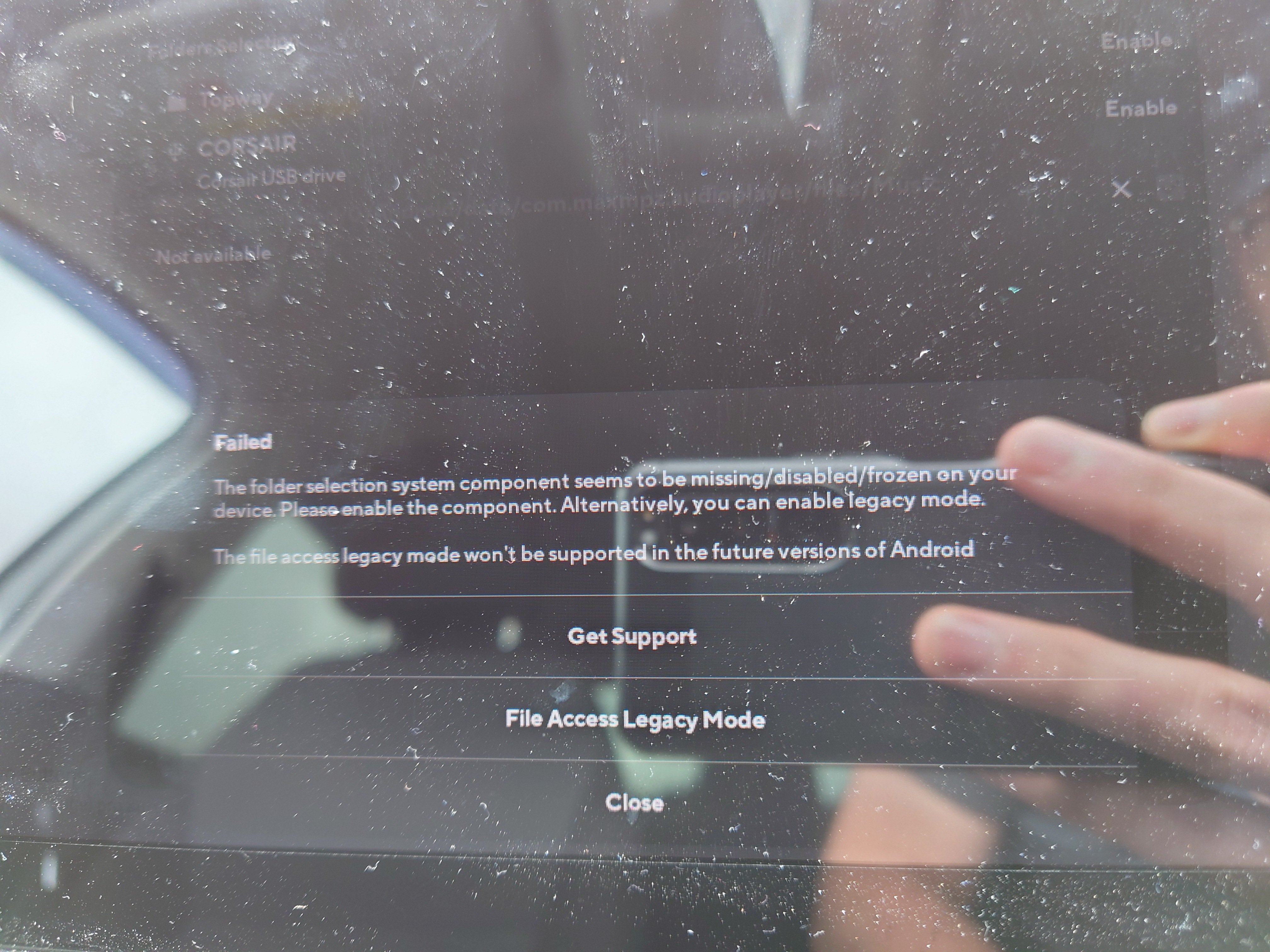

I get this when I try and link my folders up.
Tried all the troubleshooting but no success
Downloaded Pulsar to give that a look. Have tried Black Player but that mixes up the folders
I had this issue in deed. Activate files legacy mode and it should solve your problems. I will reinstall it later this evening and let you know
Ok Thanks, I will try
Unfortunately tried that too, with no success

So I reinstalled it and selected legacy mode. Poweramp rebooted and I got acces to the internal stockage.
For Poweramp blowing my ears at each phone call, deselecting direct volume control in the app did the trick.

Sorted guys, thanks very much. Had to uninstall, reinstall a few times.
