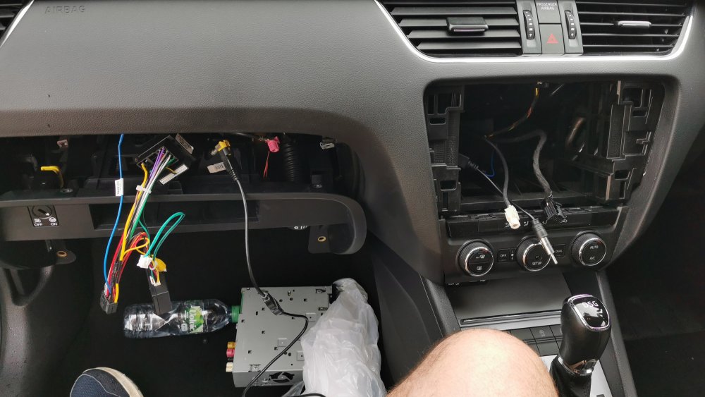

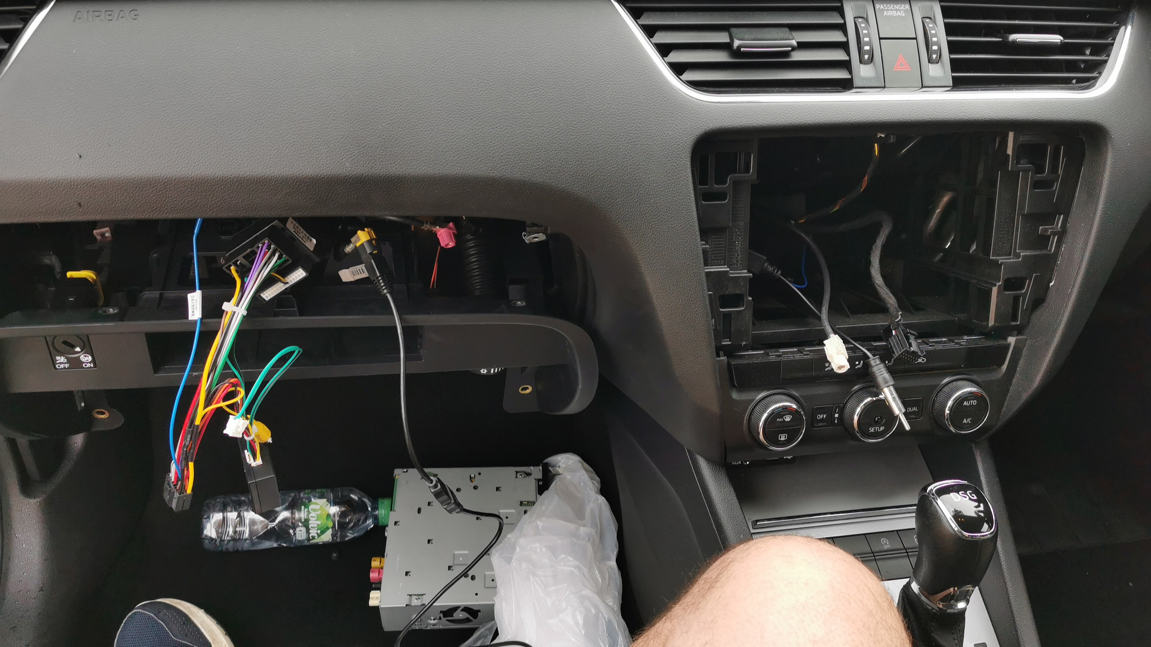

On 03/10/2021 at 10:31, Lamont1980 said:
So, tried to install mine this morning, I don't have enough give in the power cable to switch this bloody thing on.
All my power was going into the cd unit in the glove box, need about an inch more to get the stereo to slide into place and actually work
Hey struggling with this rn, how did you manage to get enough room to connect the android head unit? Plug socket is on right hand side of the Android unit and causing to be a right nightmare, need about another 1-2 inches if even. Any ideas?
Hi mate,
I had to ask the seller for an extended harness. They were fine sending it out, just took a couple of weeks unfortunately.
