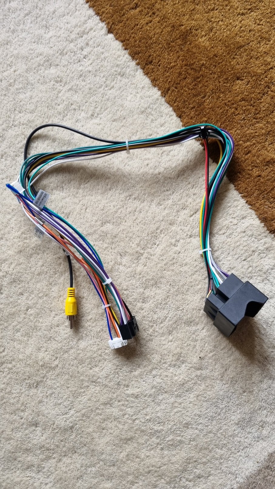

So my unit has finally arrived and as expected... there was a little bit of a lie.
The B version suppose to work with the cd player is just an extended connector to avoid moving the harness from the glove box side to the the center of the car... there is no connection what so ever to the cd player.
In my case, this is useless as I hav to get the stock GPS antenna and the stock DAB antenna so I must move the harness.
the quadlock quality is lower than the presious one I had.
There is no stock USB cable, hopefully I kept the one from the previous unit that I will customise to get the 5V to the quadlock. I sold the other custom one with the connector to the new owner.

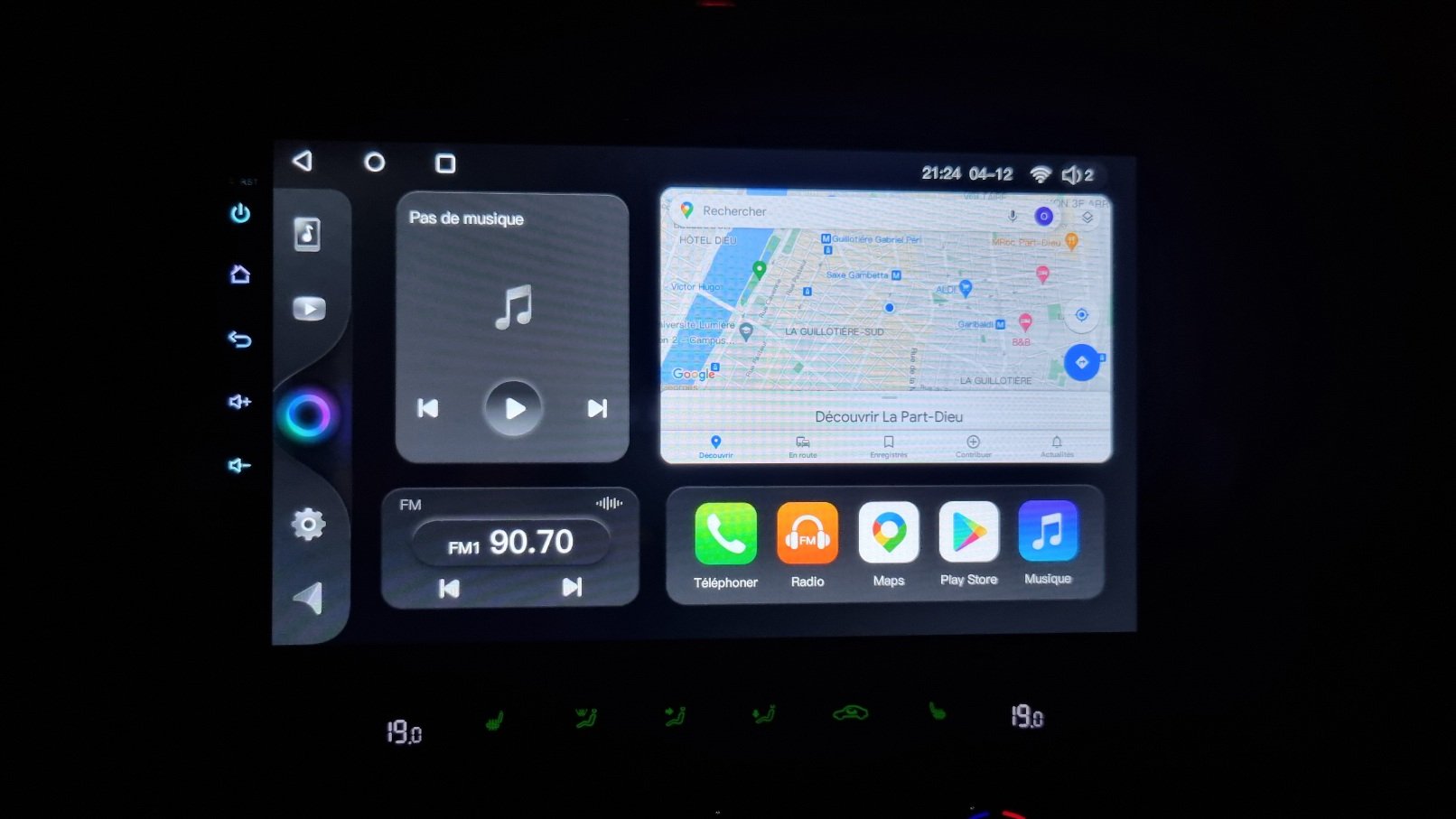

So the unit is in place and running. The UI is soooo much nicer and everything is snappy and fast.
Now I have to learn how to use it because is is completely different than the other one.

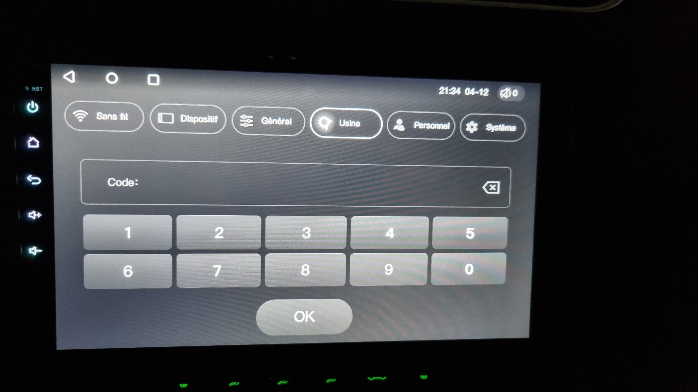

I also need the factory password. I hope there is a setting for the FM volume because as it is, on 1 It blasts your ears.
So I Found the code 121212

So the unit looks way more stable than the ebilaen and the UI is more polished. The 3gb ram are more than enough to drive the unit.
I haven't tested the call quality yet.
One thing I noticed, the drive modes don't pop up When you press the button, you have to go in the settings to see what mode is activated
 They may be a workaround I haven't figured out yet.
For the moment I am happier with this unit than the ebilaen.

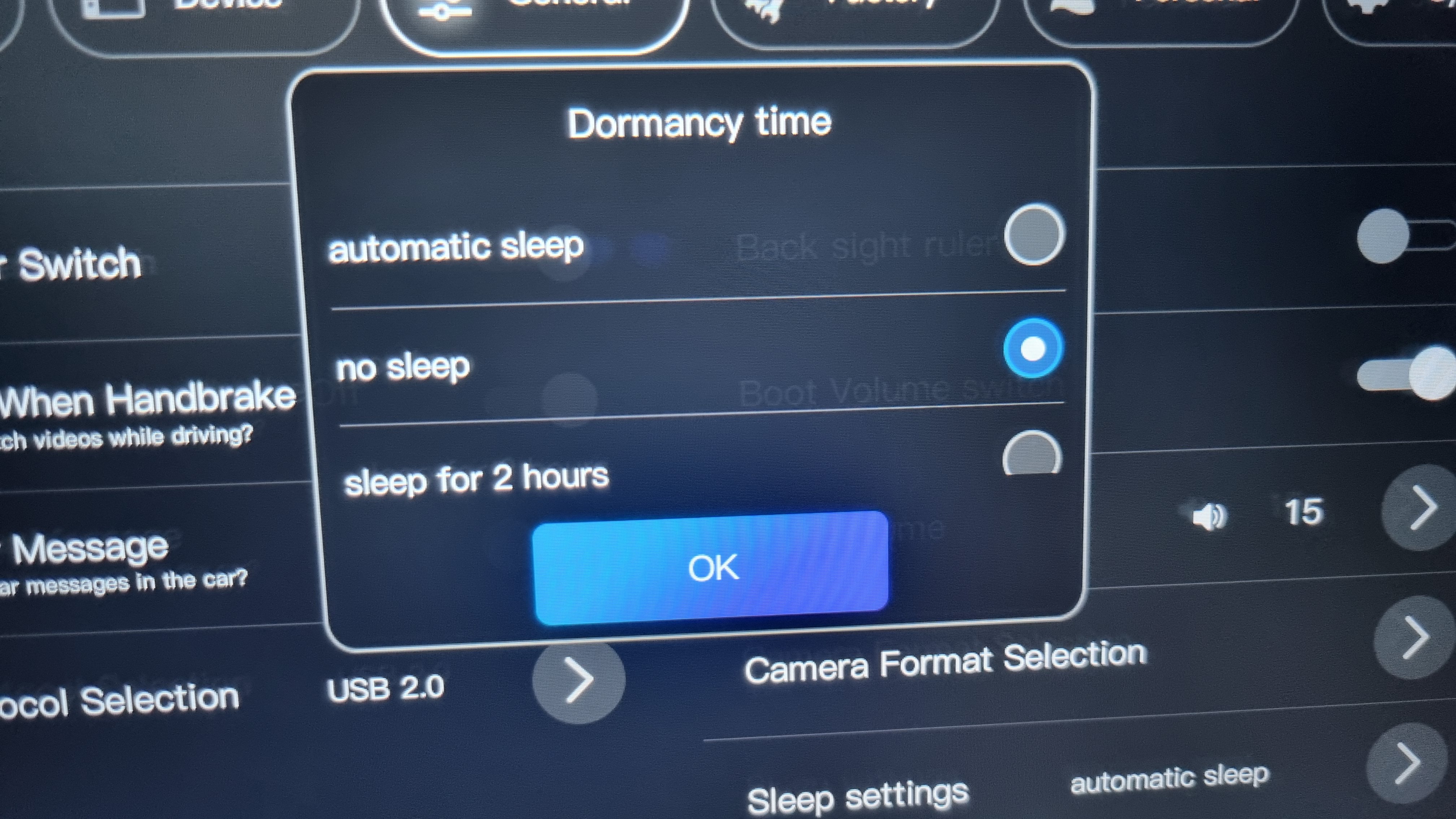

Well I just noticed that the unit does not shut off, it stays in sleep mode no matter what setting I use, even no sleep
I am trying to sort it out with the seller.
So an MCU upgrade sent by the seller seems to have done the trick, the units shuts down afer 1 minute when set to ne sleep.
This seller is really better that Ebilaen, he aswers fast and helps quite a lot.

To factory reset in the Eilaen unit you use the code 7890. The factory reset isn't really like a factory reset on a android phone as it only seems to reset certain things. The only true way to remove everything is to use the factory reset option in the extra settings. Just remember if you do it this way you lose every app that is installed that isn't built into the actual firmware so use with caution.
