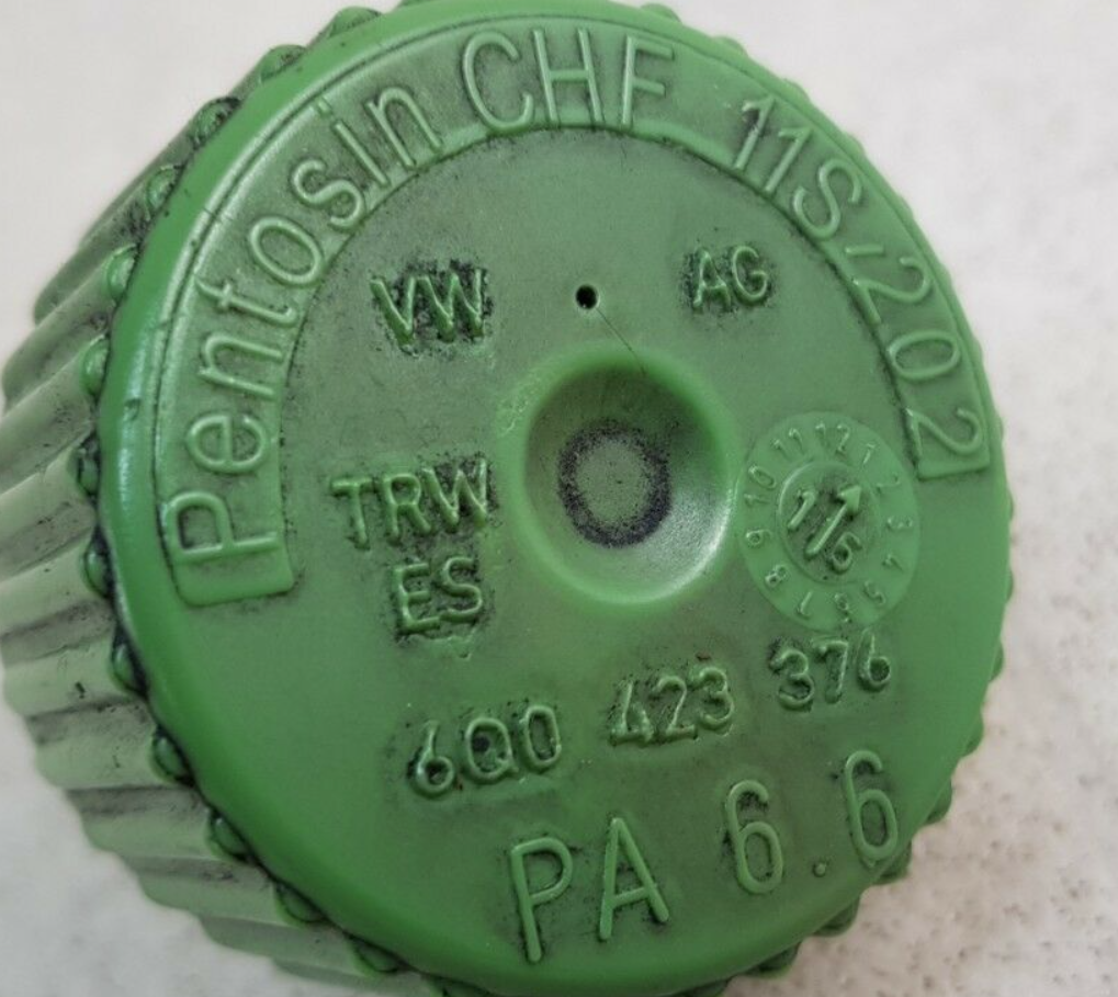

I'd certainly suggest taking @MATT0693 up on his offer, but on TRW systems the cap has TRW written on it, and I think with your engine, it'll be visible without any disassembly.

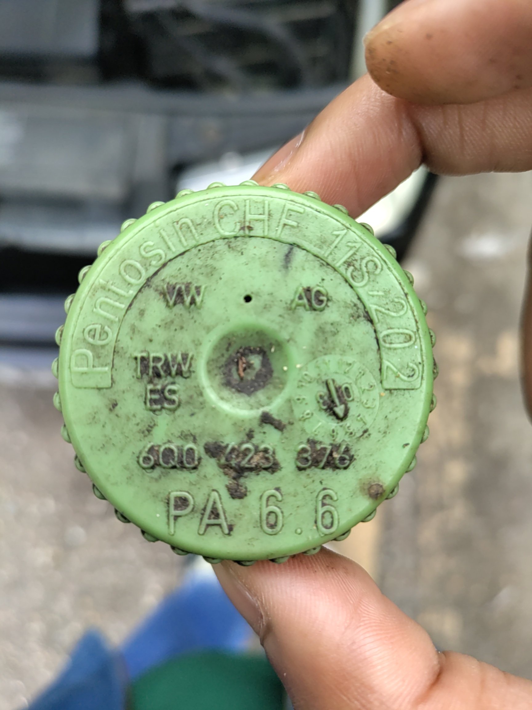

As Wino says, check the cap. My 1.2 has the cap exposed and I imagine yours will too.
Hey,
Thanks so much for the help, it's exactly as you said.
Thanks!
