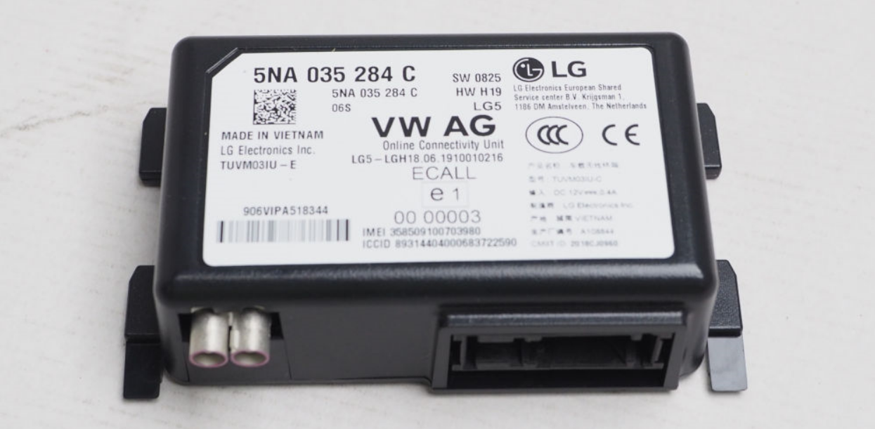

Varoom - well done!  That is the part they have ordered and are replacing soon! I assume owing to ESIM connectivity issues…. which I guess effects the ability to connect to the Emergency SOS Service?

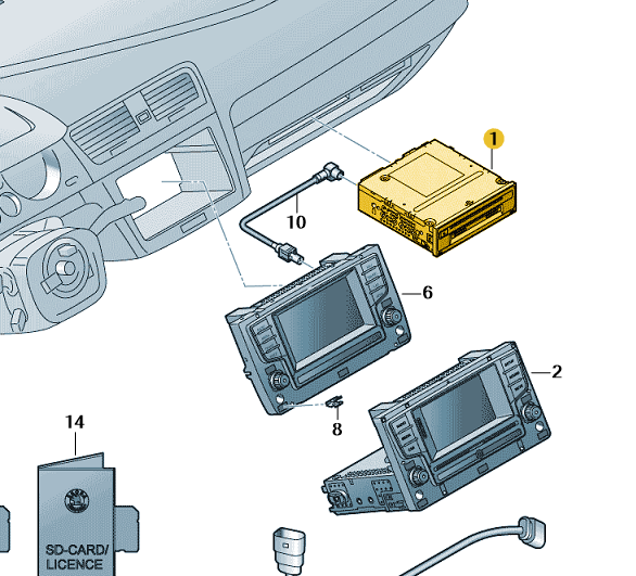

So if you don’t mind my picking your brains further…what exactly  IS the ‘Head Unit’ …. just in case the above part doesn’t correct the fault
(I have SW 1886 installed and PoP Pop SOS ‘seems’ to be the single outstanding glitch)

Yeah it's the eSIM part that gives you the SOS and online services if you pay.
The 'head unit' actual brains of the infotainment system probably lives in the glovebox area usually
Wow. That is really good information. Thank you so much for taking the time and care to answer my query 👏👏👏

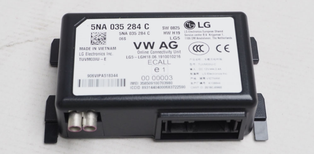

Here is an example image of the offending unit.  Hard to believe this is around £930 inc VAT.
Amazing information. Thanks once again.👍

After two years of ownership and numerous SW updates SkodaService arranged for the ‘Onboard Communications Unit’ to be changed.
I have had the car back for three days and so-far have not experienced any further  ‘Pop-Pop’ SOS or loss of functions.
After 1 week with the new OCU I have experienced no further instance of ‘Pop Pop SOS’ with loss of function. I will update further in a few weeks.

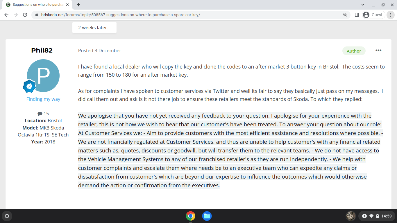

368071363_Screenshot2022-03-2511_55_58.jpg.edf9de7f74f6008ca469ca99fb9091d8.jpg.59c8e70155a4cf78e8950a1f2f6ef6be.jpg

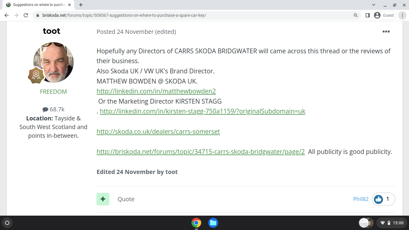

@5 mins 38.
Skoda / VW Uk really get away with it and Motoring Journals / Journalists are just letting them carry on as they do.
Some will mention it, but really it needs to be asked of the Brand Directors just WTF do they think they are doing messing paying customers about.
Dealership Group Owners & Directors of Skoda Dealerships are part of the 3 monkeys behaviour and Customers / Owners need to be communicating with them,
maybe via a Solicitor.
