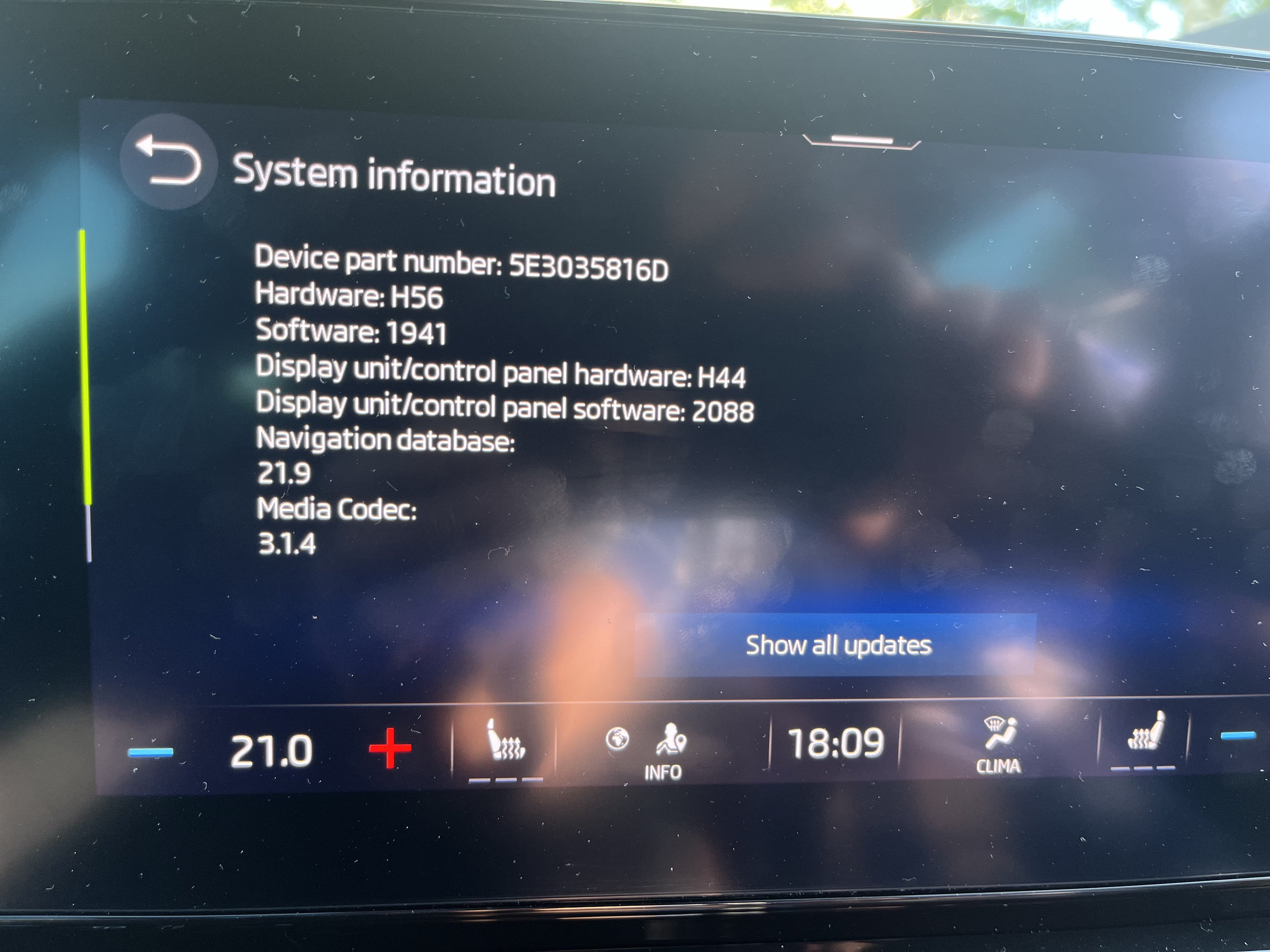

How do I check to see what version of software I am running?
Go to settings on your info screen, then into ‘system information’

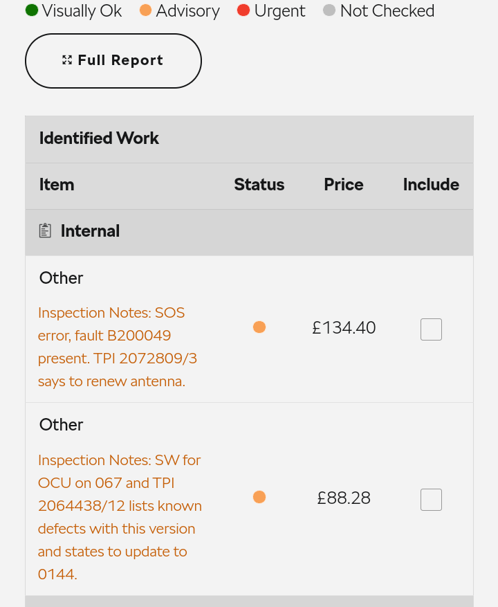

I got a 70 plate Octavia in April which had the dreaded SOS issue. At the threat of returning the car within 14 days the dealership (A Evans Halshaw branch) said they would pay for it to be fixed.  Cut a long story short, took it a Johnsons Skoda dealership who fitted a new aerial and updated the firmware.   So far so good (albeit it's only been less than a week).
TP details attached, hopefully it will help someone else to get theirs sorted.

It might be worth getting the Telematics module firmware updated.  The pop pop by the sat nav position going completely off was something I suffered but getting the Telematics firmware updated sorted it.

Hi all, I have this issue appear on my car. My OBD seems to think it is the issue that this thread is about. The skoda dealer wants £225 just to diagnose and tell me the same thing. Is it worth just going to a 3rd party garage and asking them to replace the battery?
