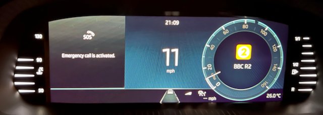

2. The message "SOS - Emergency call is activated" would appear on the left side of the virtual cockpit (see attached IMG_5638)

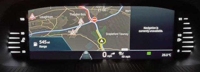

3. If using the virtual cockpit navigation screen it would report on the right-side "Navigation is currently unavailable". This message would be stuck for the remainder of the journey, and the navigation would no longer work on this screen, but was fine on the main infotainment screen.

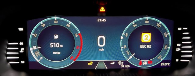

1. The emergency yellow triangle would appear on the dashboard, followed by an alert relating to the SOS system (see IMG_5639)

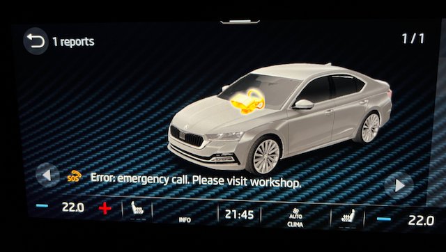

2. The vehicle status page would report "Error: emergency call. Please visit workshop" (see IMG_5640)

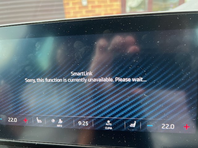

5. On at least one occasion the issue has also broken CarPlay, and SmartLink wasn't working at all (see IMG_5656).
