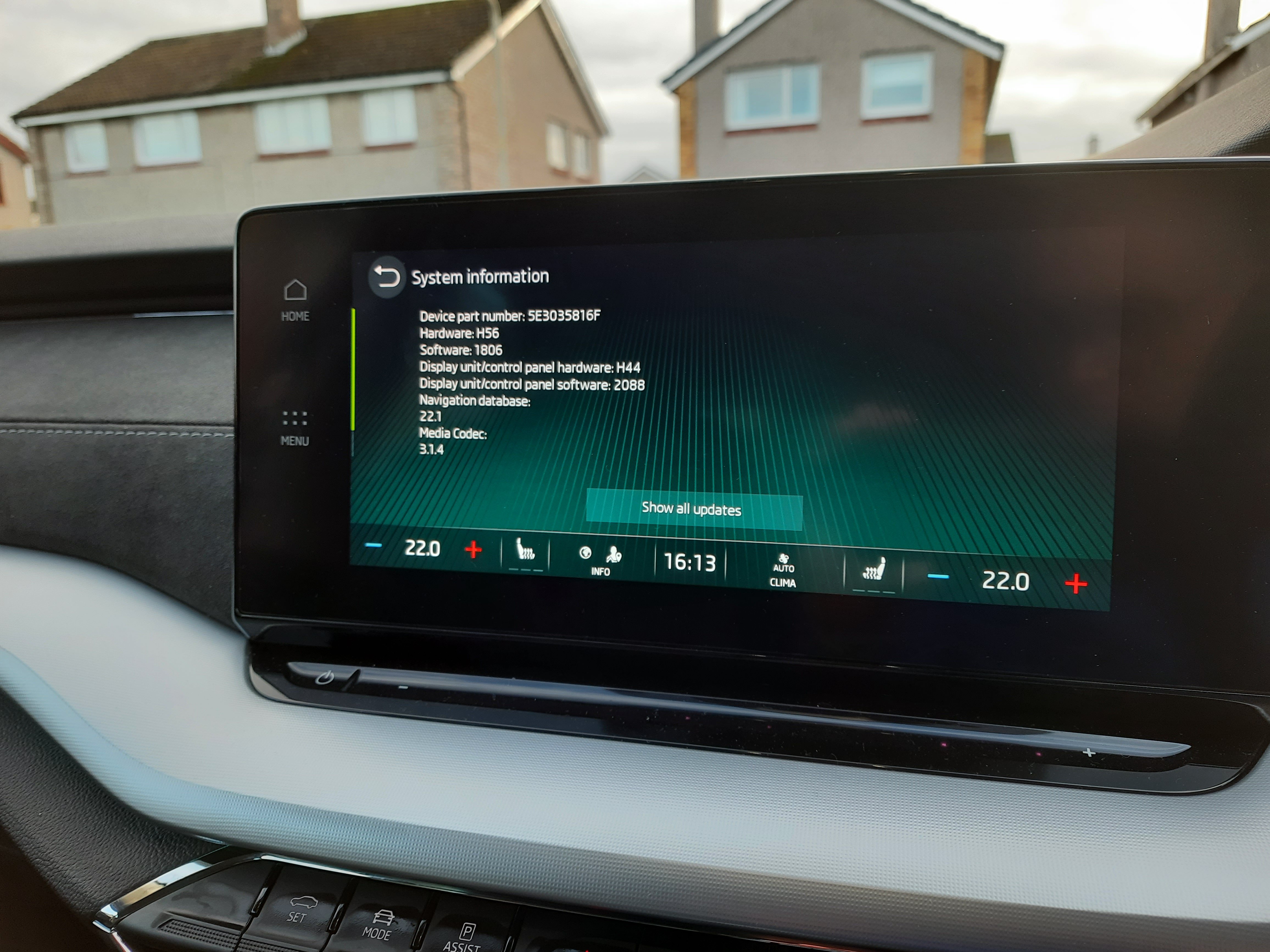

Had mine into the local dealer today to fix the pop pop, said they "updated the software" but all these values are showing the same time as before. You reckon I'll be back to the garage to get them to update it properly soon? Seems like 1896 is  the solver of the pop pop and without it the problem persists.
What they don't seem to realise is that they need to raise the software levels of several things at the same.
I suspect they updated your OCU (device for communication) and didn't apply the firmware for the infotainment unit.
Another journey needed for you once more @HighlandBoy
