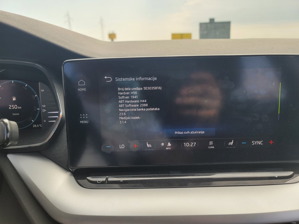

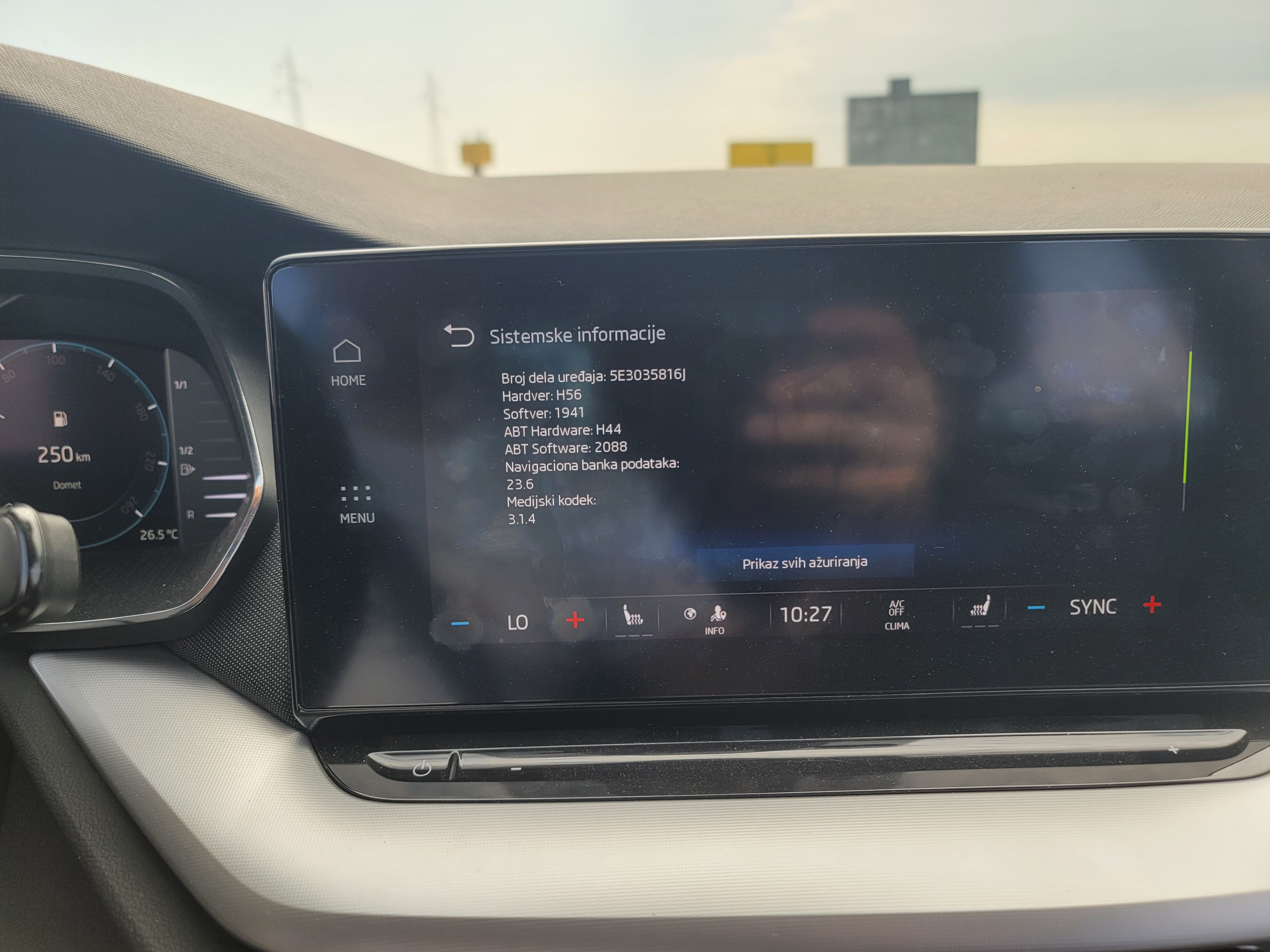

So today 1941 arrived, by dealer. Still not officially available in my country, but they found it on portal and my native language is present, no comment... Looking good for now, very responsive and fast.

As I was anticipating some time ago, today I joined the v.1941 club (through the front door 🙃 ) - believe it or not - installed by dealership, same one that did the installation for @djmartzian (thanks for the tip!).
It was not as long as they anticipated when they were threatening me with 3 to 4 hours installation time, but still - considerably longer than what it should have been. The car returned into the parking lot in about 2 hours after they took it inside for the upgrade. No idea what they did all that time, maybe they were listening to musing, or simply killing time - but the car had the hood and the driver's door opened during those 2 hours - I checked it via the phone App every 10-15 minutes while waiting...
Fingers crossed it will run smooth from now on... at least until they release another major-fail OTA ☹️
