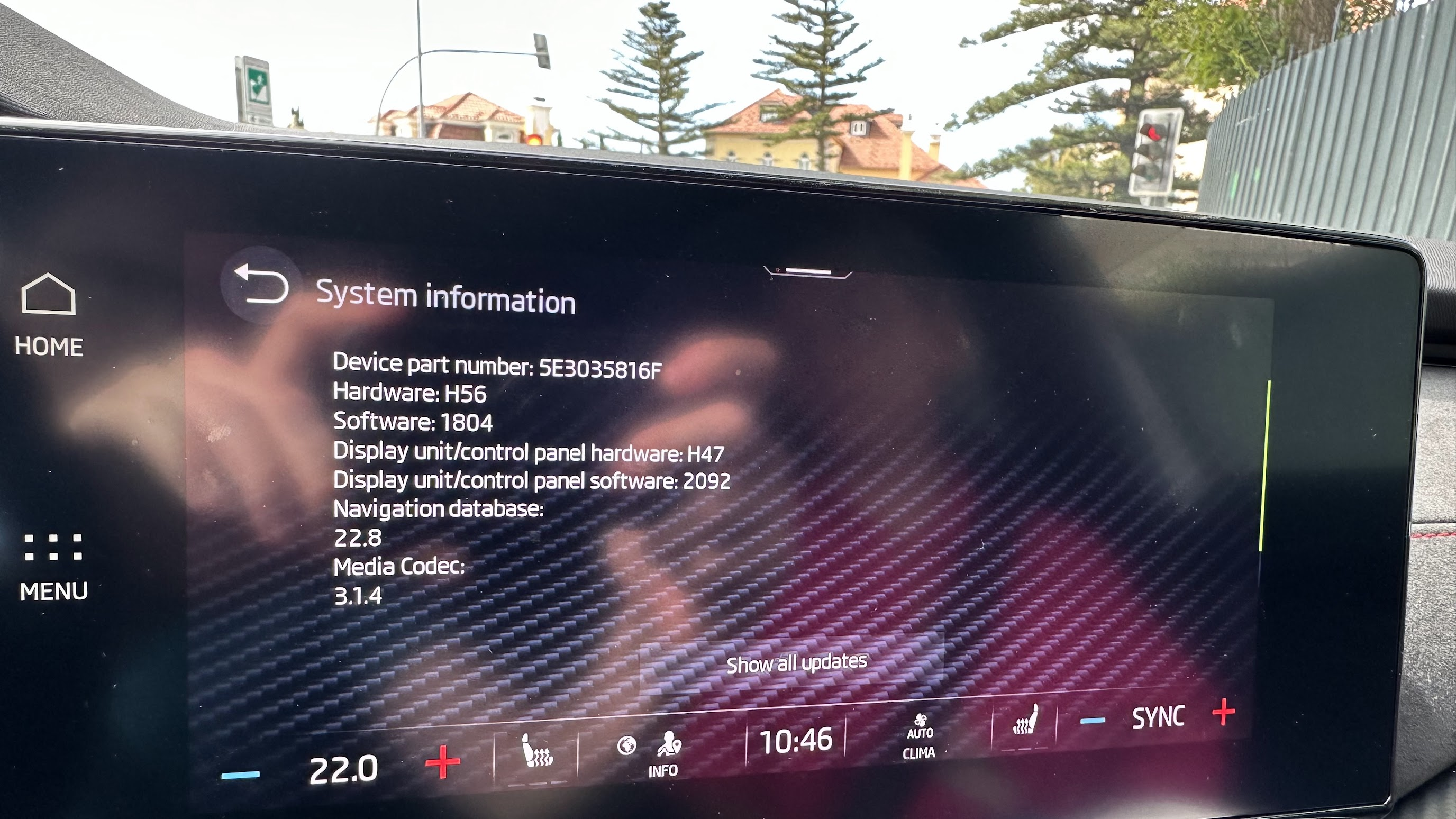

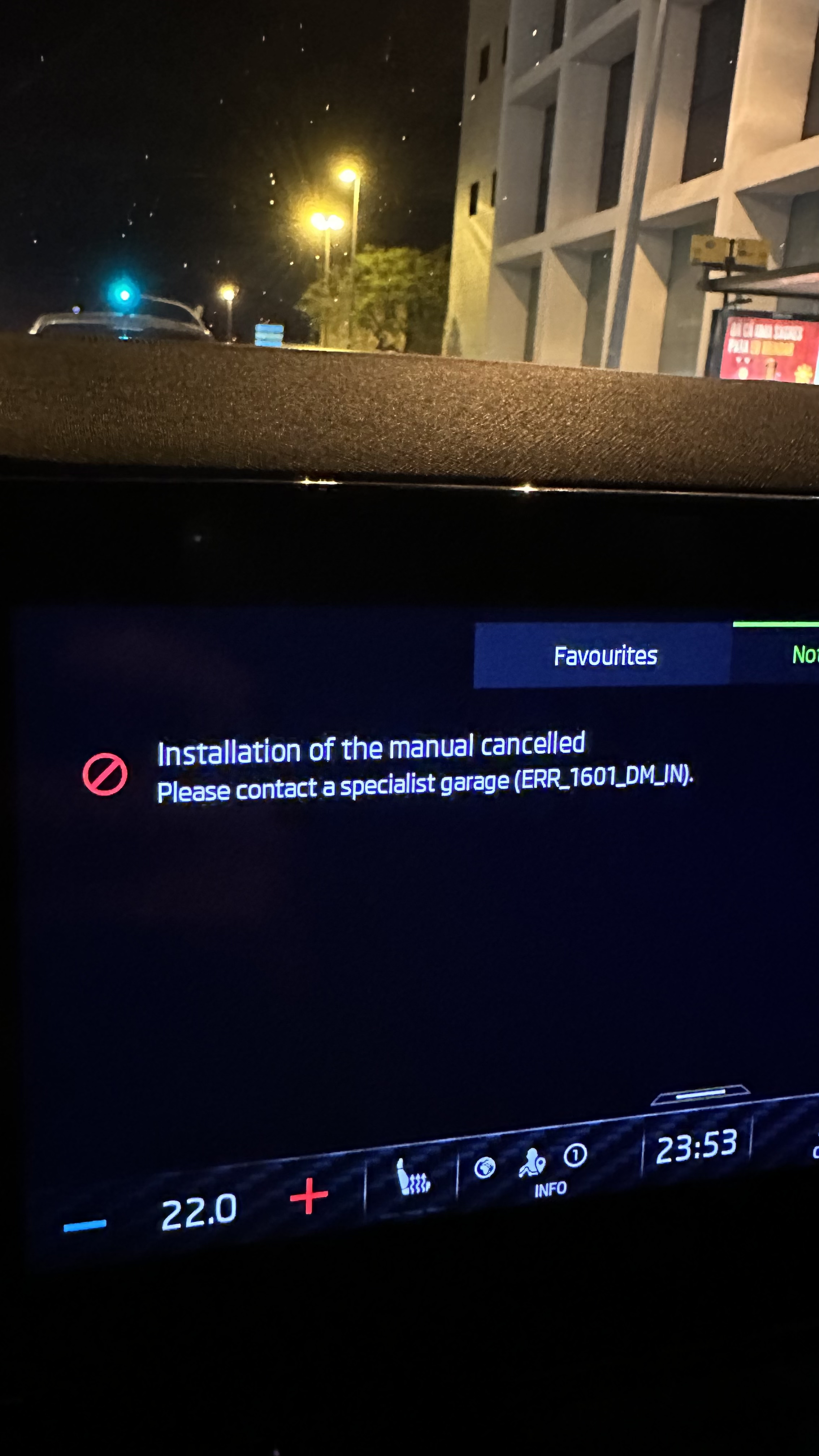

I own Skoda Octavia iV vRS 06/2022. I already visited a dealership in December, they told me that some firmware update was applied, but today I found I'm still on 1804.
I have no problem with system reboot, but I have cracking sound from small speaker and endless unsuccessful manual installation.
@varooomis it safe for me to upgrade to 1941? If so, please share a file, many thanks

1804 is on the list of supported upgrade paths in the TPI, you should be good. 20-30 users have already updated successfully and haven't heard of any failed installs so far. But as usual, everything you do is on your own risk. I'm sending you a PM with the link.

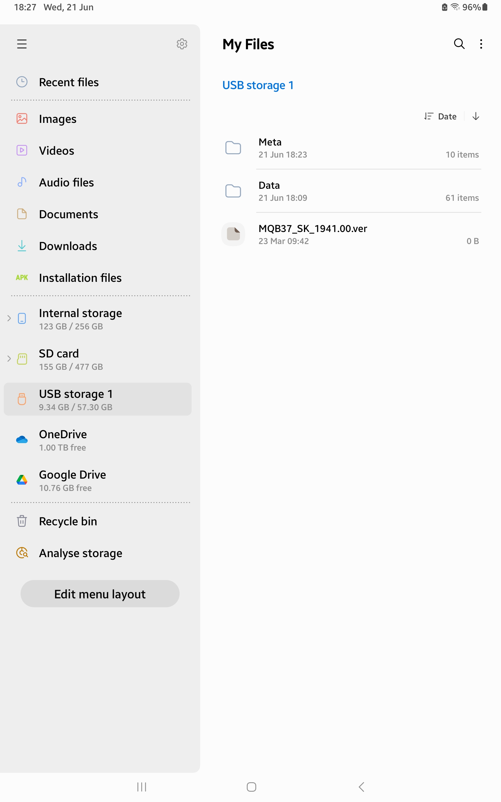

Few Hours! Once I extracted the files to the memory stick and plucked up the nerve to do the update it took no more than 45m to complete.
Another dealer taking the proverbial.
When you say extracted the files What did you do to do this? I have only got one file a 7Z file about 9.3 gb downloaded from the link. Sorry not very technical with stuff like this!

If you can't decompress the file Just download and Install "7zip":
https://www.7-zip.org/
I was going to shoot a little video, too about how to handle the update in your car but at the end of it i had to realize that I didn't hit the record button probably lol.
All in all it was quite self explaining and took a little patience in some stages of the procedure.
