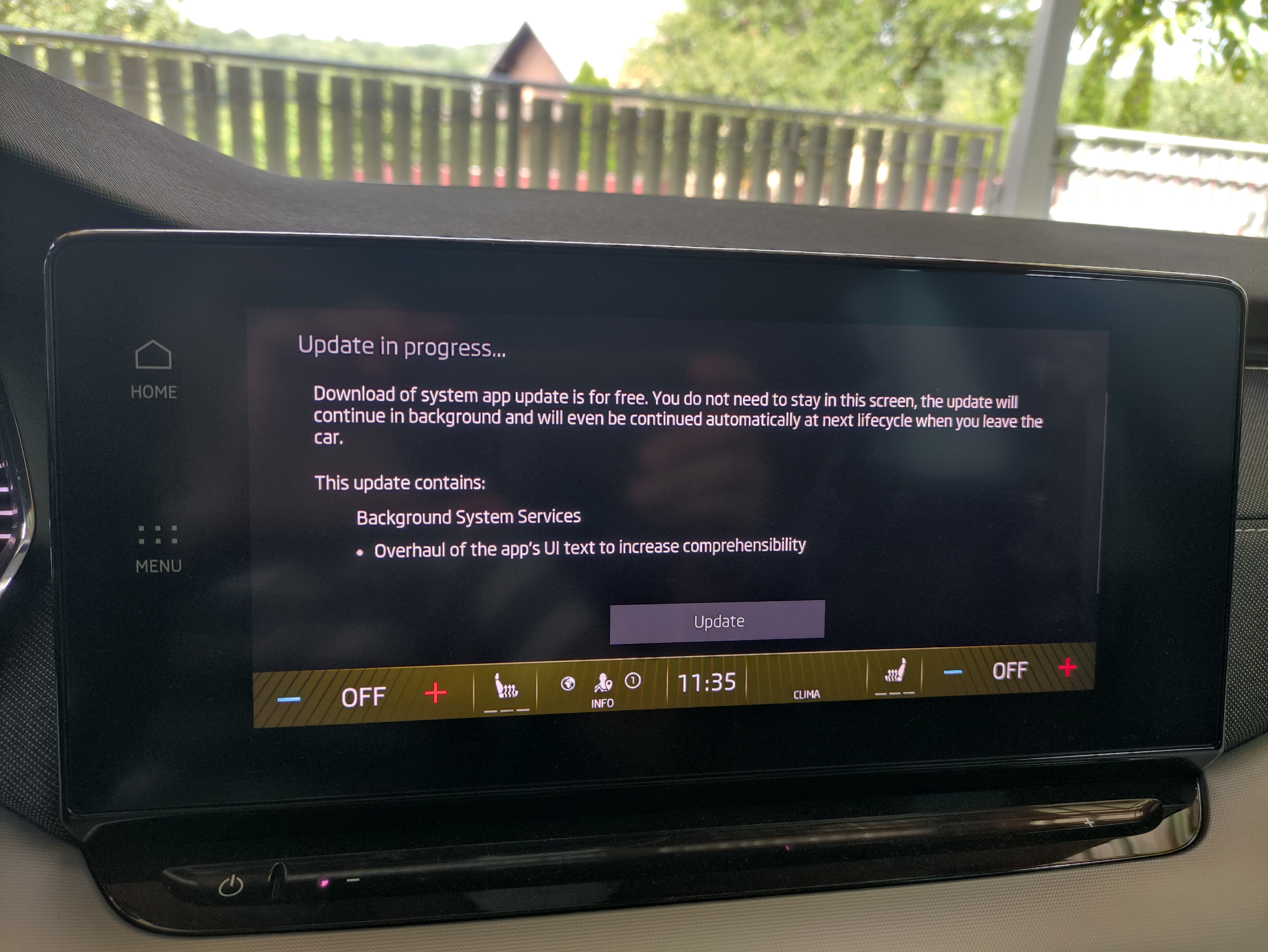

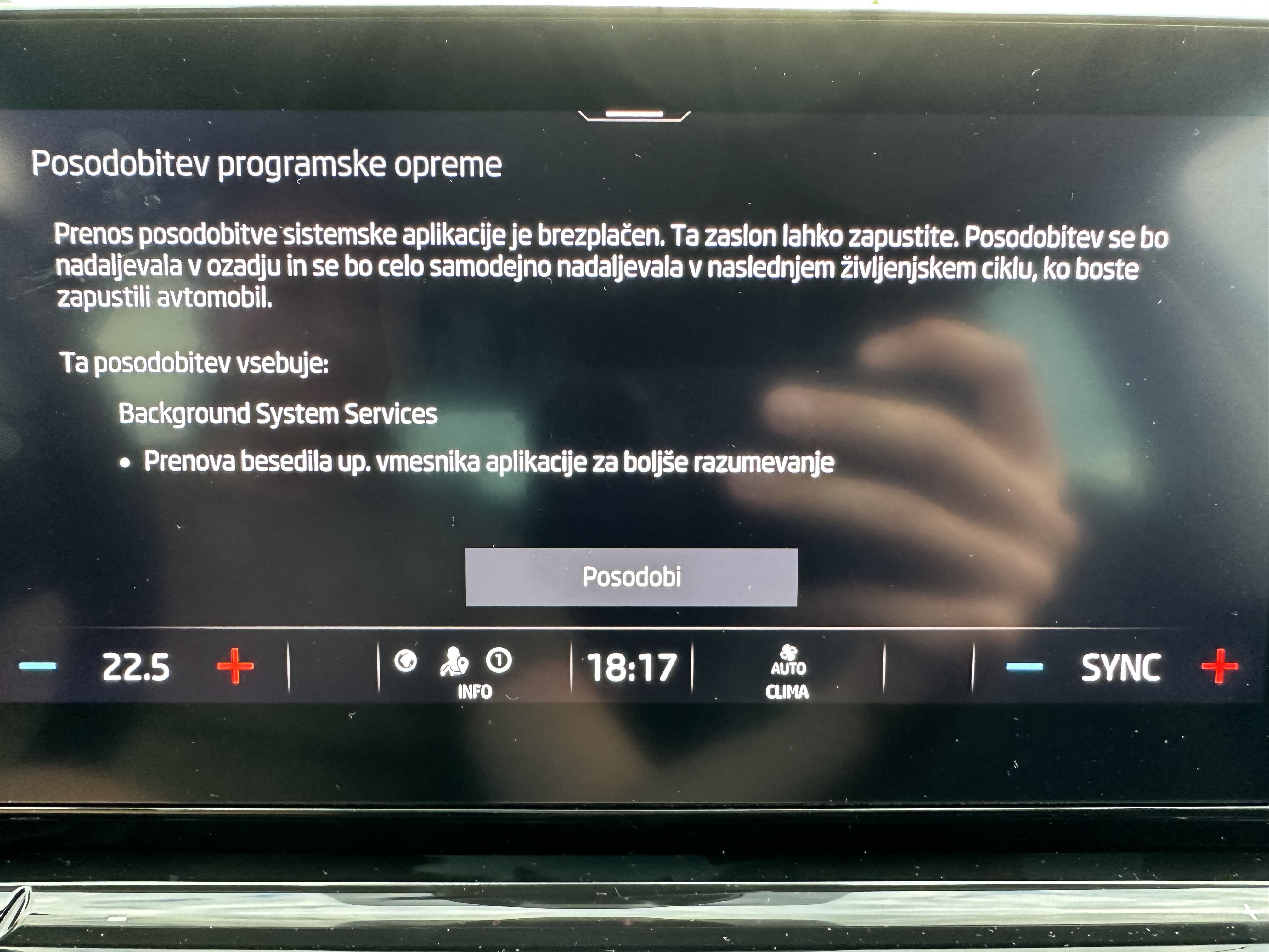

Today, I’ve received a first update since updating to 1941 about a month ago.
Here’s the English translation of the changelog:
Quote
Software update
The system application update is free to download. You can exit this screen. The update will continue in the background and will even resume automatically in the next lifecycle when you exit the car.
This update contains:
Background System Services
• Update of the application interface text for better understanding
Did you update it? I hadnt yet, because dealer just updated to 1941 2days ago. When i picked car i saw that i can update it already but i am waiting
I did. Will let you know how it works after I take another drive.
