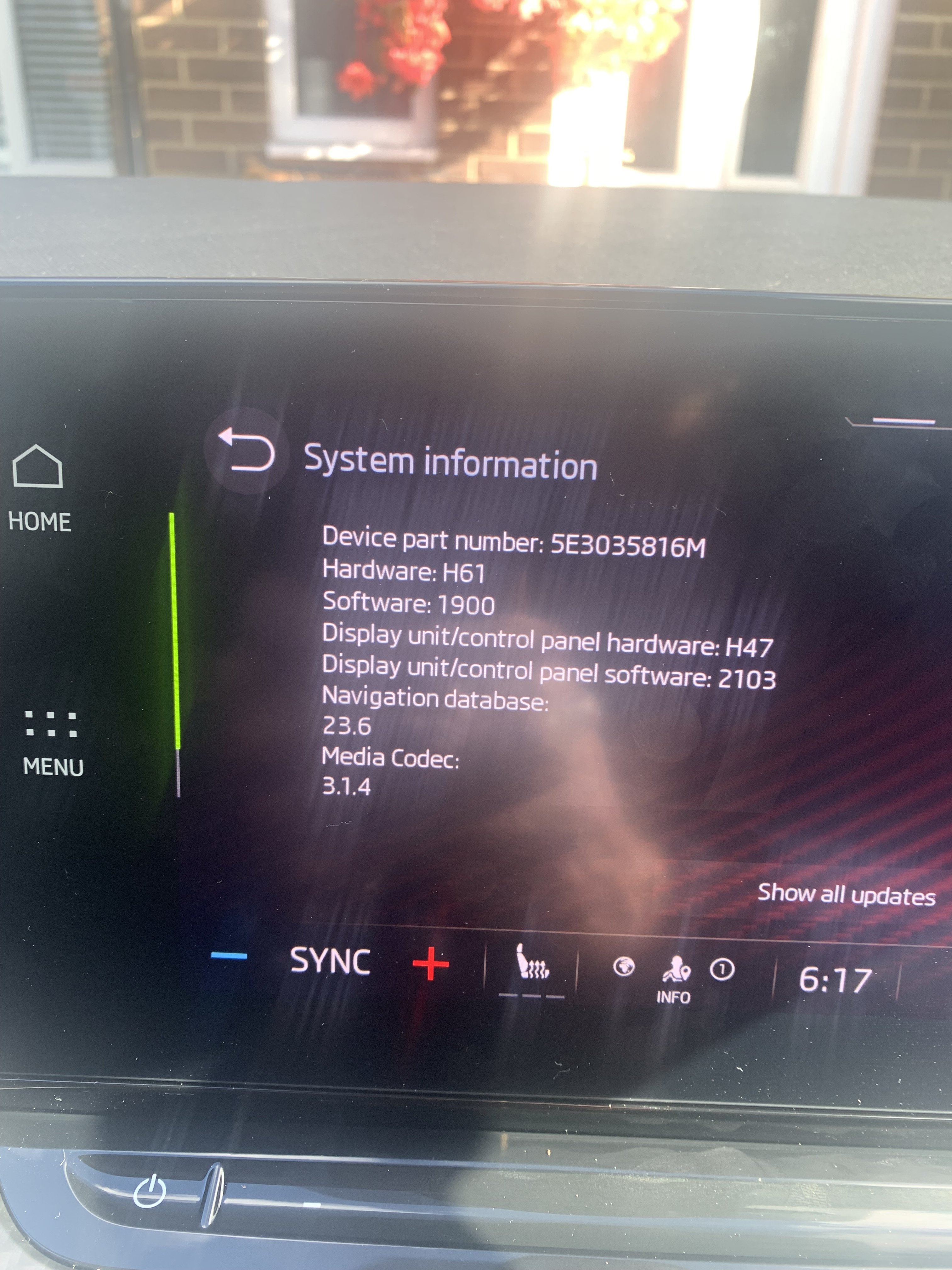

Hi All
Got my new Octavia VRS Estate last Tuesday - 2 issues.
Software - Infotainment keeps restarting
Hardware is H61
Software 1900
I've read some of the posts here and software version 1941 has been mentioned.  Ive looked at the Skoda updates web page and it doesnt really tell you what you are downloading - is there anywhere else that I can get the software from in the hope of fixing the restarting problem?
The other problem is not really a problem - but seriously no engine cover - it looks awful!
Mike

1 hour ago, MikeAPW said:
Hi All
Hardware is H61
Software 1900
Mike
Sending you a PM.
Thank you for the information - brilliant!

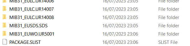

Reading the instructions on page 26 of this thread and extracted the files from the zip file "0I_P95_EU_202325 Offline Update" I expected to see 3 folders.  Instead Ive got a few more than that 789 Folders containing 6038 files!
The Folders are named starting with MIB31_EU.ROOT then MIB31_EUCM,UR10101 going through to MIB_31_EULC.UR14008 with 3 random folders on the end - see below.
There was an error message on one file (a small file of about 1.3mb which I had to skip)  Obviously I don't want to mess up the Infotainment system on a 5 day old car - what have I done wrong?
Thanks
Mike
Well, you've extracted the map update file which you probably downloaded while browsing the Skoda update portal 😅
Did you follow the link I sent you by PM? That's the file you want.
Thanks
Mike
You've gone to the Skoda Portal and successfully downloaded the map updates 😆
The 1941 software update is found by asking a selected member or two for a link to it and then do what I said on the previous pages.
If you have got it right you will have just 3 items which you either copy from your PC to a EMPTY memory stick or extract directly to a memory stick so that it looks like what I posted 3 items and absolutely NOTHING else.
I think that the link can only be used once.  Could one of you fine gentlemen send it to me again please, Ill have another try.
Thanks
Mike
