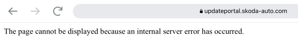

Sorry mates to highjack this thread. I’m trying to update my navigation database (currently 20.8) but no matter which pc I tried, the update portal ain’t resp9nding. Can any kind soul share the latest offline navi database with me?
Is that using your vehicles VIN number? If so then like the message says there's a server error.

Can't you access the site at all or does the error show up at some point?
Been trying for several days. No luck. I can reach the site to enter my VIN. Once I hit enter, internal server error, always.

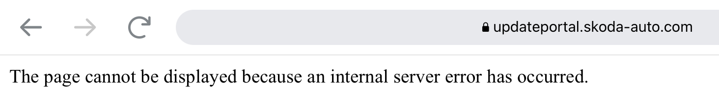

Yup. Keyed my VIN and that’s it. Internal server error for several days already.

Then it's a server fault. From what I've been told the files are from November.
You may want to try using the VW navigation site.
