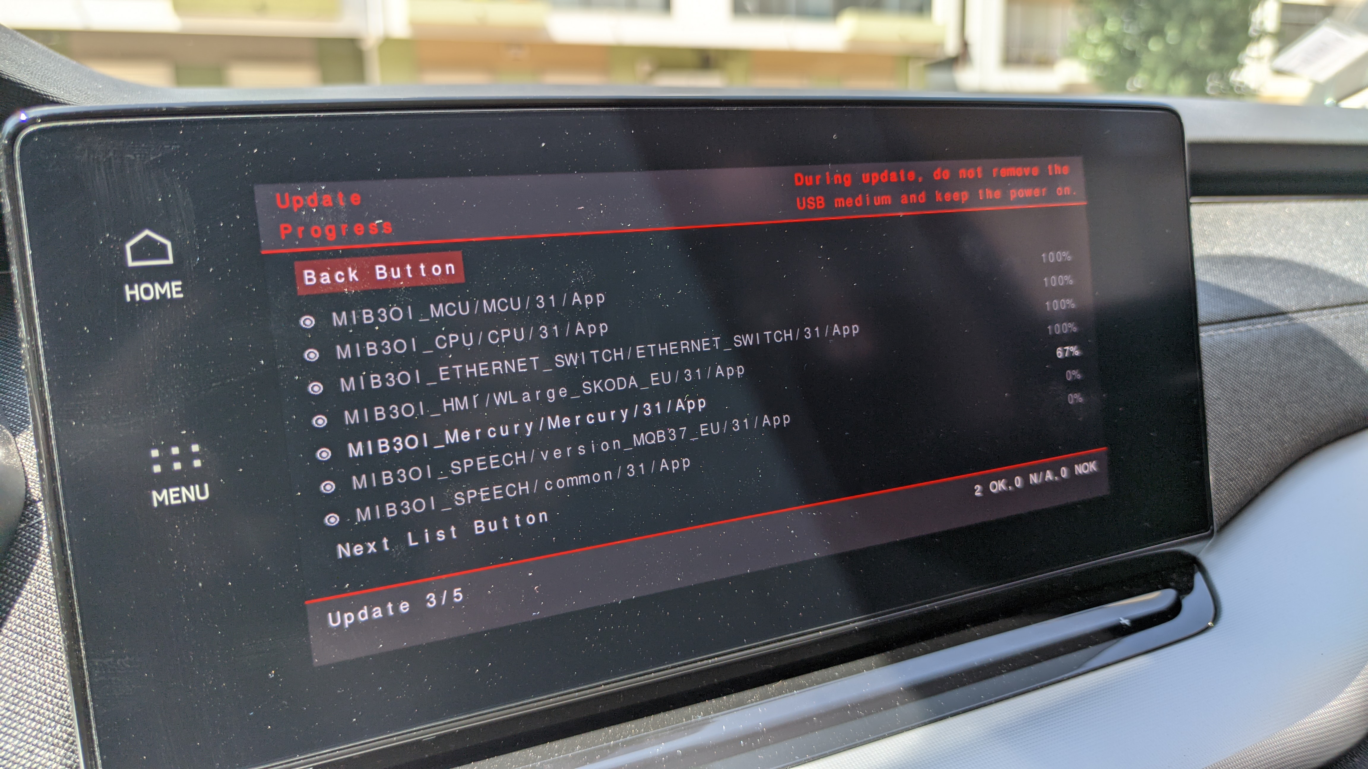

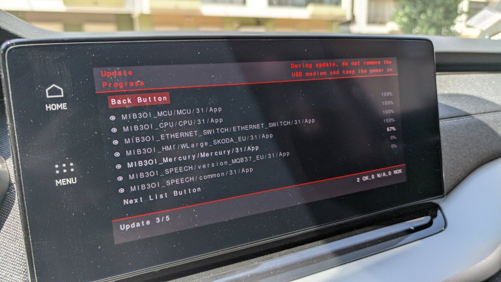

Bit the bullet and started the update 10 minutes or so ago, started panicking a bit because it stayed for like 7 minutes with only a "back" button on the screen and nothing else, so instead of just biting the bullet, I was sweating bullets instead now, but the proper upgrade screen appeared and its now on the black screen after the first line went to 100%.
Feels like updating a computer bios, after all these years they still give me horrid mini anxiety attacks whenever something stops for more than a minute 😅
Gotta love seeing things move
Edit: There sure are a lot of language packs though....
Edited by Jack_Dangerous

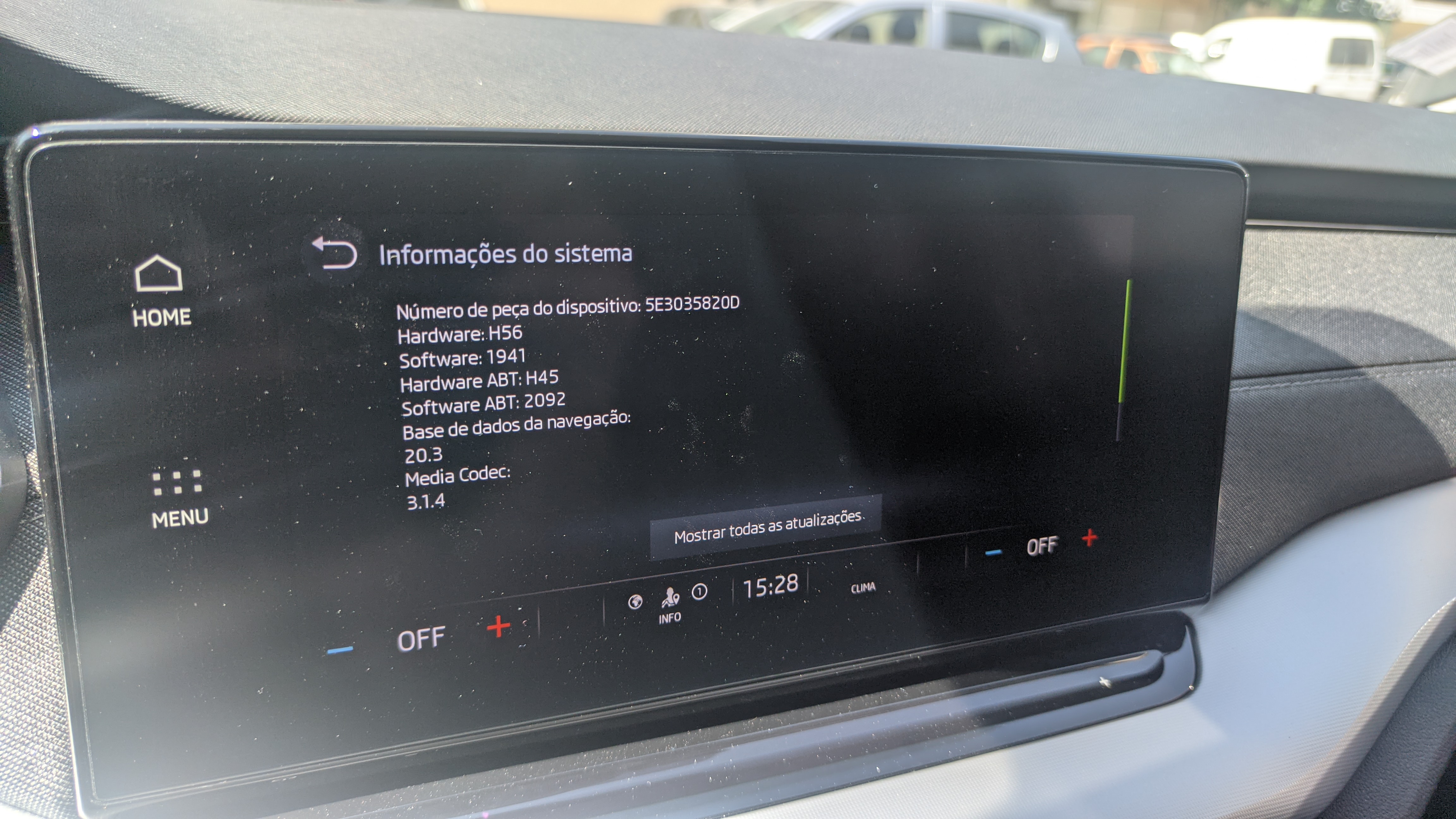

Another success story 👍👍👌👌
It just now started a OTA update as well.
