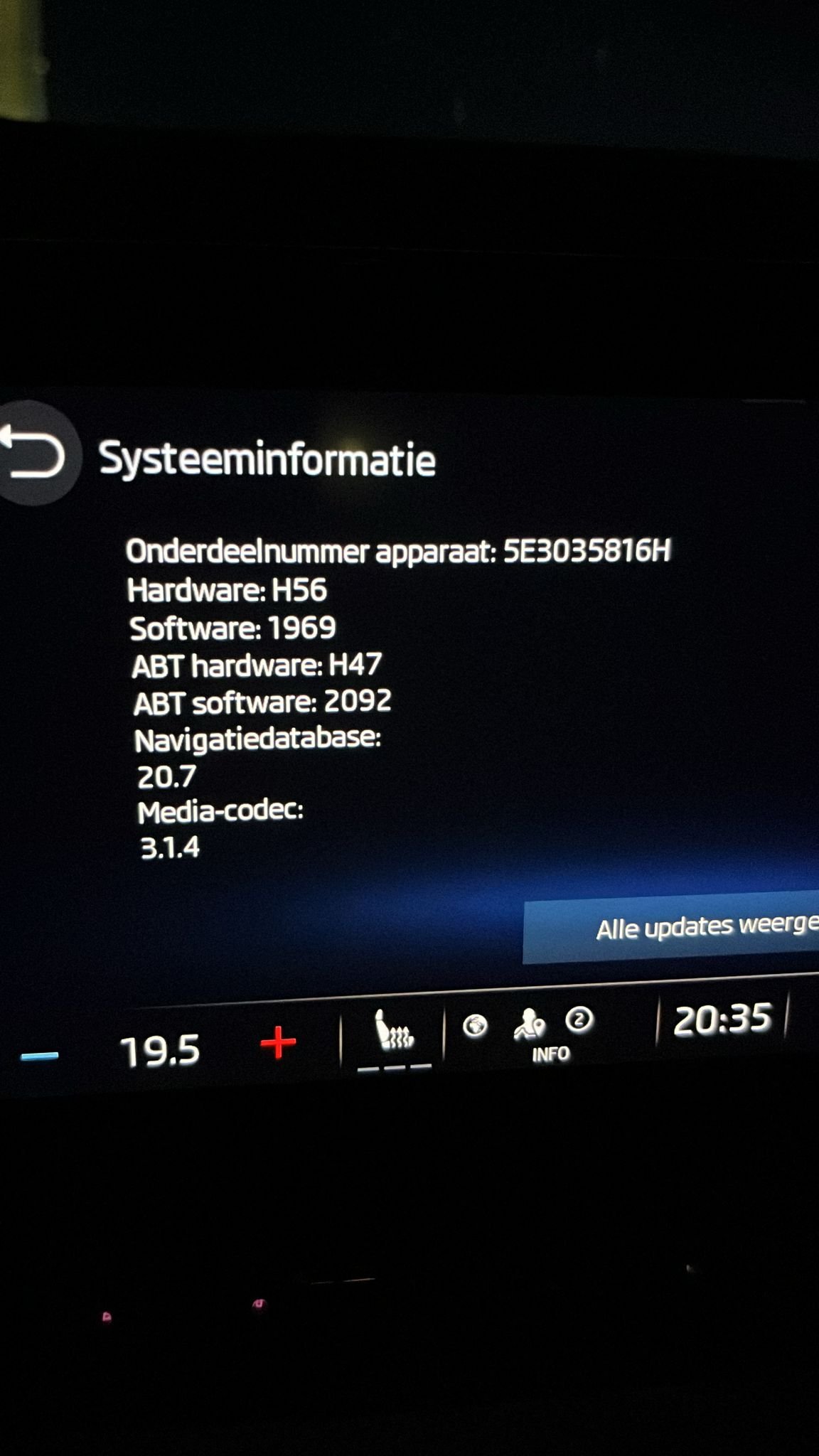

Everything went great..
Running 1969..
Can it be updated directly from 1869 to 1969 or is it necessary to proceed step by step?
I think so.
