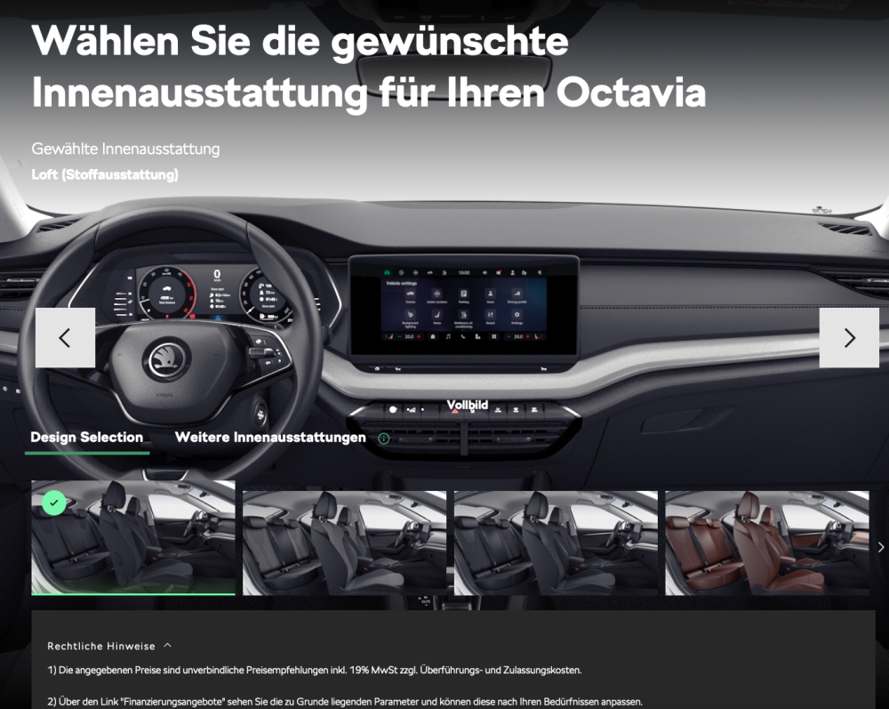

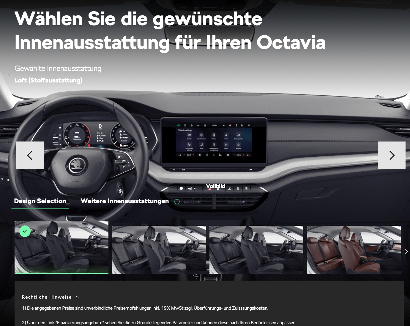

I used the German configurator and found a photo of the new 10" display, similar but minus the home and menu button.

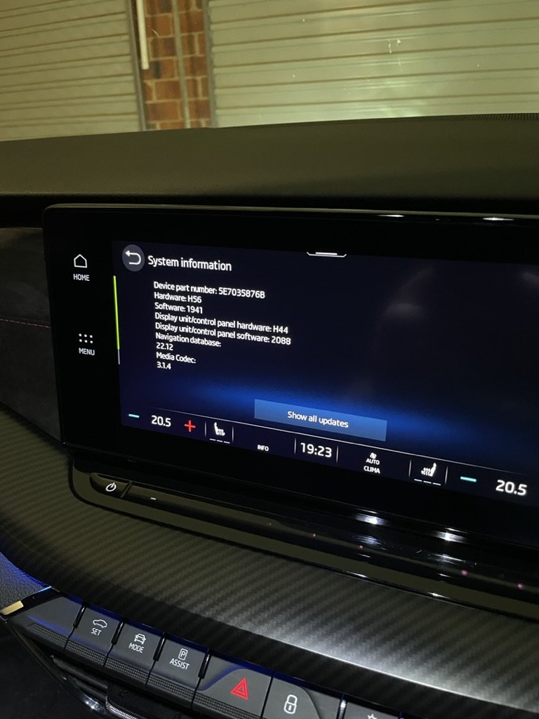

There have been hardware revisions, but nothing noticeable by the end user.
However, seperate to the infotainment system, they did introduce a new version of the virtual cockpit display from 2023. It's a bit smoother and has more views, such as the traditional tachometer plus maps. But it took a while for anyone to pick up on the change.
The latest version for the infotainment system is 1941. You can check in settings > system information. If it hasn't been installed then ask the dealership to do it for you as part of the dealer. Anything older than 1896 and it will be buggy as hell.

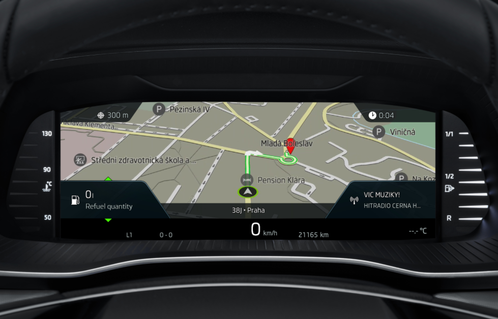

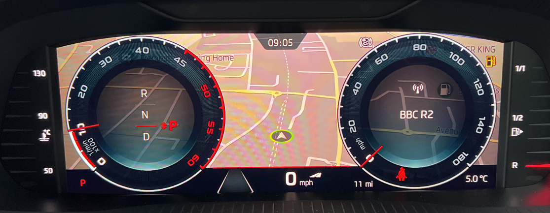

Sometime around mid 2023 Skoda added an extra view to the virtual cockpit.
Most Mk4 Octavias with Maps and the MOI3 system (bigger 10.25" infotainment display) can display this first view:
However, only Octavias with the updated virtual cockpit get the additional dials and map view like this:
It's minor but I do prefer the second view as that's is what was available in my previous car a Kamiq Monte Carlo.
From what I've read the earlier virtual cockpits don't have enough processing power. Mine tends to struggle when there are a lot of 3D buildings e.g. I'm driving through the Melbourne CBD. Skoda started installing this clusters in late 2022 and enabling the additional view from factory sometime in 2023 - in other words some cars from late 2022 can have this enabled via coding e.g. OBDeleven if they don't have it from factory.
