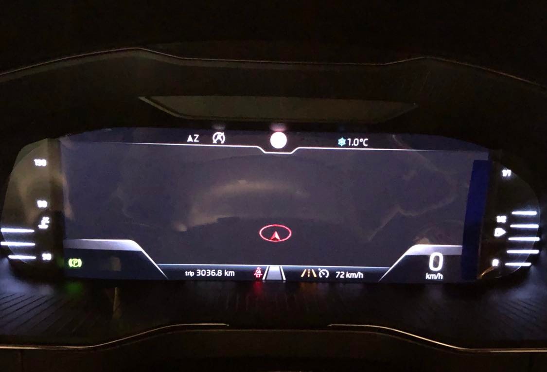

47 minutes ago, Joco776 said:
That looks like an out of region map. They appear like that when the map geography doesn't tally with the gps signal. I know its marked up for Czech Republic, suggest you try out one of the other regions. The other way of checking what the map represents is to zoom back. That's the right hand knob on the infotainment unit if its got one. You turn and it will zoom in and out, other than that you pinch and squeeze the infotainment screen. Stroke left, right, up or down and you will eventually see some roads to the zone it represents. If it's a GPS issue of the units getting confused you can do a long hold on the on/off button till it resets. If for example you have the car in an underground car park not getting a signal would / could lead to that issue. More likely than not the country is missing from the file if the gps signal is good.
You might want to upgrade to the Skoda 32gb card if you haven't got that and use the all Europe file. Martini Bs first one.
Edited by Tell
I tried to zoom out and zoom in, nothing, just a black screen. I photographed it outside, where maps from Škoda always work for me. At the same time, it normally reads that there are navigation files on the SD card. The vehicle tells me that the traffic signs are out of range and the ACC doesn't even know the speed, only what it reads through the camera.
