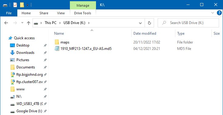

I've d/l'ed the files from theVW portal:   https://navigation-maps.volkswagen.com/vw-maps/DiscoverMedia2_EU-AS_2010_V17.7z and have expanded the compressed file without issue.
However, when I compare the files with the old SD Card, there appears to be a file missing - an identification file? - something like 1910_MP213-1247.x_EU-AS.mds.
Is this essential, and where do I find it if it is needed?
Many thanks.
28 minutes ago, BionicJohn said:
I've arrived home!
Many thanks.
Ignore the missing file checksum, it will work without that, and should exist checksums in another file (cannot recall off top of head)
Put it in the car, and use.

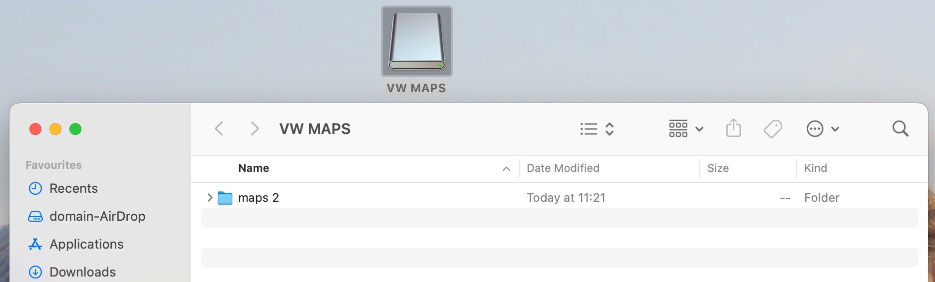

Well the fun I'm having with updating maps is starting to wane 🙁
After a particularly stupid start yesterday, it became apparent this is the thread for me - ish, and not the Columbus thread as the Golf has a Discover Media2 unit.
I decided to go via the VW website and found an option for 9.33gb V.17 maps (as in a size that'll fit my 16gb VW SD card), which I've downloaded to my MBP, unzipped with Keka (as per VW's recommendation) and then cleaned the VW SD card with CleanMyDrive2 (also per VW's recommendation).  And I can clearly see the folder on the SD card:
1854532786_Screenshot2022-12-06at11_59_39.thumb.jpeg.484bb5572334b55f763d4a2e658e14e9.jpeg

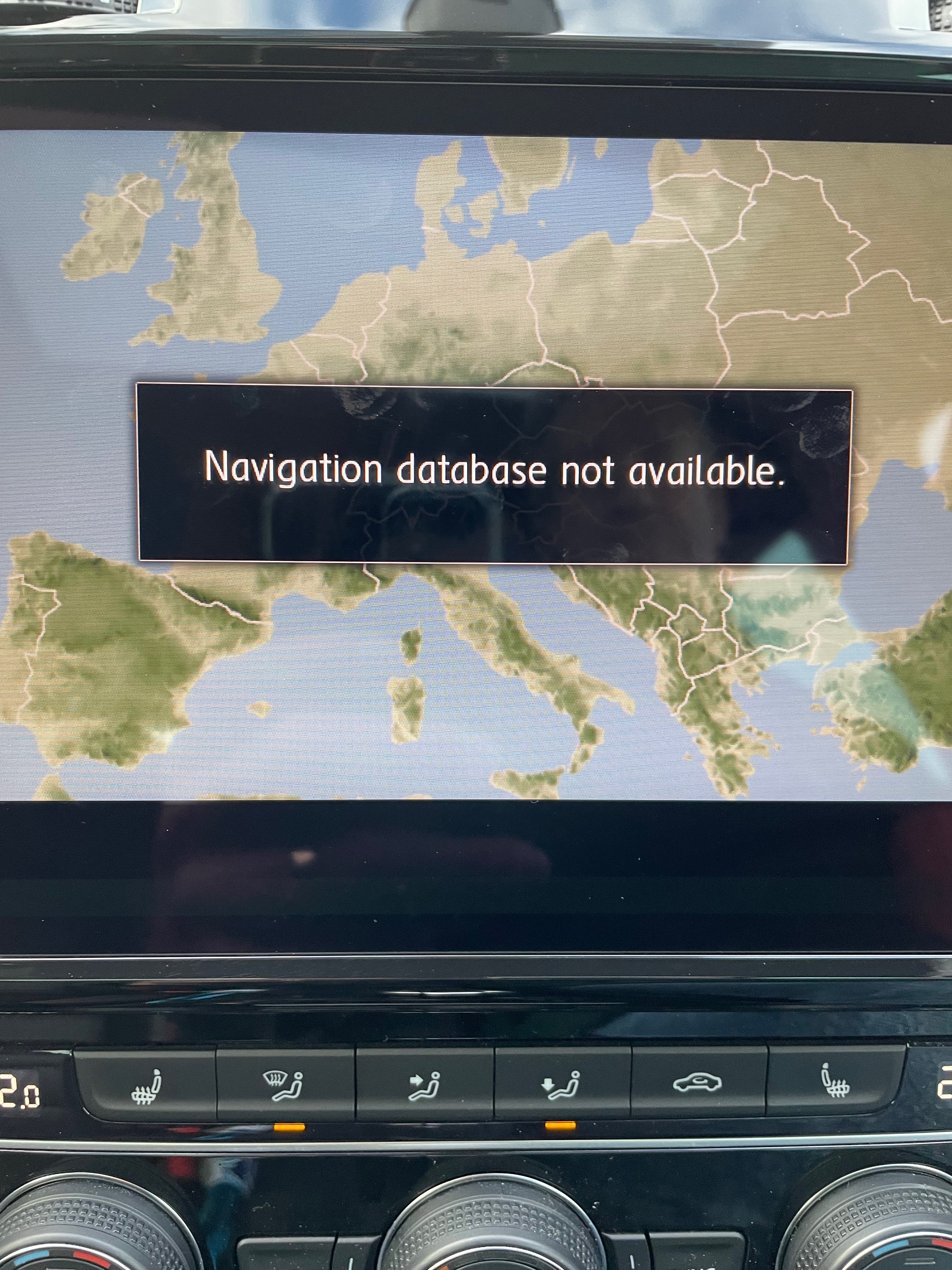

Put the card in the car and it's not playing:
So I popped into VW.  They told me I could download the AS V.17 maps onto an ordinary SD Card of the right size (I've a 64gb card) and that it doesn't need to be a VW card.  This doesn't appear to be correct. And that seems to be borne out by the VW website, which clearly states it needs to be a VW card for the AS maps.  I went to their parts/accessories counter, and was told that a 32gb card wasn't available for my car, but the latest I could get was V.15, on a 16gb card (like what I already have) with a reference of 5NA 919 866 CA.  This also appears to be incorrect, as the VW website clearly says V.17 is available for my media unit (although I'll need a 32gb card as it looks like the 15.93gb AS maps need 16.1gb of space).  A 16gb card from VW will cost me..... drum roll..... the princely sum of £136.21.
A quick squizz online and it looks like I can get the same card for £45, which is plug and play, and currently sounding very tempting:
But is there something I'm missing or ought to try before embracing F-it mode and buying the 32gb card? and will my unit be able to use a 32gb card if VW are saying the only available card is a 16gb version?
 It's the first time I've tried updating maps, so this is all new to me, and I'm currently feeling quite stupid :blush

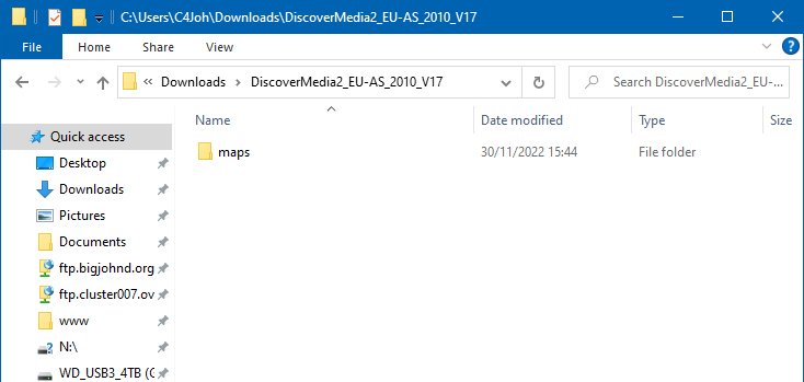

Pretty sure that folder should be called 'maps' rather than 'maps 2'? At least based on DiscoverMedia2_EU3_2010_V17.7z which I just downloaded to check the structure for you :)
I'd try renaming it and running cleanmydrive again.
Bingo!! :dance:
Oh my goodness, it was as simple as that - thank you so much :clap:
I had a really old file, not even car related, called 'maps', which is why it had defaulted to 'maps 2' once unzipped.
Version 17 maps, and all working tickety boo, on the original 16gb SD card.
Muchas gracias Langers! 👍 😎
