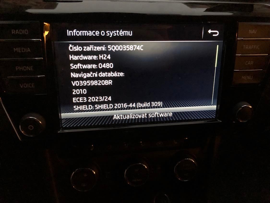

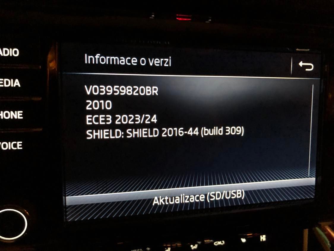

@Tell So today I managed to run the maps from the 64gb USB stick, I downloaded the whole map   # ECE AS(A1) 2023/24        15.3 Gb
 VW portal:   https://vw-maps-cdn.lighthouselabs.eu/vw-maps/DiscoverMedia2_EU-AS_2010_V17.7z
 And I downloaded to a 16GB memory card and both work # ECE 3 2023/24  5.4 Gb
 VW portal:   https://vw-maps-cdn.lighthouselabs.eu/vw-maps/DiscoverMedia2_EU3_2010_V17.7z

the first loading was long, but when I get into the vehicle, the map starts up immediately
Generally when the maps are loaded in the first time there is a delay. Think it writes new FeCs in, how on Seats you get a collection of FeCs when you use the "workaround" for Mapcare that isn't required on Skoda and VW so there is a first time day. You do have the 20 minute power on after turning off and if the infotainment system is left on, unlocking starts the process. Probably enjoying that one.

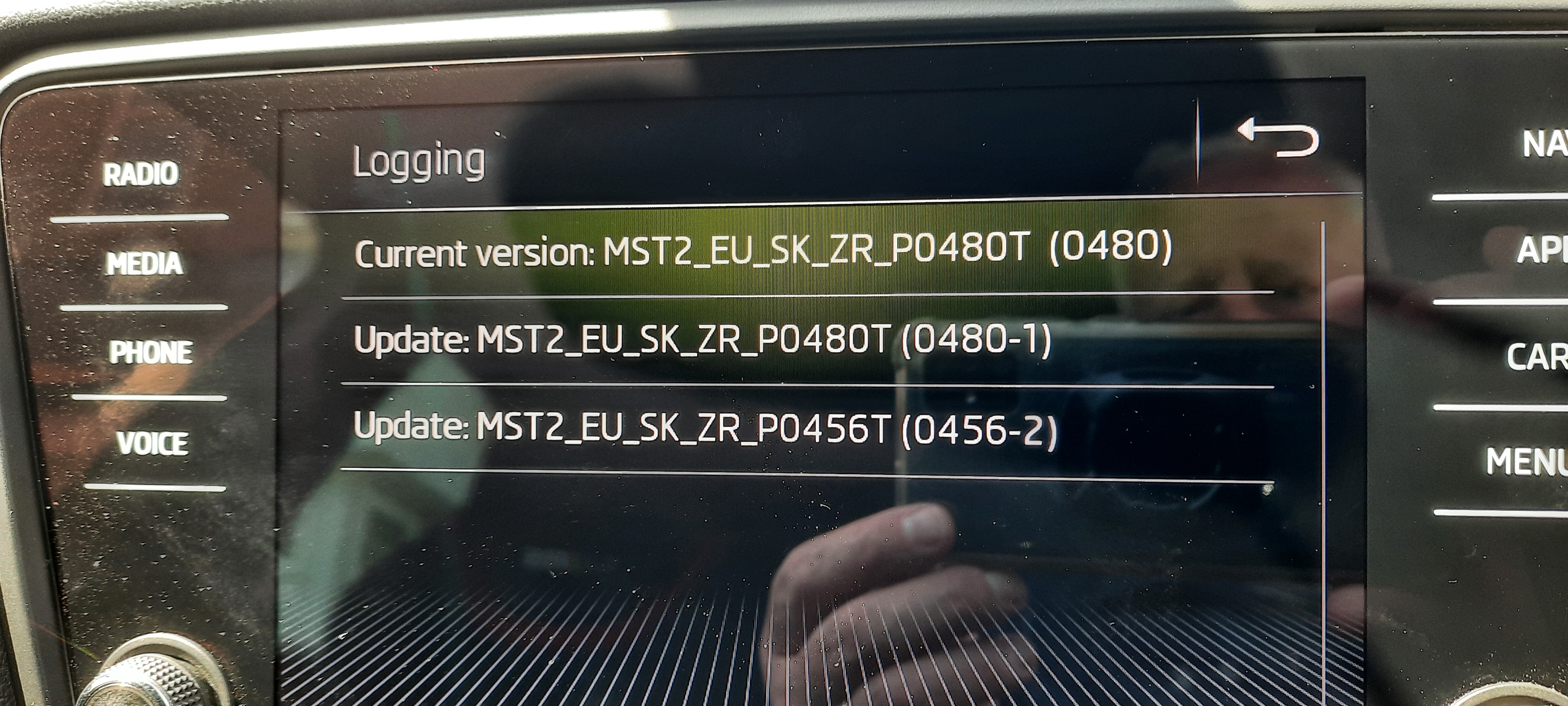

none of these software codes/version look anything like the most recent amundsen version you list below although it was supposed to be update quite recently where am I going wrong
Those are the firmware releases, not map releases which is the thread.
@John1701
2010 are previous 2023/2024
current 2024 -> 2110
